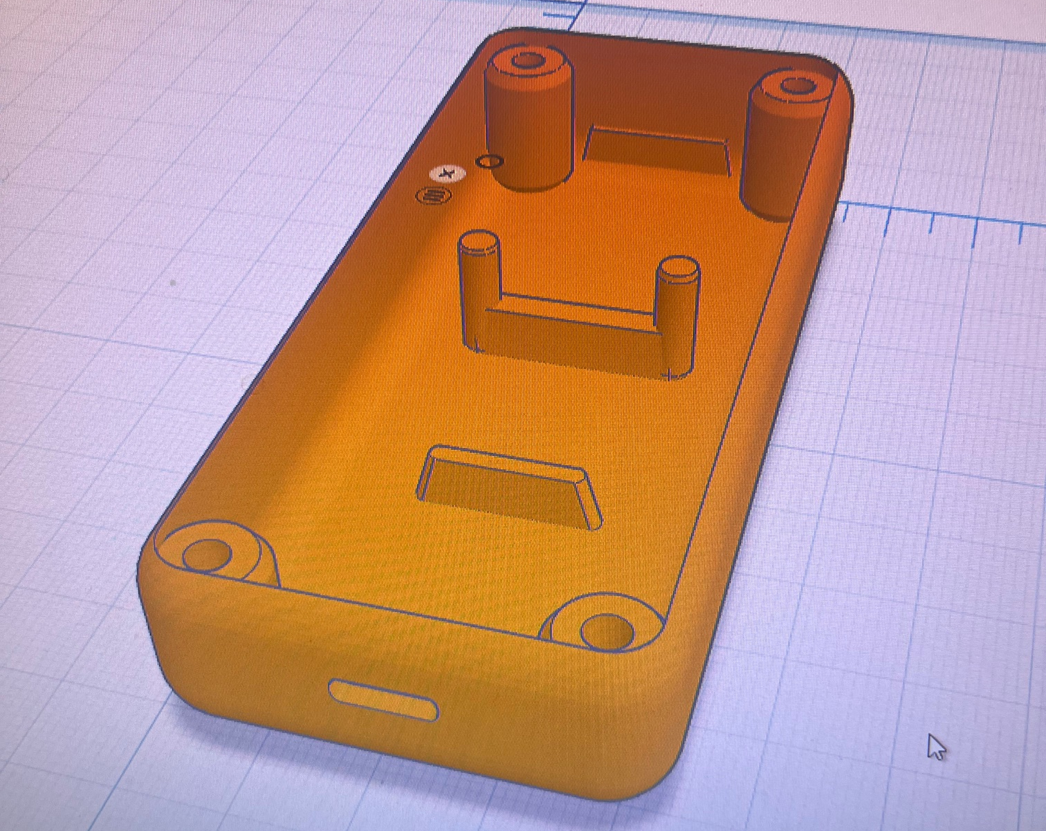

I am not a mechanical engineer.  My work on Solidworks seems to be more time-consuming than productive.  I used tinkercad to generate the 3D printed case.  It took about 5 tries to get everything the way I wanted it.  Apparently this is not a complicated part to get injected molded if it ever becomes a thing.  I will probably have to redesign for molding as the lines are parallel in this model.  I will likely have to redo it in Solidworks.
This project was challenging in many ways:
1. Originally designed as 2 PCBs sandwiched with standoffs but my wife said it looked unfinished (although I liked the exposed look of it).  This took my usual 2 dimensional design into 3 dimensions and took a few iterations to get right.
2. The analog design is challenging and very touchy.  Many simulations, calculations, and test circuits brought me to this point.
3. To get precision from the ADC required some interesting solutions.  The debugging was fun also.
4. Final design to improve accuracy and make calibration easy as well as put it into a nice case.
