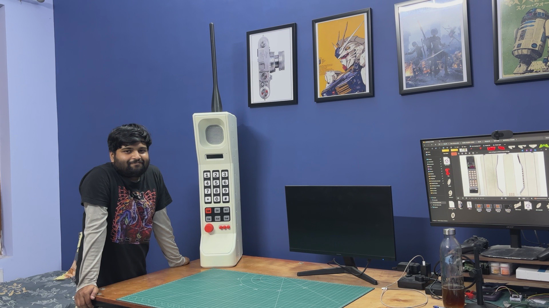

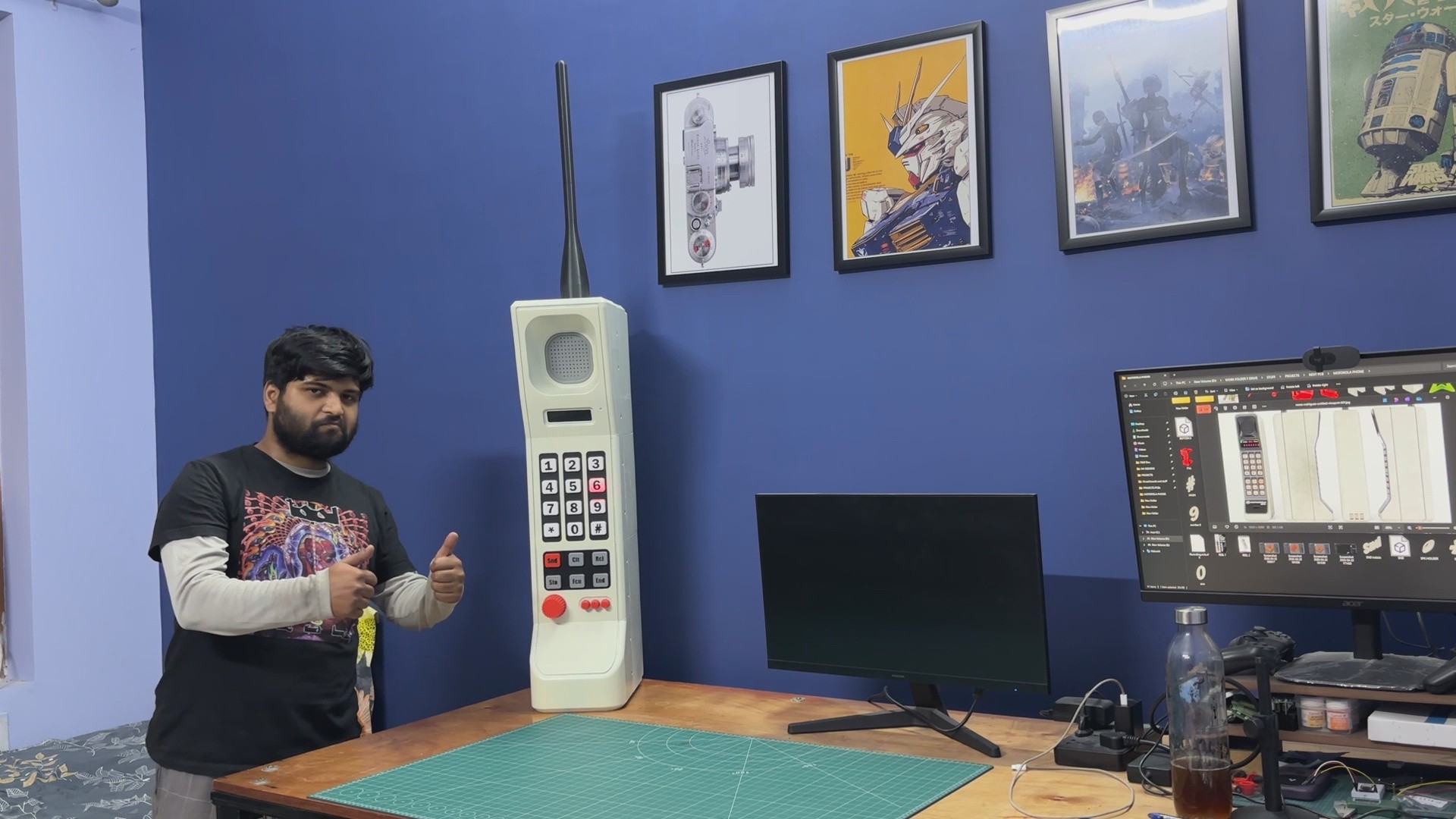

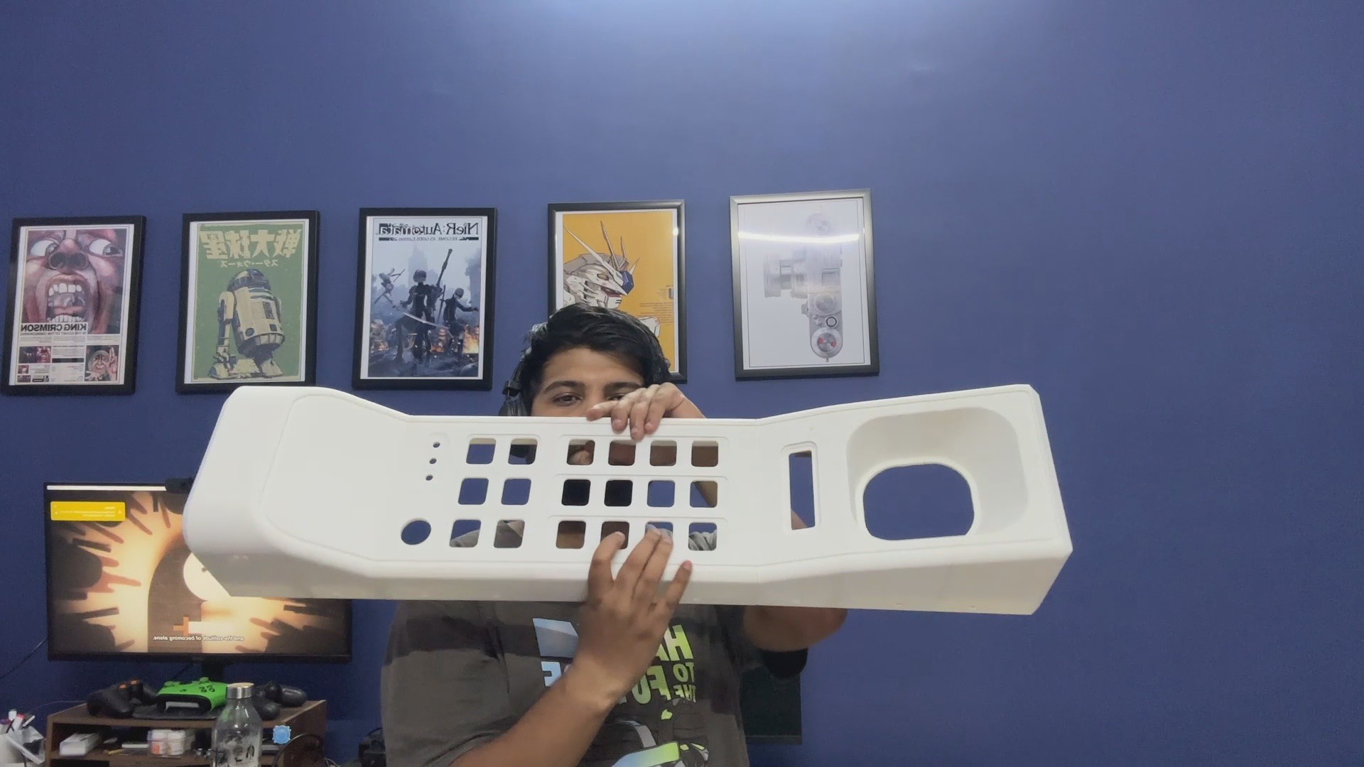

Greetings everyone, and welcome back. Here’s something comically huge: meet the Motorola DynaTAC MAX, my take on the OG Motorola DynaTAC 8000X, but with a twist. The twist here is the sheer scale of the project. I modeled a comically large replica of the Motorola DynaTAC 8000X, 3D printed the body, and made a nearly matching replica that actually works. For now, it works as a soundboard and a Bluetooth speaker.
The soundboard feature works as follows: I modeled buttons similar to the Motorola DynaTAC, and each button has its own push button connected to a Raspberry Pi Pico W and DFPlayer Mini setup. I added audio clips of numbers one to nine on an SD card. When any number button is pressed—say, one—the device plays the audio that says “one.” Similarly, it works for two, three, four, and so on.
Additionally, there are six extra buttons similar to the original DynaTAC buttons. These have unique audio clips assigned to each. Pressing the star button plays a screaming sound, the hashtag button plays a meme sound effect, one button plays the Halo theme song, another plays the “and his name is John Cena” meme, and I even added a Rickroll to the setup. It’s a perfect way to annoy your neighbours, as it gets super loud.
There’s also a full Bluetooth speaker module fitted inside the device. It includes knobs for controlling volume, treble, and bass of the Bluetooth speaker.
The idea behind this project was to make a giant replica of the Motorola DynaTAC, on which I will slowly add new features and eventually turn it into a fully functional phone. I also wanted to add a chatbot to this setup, but that will be covered in version 2 of the project.
This article covers the entire assembly process of the build, including the electronics assembly, sanding and priming process, code for the soundboard, Bluetooth speaker implementation, and more—so let’s get started with the build.

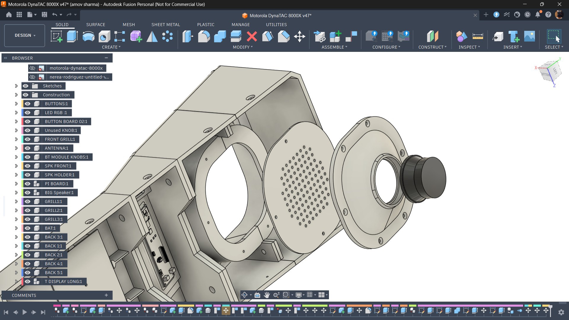

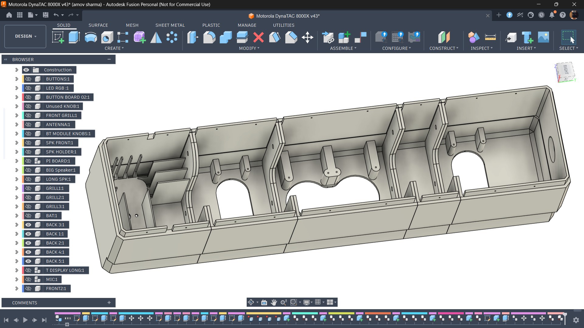

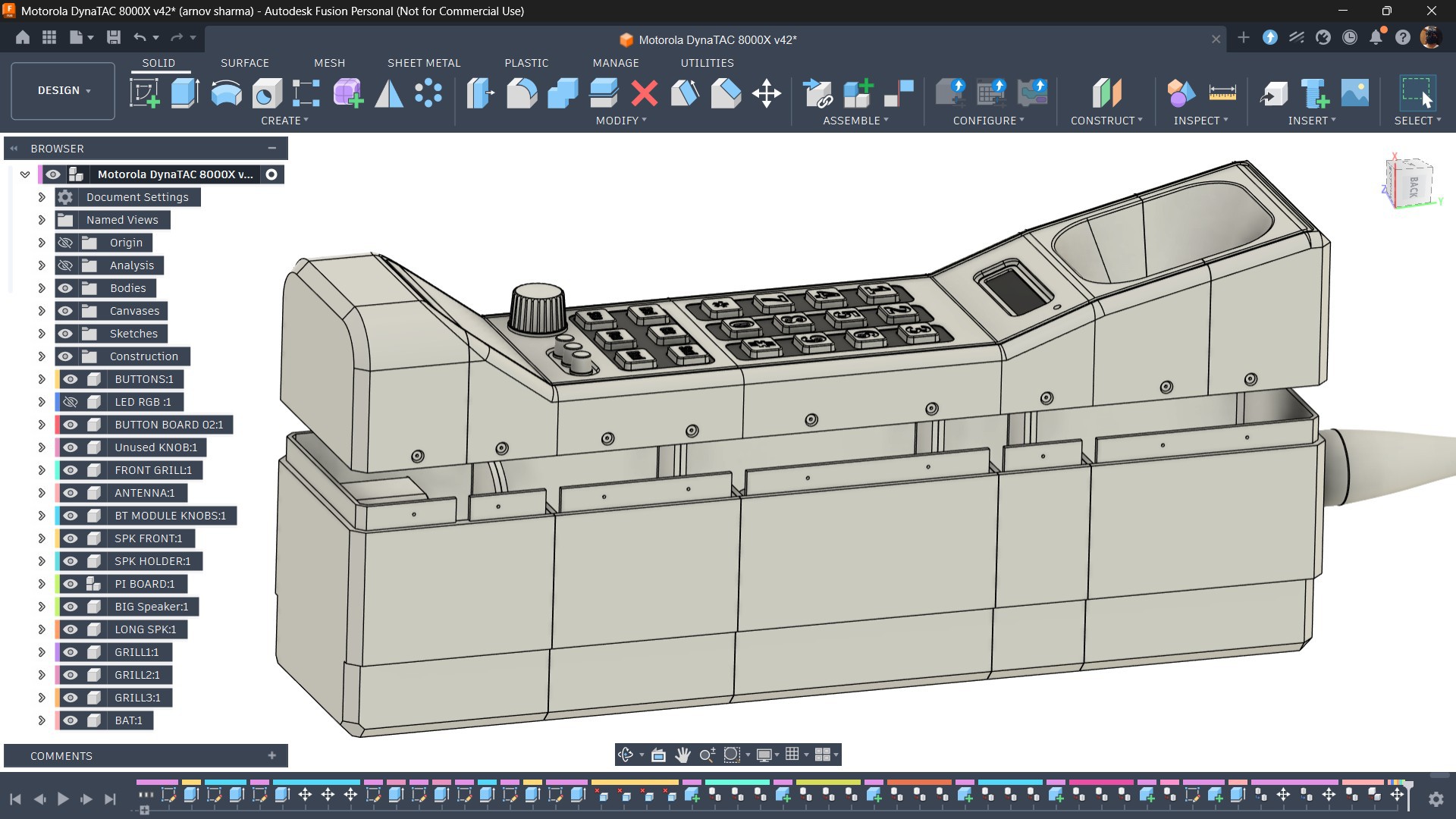

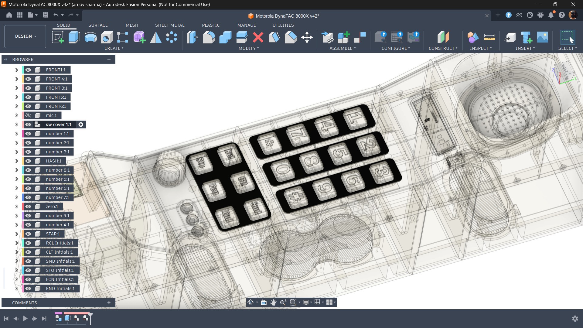

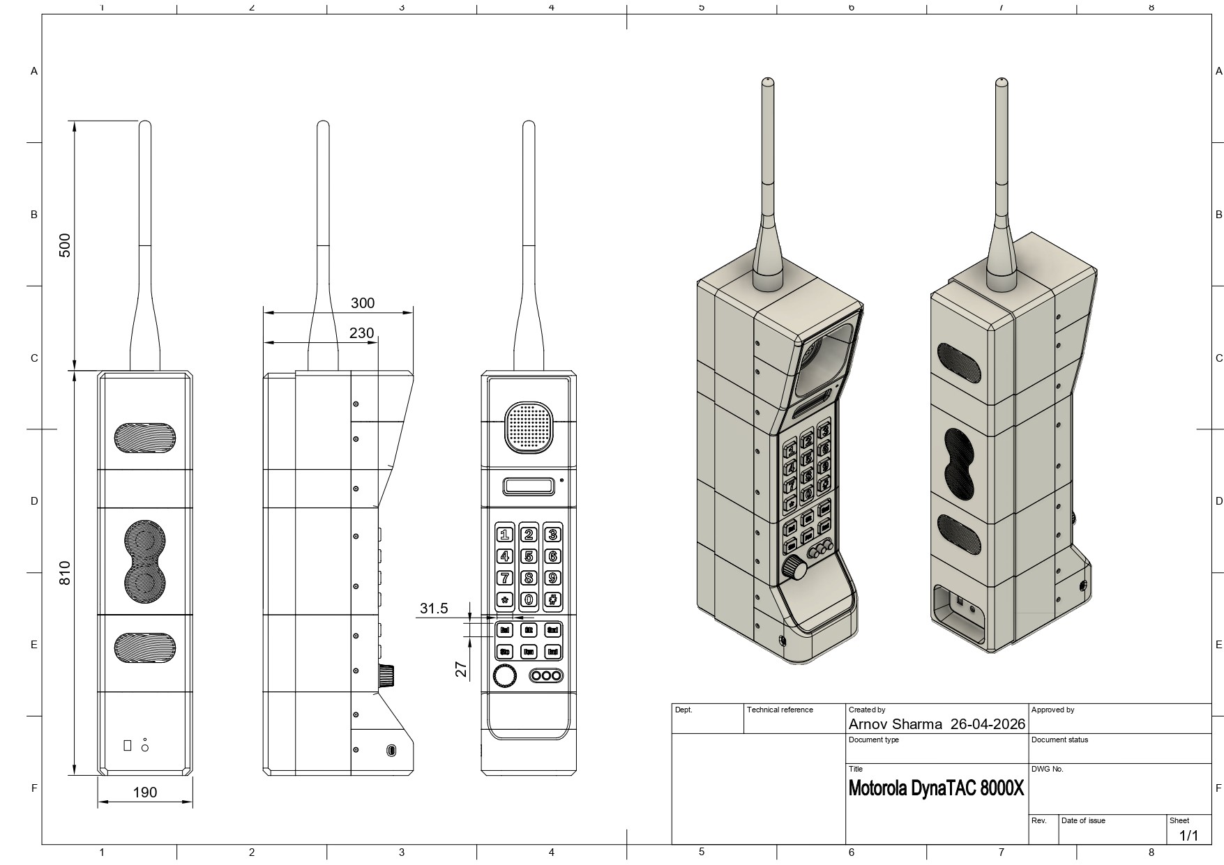

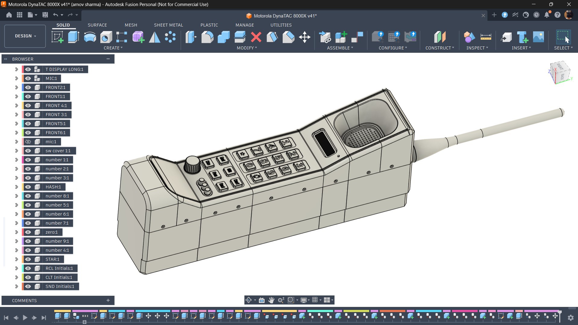

3D MODEL BREAKDOWN

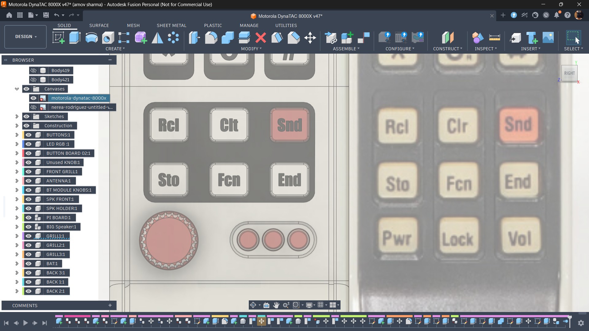

The whole project started with researching the phone, studying images from different perspectives and views to capture details that would later be used in the model.
We selected two clear images of front-view and side-view images, then imported them into Autodesk Fusion 360 using the import canvas option in Fusion.
Both images were calibrated so that the width of the phone measured around 240 mm, which scaled it correctly and allowed us to begin the modeling process.
From the front view, we sketched the outline of the phone and then extruded it, which gave us a solid block. This solid block was then viewed from the left side, where we created another sketch that followed the DynaTAC’s shape and performed...

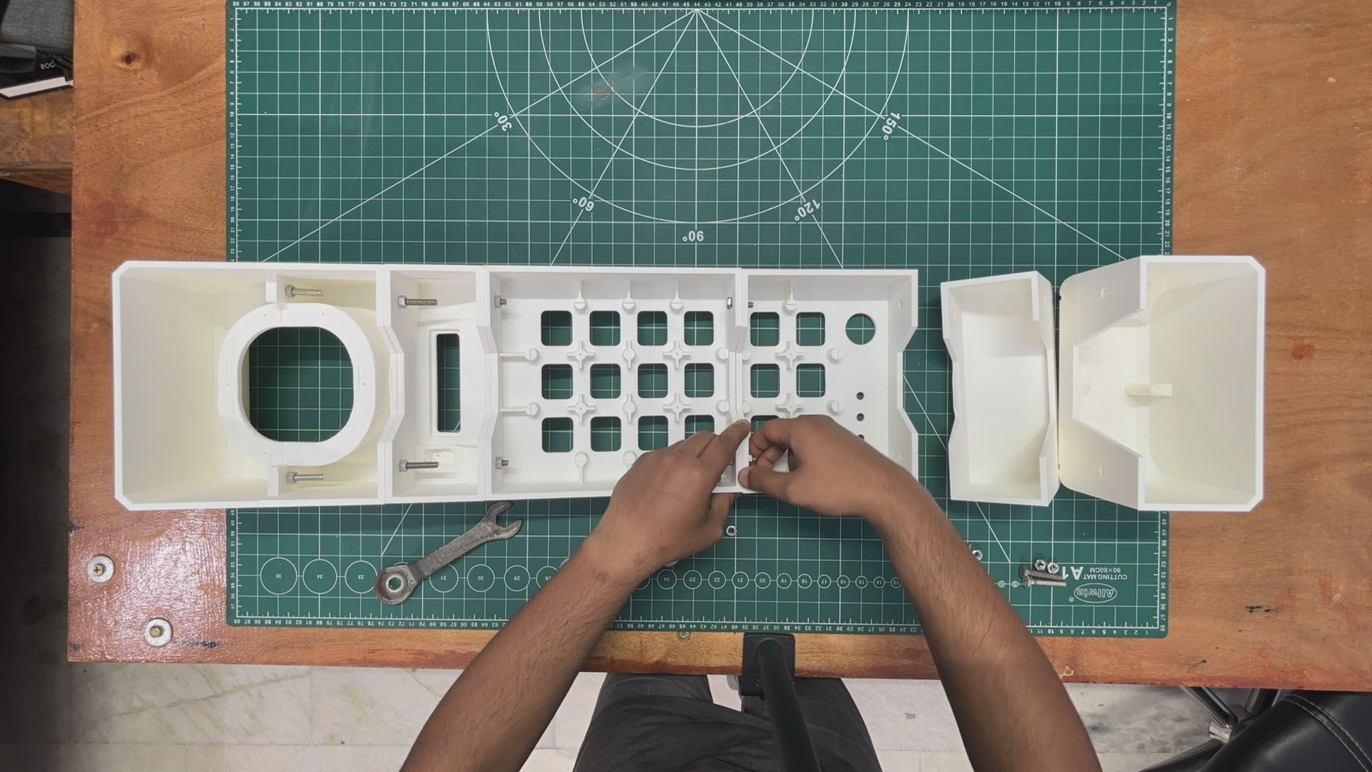

    FRONT BODY ASSEMBLY
    We begin the front body assembly by putting all the parts together.
    • We printed a total of seven parts, and using M6 nuts and bolts, we joined each part, starting from the top to the bottom.
    • We used two nuts and bolts for joining each pair of parts.
    We could have used regular superglue or other adhesives, but they wouldn’t provide enough strength. Using nuts and bolts gives the assembly proper structural integrity.

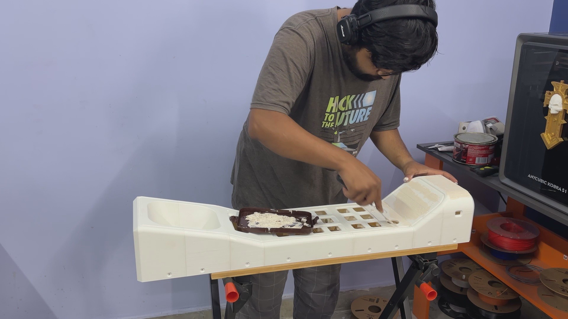

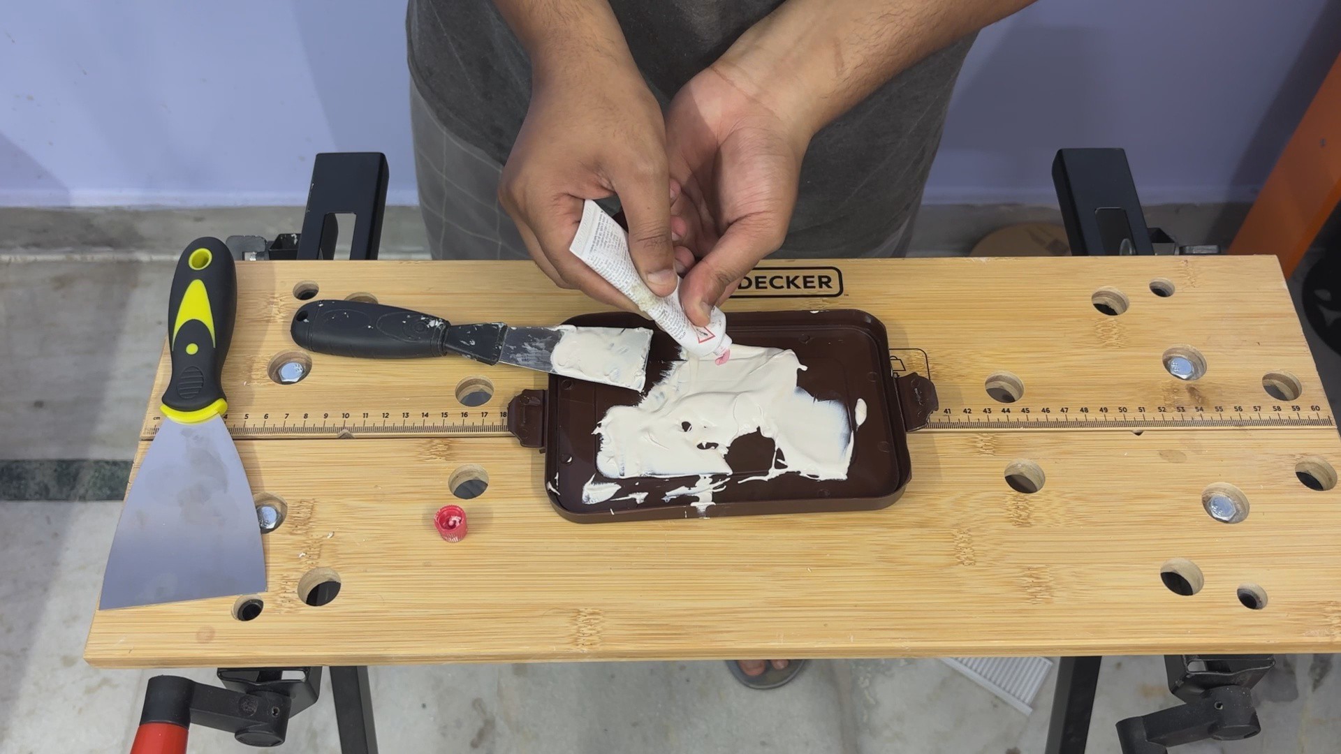

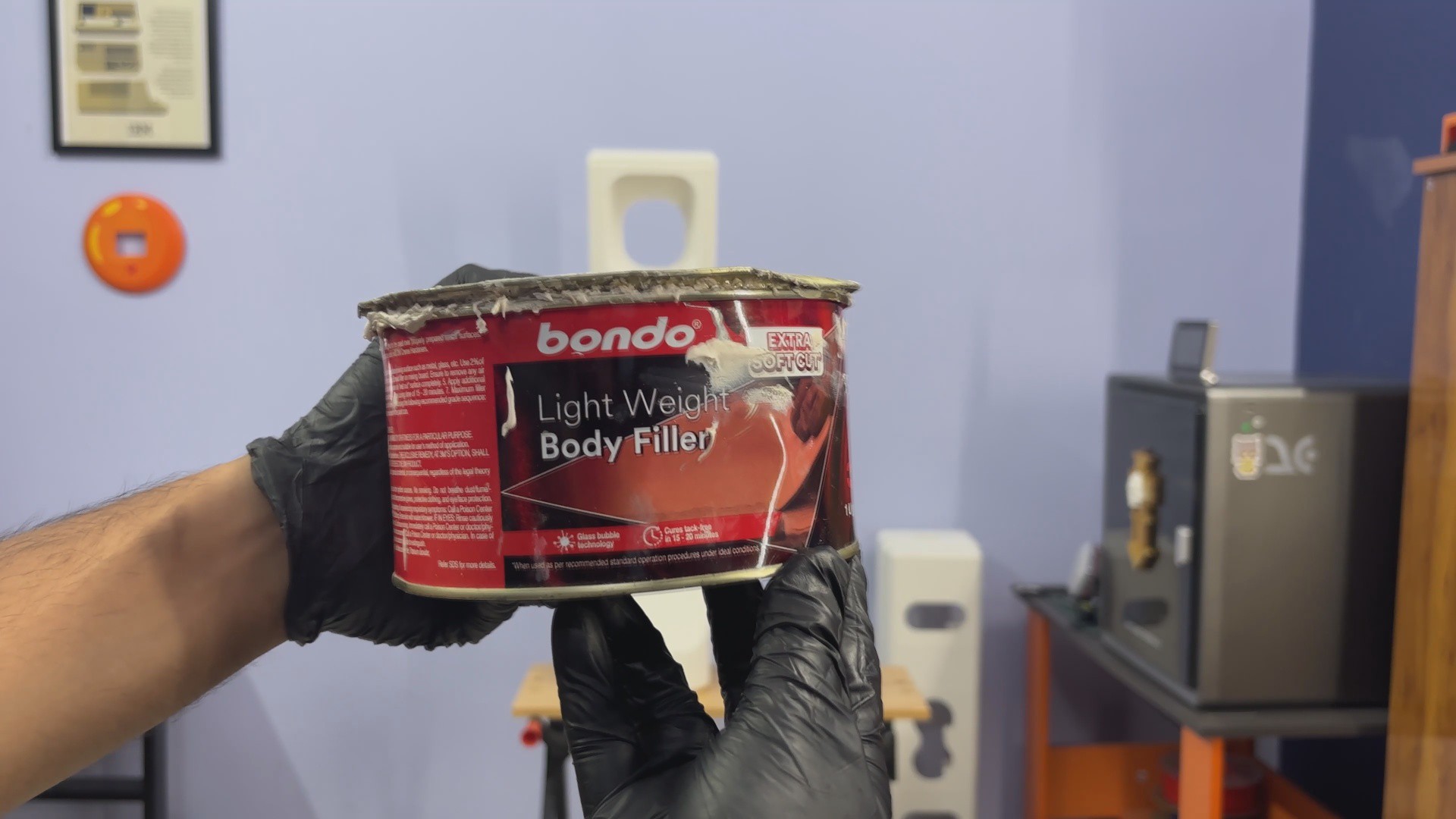

    FILLER PREP WORK
    For filler material, we are using a 3M automotive two-part filler, which consists of a filler and a hardener.
    By adding 2% hardener and mixing it thoroughly with filler, we get a compound that can be used to fill gaps, layer lines, and other imperfections on our printed body.
    The filler process is an important step before painting. Applying filler to 3D prints, then sanding the surface smooth, followed by primer and paint, results in a finish so clean that it no longer looks 3D printed at all.
  • 3
    FRONT BODY FILLER PROCESS
    • Using a paint scraper, we take a small amount of the filler compound mix and apply it across the front body.
    • We start by filling the gaps between the joined parts, then move on to areas where layer lines are visible.
    The goal is to spread the filler over the 3D-printed surface, so it settles into the layer lines and gaps between parts.
View all 28 instructions
