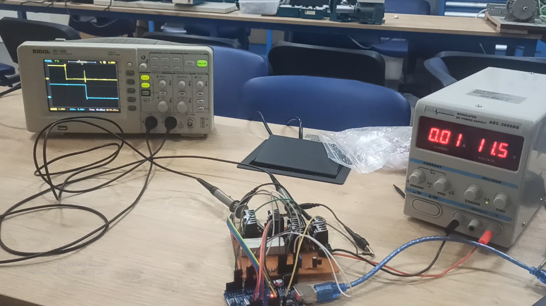

    In this log, I hooked up a Rigol DS1102E oscilloscope to probe the gate signals of the H-Bridge under no-load switching conditions. The primary goal was to verify the programmed dead-time and observe the switching characteristics of the discrete MOSFETs.
    Observations:
    As seen in the attached trace, the dead-time logic successfully prevents a direct shoot-through. However, a noticeable phenomenon occurs during the high $dv/dt$ transition. The oscilloscope captured a voltage spike of approximately 2V on the low-side IRLZ44N gate when the high-side IRF9540 switches.
    Engineering Analysis:
    This is a classic demonstration of the Miller Effect (induced via parasitic drain-to-gate capacitance C_gd. Because the IRLZ44N is a logic-level MOSFET with a V_gs ranging from 1.0V to 2.0V, this 2V spike is just enough to push the low-side transistor into slight micro-conduction. This perfectly explains the minor 10mA (0.01A) idle current draw visible on the bench power supply during switching, even without a motor connected.
    While this micro-conduction is not fatal and doesn't cause catastrophic thermal runaway at this scale, it is a valuable insight. For future iterations, decreasing the value of the gate pull-down resistors or implementing a dedicated gate driver IC to actively sink the Miller charge will be necessary to achieve a perfectly clean switching state.
