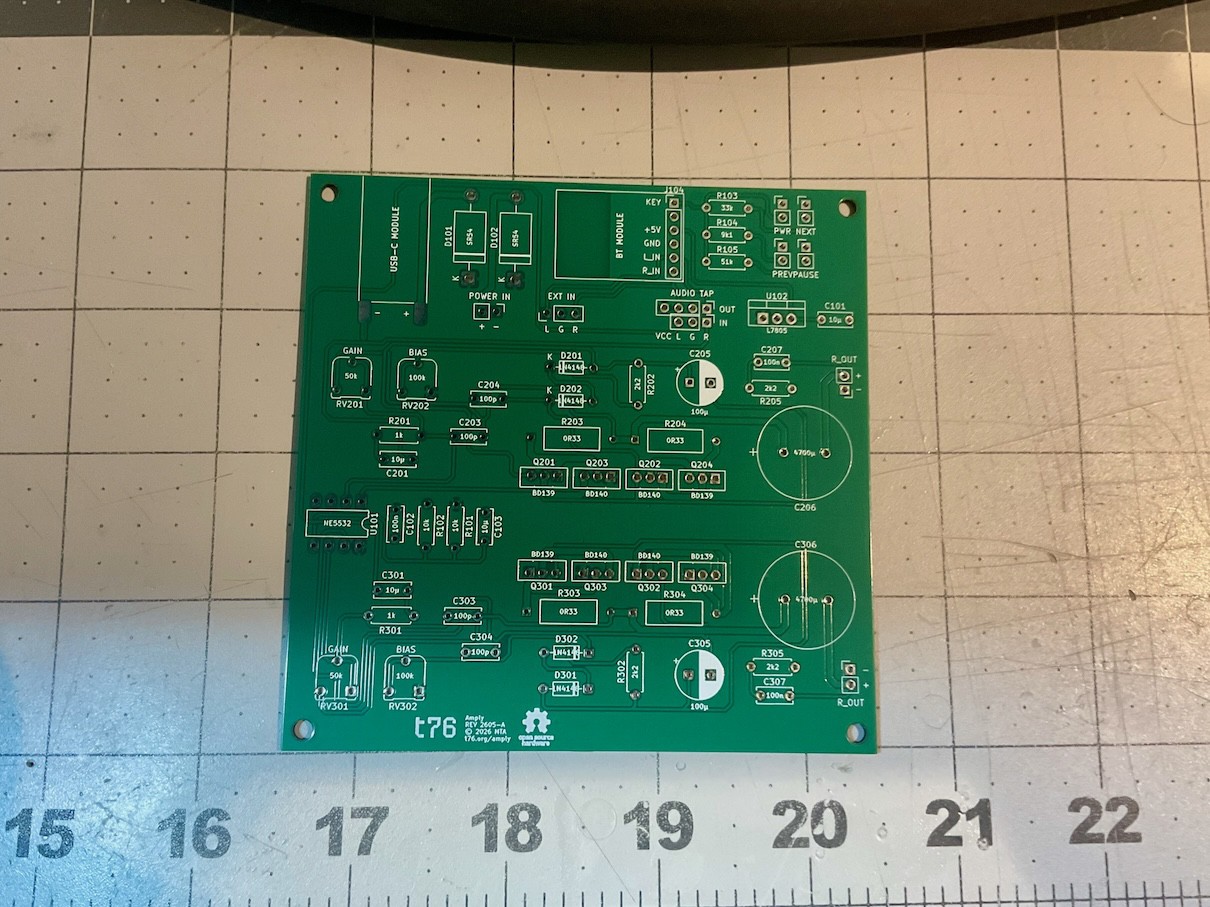

PCBs
While it's not impossible to hand-wire Amply on protoboard, the project includes all the files you need to make a 100x100 mm PCB for the amplifier. This will increase the costs a little, but also bring lots of benefits, such as a ground plane that will reduce the likelihood of picking up stray hums from the environment.
The PCB you see in the photo was made by PCBway and cost about $10 shipped. While they are not the cheapest, the quality of the PCB is very good, and they very kindly contacted me to inquire about some of the… less conventional choices I had to make to fit the design in two layers, just to make sure that the designed had not accidentally been mangled in the process.
Another side benefit of having a PCB is that it's much easier to fit the project into a proper 3D-printed enclosure. You are, of course, free to design your own, but I had to make one for myself, too, and so I included it in the Github repo as well.
Oh, in case you're wondering: PCBWay is not sponsoring me. I had never used them before, and this seemed like a good opportunity to try out their service.

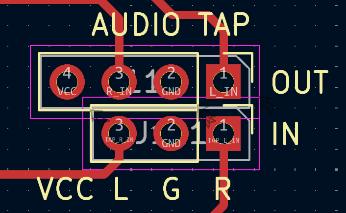

    Seven is the magic number… or not
    This is where things started to go off the rails. Removing the extra capacitors was easy enough—and I'm sure that removing the Schottky diodes would have been as well if I had actually remembered to do it. Instead, not only did I leave them in place, but I also moved them and rerouted them to a “more convenient location so they're out of the way.” Why? I don't know; you'd have to ask my subconscious.
    Next, I added a very simple mechanism for intercepting the audio signal from the BT module. This is simple enough: nothing more than a pin-header bridge on the board that you can short to let the signal pass through unaltered, or open to then tap into the signal and route it elsewhere before it comes back to be injected into the amplifier.
    I thought that it would be a good idea to also add a tap for VCC so that, if I were to add some kind of external processing module, it could be powered from the same source as the rest of the circuit. In a moment of extreme genius, I decided that, since VCC is only an outgoing signal, there would be no reason to have two separate pins, thus leaving me with a 7-pin header on the board—and, as everyone knows, 7-pin headers are not only aesthetically pleasing, but also very common and easy to source. (I mean, who doesn't have a bunch of 7-pin headers lying around?)
    The problem, of course, is that this 7-pin wonder can only be implemented by placing two sets of single-row pin headers, one with three pins and the other with four, back-to-back on the board. This is not only a pain to solder, but also makes it very easy to accidentally short the pins together if you're not careful. And, of course, I only realized this cretinous mistake after I had already ordered the PCBs and had them in hand.
    It's the layout, stupid!
    As silly as this decision was,...
