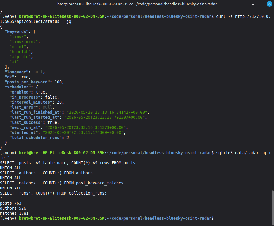

    Instead of building a polished dashboard next, I wanted to confirm the underlying data pipeline was working. So this evening I inspected the SQLite database directly to get a quick row count across four tables.
    Using the terminal, I opened the project database with:
    sqlite3 data/radar.sqlite
    Then I ran a small SQL query to count the rows in the core tables:
    SELECT 'posts' AS table_name, COUNT(*) AS rows FROM posts
    UNION ALL
    SELECT 'authors', COUNT(*) FROM authors
    UNION ALL
    SELECT 'matches', COUNT(*) FROM post_keyword_matches
    UNION ALL
    SELECT 'runs', COUNT(*) FROM collection_runs;
    The results were encouraging:
    posts|62952
    authors|30138
    matches|294065
    runs|497
    Which means the system has collected 62,952 posts, tracked 30,138 authors, recorded 294,065 keyword matches and completed 497 collection runs. For a local project running on my own hardware, this is a healthy amount of data to start analyzing.
    However these stats are slightly skewed because the system had two restarts during the collection period. Those restarts affect how cleanly the run count and collection continuity should be interpreted. The totals are still useful, but they should not be treated as a perfectly uninterrupted measurement window. In future versions, I will add restart tracking, run session IDs or metadata for distinguishing between normal collection cycles and interrupted sessions.
    Overall, this was a good validation checkpoint. The collector is producing real data, the SQLite structure is easy to inspect and the next step is to turn these raw counts into visual analysis, trends and eventually a more complete OSINT dashboard.

    Today I reached the first real milestone for this project; launching an OSINT appliance running in my homelab, collecting public Bluesky activity for specific keywords and storing the results in SQLite for later review.
    A major motivator for this project is wanting to experiment with headless machines on my local network, quietly collecting public conversation data over time. The technology stack is simple, consisting of Linux Mint, Python, Flask, SQLite, the ATProto API and eventually D3.js for visualization.
    The first version of this project started as a collector script with output available in the terminal. It loaded credentials from a .env file, authenticated with Bluesky, pinged the ATProto search API and normalized the returned posts into records.
    From there, I moved the project into a more always-on mode. I added a Flask server and SQLite database. The Flask app now owns the database, exposes various endpoints and runs scheduled collection automatically. The collection interval is currently set to every 20 minutes.
    The database schema is designed around four core tables. Those being posts, authors, post_keyword_matches and collection_runs. This structure prevents exact duplicate posts by using the Bluesky post URI as the primary key, while preserving useful repeated observations over time.
    Ultimately, the OSINT radar node is collecting. The database is clean. The appliance is alive.
