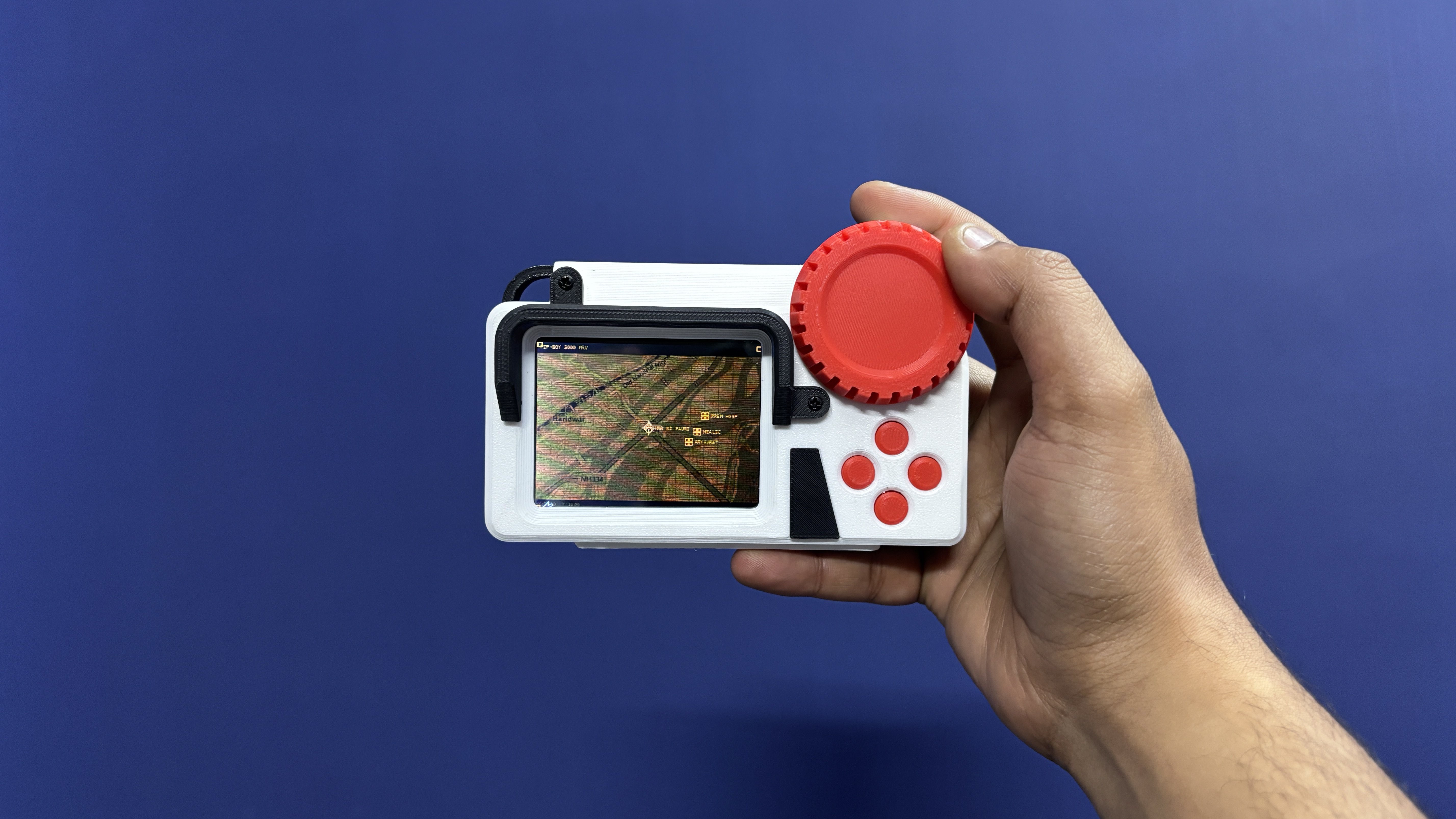

Greetings Fellow Travellers, and welcome back. This is PathFinder, a DIY digital map device powered by the UNIHIKER M10, designed to help you find your way. I go on rides in mountain areas near my hometown, and there, I frequently get no signal in some areas. Relying completely on Google Maps is a no-no; sometimes, due to data issues, maps are not loaded completely, and this can be a nightmare if you are stranded. This could all be sorted if we had a physical map and some navigation skills. I don’t have a physical map, but I have made a digital map that is loaded on a UNIHIKER M10 board. We can navigate the map using directional buttons. With this, one can help themselves if they are stranded.
For testing this out, I went to a remote area in the mountains near my hometown and used this map to navigate a road I had never been to before. I followed the map and was able to find my way without any issues.

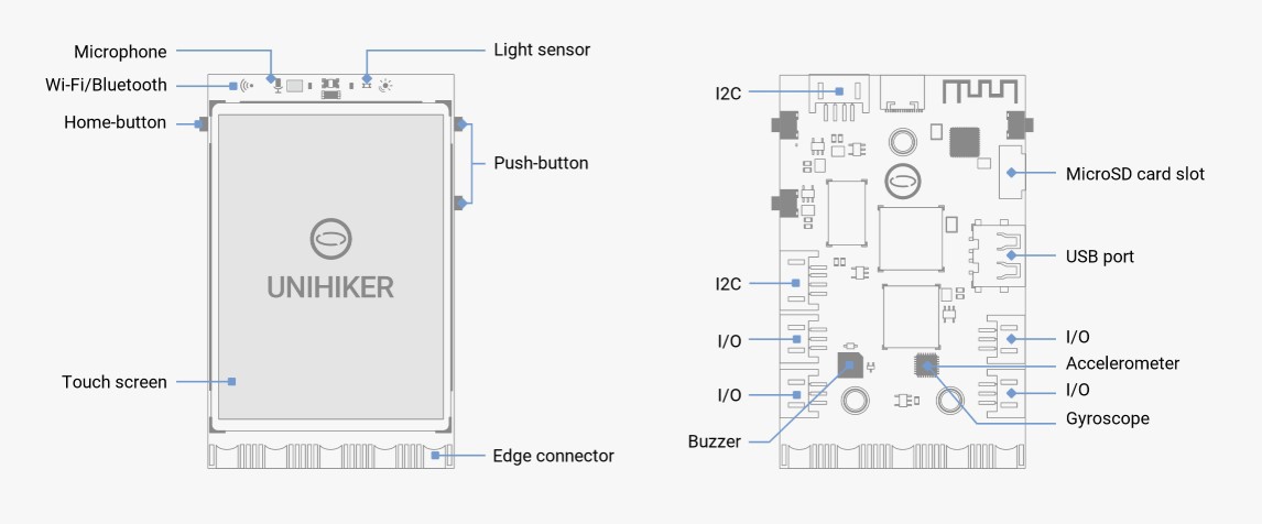

The star of our project is the UNIHIKER M10, which is a single-board computer that is quite unique. It comes with an onboard 2.8-inch touch display and has Wi-Fi and Bluetooth built in.
The thing that makes this device truly unique is the processor and co-processor. It is powered by an RK3308 ARM 64-bit processor, which has 4 cores and is clocked at 1.2GHz. It has 512MB DDR3 RAM and comes with an onboard 16GB eMMC chip.

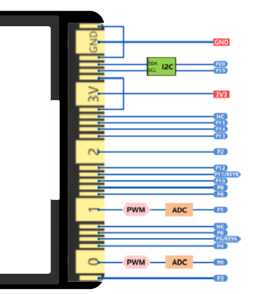

For controlling GPIOs, it has a co-processor, the GD32VF103C8T6. The name might be long, but it’s a RISC-V processor clocked at 108MHz, with 64KB flash and 32KB SRAM.
The CPU cannot directly control GPIOs, so a co-processor has been added, which we can control using Python. The system controls the co-processor using the PinPong library.

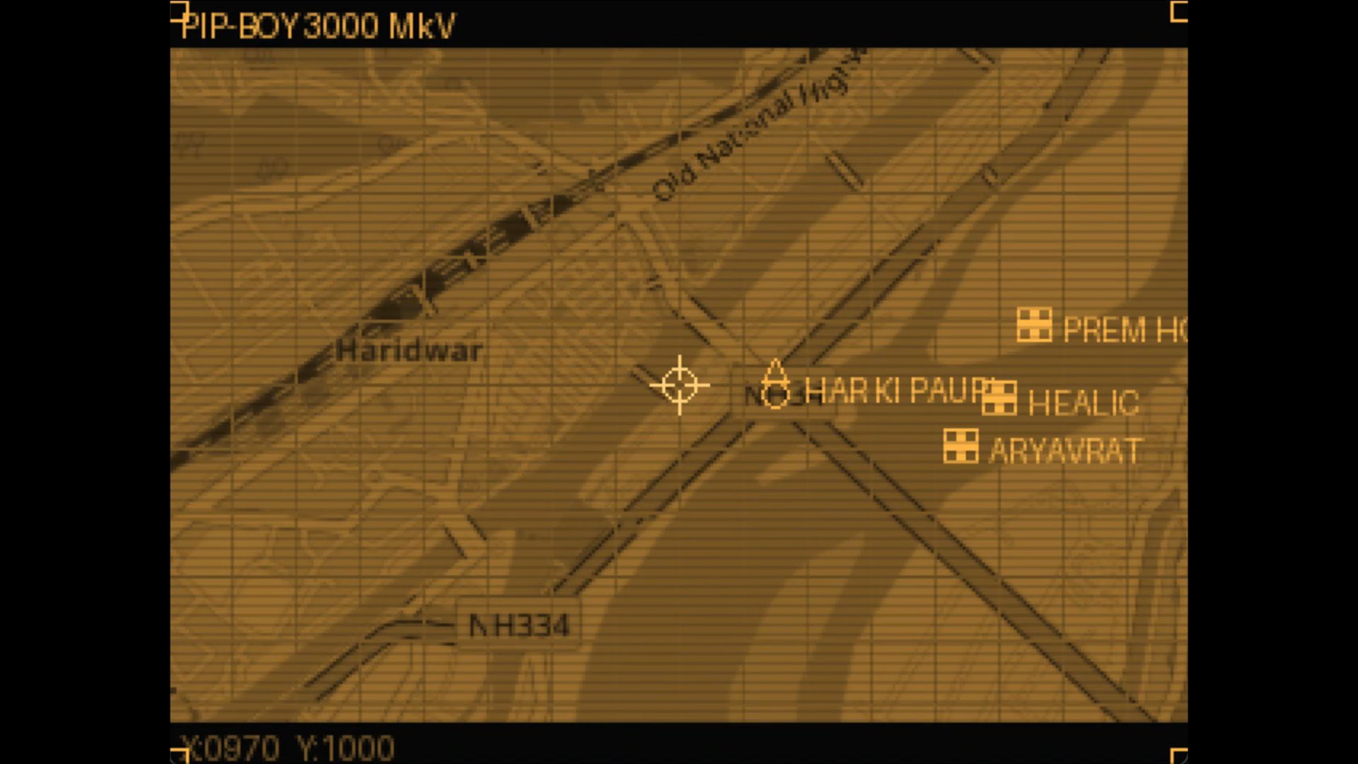

For the map, I took inspiration from the Fallout: New Vegas Pip-Boy 3000 interface, which features an amber tint. Normal maps are boring, and as a Fallout fan, it was my duty to create a map inspired by the Pip-Boy.

Rendering with Pillow
All graphics are composed in memory using Pillow — no framebuffer, no pygame. Each frame goes through:
  • Crop a 320×240 viewport from the 2000×2000 map
  • Apply an amber tint
  • Draw CRT grid + POI icons
  • Composite scanline overlay
  • Animate crosshair
  • Draw HUD bars
  • Rotate to landscape
  • Save and push
```pythonfrom PIL import Image, ImageDrawviewport = self._map.crop((x0, y0, x0 + VIEWPORT_W, y0 + VIEWPORT_H))frame    = viewport.convert("RGBA")draw     = ImageDraw.Draw(frame)```
Amber Tint
The map loads as normal RGB. To get the Pip-Boy phosphor look, the Red channel is used as the brightness source for all three channels:
r, g, b = img.split()img = Image.merge("RGB", (    r,    r.point(lambda v: int(v * 0.71)),   # amber green    r.point(lambda v: int(v * 0.26)),   # amber blue))Ratios `(1.0, 0.71, 0.26)` match the target amber `(255, 182, 66)`.

Buttons are wired to GPIO pins with internal pull-up resistors. When pressed, they pull the pin LOW, so a reading of `0` means "pressed".
from pinpong.board import Board, PinBoard("unihiker").begin()btn_up = Pin(Pin.P3, Pin.IN, Pin.PULLUP)if btn_up.read_digital() == 0:    move_y = -PAN_SPEEDif not hasattr(Pin, "PULLUP") and hasattr(Pin, "PULL_UP"):    Pin.PULLUP = Pin.PULL_UP

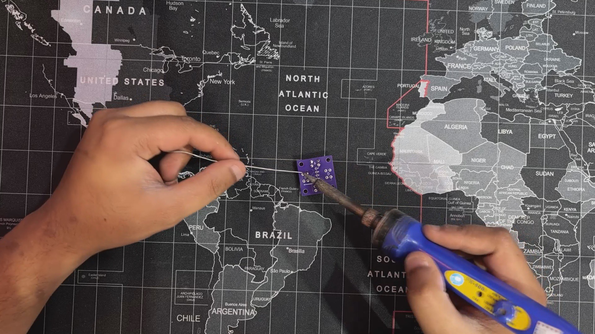

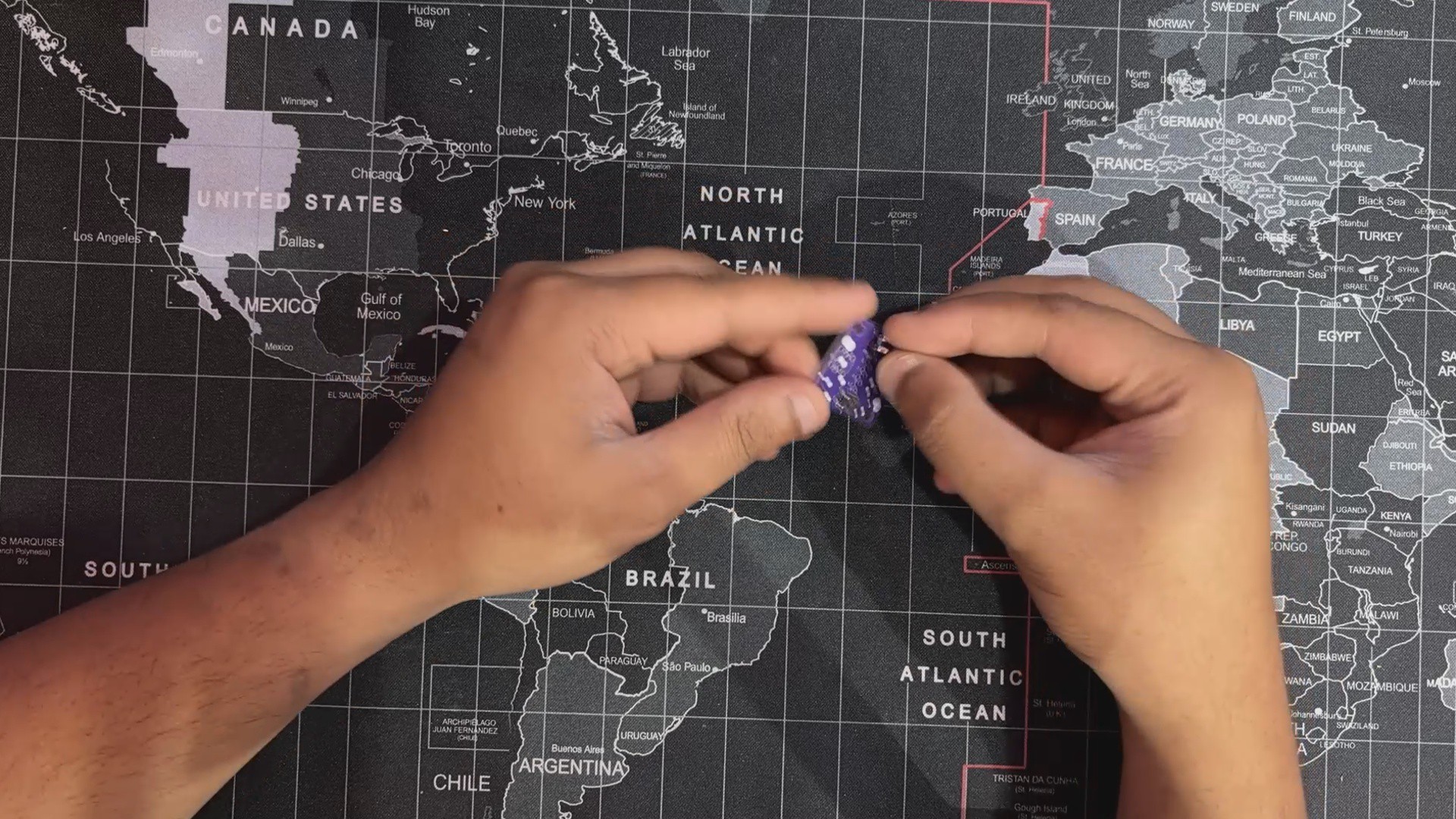

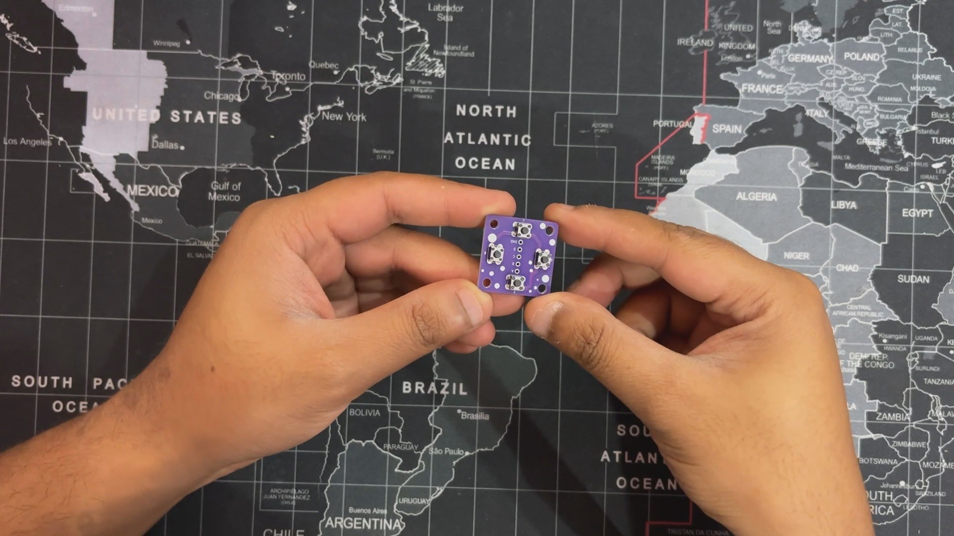

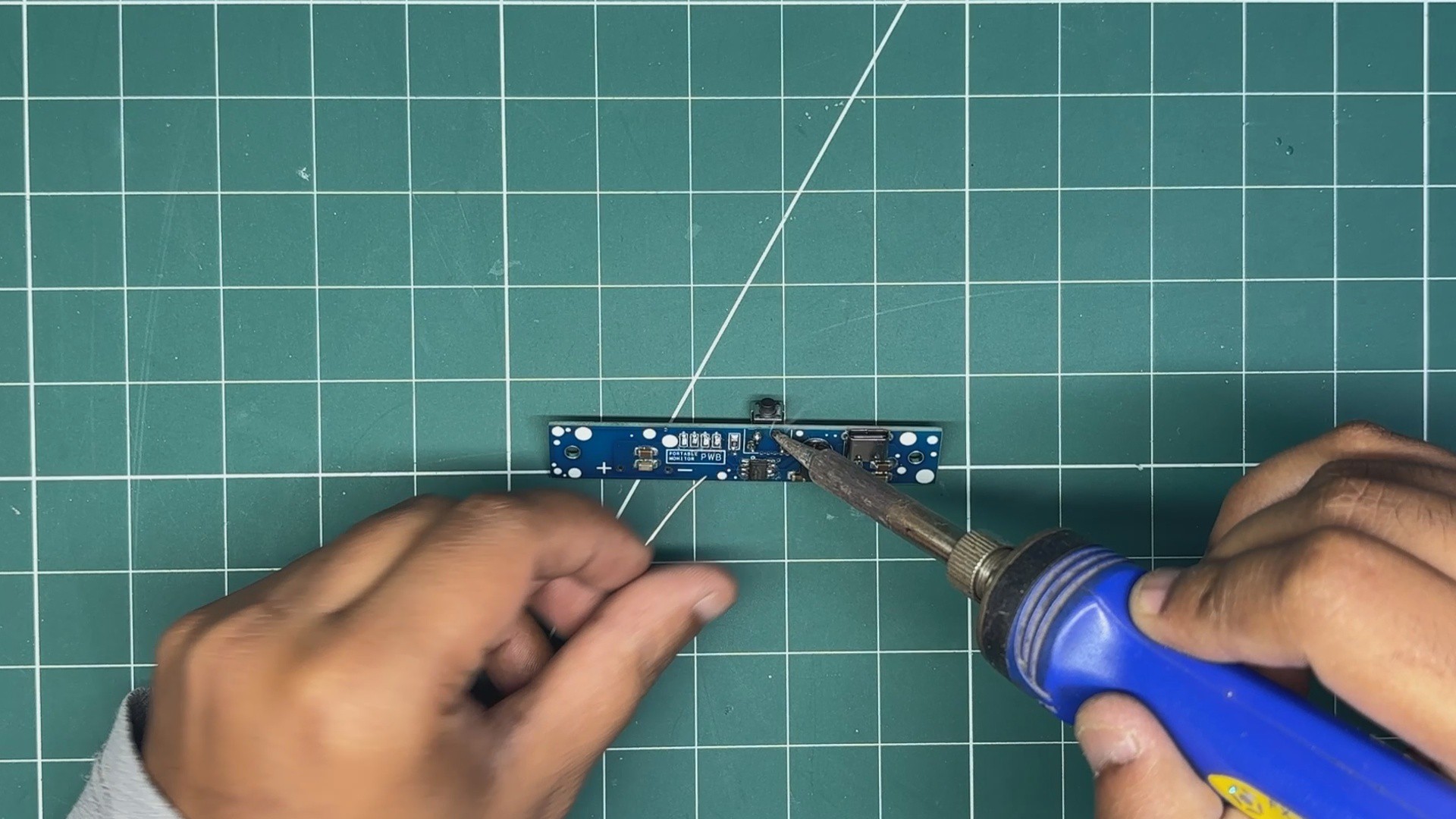

    BUTTON BOARD ASSEMBLY PROCESS

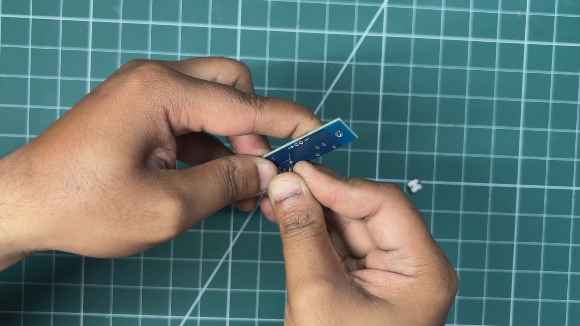

    Button board assembly was pretty straightforward.
    We placed all four push buttons in their positions, flipped the board over, and then used a soldering iron to solder all the leads of the push buttons.

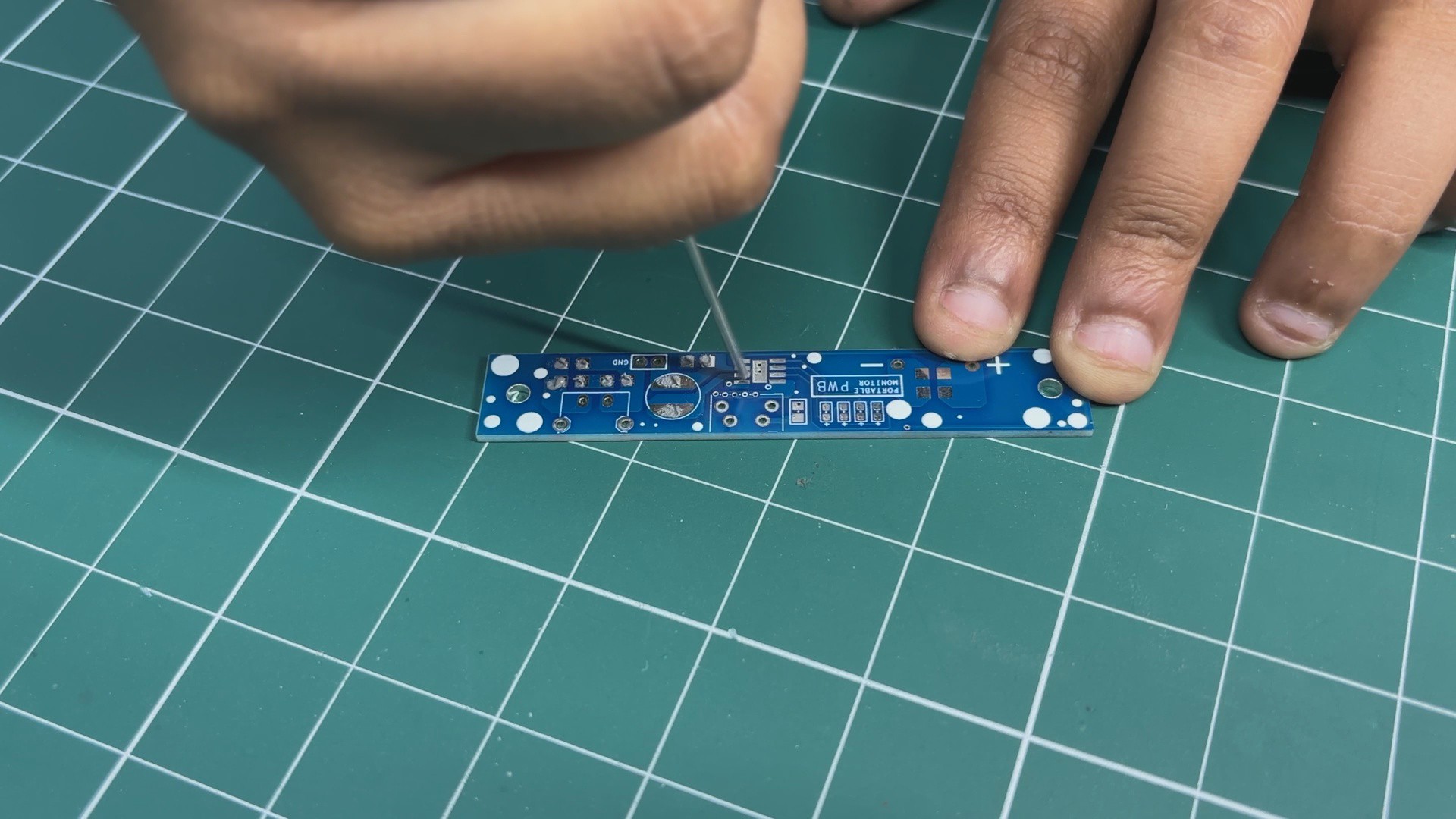

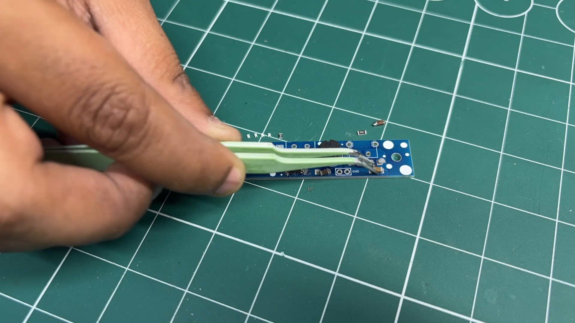

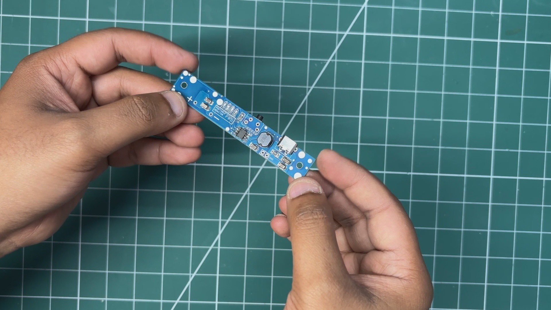

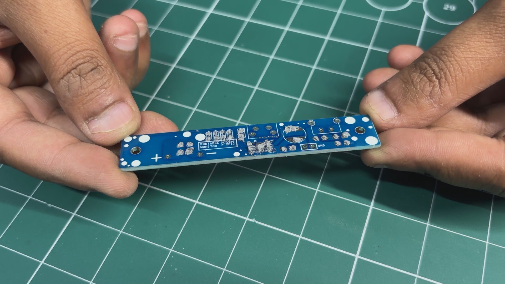

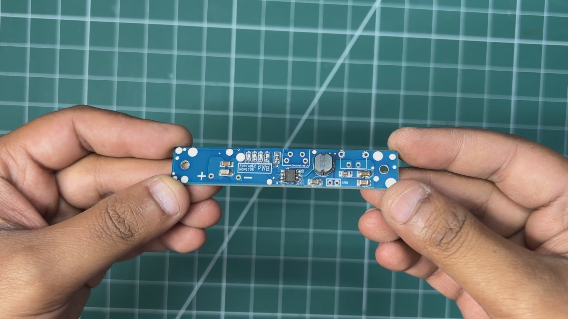

    POWER BOARD ASSEMBLY PROCESS

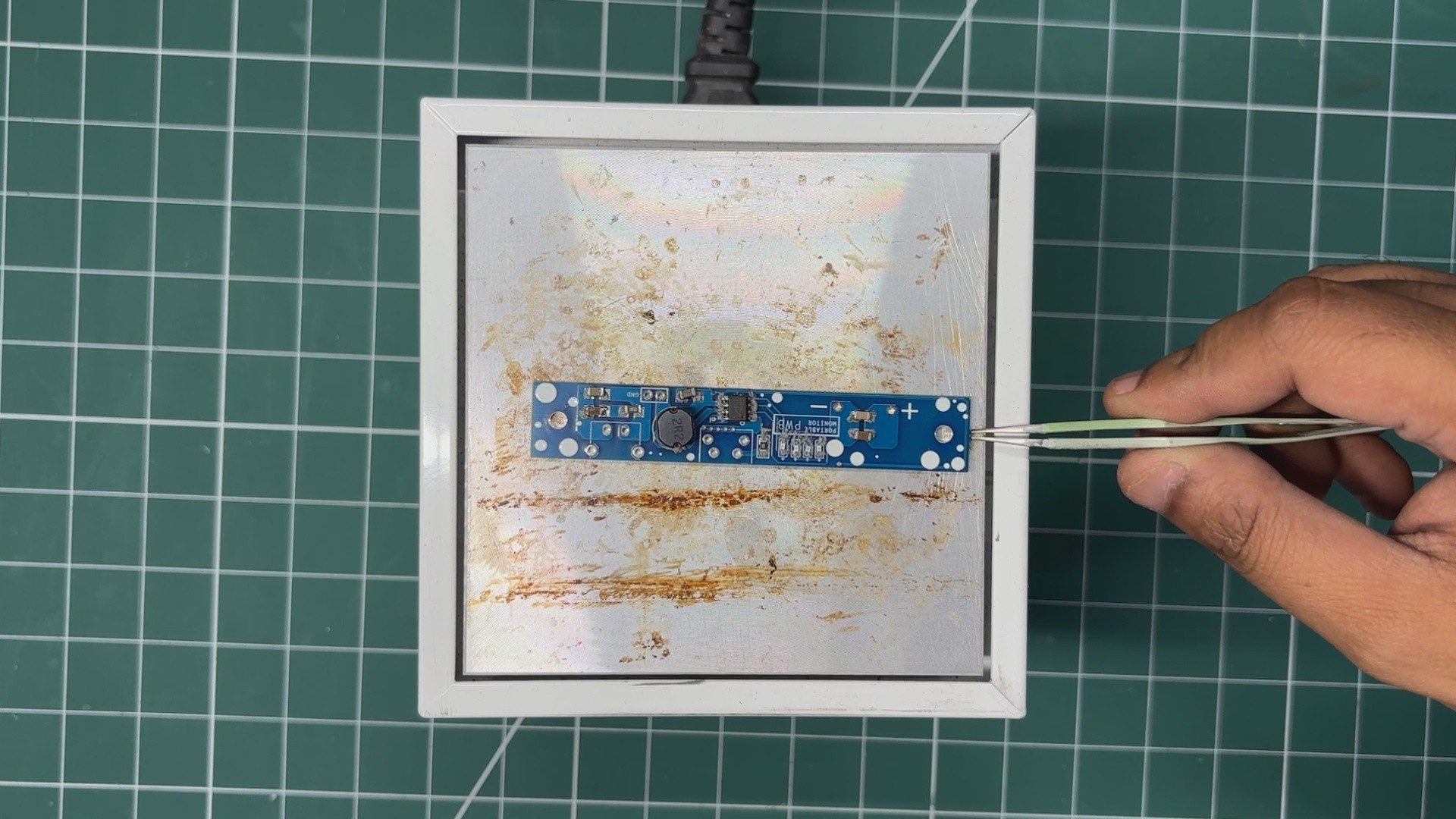

    • For the assembly process of this PCB, we use a solder paste dispensing syringe. We apply solder paste to each component pad to begin the Main Circuit Assembly process. Here, we are utilizing Sn/Pb 63/37 solder paste, which has a melting temperature of 190 °C.
    • Next, we pick each SMD component and place it in its correct location.
    • All of the components are then permanently bound to their pads when the entire circuit is set on the reflow hotplate, which heats the PCB to the solder paste melting temperature.

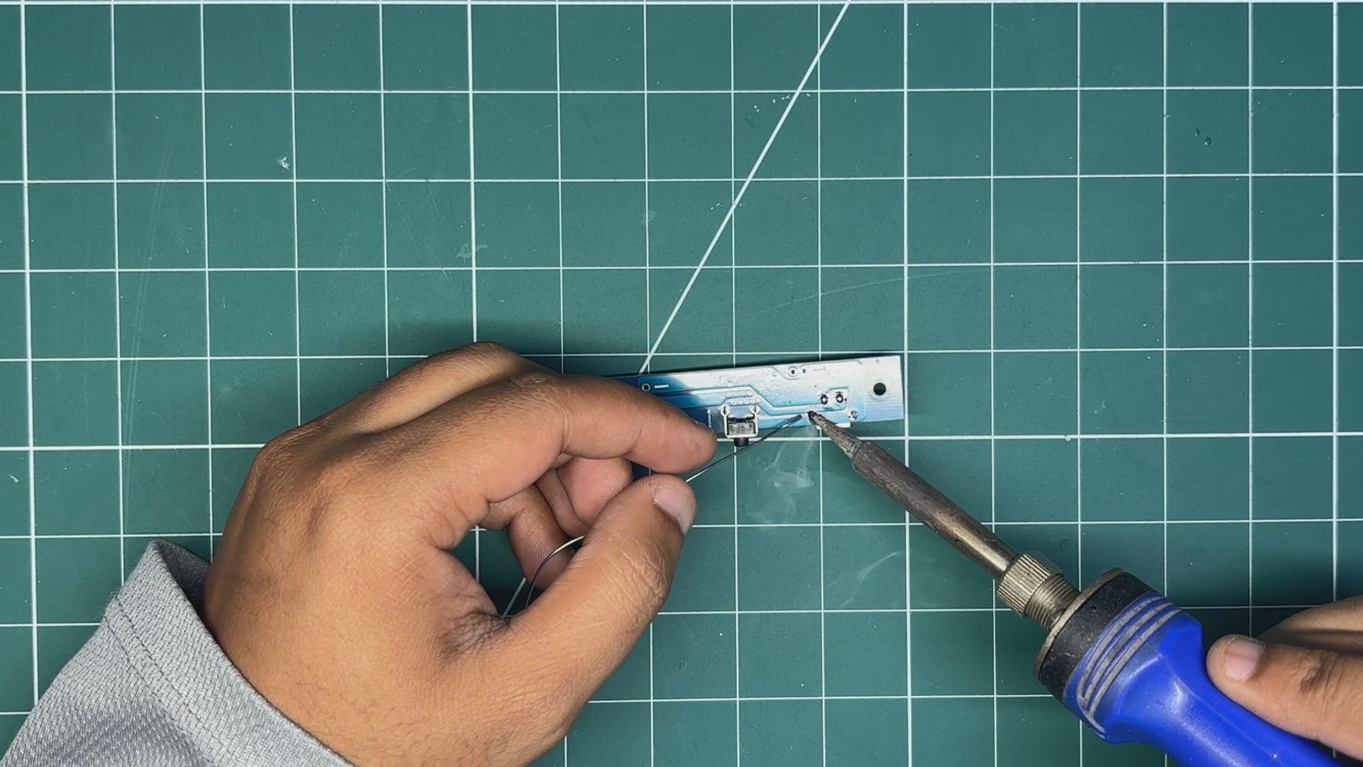

    • Next, we positioned every THT component, including the Type C port and the vertical push button, in their proper location. We place the Type C Port on the top side, but flip the position of the push button and place it on the bottom side. Using a soldering iron, both components are soldered in their position.

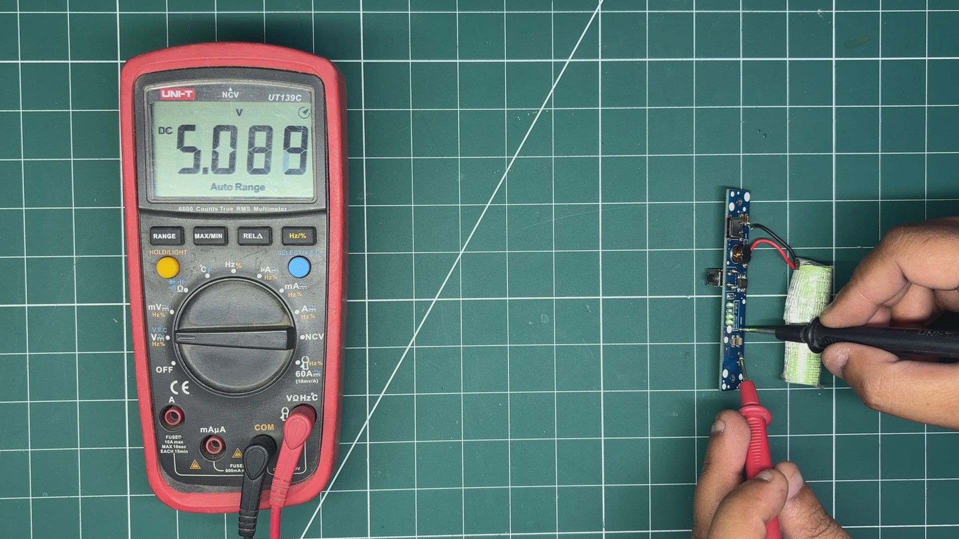

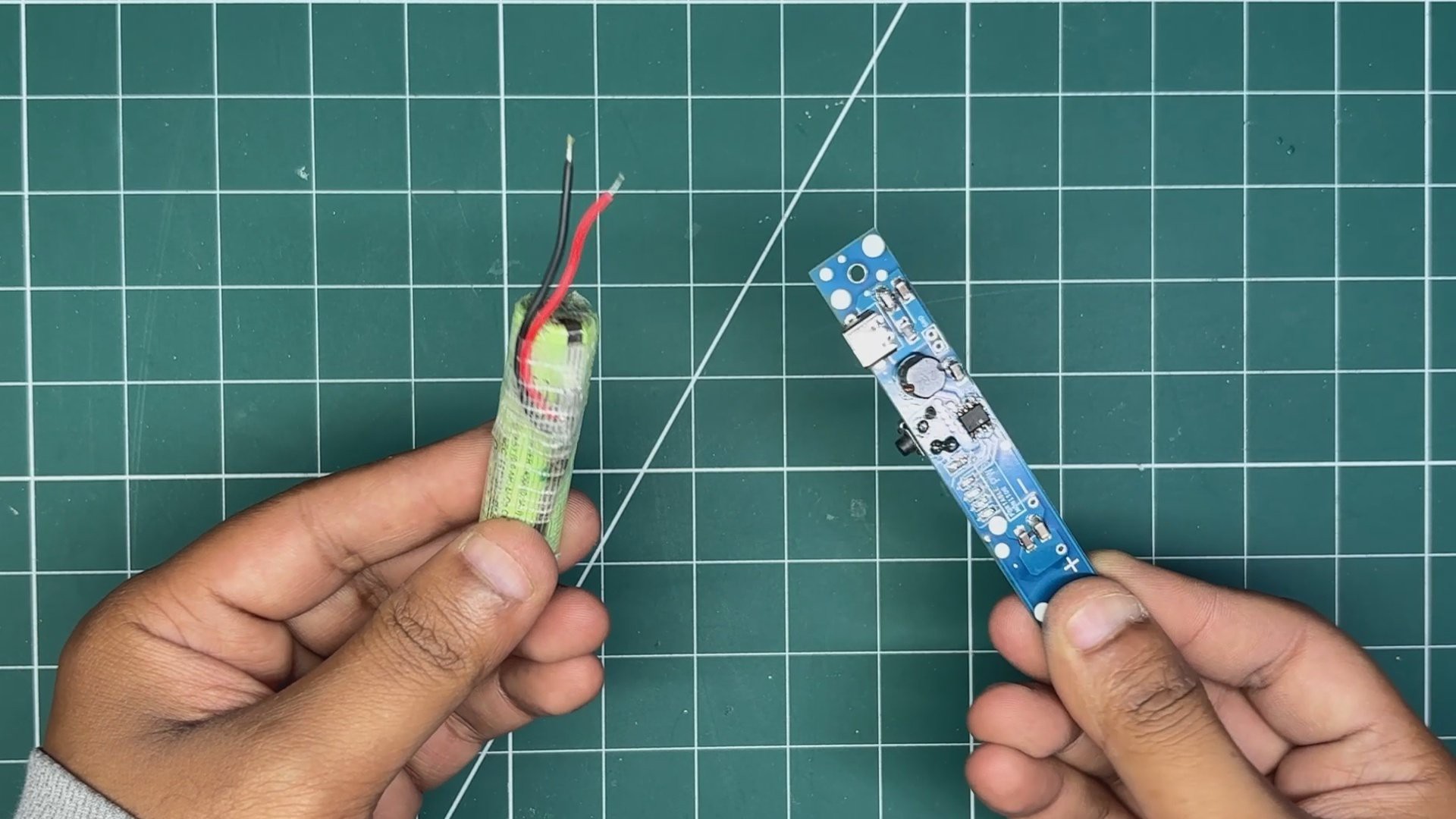

    POWER SOURCE
    For the power source of this project, we are using a lithium-ion cell, the 14500 form factor 3.7V 600mAh Li-ion cell, to be precise, which comes with a pre-installed PCM circuit. This PCM circuit protects the cell from overcharge and over-discharge, and it even provides short-circuit protection.
    • The cell’s B+ and B- are soldered to our power management board’s battery terminals using a soldering iron.
    • To test the setup, I used a multimeter, pressed the vertical button which turns ON the circuit, and we can see the indicator LED light up.
    • Using the multimeter, we can check the output voltage of the circuit, which measured a stable 5V, meaning the setup is working.
