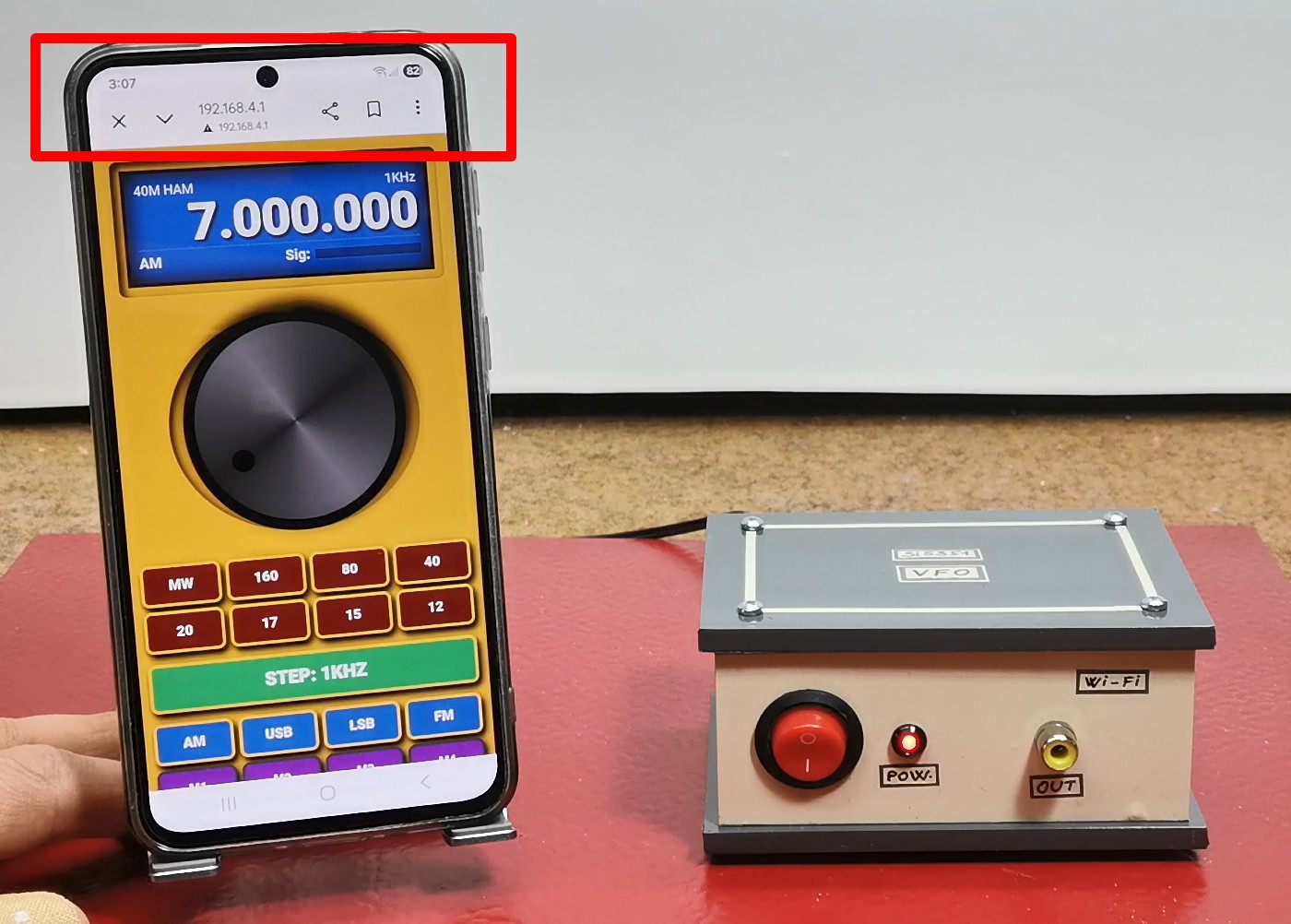

However, its manufacture is much simpler and cheaper, because we do not use a display, or even a rotary encoder, which is a basic part of every VFO. All this is achieved thanks to the use of a smartphone in the function of controlling and displaying the generated frequencies. Now the device is extremely simple and consists of only two inexpensive components: an ESP32 microcontroller board, and a Si5351 clock generator modulе which is connected to the ESP32 with only 4 wires.
The frequency is generated directly on the CLK0 output of the signal generator. Using a smartphone as a user interface (UI) instead of a classic LCD is a great way to get a graphically rich display without spending money on expensive touchscreens. The ESP32 is perfect for this because it has built-in Wi-Fi and enough muscle to simultaneously run a web server and communicate with the Si5351 via the I2C protocol.

  First, let me explain to you the method of starting and all the functions of this hybrid VFO. We turn on the hardware part and on the Smartphone we search for a Wi-Fi network (access point) with the name SI5351_VFO_Final_Complete.
Then we connect to that network with the password "vfo12345678". Now in the Web Browser we enter the address 192.168.4.1. By pressing enter, a mask of a professionally made instrument appears on the display. This image actually represents a web interface through which we will control the hardware. A great advantage is the fact that we do not install any application on the smartphone at all, but only open a web page.
Thus, there is no danger of introducing malicious software, and the compatibility with different smartphone models is unlimited, taking into account that the only requirement is to activate a web browser. By pressing the bottom of the display, fullscreen mode is activated and now the instrument is ready for operation. The LCD display shows the starting frequency, which is defined in the code. The upper left part of the screen shows the modulation type and the Band, and the lower left shows the step with which the frequency changes. At the very right bottom is the Signal Bar, which in a real...
