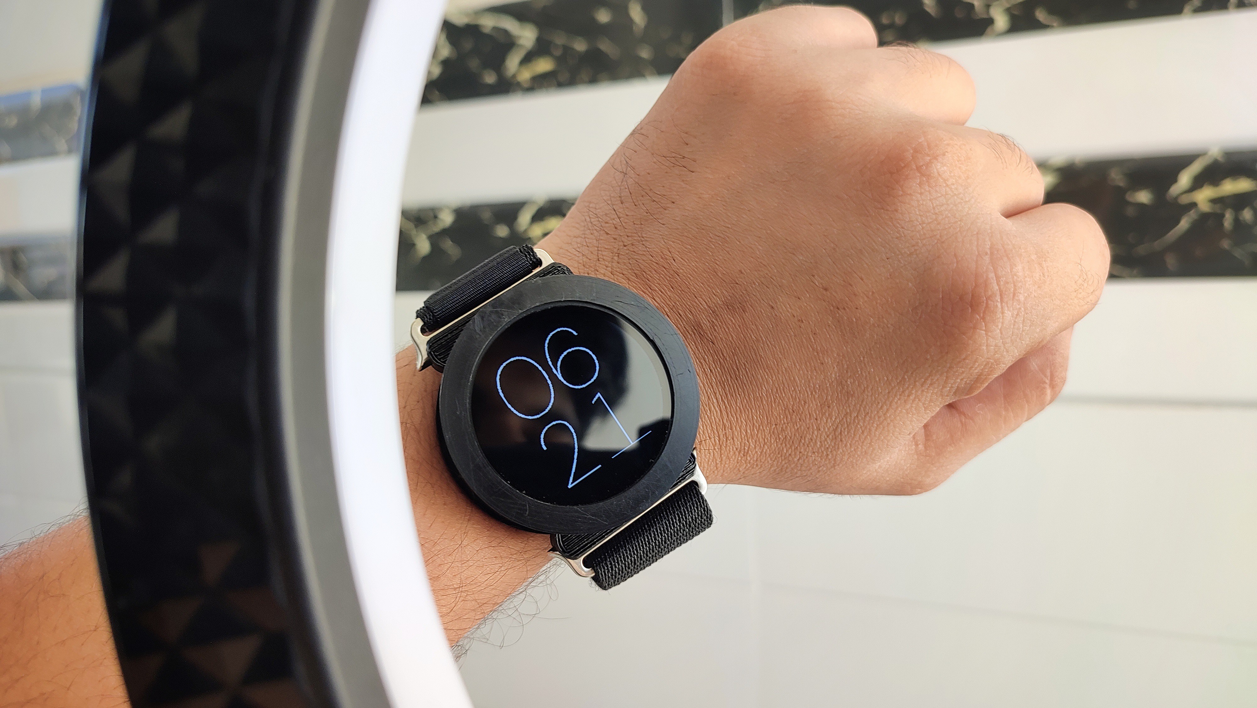

To make it more personal and stylish, I added multiple watch faces inside the device, allowing the look of the watch to match different moods, vibes, and environments. Whether classic, modern, or minimal, the ChronoWatch X2040 can adapt with a simple change of style.
For this project, I used a WaveShare RP2040 Round Touch Display, which became the heart of the ChronoWatch X2040. To give it the look and feel of a real wearable device, I designed a custom 3D-printed case using Tinkercad — a simple yet powerful software that makes 3D designing easy and accessible for creators of all skill levels.
The watch is not just about hardware; it also includes a fully functional settings interface. Users can easily adjust the time, date, and switch between 12-hour or 24-hour formats directly from the watch. It also comes with several useful features such as brightness control, a stopwatch, screen rotation options, and sleep timer settings for better battery management. Best of all, everything can be controlled through the touchscreen interface — no mobile app, no extra device, and no internet connection needed.

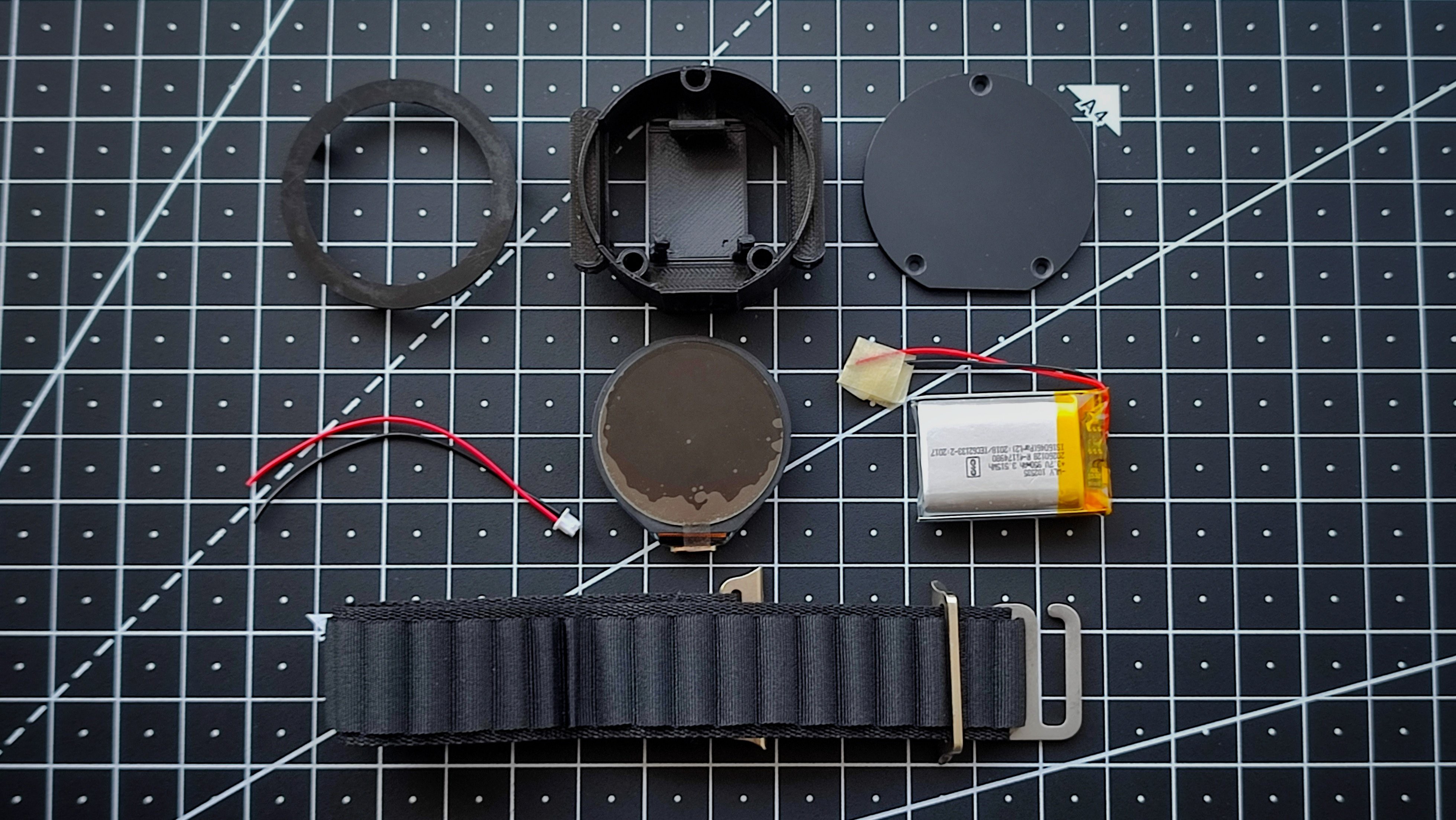

    COMPONENTS:
    1. Waveshare RP2040 Round 1.28-inch Touch Display (amazon.com / amazon.in)
    2. 3D Printed Case
    3. 3.7V 950mAh Lipo Battery (10mm X 25mm X 35mm) (amazon.com / amazon.in)
    4. M2 4mm screw (amazon.com / amazon.in)
    5. M2 heat inserts (amazon.com / amazon.in)
    6. MX1.25 2P connector (amazon.com / amazon.in)
    7. Heat Shrink Sleeve Tube [1mm] (amazon.com / amazon.in)
    8. Apple Watch Strap (amazon.com / amazon.in)
    TOOLS:
    1. Soldering Iron (amazon.com / amazon.in)
    2. Screwdriver (amazon.com / amazon.in)
    it is a compact development board based on the Raspberry Pi RP2040 chip. It features a 1.28-inch round capacitive touch screen with 240×240 resolution. The board includes built-in accelerometer and gyroscope sensors for motion detection. It supports programming with MicroPython, Arduino IDE, and C/C++. USB Type-C and battery charging support make it suitable for portable projects. It is ideal for DIY smartwatches, mini dashboards, and IoT devices.
    3D Printed Case
    The 3D case design was created in Tinkercad and is made of three main parts, each serving an important purpose. The middle section forms the main body of the watch and securely holds the display module, battery, and the attachment points for the watch straps. The top section works as a locking frame that fits over the front, keeping the display firmly in place so it does not fall out while also giving the watch a clean finished look. The bottom section is fixed with screws to close the back side of the watch securely, making the overall design strong, practical, and easy to open later for maintenance, upgrades, or battery replacement if needed.
    For this project, I chose a 3.7V 950mAh battery, which fits perfectly inside the custom back cover. This battery provides a good amount of backup time, allowing the user to wear the pendant for hours without worrying about frequent recharging. In the market, there are many types of lithium batteries available in different shapes, sizes, and capacities. So depending on your design, you may find a battery that fits even better, with either lower or higher capacity, to match your specific needs.
    M2 4mm screw & M2 heat inserts
    These are commonly used in 3D-printed parts to create strong, reliable, and long-lasting fastening points. The heat inserts are installed into the plastic using heat, which melts them into place and forms durable metal threads inside the printed part. Once installed, the M2 4mm screws fit securely into these inserts to hold components together firmly. They are ideal for small enclosures, electronics mounts, and compact mechanical assemblies like this watch project. This combination greatly improves strength, provides a professional finish, and allows repeated assembly or disassembly without damaging the 3D-printed parts.
    MX1.25 2P connector
    The MX1.25 2P connector is used to connect the battery to the board. The Waveshare ESP32-S3 round display comes with a built-in 1.25 2P male connector, so the battery needs a matching female connector attached. This makes it easy to plug the battery directly into the PCB without soldering every time. Using the proper connector ensures a secure and reliable connection while also making the battery simple to replace or upgrade in the future.
    A Heat Shrink Sleeve Tube (1mm) is a thin plastic tube that shrinks tightly when heated, usually with a heat gun or the side of a soldering iron. It is commonly used in electronics to cover and insulate exposed wires or solder joints, protecting them from short circuits and giving a cleaner look. For this project, the 1mm size is perfect for small battery wires and connectors. It not only improves safety but also makes the overall build look neat and professional.
    Apple Watch Strap
    The Apple Watch strap was used in this project to provide a comfortable, secure, and adjustable fit on the wrist. It gives the watch a modern and premium appearance while ensuring it can be worn comfortably throughout the day. The strap is lightweight, durable, and designed for long-term daily use, making it a practical choice for this build. Using a ready-made strap also saved time and effort compared to designing and manufacturing a custom band, while still giving the ChronoWatch X2040 a polished and professional look.

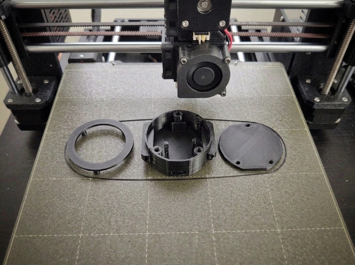

    Designing the Case in Tinkercad
    I designed a 3D-printed case for this watch to hold the battery, display, and the strap. The design was created in Tinkercad, an easy-to-use online 3D design tool.
    Design is made of three main parts, each serving an important purpose. The middle section forms the main body of the watch and securely holds the display module, battery, and the attachment points for the watch straps. The top section works as a locking frame that fits over the front, keeping the display firmly in place so it does not fall out while also giving the watch a clean finished look. The bottom section is fixed with screws to close the back side of the watch securely, making the overall design strong, practical, and easy to open later for maintenance, upgrades, or battery replacement if needed.
    3D files : https://www.tinkercad.com/things/bg3LTt8TSza-rp2040-wristwatch
  • 3
    3D Printing the Back Case
    Printing Details:
    1. Nozzle: 0.1 mm (for fine detail and smooth finish)
    2. Infill: 20>#/b### (strong yet lightweight)
    3. Material: ABS – Black (durable, heat-resistant, and gives a professional look
