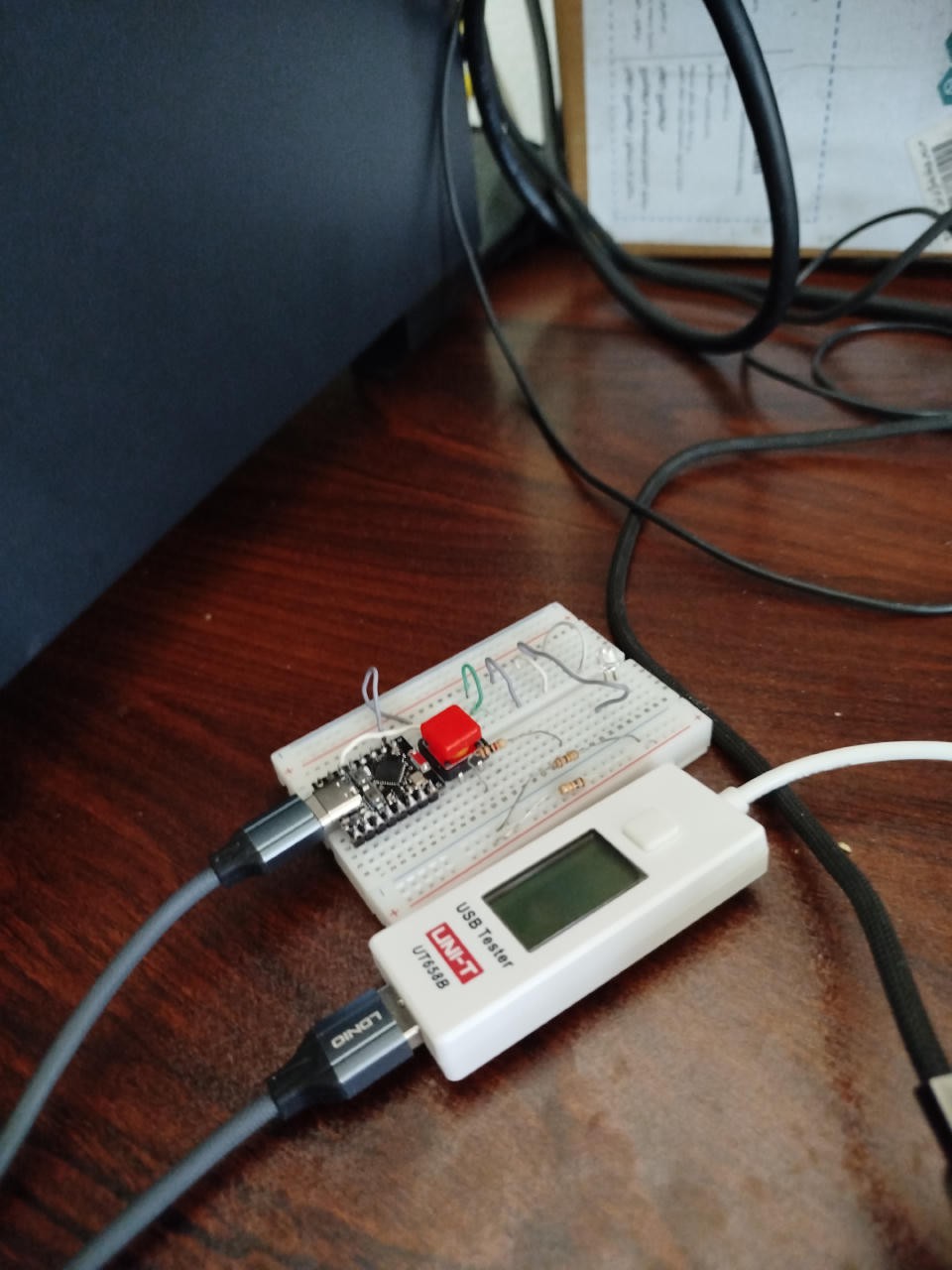

  • Tests with ESP32-C3 super mini dev board
    Farooq [Master Patata]06/01/2026 at 08:24 0 comments
    It has been sometime since the ESP32-C3 dev board has arrived. However, I was too lazy to spend like 3 days to write a test firmware. Fortunately, yesterday I found rmk, an open source keyboard firmware written in Rust. It's based on embassy and supports a variety of chips including C3.

    Using RMK, I created a tiny firmware with a single key:

    I flashed the firmware and it simply works. However, the power consumption is not very much satisfactory. I haven't got advanced equipment to monitor power usage. But the USB tester I've got shows 100 mA @ 5V. According to this, the board uses an ME6211 SOT23 But I'm just too lazy to calculate the efficiency...
    Since I want to use a Li-ion battery. This translates to like ~135 mA @ 3.7V. Given the space it has got inside, the battery which would fit is typically 300-600 mAh. So a we could have a 1H gaming session which is fine. Let's just call it a day and move forward!
