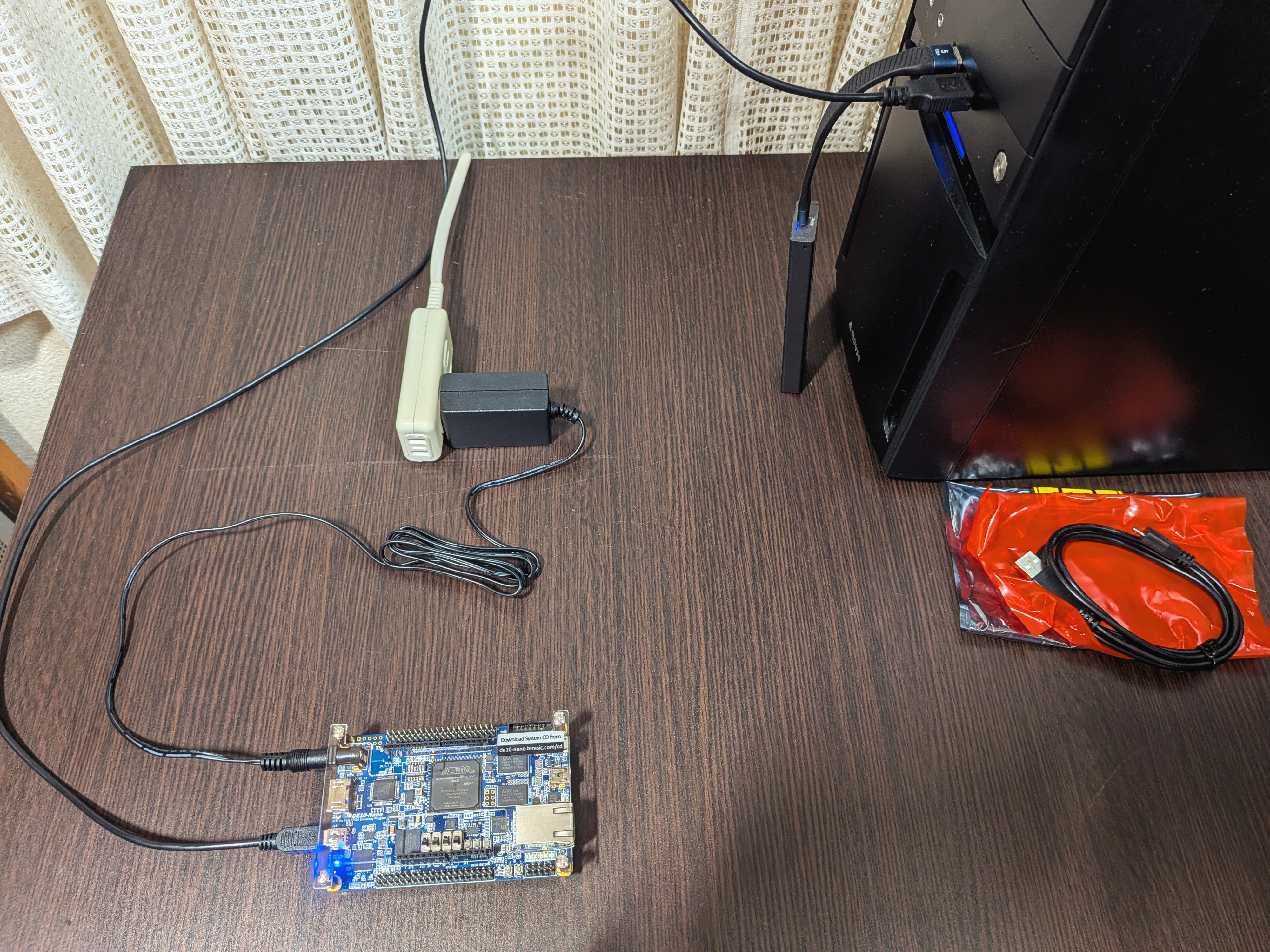

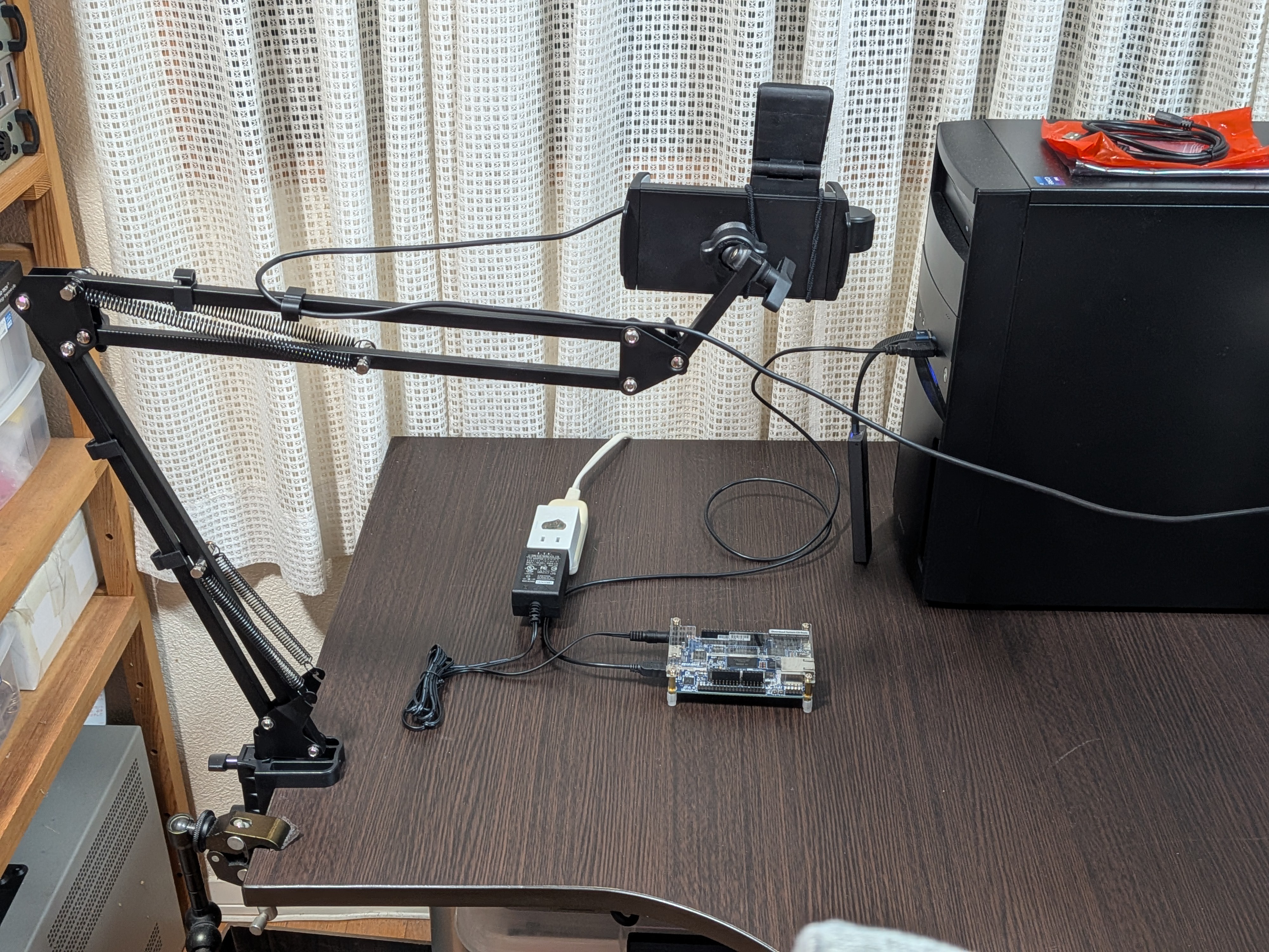

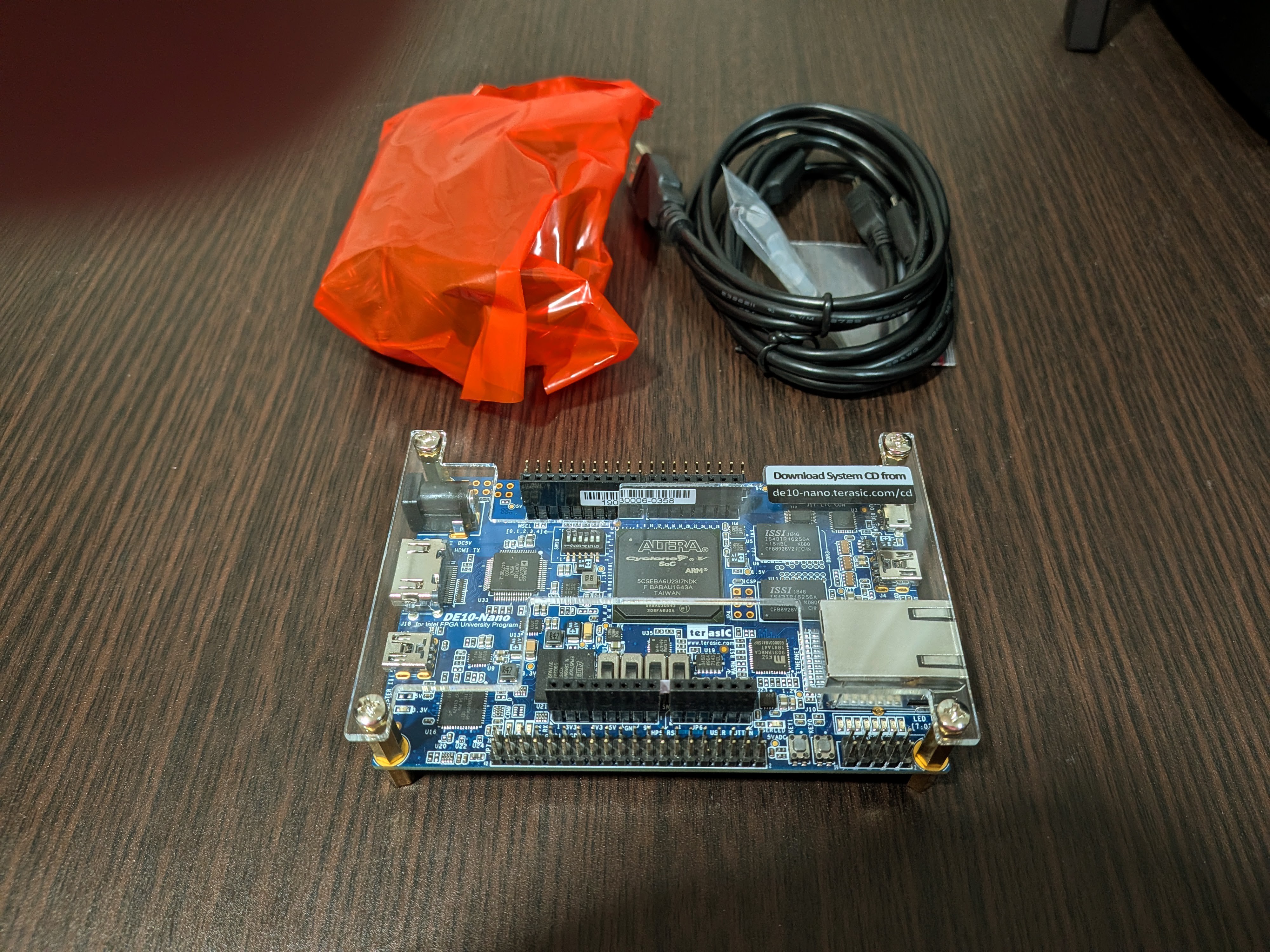

    1. DE10-nano Board
    2. DE10-nano Board Connection and Power On

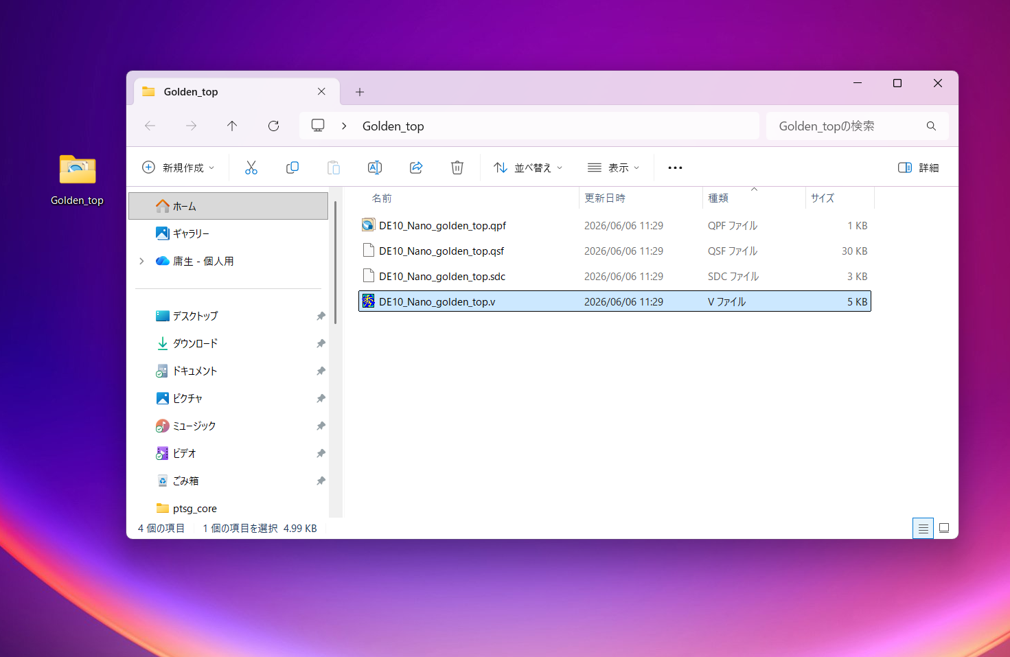

    3. DE10-nano Golden Top Sample Project

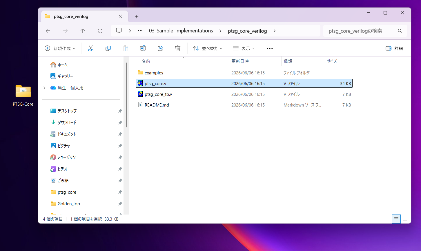

    4. PTSG-Core repository Layer3 Clone

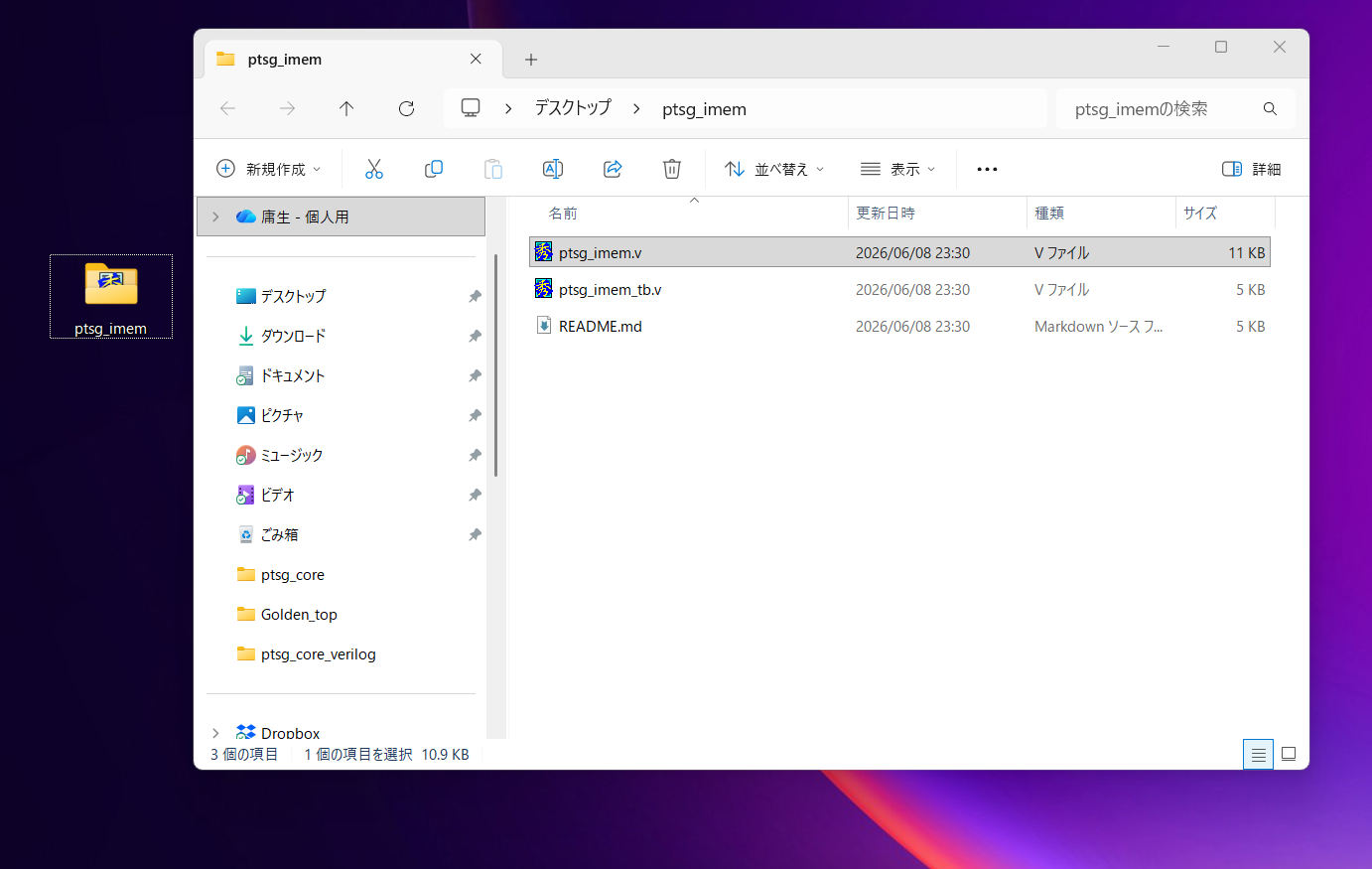

    5. PTSG-Memory wrapper
    6. And the shooting environment
