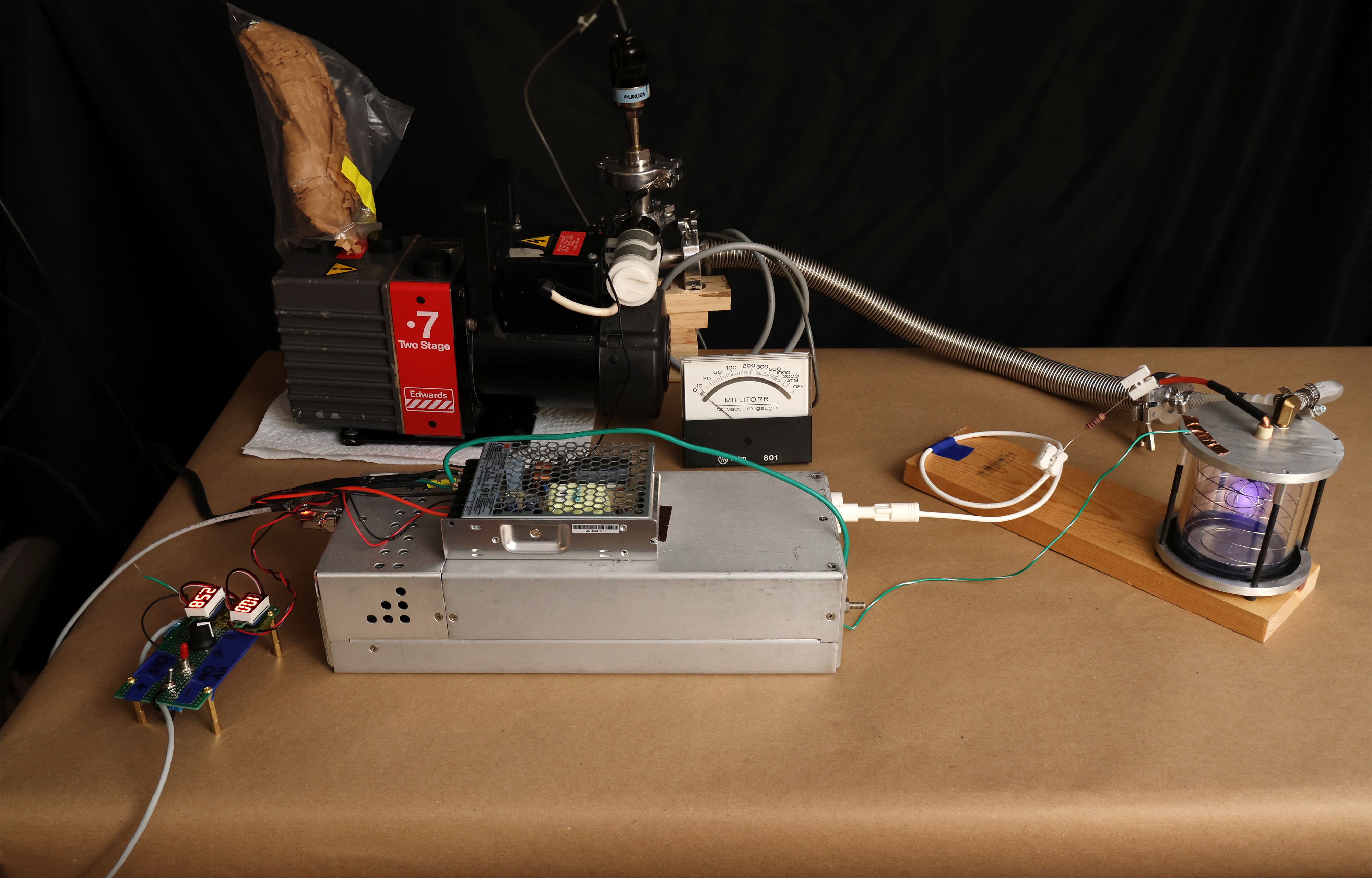

Working Result So Far:
This is a test fixture before finishing a PCB that mounts to the D-SUB connector, and has a LCD readout for scaled voltage. I'm also planning on putting a precision DAC on it to allow software control in the future if desired.
Short of the PSU running a Fusor:

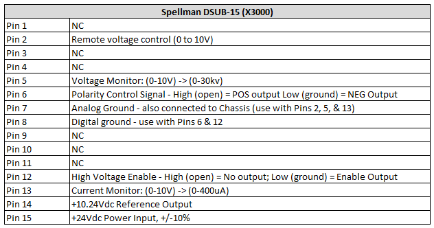

Pin-outs and Electrical:
I found some similar models online (TOF3000) with pin-outs listed, since there appears to not be a datasheet available for the X3000 model (most likely due to it being used in OEM products? Regardless, this appears to all be correct. The board images also show additional connections with de-populated components, so maybe this PCB is used for multiple products.

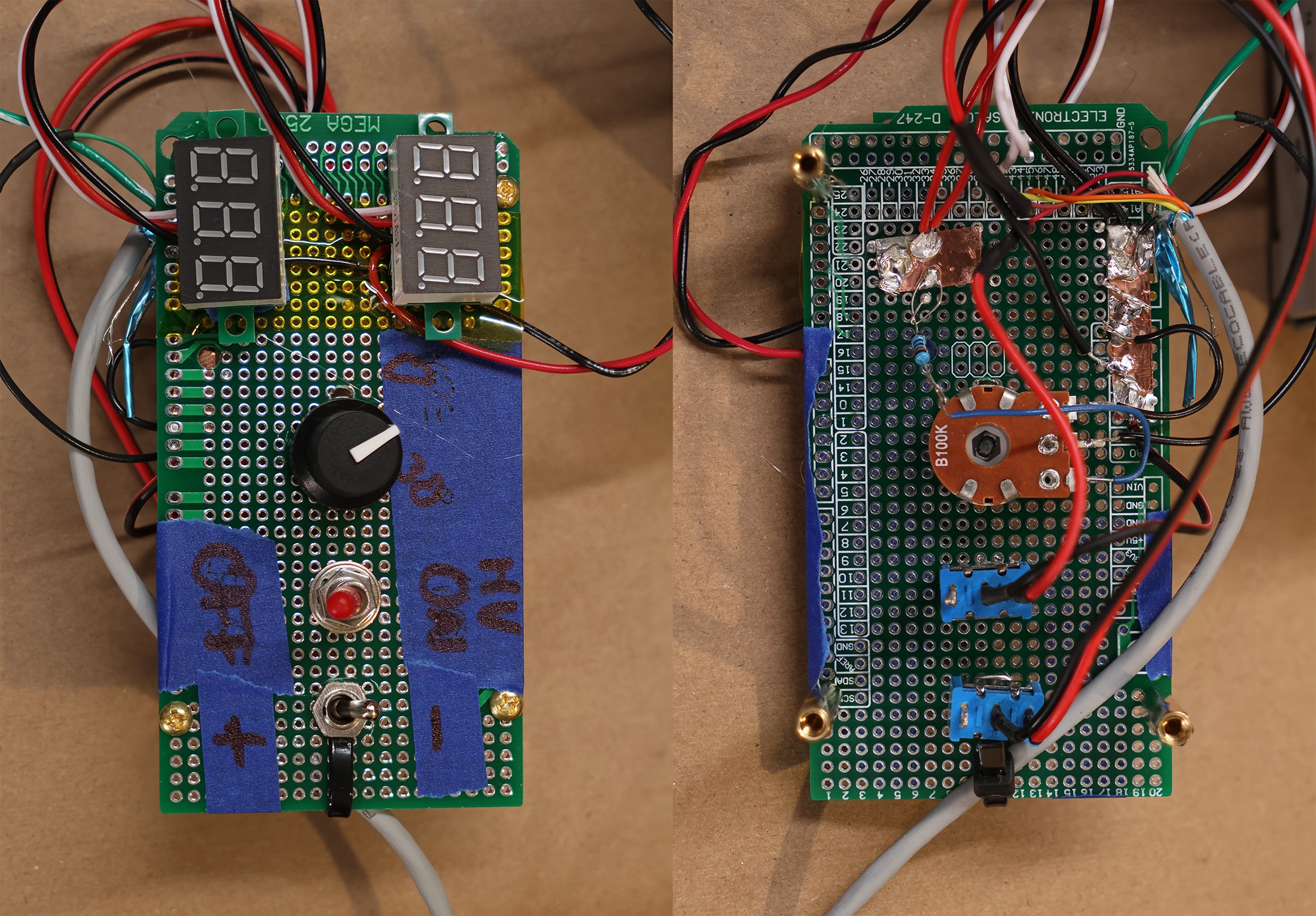

Basic Controller:

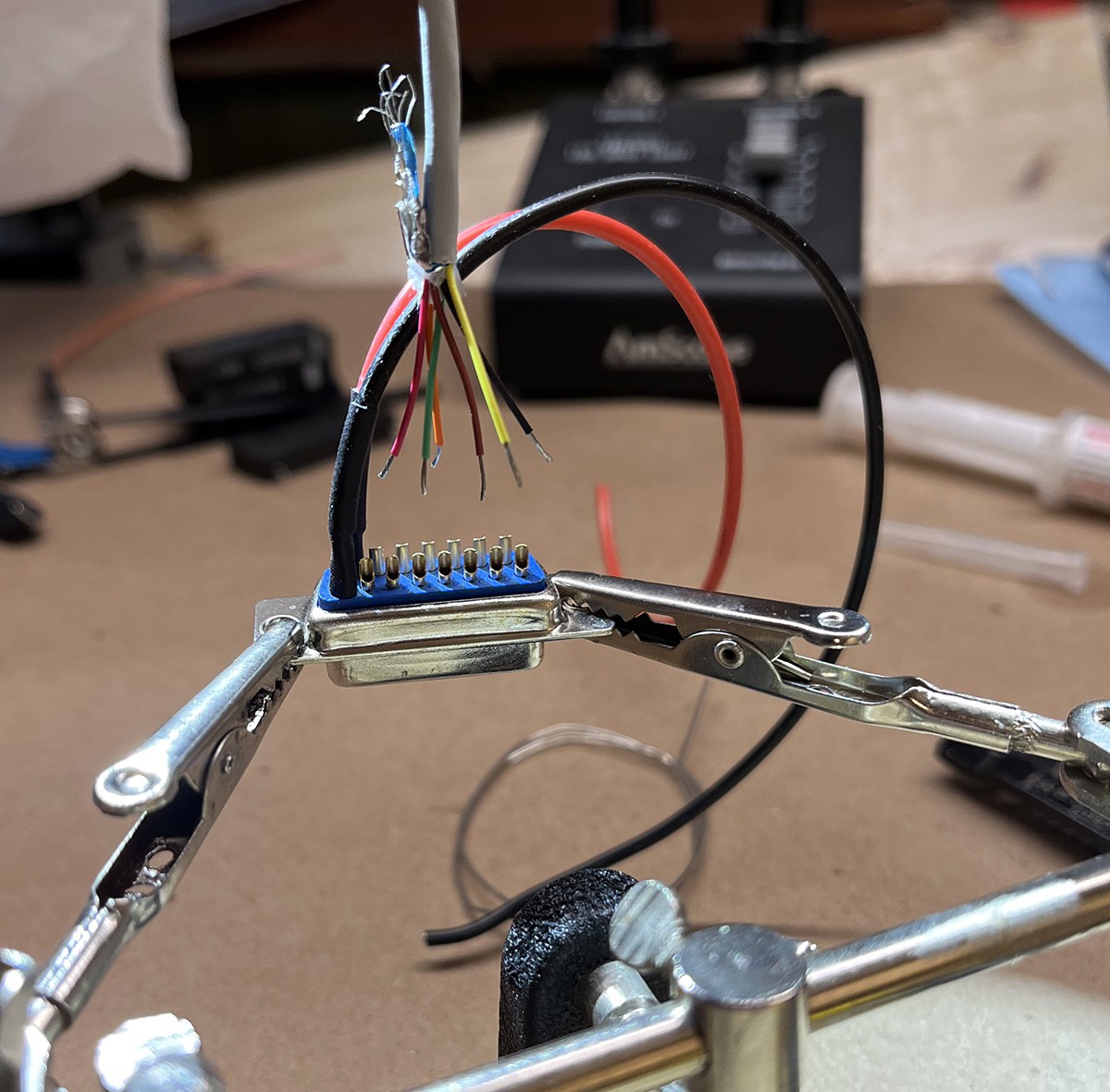

Before I make a custom PCB, I figured I should ensure the thing turns on... I soldered up a fairly formal looking SUB-D connector, and then soldered it onto a hastily thrown together perf-board.
Below, there is a polarity control, enable switch, and two cheap "voltage monitor" displays (for 0-10v current and voltage output.)
