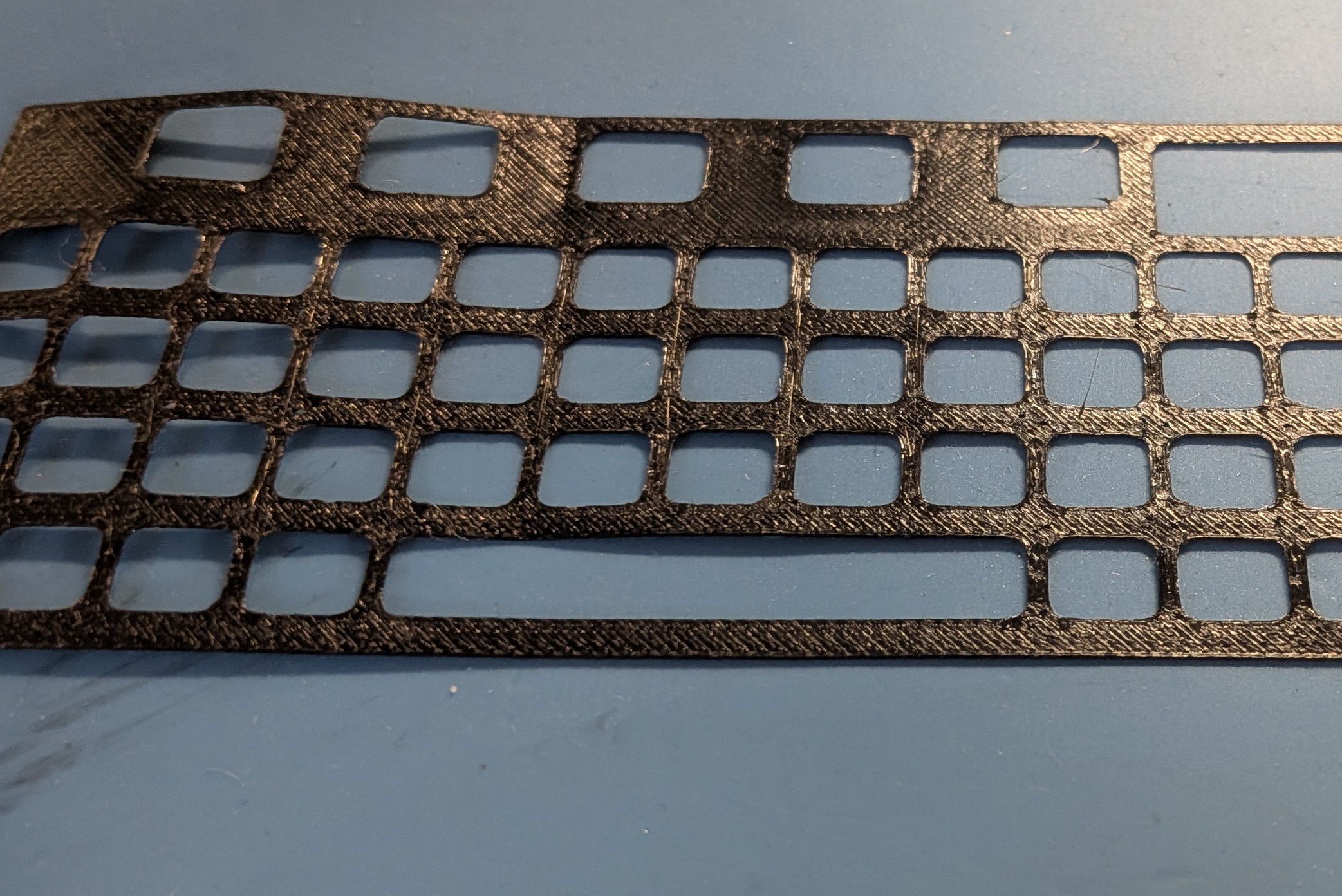

    The keyboard design was taken from the original Github repo and slightly modified for a good fit (after ordering the PCBs) and with a small border at the bottom to hold tight in the flexible frame. Files are available as STL.

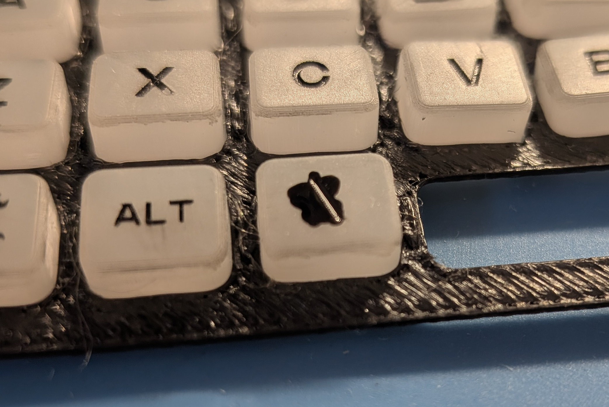

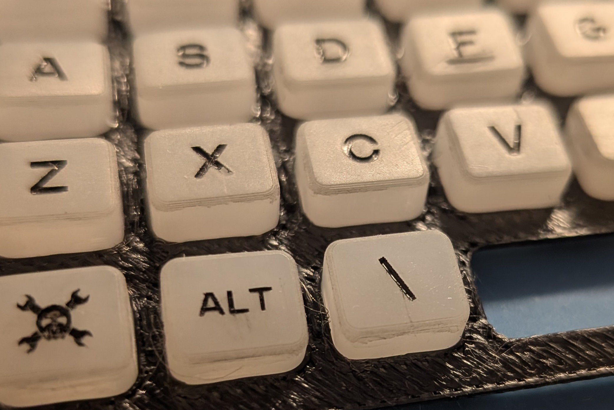

    The keys were resin-printed with a mix of white and transparent resin (approx. 80% transparent, 20% white). A paint marker pen was used to mark the letters in black.
     After drying for 1-2 minutes, the top surface was cleaned with IPA and the letter was clearly visible.
    It's not perfect, but in reality the imperfections are not visible, especially when the lights are on.
    The keys are hold together with a thin flexible TPU frame (FDM printed with 2 layers, 0.3mm).
