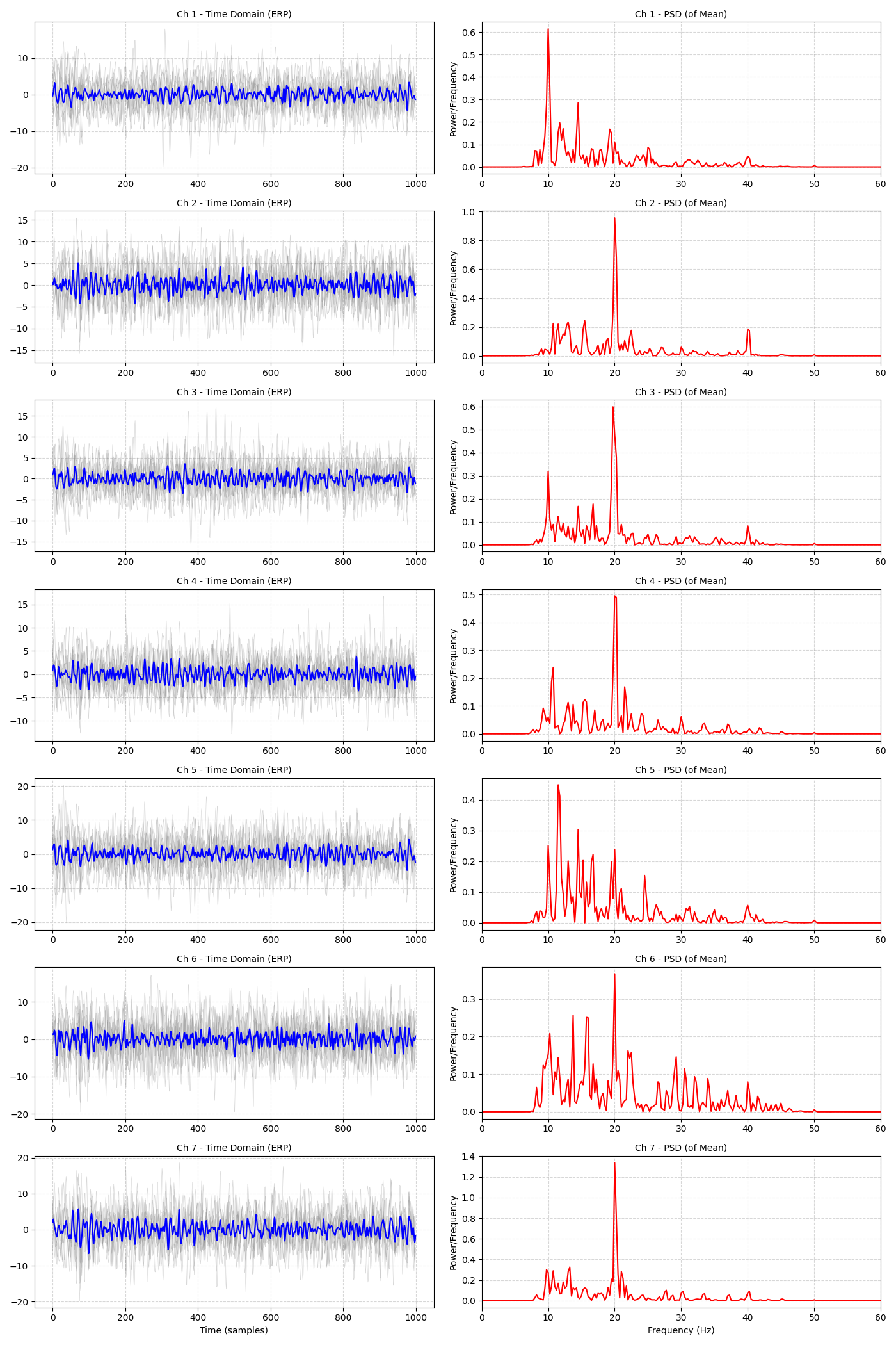

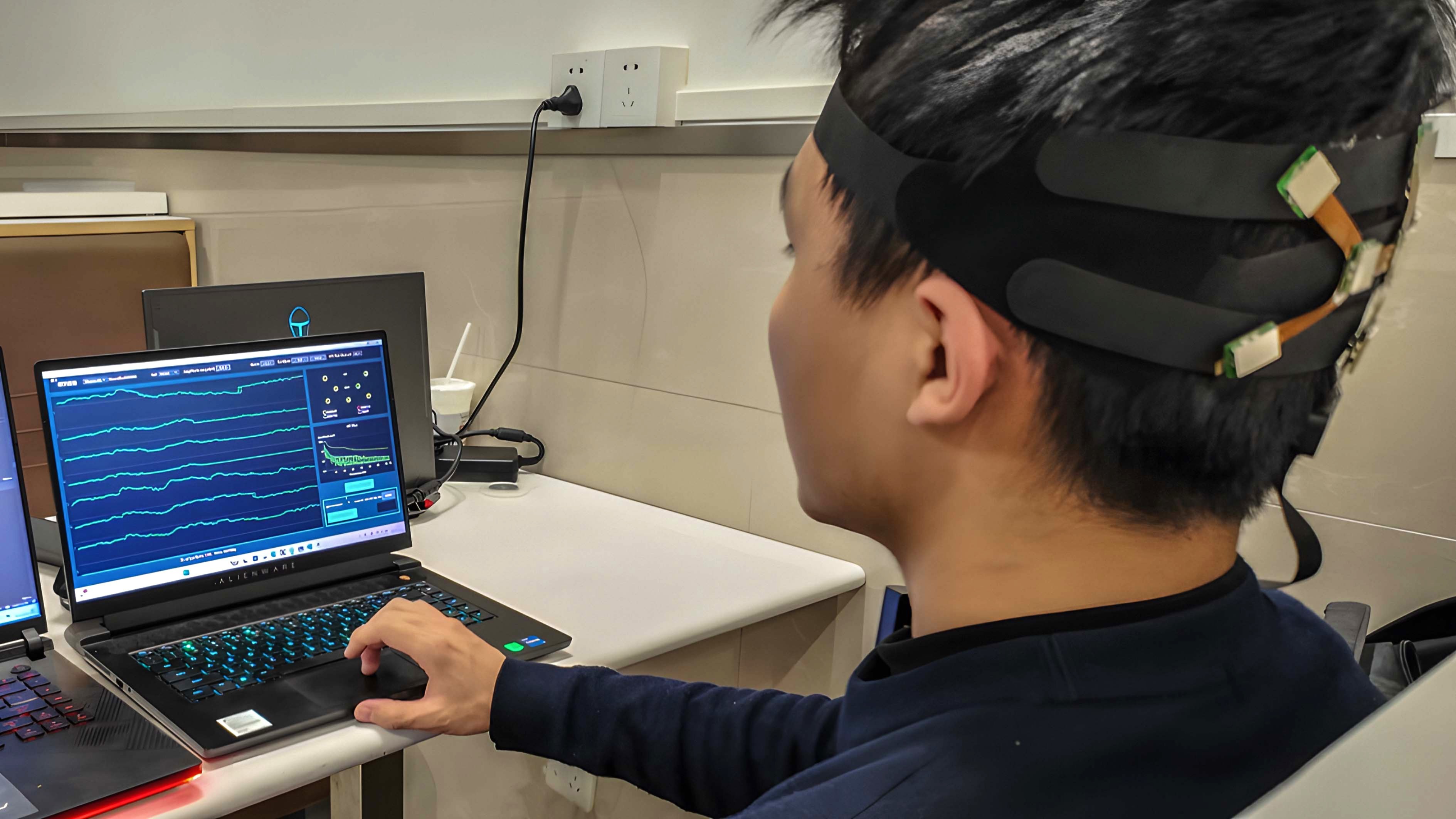

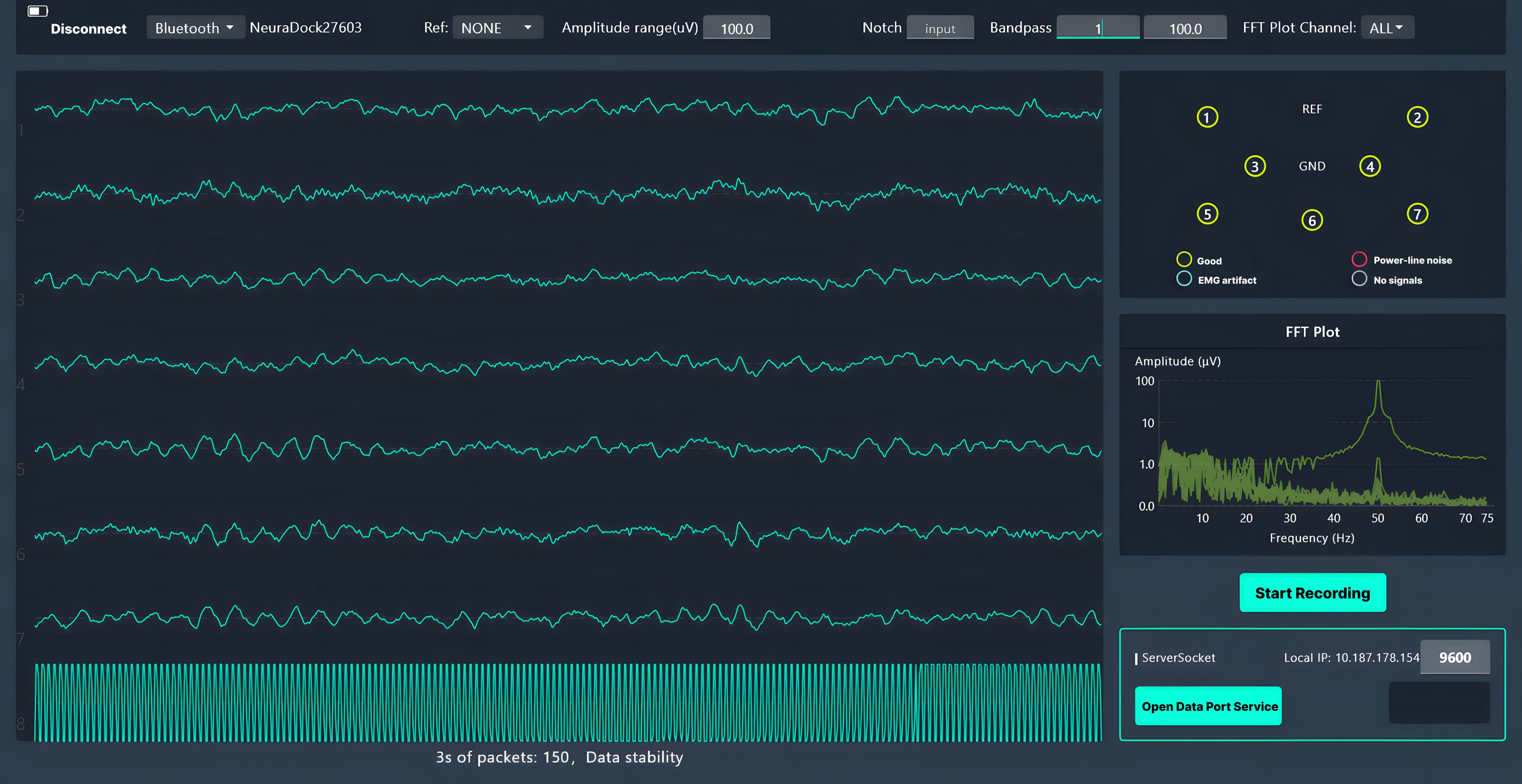

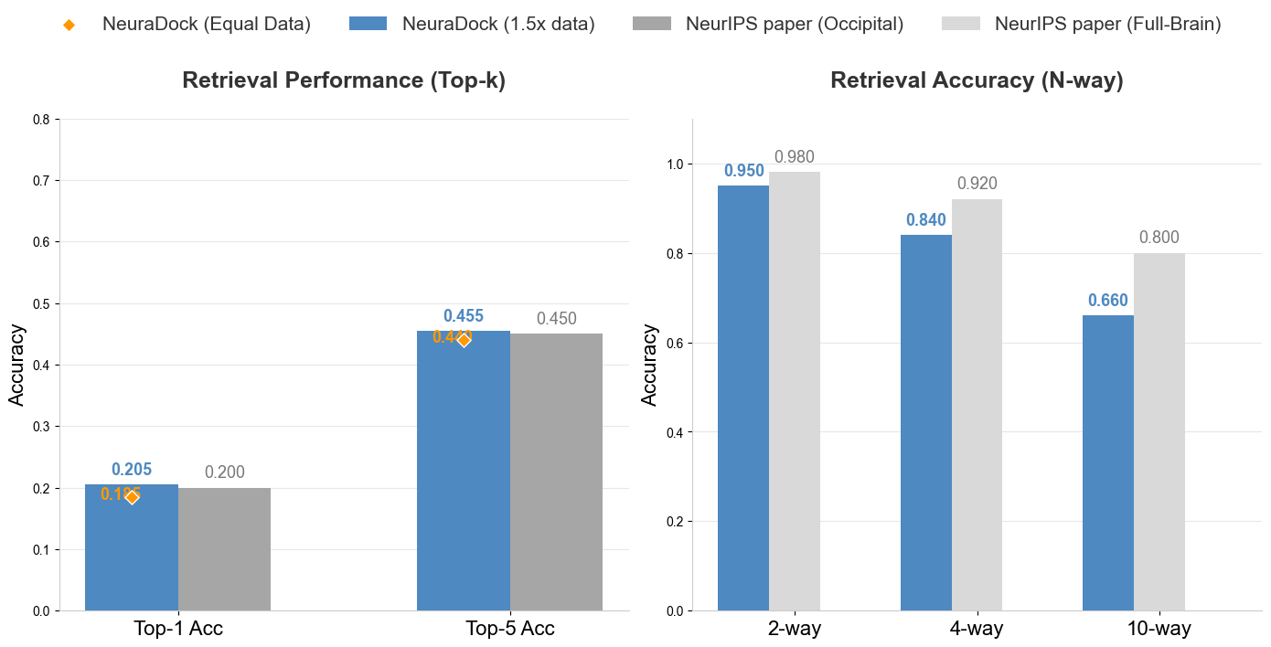

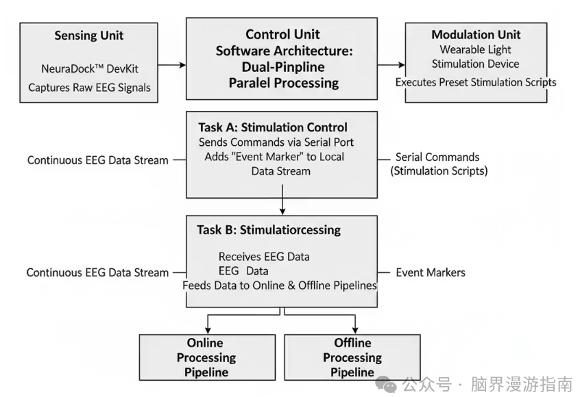

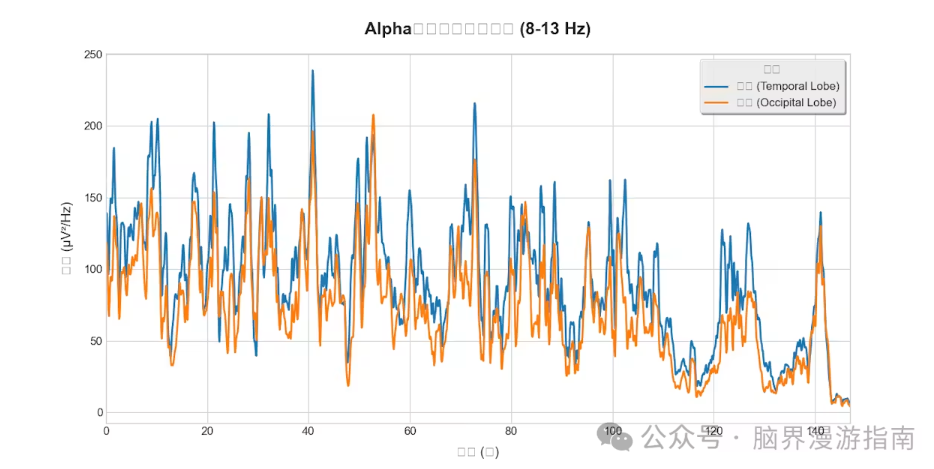

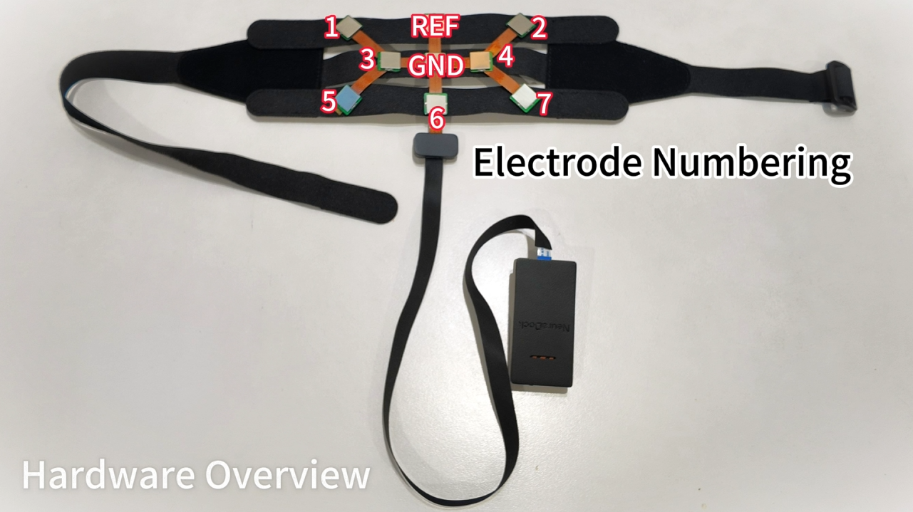

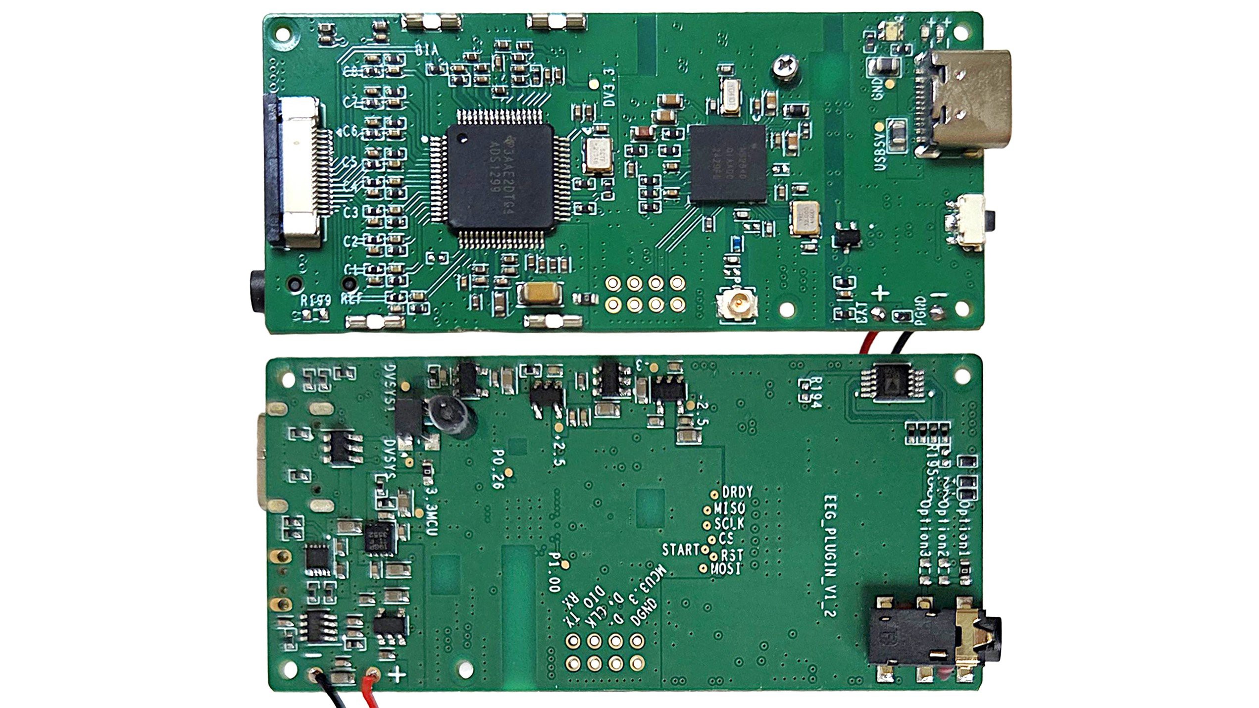

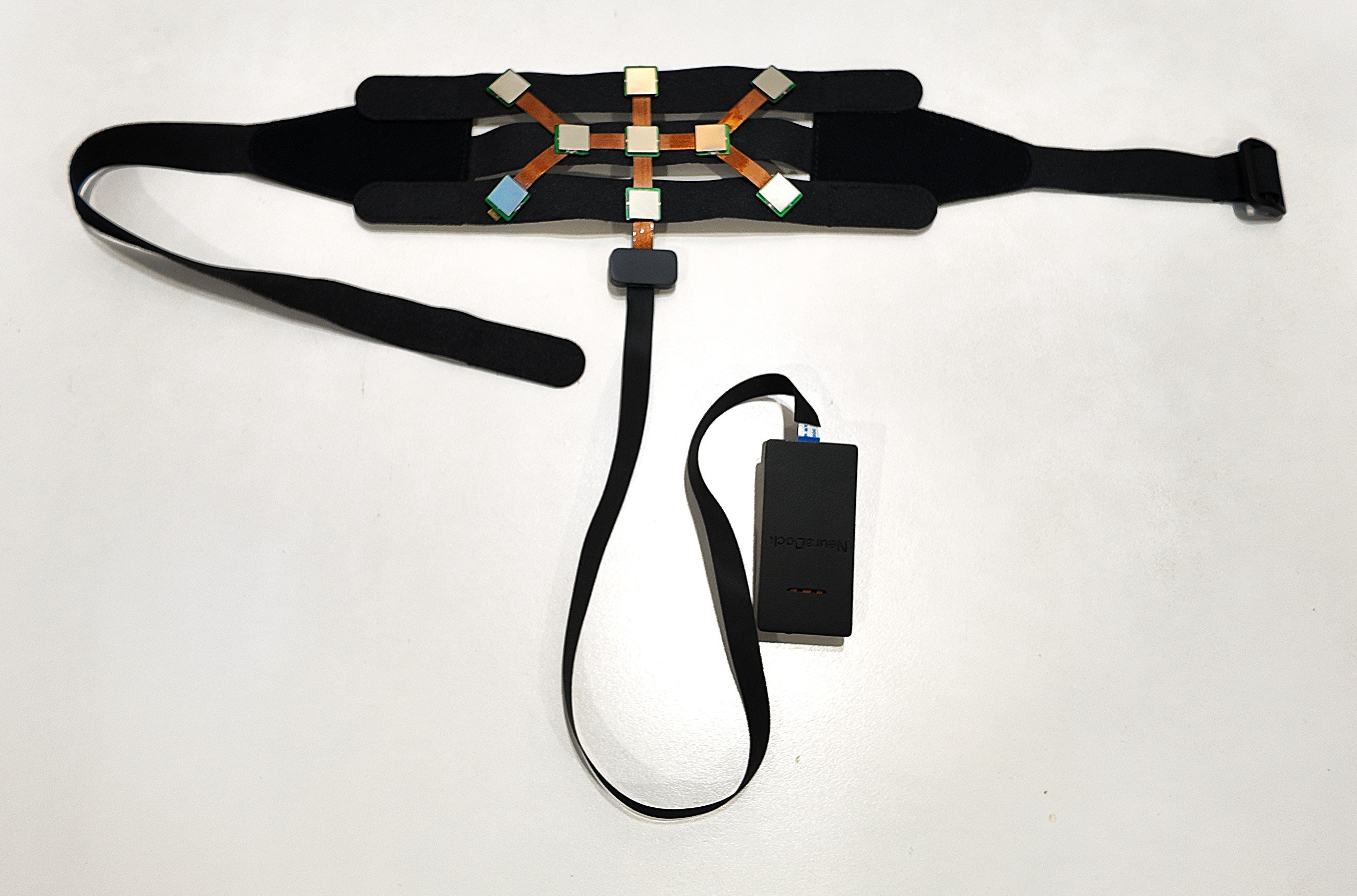

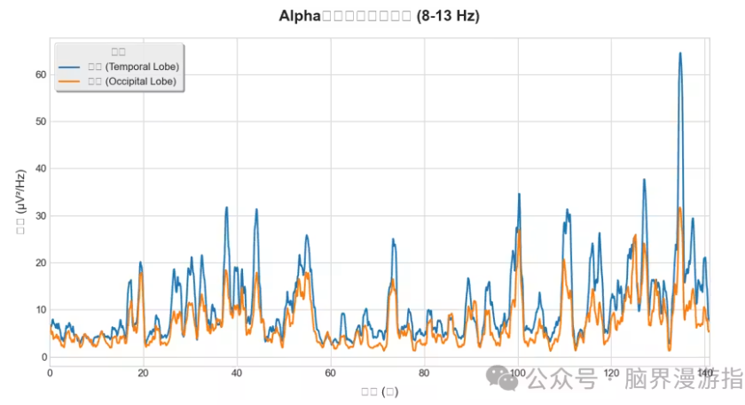

NeuraDock: A Hackable 7-Channel EEG Workstation
A 7-channel open-source EEG development kit that combines a dry-electrode headset, ADS1299 chip and AI agents
Public Chat
EEG is a powerful signal for neuroscience, BCI, HCI, XR, and AI communications, but building with EEG is still harder than it should be. NeuraDock is our attempt to make this workflow more accessible, transparent, and hackable. One of the most noval parts of NeuraDock is the Agent-assisted workflow. For example, a user could ask:"Detect user brain states between eyes-open and eyes-closed conditions." The agent can help build a workflow such as: Import EEG data → compute bandpower → segment eyes-open/eyes-closed periods → generate plots and a short report. The idea is not to hide the signal processing, but to make it easier to generate, inspect, modify, and reproduce IIf you are interested in following the launch, our Crowd Supply pre-launch page is here: https://www.crowdsupply.com/neuradock/neuradock-eeg-workstation
NeuraDock is built for people who want to work directly with EEG data without spending most of their time assembling hardware or writing low-level signal-processing code. It is used by neuroscience researchers, HCI designers, AI engineers, and XR or game developers who want to prototype with brain signals quickly.
A typical project might start with an idea for brain-driven interaction or an experiment using EEG signals. With many existing tools, developers first need to configure hardware, check electrode contact, set up data streaming, and write preprocessing code before they can test anything meaningful. NeuraDock shortens this path by providing a ready-to-use hardware setup and a workflow that helps move from raw signals to usable data more efficiently.
In practice, this means faster iteration. A team can put on the headset, verify signal quality, record data, and begin analysis or application development without rebuilding the same pipeline for every project.
One key challenge in EEG work is the gap between ideas and implementation. Designing a custom feature or metric often requires writing and debugging complex signal-processing code. With NeuraDock, users can describe tasks such as filtering signals, extracting bandpower, or generating visualizations, and the system assists in building the required pipeline. This turns what is often a time-consuming process into a faster and more accessible workflow.
NeuraDock is especially useful in early-stage prototyping, where flexibility and speed matter. It supports use cases such as:
  • Brain-computer interface research and experiments
  • EEG-based interaction and interface design
  • XR, game, and spatial computing prototypes
  • Machine learning experiments with biosignals
  • Neurofeedback and cognitive-state visualization
  • Maker projects requiring raw EEG access
Features & Specifications
Key Features
  • 7-channel EEG acquisition for BCI and biosignal prototyping
  • Dry-electrode headset for fast setup and repeatable placement
  • Direct access to raw multichannel EEG data
  • Bluetooth Low Energy (BLE) and USB Type-C connectivity for real-time streaming
  • Modular architecture for integration into custom hardware and wearables
  • Real-time signal inspection for checking data quality during recording
  • Companion software for recording and data access
  • Agent-assisted workflow for signal processing, feature extraction, and visualization
Hardware Specifications
ParameterSpecification
EEG Channels7 channels
Analog Front-EndTexas Instruments ADS1299
ADC Resolution24-bit
Sampling Rate250 Hz
Input-Referred Noise< 1.5 μV p-p
CMRR110 dB
Electrode TypeDry electrodes
Electrode LayoutO1, O2, Oz + PO3, PO4, CP5, CP6
ConnectivityBluetooth Low Energy (BLE), USB Type-C
WirelessNordic Semiconductor nRF52840
BatteryRechargeable Li-ion
Battery Life~6 hours continuous streaming
Software and Workflow
  • Companion application for recording and exporting EEG data
  • Real-time signal visualization for monitoring signal quality
  • Data export for integration with Python, MATLAB, and common EEG toolchains
  • Agent-assisted workflow for generating analysis pipelines from natural language prompts
  • Local processing architecture — EEG data remains on the user’s machine
Open Source
NeuraDock is designed as an open and developer-friendly platform, with key parts of the system made available for customization, research, and integration.
We plan to provide the following resources:
  • Hardware schematics and PCB design files
  • Mechanical CAD files for the headset and enclosure
  • Core software components, including the Python SDK
  • Documentation for data communication and integration
Licensing:
  • Hardware design files: CERN-OHL-W
  • Mechanical CAD files: CC BY-SA 4.0
  • Software (SDK and tools): MIT License
All resources will be published on our GitHub repository. We welcome contributions from the community, including software improvements, new analysis workflows, and hardware adaptations.
  • Open-Loop Alpha Monitoring with Light Stimulations
    Neuradock0015 days ago 0 comments
    What We Built
    This week we put together an open-loop alpha monitoring workflow using the NeuraDock EEG Workstation (7-channel dry-electrode) paired with a wearable light stimulation device.
    The idea is simple: run a predefined light stimulation script while recording EEG in real time, then inspect how the brain responds. No closed-loop feedback yet — just clean observation, solid data, and a dual-pipeline setup that gives us both live process monitoring and deep offline analysis.
    System Architecture
    Three units, one stream, two pipelines:
    UnitRole
    SensingNeuraDock — 7-channel dry EEG, posterior visual-area focus
    ModulationWearable light stim — runs preset scripts
    ControlSoftware layer — sends commands, records event markers, splits EEG into two analysis paths
    The key design choice: One EEG stream feeds two pipelines simultaneously.
    • Online pipeline → real-time alpha trend dashboard (process monitoring, not diagnosis)
    • Offline pipeline → post-session power, coherence, and asymmetry analysis
    This split lets us validate the experiment while it runs and still dig deep after the session ends.
    Online Pipeline: Real-Time Alpha Trend
    During the session, we visualize an alpha-related proxy metric live. Think of it as a flight dashboard — it won't tell you the full story, but it immediately tells you if the session is behaving as expected.
    We treat this as a process-monitoring signal, not a clinical endpoint. If the trend flatlines when it shouldn't, we know something is off with the hardware or the subject's state before we waste a full session.
    Offline Pipeline: The Real Work
    After the session, we analyze three conditions side by side:
    1. Eyes open (baseline)
    2. Eyes closed (natural alpha rebound)
    3. Eyes closed + light stimulation (target condition)
    Metrics we ran:
    • Alpha power — standard bandpower inspection across conditions
    • Alpha-band coherence — phase consistency between channel pairs; higher coherence = more synchronized oscillation
    • Hemispheric alpha asymmetry — log(right α) - log(left α) as an exploratory feature
    In our single-session demo, the stimulation condition showed stronger alpha-band synchronization in selected posterior channel pairs. We’re not calling this a therapeutic result — it’s an exploratory workflow for linking stimulation protocols to measurable EEG dynamics.
    offline alpha power analysis: eye open
    offline alpha power analysis: eye close
    Why Open-Loop First?
    Everyone wants closed-loop neurofeedback. But before you close the loop, you need to answer a more basic question:
    What EEG changes actually show up when you apply a predefined stimulation script?
    Open-loop monitoring is the honest first step. It lets us:
    • Observe stimulation-associated EEG changes without confounding feedback effects
    • Verify that the experiment protocol runs as designed
    • Record clean, marker-aligned raw data for future model training
    • Build the data foundation that closed-loop systems actually need
    What We Learned
    • Dry EEG + event markers work. The 7-channel posterior setup captures usable alpha dynamics without gel or prep.
    • Dual-pipeline is the right split. Real-time dashboard prevents bad sessions; offline analysis extracts the science.
    • Coherence is sensitive to stimulation. In our demo, light stimulation during eyes-closed showed elevated alpha-band coherence between selected channels — worth expanding with more subjects and controlled protocols.
    • Asymmetry is exploratory. Interesting, but interpretation-heavy. We keep it in the offline toolbox, not the live dashboard.
    Limitations (We're Honest About This)
    This is an exploratory demo, not a clinical validation. Single session, no statistical power, no therapeutic claims. What we proved is the workflow — not the therapy.
    To move from "interesting demo" to "validated protocol," we need: more participants, repeated sessions, sham controls, and proper statistical testing.
    What's Next
    We're stacking more workflows on this foundation:
    • SSVEP and motor imagery pipelines ...
  • Motor Imagey Paradigm Demo
    Neuradock0017 days ago 0 comments
    We’ve been obsessed with a question: Can we decode motor imagery without asking the user to "just imagine" moving their hand? Traditional MI-BCI suffers from one brutal flaw — it relies on the user’s willingness and ability to produce clear motor imagery, which many patients (especially post-stroke) struggle with.
    So we built a hack. Instead of going directly after the motor cortex, we’re piggybacking on the dorsal visual stream — the brain’s "Where/How" pathway that processes visual motion and spatial planning. By tracking how the occipital and temporo-parietal areas respond to a falling ball visual stimulus, we can infer motor intent indirectly. Here’s how we wired it up.
    The Neuroscience Hack
    The dorsal stream runs V1 → V5/MT → posterior parietal cortex (SPL/IPL) → premotor cortex. When a patient watches a ball fall and receives a "grasp" cue, this whole highway lights up:
    StageRegionWhat It DoesOur Electrodes
    Visual inputV1 (Occipital)Processes motion stimulusO1, O2, Oz
    Motion/spatial planningSPL/IPL (Parietal)Integrates visual space + motor intentvia coherence analysis
    Attention relayTPJ (Temporo-parietal junction)Coordinates visual attention & motor prepT5, T6
    Our 7-channel layout (O1, O2, Oz, T5, T6, plus references) spans the occipital → temporo-parietal segment of the dorsal stream. We’re not reading motor cortex directly — we’re sniffing the traffic on the visual-motor integration highway.
    The Experimental Paradigm
    We designed a 3-phase trial that forces the brain into the right state without relying on the user’s "imagination discipline":
    表格
    TimePhaseVisual StimulusUser StateEEG Purpose
    0.0–2.0 sBaselineBall falls, no flashingRelax, passive watchREST reference
    2.0–4.0 sMotor ImageryBall flashes as it nears the handActively imagine graspingERS + coherence features
    4.0 s+FeedbackRobotic hand moves or animation playsRelax / observeBackup data
    Why this works:
    • 0–2s: The moving (but non-flashing) ball pre-activates the visual pathway. We use this as a within-trial baseline — no more fighting individual alpha differences across sessions.
    • 2–4s: The flashing ball at "grasp distance" triggers instinctive motor anticipation. The user doesn’t have to "try" to imagine — the brain prepares to grasp automatically. This is the hack: we hijack the visual affordance of a falling object to force motor planning.
    • Net task duration: 1.8s (minus 200ms VEP onset transient). At 250 Hz, that gives us 450 clean samples per trial.
    The Algorithm
    We use a two-stage pipeline to extract intent from this visual-motor traffic:
    Stage 1: SSVEP-Driven ERS
    We measure Event-Related Synchronization (ERS) during the MI phase relative to baseline. The flashing ball drives SSVEP in the occipital channels, and we track how alpha-band power changes as the dorsal stream engages.
    Stage 2: Cross-Channel Coherence (Alpha & Beta)
    We compute spectral coherence between electrode pairs to track information flow along the dorsal stream:
    表格
    Electrode PairDirectionBandNeural Meaning
    O1 – T5Left dorsal streamAlpha (8–13 Hz)Left visual → temporo-parietal activation
    O2 – T6Right dorsal streamAlpha (8–13 Hz)Right visual → temporo-parietal activation
    Oz – T5Midline → left temporalAlpha (8–13 Hz)Bilateral convergence
    Oz – T6Midline → right temporalAlpha (8–13 Hz)Bilateral convergence
    For single-trial power spectra, we use Welch’s method — more stable than raw FFT for our short 1.8-second windows.
    What’s Next
    This paradigm is currently running on our 7-channel NeuraDock hardware. The next log will cover the real-time implementation: how we pipeline the 250 Hz stream through a lightweight online classifier, and whether we can hit <500ms latency from flash onset to intent detection.
    We’re also exploring whether adding a beta-band (13–30 Hz) coherence layer can separate "true motor planning" from pure visual attention — but that’s for the next hack.
    Questions? Want to replicate this? Our EEG workstation examples are on GitHub released very soon:https://github.com/Neuradock...
  • SSVEP Paradigm Demo with Data Processing
    Neuradock00106/04/2026 at 14:46 0 comments
    SSVEP data results
    SSVEP experiment  and data process video:
  • Replicating a NeurIPS Visual Decoding Paper with 7-Channel Dry Electrodes
    Neuradock00105/27/2026 at 01:58 0 comments
    # Replicating a NeurIPS Visual Decoding Task with 7-Channel Dry Electrodes
    *Can wearable EEG hardware match lab-grade equipment for brain-state decoding? We ran the experiment.*
    **Tags:** EEG · BCI · Visual Decoding · NeurIPS 2024 · Dry Electrodes · ADS1299
    ## Overview
    EEG-based visual decoding has long been the domain of well-funded neuroscience labs. The bottleneck isn't the algorithms — it's the hardware. A clinical-grade wet-electrode amplifier costs upward  $28,000 USD, requires conductive gel, and is far from portable.
    We built NeuraDock as a wearable, dry-electrode EEG platform and asked a straightforward question: **can it actually hold up against lab-grade equipment on a state-of-the-art decoding task?**
    > **Short answer:** Yes. Using 7-channel dry electrodes in an everyday environment, we replicated the NeurIPS 2024 visual decoding benchmark and matched the paper's reported Top-1 accuracy at equivalent channel counts — at roughly 1/7th the hardware cost.
    ## The Benchmark: NeurIPS 2024 Visual Decoding
    We replicated *Visual Decoding and Reconstruction via EEG Embeddings with Guided Diffusion* (NeurIPS 2024). The paper's core task: decode and reconstruct natural images purely from EEG signals recorded while subjects viewed photos.
    The framework has three main technical components:
    - **Multimodal latent alignment (CLIP):** EEG features are aligned to CLIP image embeddings via contrastive learning — bridging brain signals and image semantics.
    - **ATM encoder (Adaptive Temporal-spatial Modeling):** A custom EEG encoder that extracts spatiotemporal features at state-of-the-art efficiency.
    - **Two-stage image generation:** Separate extraction of high-level semantic features ("a cat") and low-level visual features ("edges, color") — followed by a lightweight prior diffusion model — achieving reliable reconstructions from under 500ms of EEG data.
    The original paper tested multiple channel configurations. Critically, it reported that **7-channel EEG achieves 16–25% Top-1 accuracy** in image classification — giving us a meaningful comparison point.
    The live demo is as below:
    ## Hardware Comparison
    | Dimension | Original paper | NeuraDock (this work) |
    | Channel count | 64-ch subset → 7 for comparison | 7 channels |
    | Electrode type | Wet (conductive gel) | Dry (comb-tooth) |
    | Hardware | BrainVision actiCHamp | NeuraDock ADS1299-based |
    | Portability | Lab-only | Wearable, everyday use |
    | Setup time | 20–40 min (gel application) | <5 min |
    **NeuraDock device specs:**
    | Parameter | Spec |
    | Channels | 7 (+ REF + GND) |
    | Electrode positions | T5, T6, PO3, PO4, O1, Oz, O2 (occipital + temporal) |
    | Sample rate | 250 Hz |
    | Resolution | 24-bit |
    | Connectivity | Bluetooth / USB |
    | Mounting | Wraparound headband, Velcro |
    ## Key Results
    | Metric | Original paper (7-ch) | NeuraDock (7-ch) |
    | Top-1 accuracy | ~20% | 20.5% |
    | Top-5 accuracy | ~55% (full config) | ~45% |
    | 2-way retrieval | Comparable | Comparable |
    | 4-way retrieval | Comparable | Comparable |
    | Data trials | Single-trial | Multi-trial average |
    On 2-way and 4-way retrieval tasks, NeuraDock's 7-electrode configuration performed on par with the paper's 64-electrode results. Individual image reconstructions capture the primary semantic content and basic contours of the original stimuli — consistent with the paper's 7-channel results.
    ## Engineering Decisions
    ### 1. Signal Filtering and Timing Calibration
    Because we use a software-based marker system (USB + software timestamps) rather than a hardware trigger line, we needed to characterize and compensate for system latency. We swept across delay offsets and three filter bands:
    - **1–20 Hz:** Significant accuracy drop — gamma-band (>30 Hz) content is essential for visual decoding.
    - **1–45 Hz:** Best trade-off — preserves visual features, rejects power-line and high-frequency muscle artifacts.
    - **1–100...
View all 4 project logs
  • 1
    NeuraDock Workstation Step-by-Step Wearing Guide
    Step-by-Step Wearing Guide
    1. Identify the main parts of the NeuraDock EEG Workstation: the main headband, the upper auxiliary headband, the lower auxiliary headband, and the electrode modules.
    2. Place the main headband on the forehead and keep the front sensor area centered.
    3. Adjust the lower auxiliary headband so it fits securely around the lower back of the head.
    4. Adjust the upper auxiliary headband so it supports the headset from the top and helps keep the electrodes stable.
    5. Check the electrode positions and make sure the electrodes are aligned with the target EEG locations.
    6. Gently adjust the headset until all electrodes maintain stable contact with the scalp.
    7. Connect the device and open the NeuraDock recording software.
    8. Run the signal quality check before starting the experiment.
    9. If any channel shows poor signal quality, slightly adjust the headset or electrode contact until the signal becomes stable.
    10. Once the signal quality is verified, the headset is ready for EEG recording and BCI workflow experiments.
View all instructions
