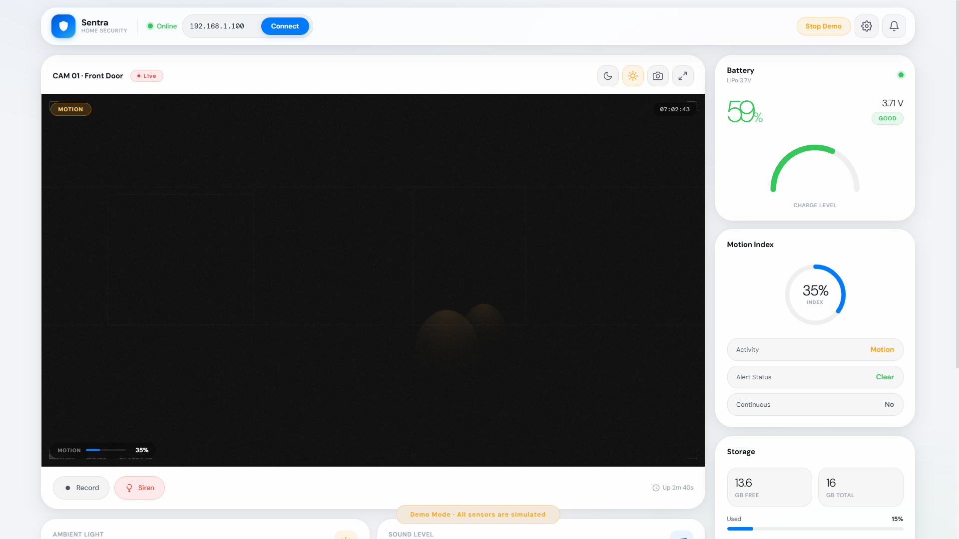

8Control Dashboard
To make Sentra feel like a complete smart product, we designed a modern web-based dashboard with a clean interface and real-time controls.
Simply open the dashboard, enter the camera's IP address, and connect instantly. It Designed with a modern and responsive layout, the interface works seamlessly across smartphones, tablets, and desktops, giving Sentra a polished and professional user experience.
You can view the live camera feed and monitor important information such as motion activity, battery level, ambient light, sound level, recording status, SD card usage, and night vision status in real time.
The dashboard also provides quick access to features like recording control, voice announcements, siren mode, and infrared lighting, making it easy to manage the camera from anywhere on your local network.

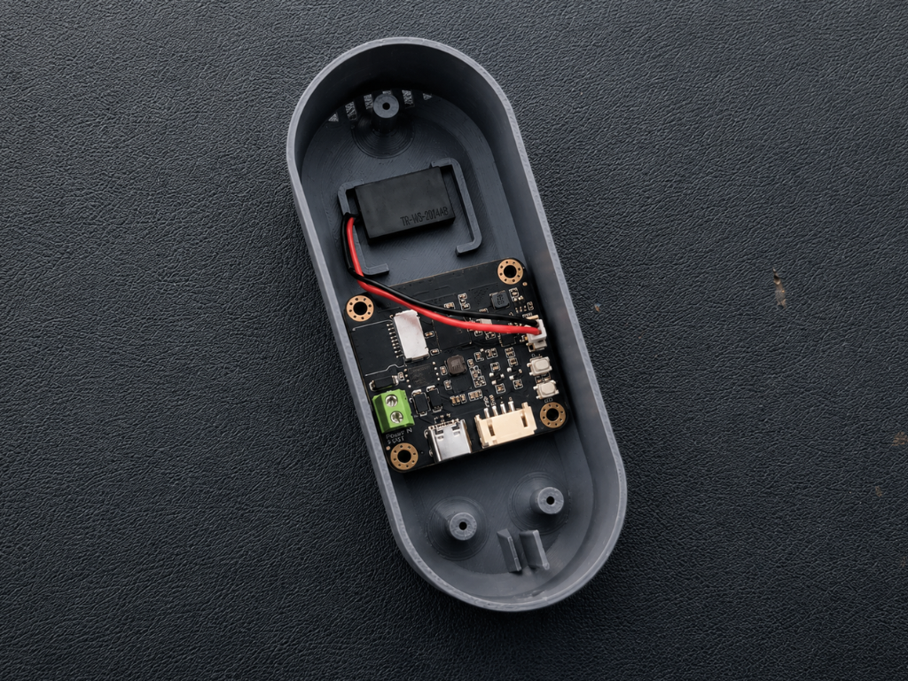

9ESP32 S3 Camera Assembly
The next step was installing the ESP32-S3 camera board into the main housing. I placed the board into the dedicated mounting position, and after positioning the board, I connected the speaker using its JST connector
The enclosure was designed to support standard screw mounting using 4 small screws for a secure installation. Since I did not have the screws available at the moment, I used a small amount of super glue to hold the board carefully in place for now.
10Charging Module Assembly
After preparing the charging module earlier, I carefully placed the module into its dedicated position and aligned the USB Type-C connector with the cutout on the side of the housing so the camera can be charged easily from outside.
Once the module was positioned properly, I connected the two 5V output wires from the charging module to the main board’s power input terminal, making sure the polarity was correct before powering the system.
