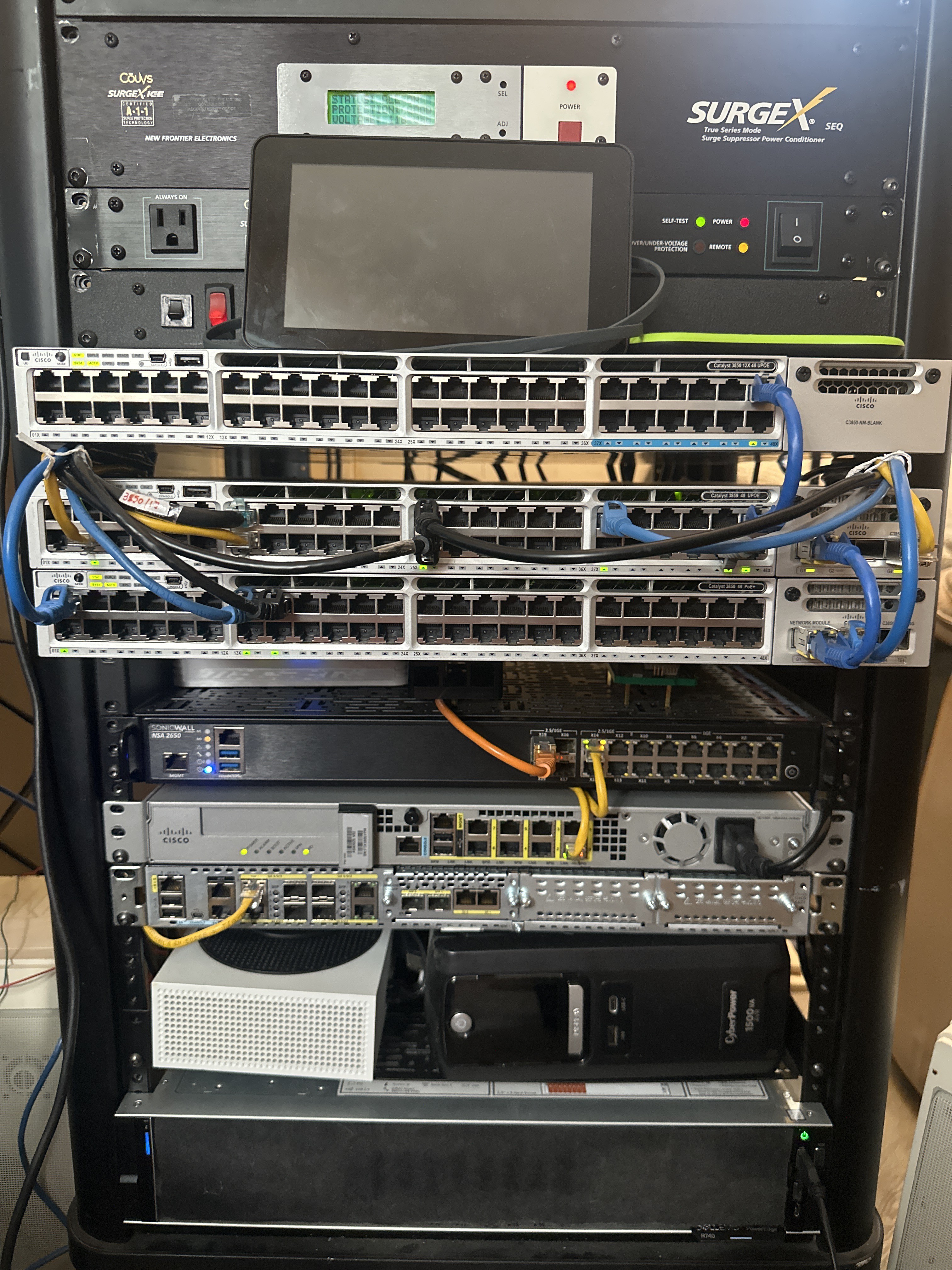

  • The current state
    Rhea Rae08/06/2026 at 20:22 0 comments
    I finally had a chance to get my Catalyst 3850 12X 48 UPOE in to the main rack and configured a temporary Trunk so I can slowly migrate my first catalyst then install the first catalyst into the new upstairs rack which currently has no PoE only a dumb switch atm, after migration I will have PoE upstairs :)
    -RR

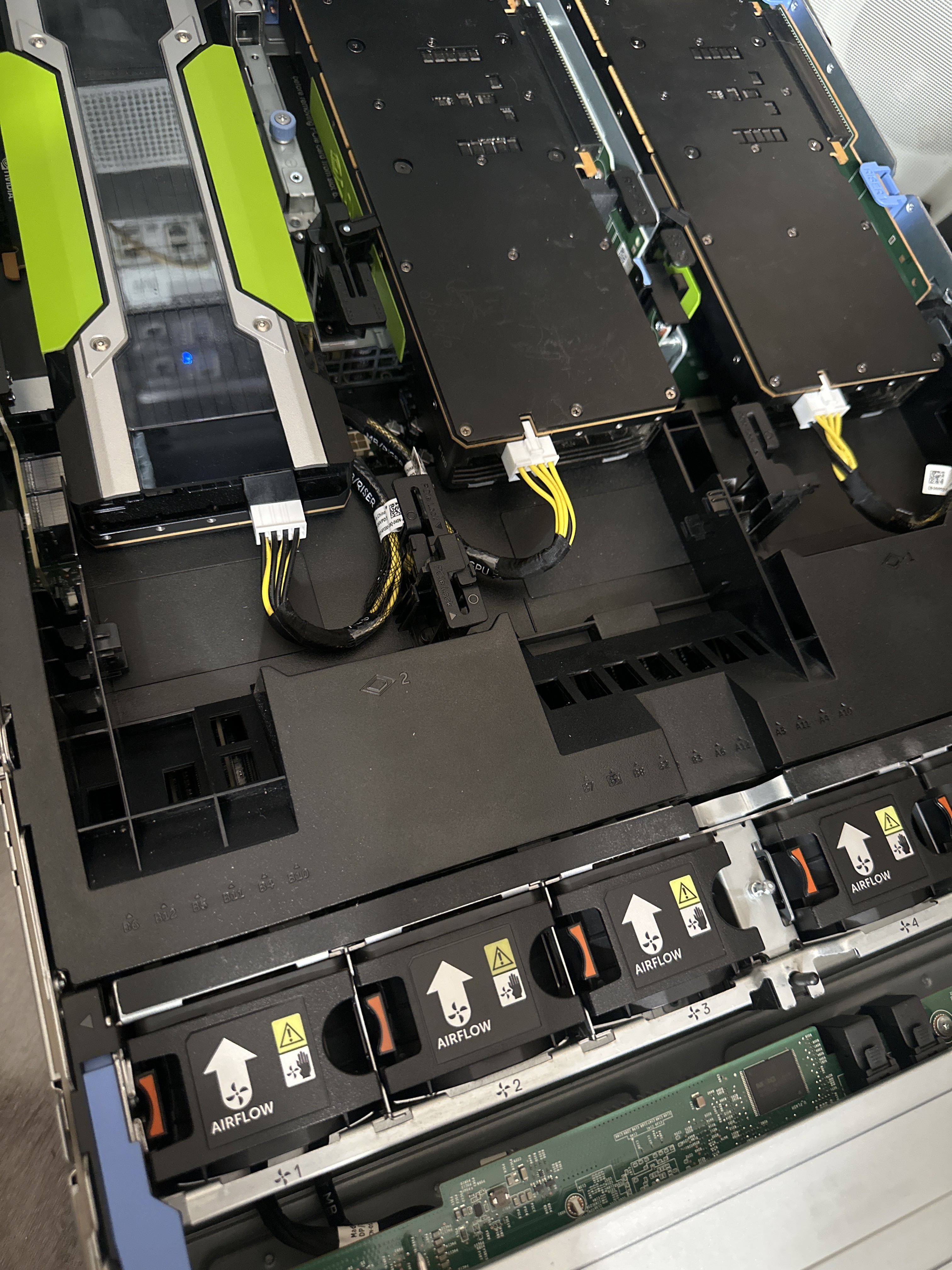

    Rhea Rae08/01/2026 at 12:43 0 comments
    3x NVIDIA P100 16gb, Dell R740 128gb DDR4

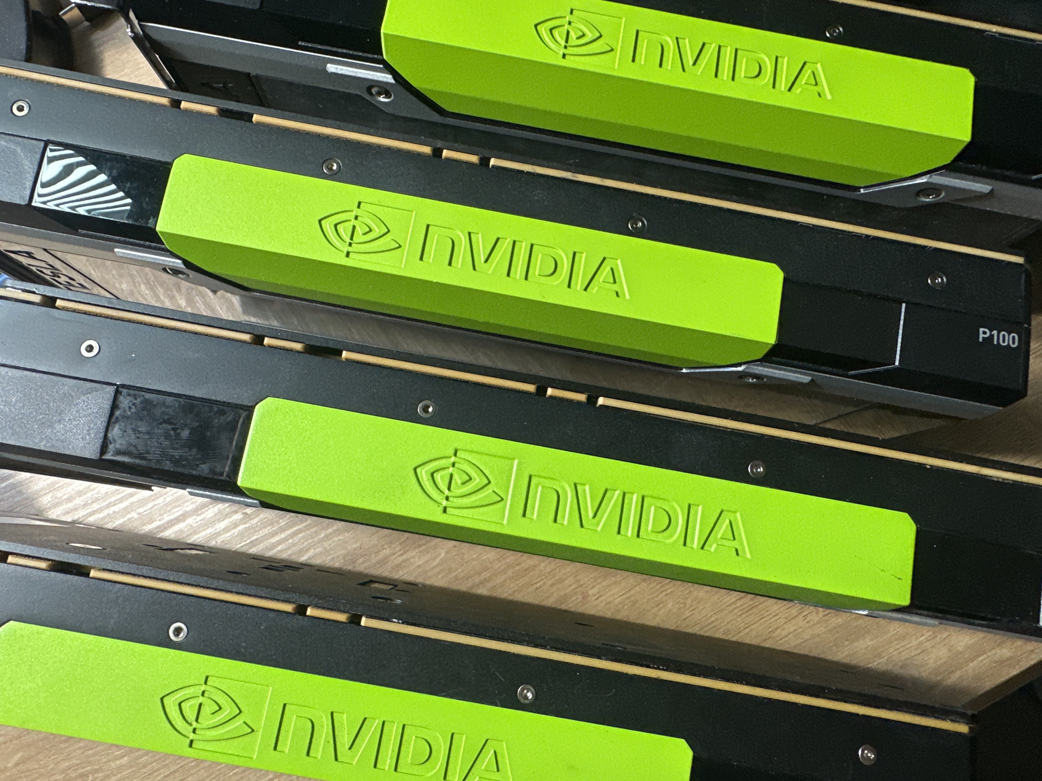

  • NVIDIA Tesla P100
    Rhea Rae07/25/2026 at 21:44 0 comments
  • Unit acquired :)
    Rhea Rae07/20/2026 at 18:38 0 comments
    tbh prolly the best 100$ I have spent yet .
    -RR

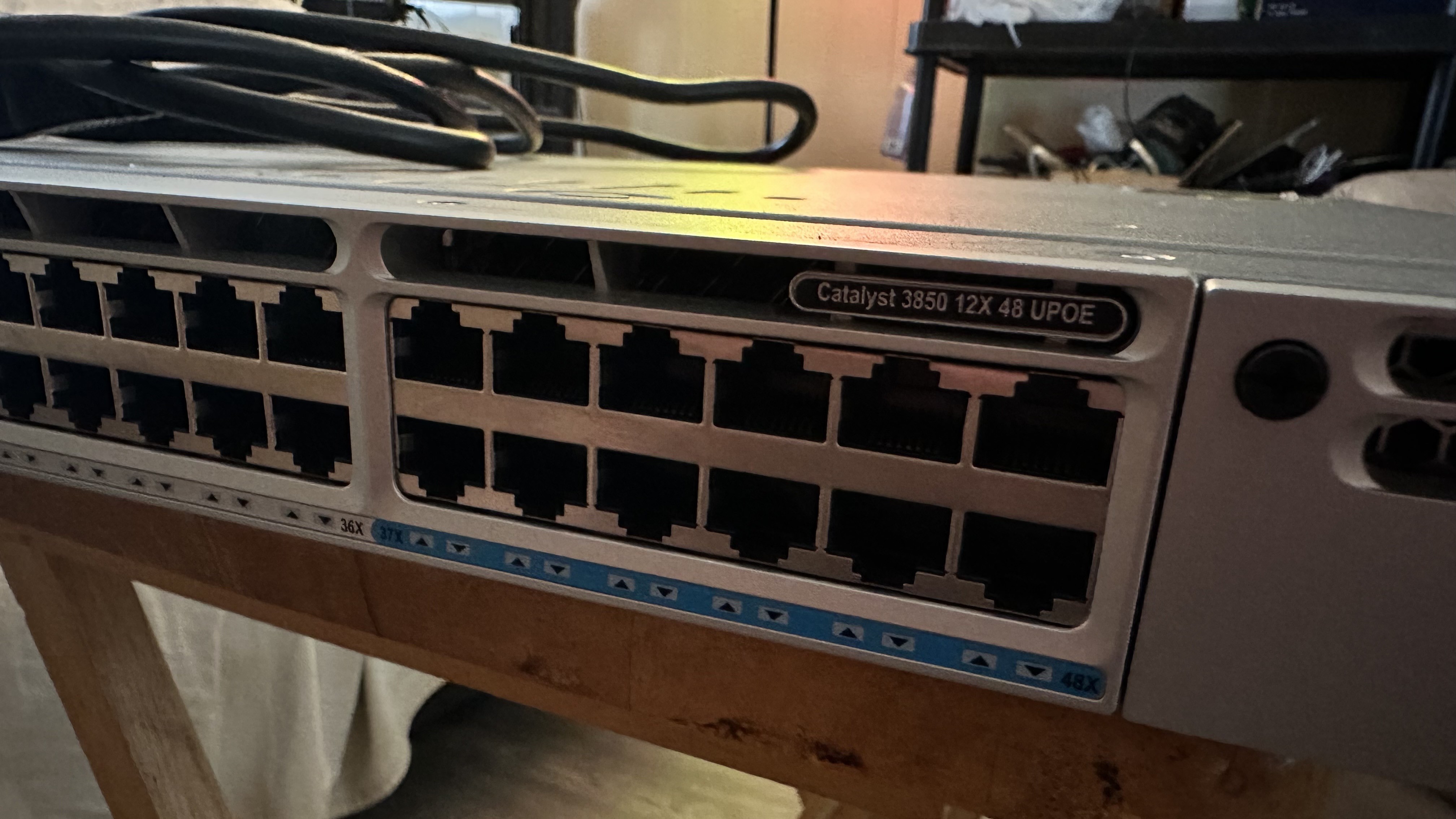

  • A New Not New Switch Has My Attention...
    Rhea Rae07/16/2026 at 20:13 0 comments
    I know there are much newer and faster switches available today. There are Catalyst 9300s, Nexus switches, and plenty of white-box options that outperform the 3850 in almost every way.
    But I have a soft spot for the Catalyst 3850 series.
    Over the past several months I've configured, repaired, reset, tested, and sold hundreds of them at work. They've become one of those pieces of hardware that I know inside and out. They're reliable, well-built, and still more than capable for a homelab.
    That's why finding a WS-C3850-12X48U-L caught my attention. It has all the things I already like about the 3850 platform, but with twelve multigigabit copper ports that make it a little more unique. 1, 2.5, 5 and 10G!
    Is it the most practical switch I could buy? Probably not.
    Is it the one I want? Absolutely.
    -RR

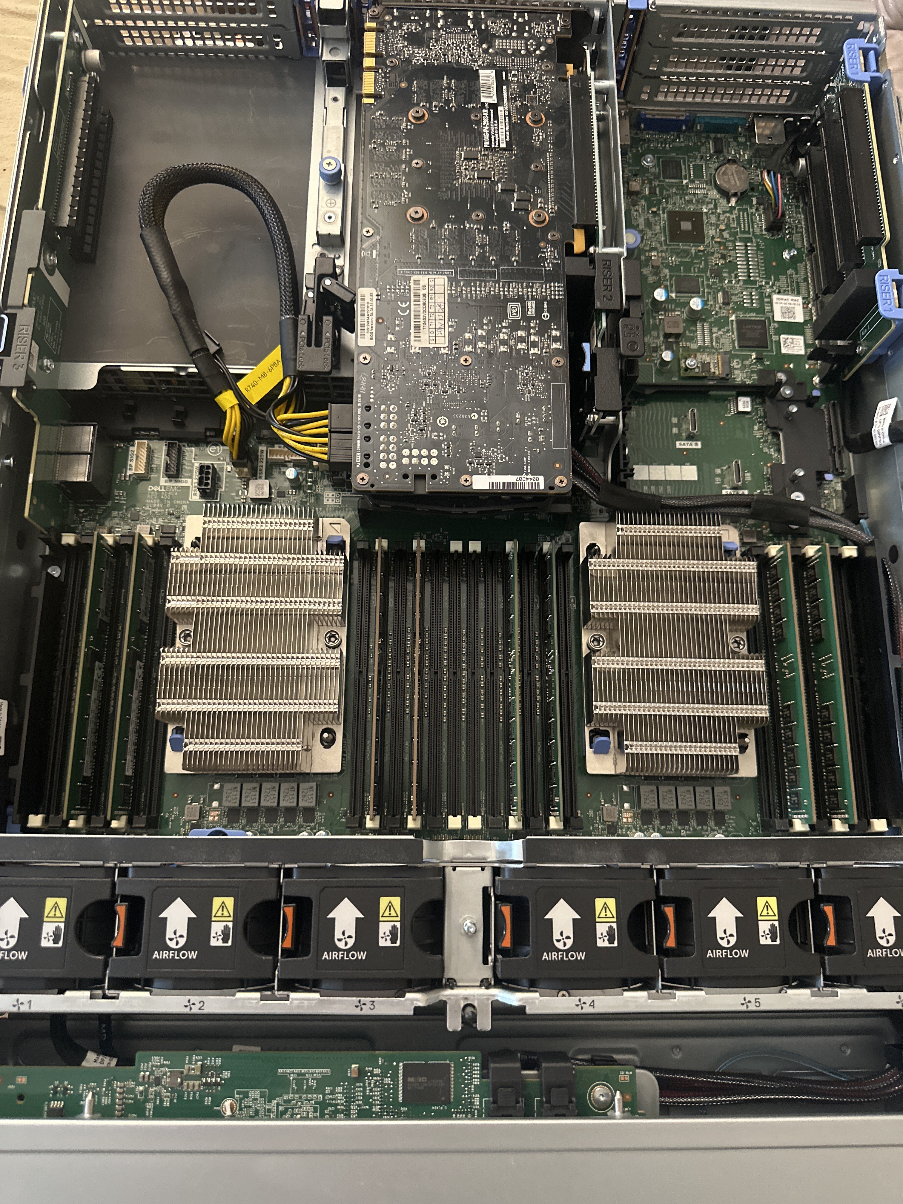

  • _UPGRADE
    Rhea Rae07/11/2026 at 15:48 0 comments
    Now 128 Gb SK hynix DDR4 ECC RDIMM 2666 Ram. Spare GTX 980 for testing. Ordered GPU riser slot 1A for future 2nd powered GPU tests. This unit includes 2x Xeon Gold 6138 CPU upgraded from Silver CPU's.

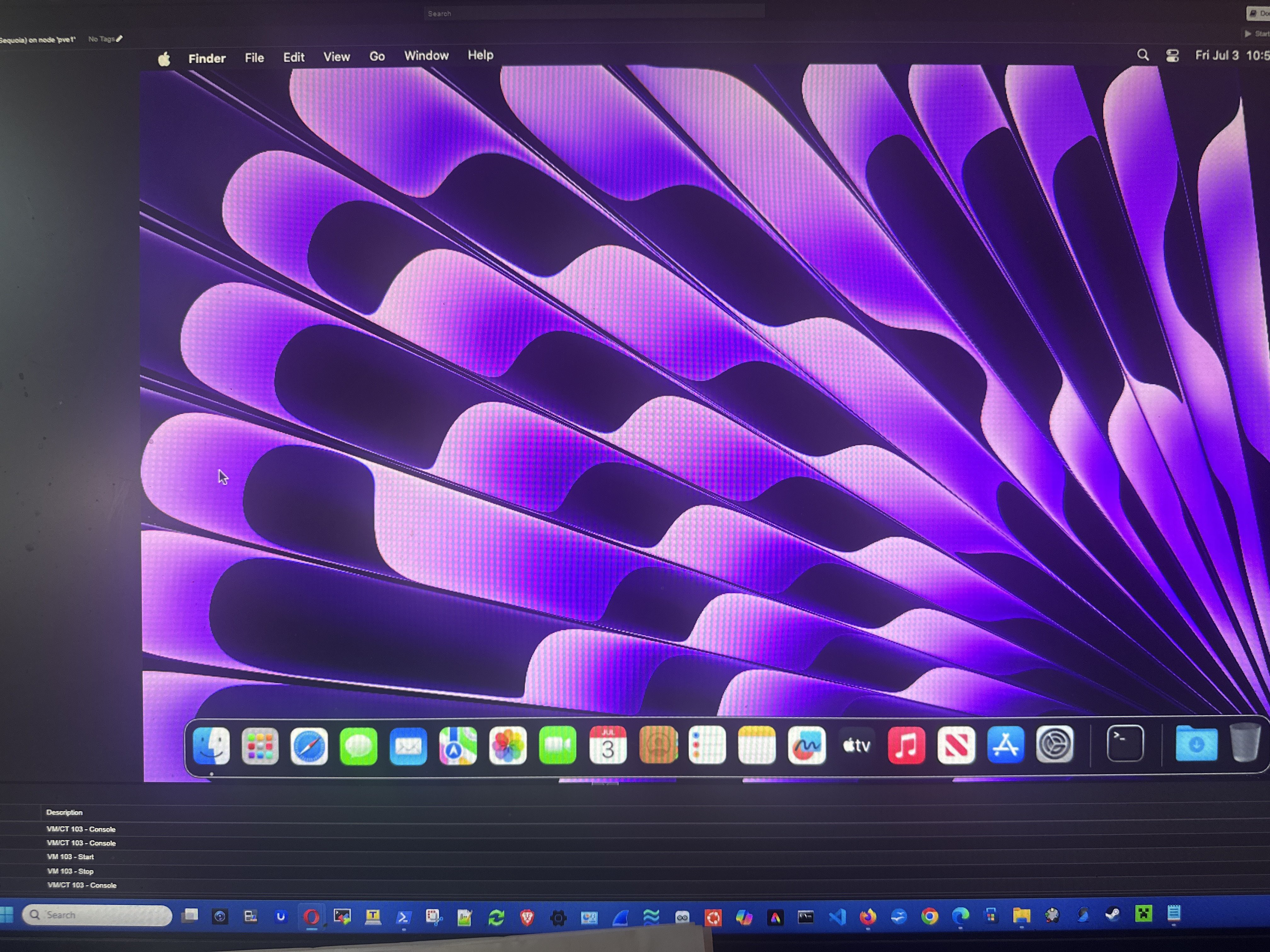

  • Virtual Hackintosh running on Dell PowerEdge R740
    Rhea Rae07/03/2026 at 17:51 0 comments
