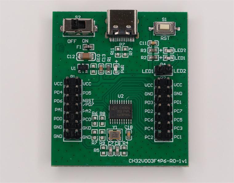

Now we get to the actual hardware that I've decided to develop for. The CH32V003 family is one of the offerings of the Nanjing Qingheng Microelectronics company. These MCU ICs got the attention of developers and hobbyists for their low price. This family of 20 pin and below MCUs aims to capture some of the base functionality MCU market, which coincidentally or not, have 003 somewhere in the model name, e.g. STM8F003, STM32F003. Higher members of the CH32V family offer more peripherals and more pins.
If you go shopping in the usual bazaars, this is a module you will commonly see:
Another variant has a TSSOP-20 package instead of the QFP-20 package in the middle. Notice the 3 pins to the programming dongle.
I've decided to go for the module shown in the topmost picture, one of the BTE series made by a different factory. It doesn't have the USB-C connector but has an onboard 24 MHz crystal which could come in handy for more precise timing.
I've decided to not attempt to design around the bare MCU but use the BTE module as a component. They pack more on the module than I could with my SMD soldering skills and sell it cheaper than I could buy the components for. You can see how small it is, about the size of a 20 pin 0.6 inch DIP IC. A price of tens of cents for the bare MCU is tempting, but so is the price of only a dollar or two, quantity 10 shipping included, for the module. Tested working too. The drawback is that these module will raise the height of the entire assembly if pulgged into Dupont pin sockets, unless I'm willing to solder them more or less permanently onto the base PCB.

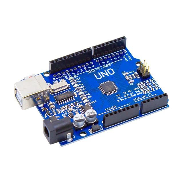

    Just for kicks I decided to see if I could run blinky written in Rust on an Arduino, even though this is a digression from the main goal of this project. The Arduino model I have is a clone of the common UNO which has the ATMega328p MCU.
    I found this guide which outlines the steps. From there I followed the link to the Github repo for avr-hal-template.
    First of all, Rust on AVR chips doesn't use the LLVM compiler for the linking, but rather the gcc compiler. So you need to have this installed separately. If you have installed the Arduino IDE, then you already have it, but you have to make the commands avr-gcc and friends available from the command line. What I did was make symbolic links from /usr/local/bin to the actual executables.
    $ ln -s -t /usr/local/bin ~/.arduino15/packages/arduino/tools/avr-gcc/7.3.0-atmel3.6.1-arduino7/bin/*
    The version of the avr-gcc package may differ, double check.
    The other thing you need to do is install the nightly Rust toolchain. This will be taken care of in a step further down.
    Now install two auxiliary tools like this:
    $ cargo install cargo-generate
    $ cargo install ravedude
    Ravedude is a front-end to avrdude, which must also be on your $PATH. Now run:
    $ cargo generate --git https://github.com/Rahix/avr-hal-template.git
    This will prompt you for the project name, and the type of Arduino you have and generate the standard Cargo project structure..
    I had to make a couple of changes: In rust-toolchain.toml I changed the channel from nightly-2025-04-27 to just nightly. I also added port = "/dev/ttyUSB0" in the [general] section because autodetect didn't work.
    Now you can do:
    $ cargo build
    If you didn't have the nightly toolchain already installed, then a lot of downloading will happen. After that many crates will be downloaded and compiled, then linked with the blinky in src/main.rs.
    Note that the sample blinky doesn't use the Embassy framework. So this is the blocking version, which looks like this:

    I made one change, from 1000 ms to 500 ms. Otherwise it's a ½ Hz blinky, not a 1 Hz blinky. Now you can run the blinky:
    $ cargo run
       Compiling avr-rust-blinky v0.1.0 (/home/ken/play/uC/avr/project/avr-rust-blinky)
        Finished `dev` profile [optimized + debuginfo] target(s) in 0.32s
         Running `ravedude target/avr-none/debug/avr-rust-blinky.elf`
           Board Arduino Uno
     Programming target/avr-none/debug/avr-rust-blinky.elf => /dev/ttyUSB0
    Reading 262 bytes for flash from input file avr-rust-blinky.elf
    Writing 262 bytes to flash
    Writing | ################################################## | 100% 0.08 s
    Reading | ################################################## | 100% 0.05 s
    262 bytes of flash verified
    Avrdude done.  Thank you.
      Programmed target/avr-none/debug/avr-rust-blinky.elf
         Console /dev/ttyUSB0 at 57600 baud
                 CTRL+C to exit.
    As you can see, the size of the executable isn't large at all, so there is very little overhead in this case.

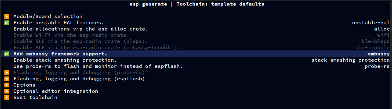

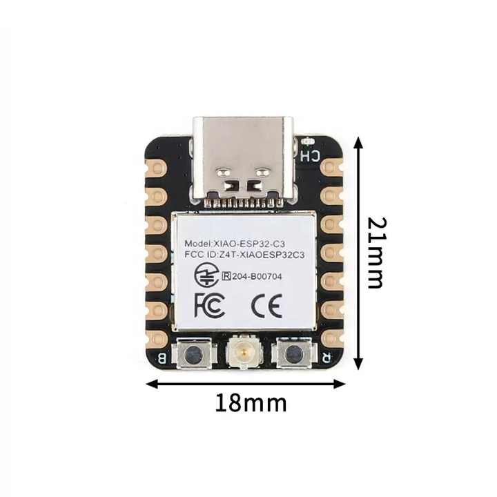

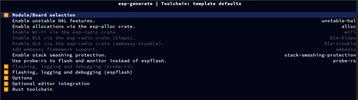

    The Seeed Xiao ESP32C3 packs an incredible amount of features on a tiny board. The SOC MCU is an Espressif ESP32C3 running at up to 160 MHz. It comes with 400 kB SRAM and 4 MB flash, plus 2.4 GHz WiFi and BLE 5.0 Bluetooth. I got mine cheap when Seeed was promoting them. So why not try to get this working with Rust/Embassy and get one step closer to being able to build embedded apps for the tiny RISC-V MCU board in the cover picture?
    Are you tired of blinky yet? I'm not. Blinky is not the point. If I wanted to flash an LED at 1 Hz, I could do it with any MCU, or even a 555 chip. The goal of all these blinky exercises is to work out how to use the Rust/Embassy toolchains to write async embedded apps.
    I thought I had found a good tutorial at https://shanesnover.com/2025/01/28/bootstrap-embassy-esp32c3.html. But on trying out the steps and updating the versions of the crates used, it turns out it's out of date, and it's less than 2 years old. For one thing esp-hal-embassy is no longer maintained. Right at the top of the crate page it says:
    🚧 This crate is no longer maintained 🚧
    This crates functionality has been merged into esp-rtos, where further development will occur.
    So I browse the esp-rtos crate which is maintained by Espressif. From there I find that Espressif has a book on programming with Rust on ESP products. So they are supporting Rust on their products. Under toolchain installation I find that I have to do:
    $ rustup target add riscv32imc-unknown-none-elf
    for the C3. Under tooling installation I find that I have to do:
    $ cargo install esp-generate --locked
    $ cargo install espflash --locked
    to install 2 auxiliary tools. Great, that should save me a lot of work. So I do:
    $ esp-generate --chip=esp32c3 esp32c3-rust-blinky
    This brings up a ncurses configuration screen:
    I save the setup with s, and it creates my project crate. Looking at src/bin/main.rs, I see:

    Ah no, this is not an async app. The MCU keeps polling the timer until 500 ms have elapsed. Looking again at the configuration screen, I should Add Embassy framework support. For that to be possible, I have to Enable unstable HAL features. Live dangerously I say. So the configuration screen is this:
    Another esp-generate run and I get this for src/bin/main.rs:
