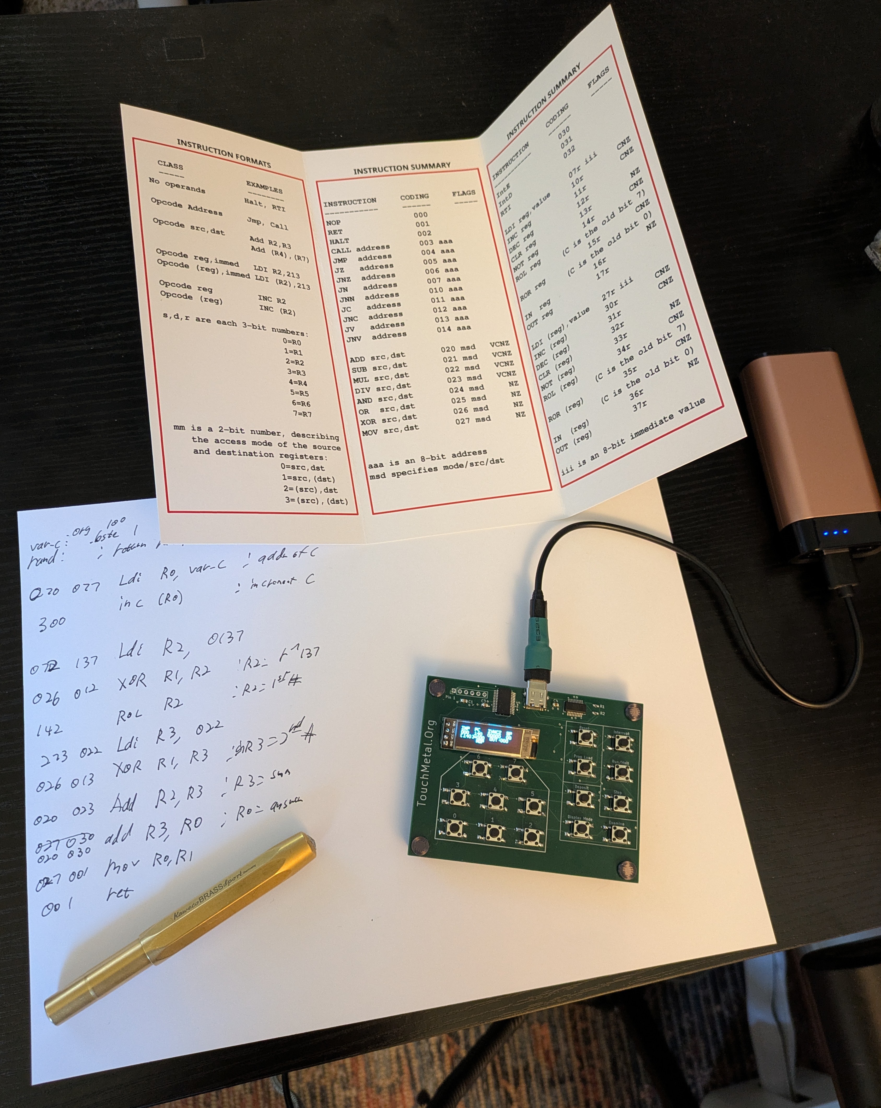

Computer Science is increasingly detached from the low-level aspects of the underlying CPU/memory system. With vibe-coding, this detachment is absolute: you don't even need to understand much about the higher-level aspects of the system. This board is an attempt to help people re-connect with those lower-level aspects. With the Touch Metal board, you examine and modify memory one byte at a time, by typing in addresses and data in octal (using 8 push buttons). After entering your code, you can single-step the CPU, examine registers and memory, and really see what the CPU is doing as it executes your code.
I'm hoping this will be a fun, entertaining and educational toy for people who want to know more about how computers work: a chance to "touch metal."
Bare Metal Programming!
What makes it special?
This is a custom CPU architecture, designed for education. It has a simple instruction set; relatively few addressing modes (it favors direct memory access, though it also has internal registers and supports memory-indirect addressing); and the coding of instructions in machine code is very clean, breaking on octal-digit boundaries, which makes it feasible to assemble code in your head (especially with the handy assembly-to-machine code map on the back).
