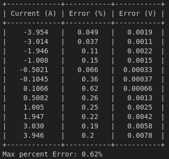

Basically we just have a shunt and a differential amplifier with a non-inverting stage to add some gains. The gains gives a 1:1 voltage current ratio. It is fused at 6A, but I have tested accuracy up to ~4A. Note the precise resistors used for the differential amplifier.

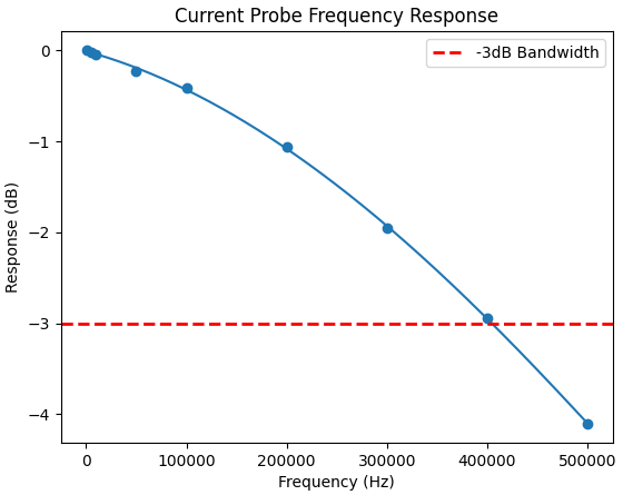

The frequency response is also problematic. Ideally it would be flatter than this. The op amp might make it roll off faster than it should. Really the cutoff frequency should be ~530kHz. I will probably mostly use this thing close to DC though, so I'm not going to worry about it too much.

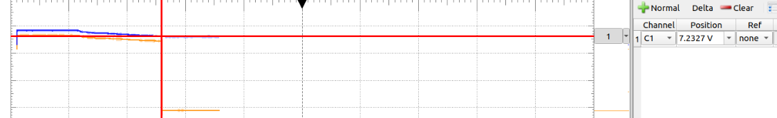

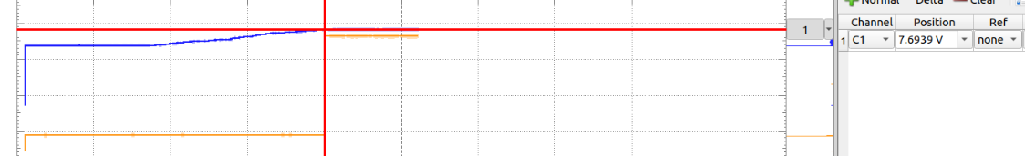

The low battery circuit is mostly fine. There is some hysteresis with ~0.5V between the up going threshold and the down going threshold.
Low Battery ThresholdLow Battery Off Threshold

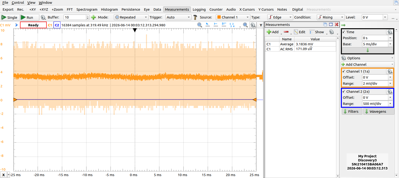

    I realized I never measured the noise of this thing before. Here it's now:

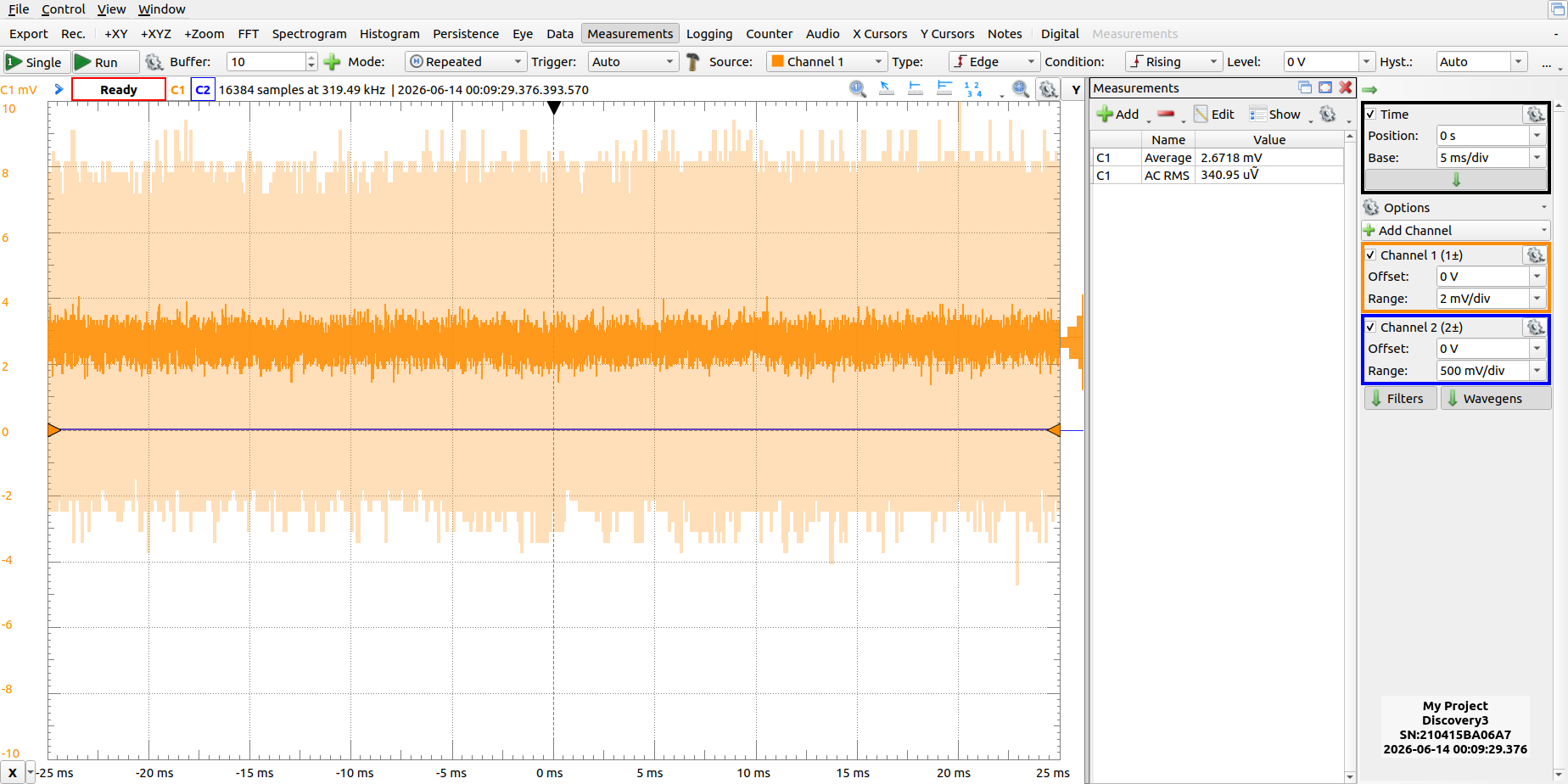

    We are getting close to the noise floor of the scope. Here is an open scope:
    As a side note this this AD3 has a surprising amount of offset and no offset null feature. Subtracting the scope noise using the root sum square method, we get about 300uVrms of noise. This is the same order of magnitude as my calculations. This noise is really what sets the lowest current that can be measured with the probe.
