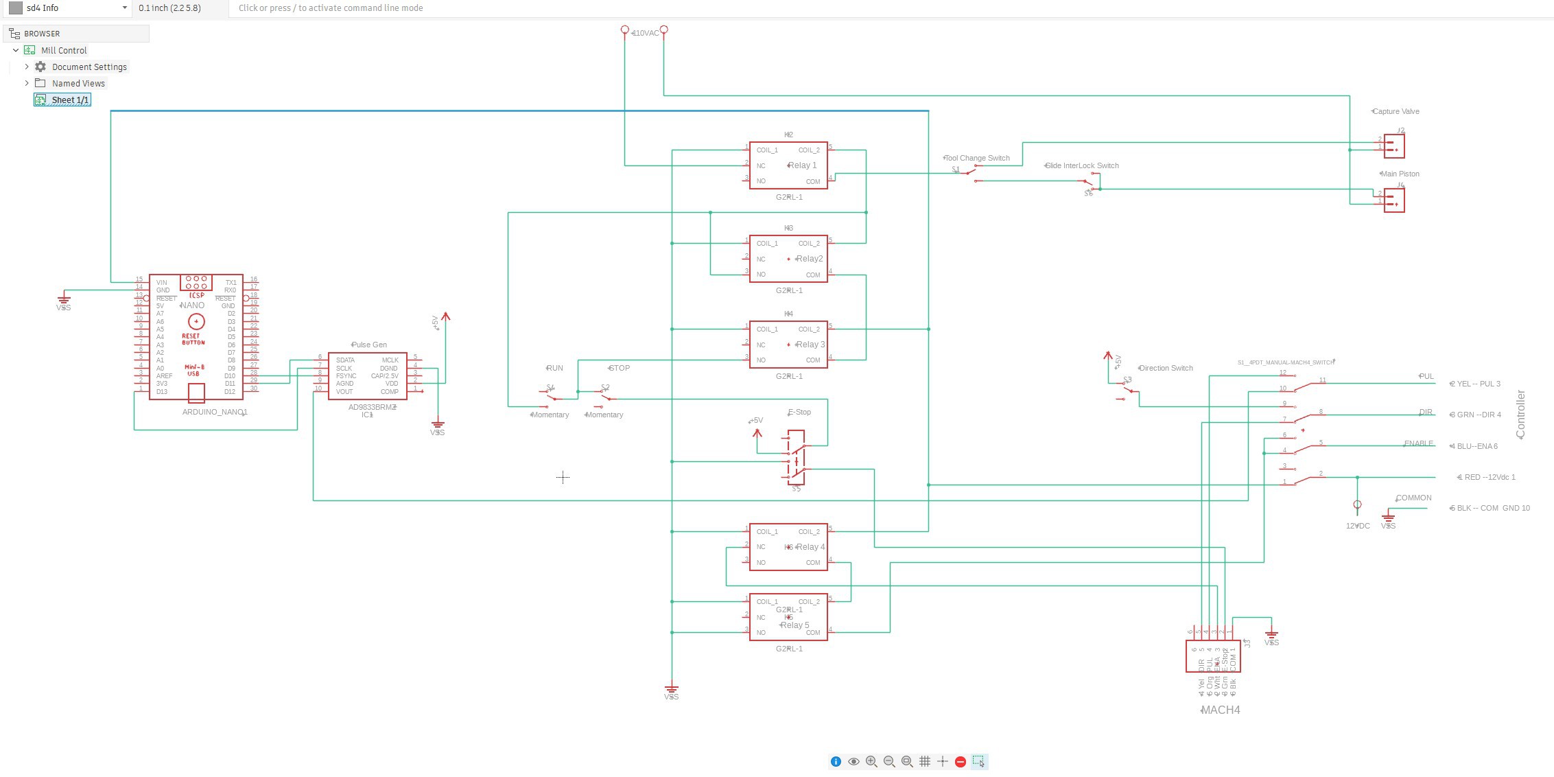

  • Full Schematic and Deep‑Dive System Operation
    Gary Alose4 days ago 0 comments
    This log presents the complete electrical schematic for the controller and explains how the relay logic, spindle enable chain, and pneumatic controls work together to create a safe, reliable hybrid spindle and toolchange system.
    By this point, the earlier logs have covered the manual spindle control, Mach4 integration, high‑level architecture, and pneumatic theory. Now we can finally walk through the wiring and logic that make the system behave like an industrial machine.
    Before diving into the detailed operation of each section, it’s helpful to see the entire system laid out visually—how the signals flow, how the relays interlock, and how the electrical and pneumatic sides connect. The schematic below serves as the reference point for the explanations that follow.
    Schematic Overview
    The schematic is organized into functional blocks:
    • Manual Spindle Control Arduino Nano, AD9833, manual RUN/STOP, manual direction
    • Mach4 Spindle Control PUL/DIR/ENABLE inputs, opto‑isolated interface, mode switch routing
    • Relay Logic Section Mode selection relay Safety gate relay Toolchange relay Capture confirmation relay Master enable relay
    • Pneumatic Solenoid Control Capture solenoid (Stage 1) Main ram solenoid (Stage 2) Limit switch feedback
    • Power Distribution 24VDC logic 110VAC solenoid power E‑Stop chain Slide interlock
    Each block is electrically isolated where appropriate and tied together through the relay logic that enforces safety.
    Relay Logic — The Heart of the System
    The relay network is what makes this controller fundamentally different from typical hobby CNC conversions. Instead of trusting software, the system uses hard‑wired logic to enforce safety and sequencing.
    Here are the key relays and their roles:
    1. Mode Selection Relay
    Selects which spindle control source is active:
    • NC → Manual enable path
    • NO → Mach4 enable path
    Only one can be active at a time. This prevents cross‑feeding signals or simultaneous control.
    2. Safety Gate Relay
    This relay enforces the global safety conditions:
    • E‑Stop must be OK
    • Slide interlock must be OK
    • Toolchange must be inactive
    If any of these conditions fail, the relay drops and the spindle enable line (blue) is forced LOW.
    This is the electrical equivalent of a “master safety AND‑gate.”
    3. Toolchange Relay
    When the Toolchange switch is ON:
    • The spindle enable path is forcibly opened
    • The capture solenoid receives 110VAC
    • The system enters toolchange mode
    This relay ensures that toolchange and spindle motion are mutually exclusive.
    4. Capture Confirmation Relay
    This relay is controlled by the capture bar limit switch.
    • When the capture bar is fully extended and has physically captured the spindle, the switch closes
    • This energizes the relay
    • The relay then allows power to reach the Main Ram solenoid
    This is the mechanical guarantee that the spindle is secured before the main ram actuates.
    5. Master Enable Relay
    This is the final gatekeeper before the spindle drive.
    It receives:
    • The selected enable source (manual or Mach4)
    • The safety‑gated enable path
    • The toolchange lockout
    Only when all conditions are satisfied does this relay close and send the ENABLE signal to the spindle drive.
    Spindle Enable (Blue Line) — Final Logic Path
    The ENABLE signal to the spindle drive is the output of the entire relay chain.
    It can only go HIGH when:
    1. E‑Stop OK
    2. Slide interlock OK
    3. Toolchange inactive
    4. Mode selected (manual or Mach4)
    5. That mode’s enable signal is active
    6. All relays in the chain are energized
    If any condition fails, the blue line drops to LOW instantly.
    This is why the system behaves safely even if:
    • Mach4 crashes
    • The Arduino locks up
    • A wire breaks
    • A relay fails
    • Power flickers
    The default state is always safe.
    Pneumatic Solenoid Control (Electrical Side)
    The schematic shows two 110VAC solenoid outputs:
    Capture Solenoid (Stage 1)
    Powered when:
    • Toolchange switch is ON
    • E‑Stop is OK
    This extends the capture bar.
    Main Ram Solenoid (Stage 2)
    Powered only when:
    • E‑Stop is...

    3. Hard‑Wired Relay Safety Logic
    The system uses relays—not software—to enforce safety. This means:
    • The spindle cannot run during toolchange.
    • Toolchange cannot proceed unless the spindle is disabled.
    • The main ram cannot fire unless the spindle is physically captured.
    • E‑Stop overrides everything instantly.
    • Slide interlock must be satisfied before spindle enable is allowed.
    • All relays fail to the safe state if power is lost.
    This architecture ensures that even if Mach4 crashes, the Arduino locks up, or a wire comes loose, the machine defaults to a safe condition.
    Safeguards and Safety Philosophy
    This controller was designed around the principle that no software should ever be trusted with safety‑critical decisions. Every dangerous action—spindle enable, toolchange motion, pneumatic actuation—is gated by physical relay logic and mechanical confirmation.
    Key Safeguards
    • E‑Stop Dominance If E‑Stop is pressed, all solenoids drop and spindle enable is forced low.
    • Slide Interlock Prevents spindle enable unless the slide is in the correct position.
    • Toolchange Lockout When Toolchange is active, the spindle is forcibly disabled.
    • Mechanical Confirmation The main ram cannot fire until the capture bar physically hits its limit switch.
    • Mutual Exclusion Spindle motion and toolchange motion cannot occur at the same time.
    • Fail‑Safe Relay Behavior Loss of power → all relays drop → system becomes safe automatically.
    This is the same philosophy used in industrial machinery: hardware enforces safety, software only requests actions.
    What Makes This System Unique
    This controller stands out because it blends hobby‑grade components with industrial‑grade logic:
    1. Manual + CNC Control Without Compromising Safety
    Both control sources coexist, but neither can bypass the safety chain.
    2. Two‑Stage Pneumatic Sequencing
    Capture → Confirm → Main Ram This prevents accidental tool ejection or firing the ram against a spinning spindle.
    3. Mechanical Confirmation Before Dangerous Motion
    The system waits for a physical switch to confirm capture before allowing the main ram to actuate.
    4. Relay‑Based Logic Instead of Software Logic
    No firmware bug or Mach4 glitch can override the interlocks.
    5. Industrial‑Style Mutual Exclusion
    Toolchange disables spindle. Spindle disable is required for toolchange. Both conditions are enforced in hardware.
    • What Comes Next
      • Log #4 will explain the pneumatic system, including how 2‑position 5‑way valves work and how the toolchange pneumatics operate.
      • Log #5 will present the full schematic and walk through the relay logic, truth tables, and complete system operation.
