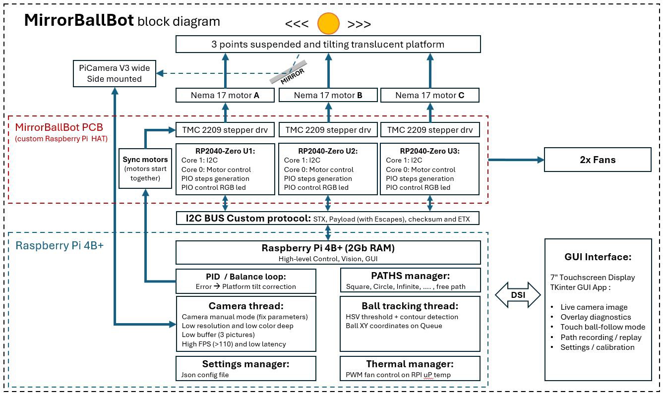

A Raspberry Pi 4B acts as the brain of the robot and sends commands via I2C to three RP2040-Zero boards controlling the stepper drivers.
I wanted to use RP2040-Zero boards because I really like the PIO features, here used to generate precise quantities of motor steps at the intended speed. However, I could not find a suitable MicroPython library to use the RP2040 as an I2C receiver, so I implemented code originally suggested by danjperron on a Raspberry Pi forum.
At a high level, the Raspberry Pi sends 2-byte packets containing speed and step-count information, encapsulated in a custom protocol using STX, escape characters, checksum validation, and ETX markers at at 200KHz.
The RP2040 first validates the received packet and then decodes the data fields into speed, direction, and number of steps.
Since the I2C communication runs on core1 of the RP2040, while core0 handles the remaining tasks, the two cores exchange information through the mem16 shared-memory area.
Thanks to the PIO feature, despite the relatively limited execution speed of the MicroPython interpreter, the RP2040 boards operate very reliably. In practice, this reliability allowed me to design the communication as almost entirely mono-directional: the Raspberry Pi sends commands to the RP2040 boards and simply trusts the job gets done.
Here below the block diagram:
