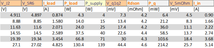

  • Load Measurements Part 2
    MagicWolfi06/18/2026 at 23:12 0 comments
    More measurements, this time to find out the real value of Rdson of the 2 power switching FETs ON Semi    NTTFS5C453NLTWG (datasheet link). The datasheet suggest max 3 mOhm @ 10 V and 4.8 mOhm @ 4.5 Vgs. I measured with a constant current of 4.7 A at 28 V and this is the result:
    Vq1q2: voltage across both FETs
    Vload: Voltage at the load
    4.4 mOhm sits very good inbetween the datasheet values. Now I have to measure Vgs to complete this part.
  • Load Measurements Part 1
    MagicWolfi06/06/2026 at 21:09 0 comments
    I did some load measurements with a fixed 5.6 Ohm power resistor. Here are the results and some calculations.
    V_J2 : Voltage at output connector on the PCB
    V_R5R6 : Voltage at load resistor
    I_load : current through load resistor (calculated)
    P_load: power dissipation in load resistor (calculated)
    P_supply: power delivery display on supply (ANKER 140W)
    V_q1q2: voltage across the 2 FETs
    Rdson: FET resistance drain-source (calculated)
    P_q: power dissipation in FET switches
    V_5mOhm: Voltage across 5 milliOhm current measurement resistor
    I_in: input current (calculated)
View all 2 project logs
