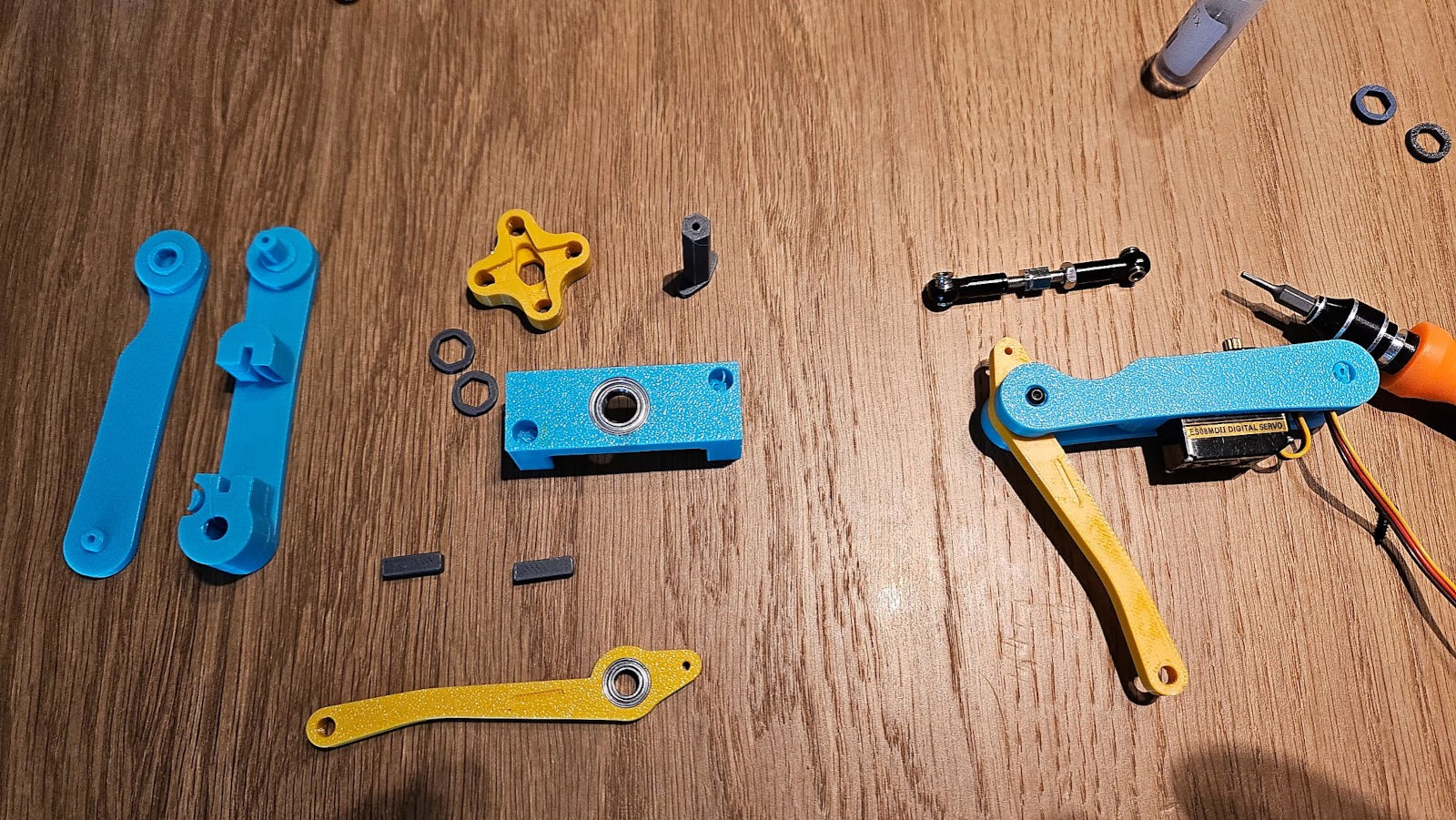

  • Mini robot leg with ball bearing and a push-link
    Vadim06/20/2026 at 11:18 0 comments
    Hi there!
    The first experiment with the quadruped's leg update was insightful but left me dissatisfied with the outcome.
    • The joints are directly connected to the motor shaft with very limited side support. This will cause the tiny servo gears to wear out even faster. Not to mention side bumps.
    • The knee joint motor was also protruding too noticeably outside. This is bad for balance and hurts my eyes.
    • There are no ball bearings, so the joints can rub against each other if side force is applied.
    Let's improve this. Of course, the "wheel" has already been invented multiple times. One of the best designs I came across had triangle-shaped legs, like in the  project "CARA". It's very efficient and clever, but it doesn't look like a normal leg, which I wanted to implement.
  • How bad can it be to design a robot leg?
    Vadim06/10/2026 at 19:59 0 comments
