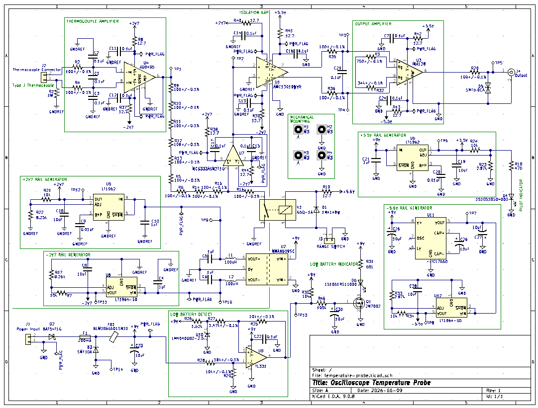

Schematic
The schematic for the first revision is complete. Of course, there might be serious issues with this design as it has not been built yet. See the logs for more info, but the key details are the 10X and 100X ranges and the isolation gap

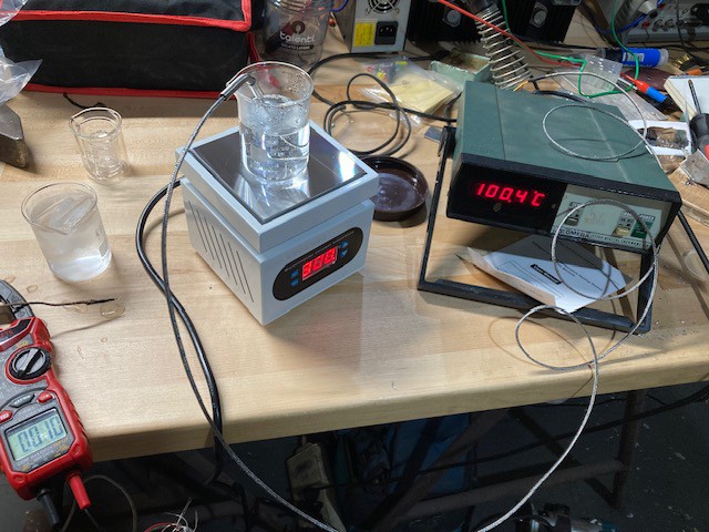

Testing
I have done some early experiments with ice bath and boiling bath with another thermocouple amplifier instrument I have (Omega 2175A).

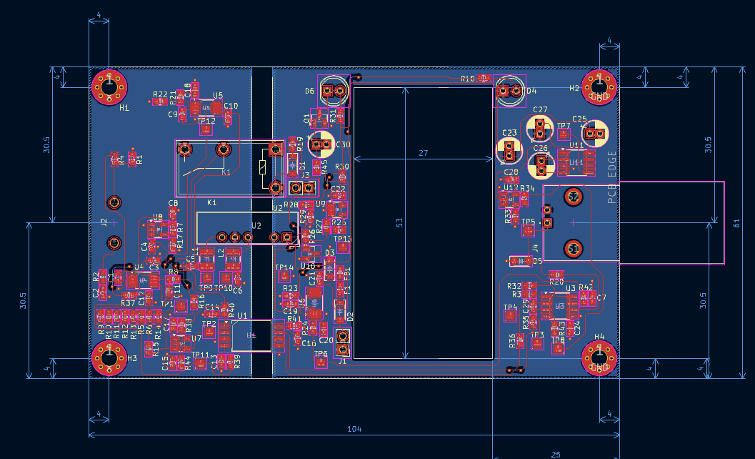

    sup, the pcb layout is complete. see below:
    The big rectangle whole in the middle is a place for the 9V battery to lay. I figure this is the best way to mount it in a case, in the middle of the circuit board so it can sink the center of gravity of the device. Otherwise observe the isolation gap. I did absolutely no analysis on how wide this isolation gap should be. Hopefully no one uses this to do thermal analysis on their tesla coil or anything like that. If they do it will probably end badly.
    The pcb routing and placement is defs sub optimal at this point. No power planes at this point and long traces. I don't really care though.

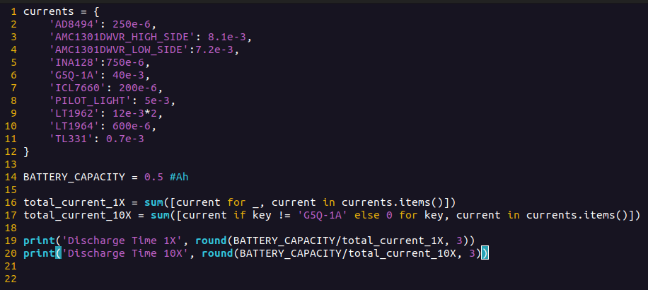

    I would like to use a 9V battery to power the probe. The circuit is actually going to drink quite a bit of current, however. Particularly when it's in 100X mode:
    This results in:
    5-10 hours operating time should be fine though. Maybe in the future an option for an auxiliary power supply will be added so the probe can be used for very long time scale logging.

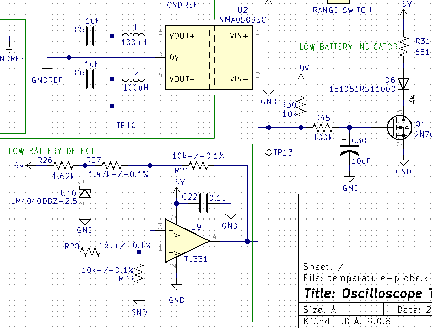

    There is also a low battery detection circuit:
    This circuit triggers a low battery indicator when the 9V battery reaches ~6.5V.

  • Schematic Rough Draft
    schuyler406/09/2026 at 21:28 0 comments
    I have made some progress on the schematic. Most of the components are down, but I have not calculated many of the values yet. As you can see, we are just using the AD8494 thermocouple amplifier combined with the AMC11000 for isolation. There is also a selectable division so the output can go to either 50 deg C full scale or 500 deg C full scale. This corresponds to 0.1V/(deg C) or 0.01V/(deg C) respectively. Other than that there are just a bunch of linear regulators to generate different power rails, and a low battery detection circuit.
