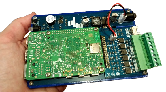

    The Edgeberry Zero came into being after using the Edgeberry ecosystem for a while, and noticing that using it with Raspberry Pi 3B+ was my winning combination for most solutions - staying cool while executing the device's part of the application software perfectly. The more appropriate solution was using the Raspberry Pi Zero 2W, I figured. Of course, with Raspberry Pi's compatibility choices, a Raspberry Pi Zero 2W fits on the Edgeberry board perfectly - but I wanted to lean into the smaller form factor. So I reviewed the board with all Edgeberry's original components and the exact same size of Hardware Cartridge slot, but tailored to the Raspberry Pi Zero form factor. And I immediately fell in love with it.
    Headroom during Development
    While I'm almost exclusively using Edgeberry Zero devices for deployment, the original Edgeberry did not completely fall out of fashion in my workflow. I still have several of those around, equipped with the more capable B models of the Raspberry Pi.
    The device software for an IoT solution is very likely to be closely intertwined with the application-specific hardware. When developing this software, I want the conditions to be as close as possible to the eventual deployment situation - mostly meaning the same software environment and the exact same Hardware Cartridge, but with the additional compute capability for running extensive development-related tools without requiring me to stretch my patience. Everything that could behave differently between my desk and the field stays identical - same OS, same cartridge, same wiring. The only thing I swap when it's time to deploy is the computer underneath, and that's the one change that can't surprise me. I get the comfort of a powerful machine while building, and the honesty of developing on the real thing, without choosing between them.
    Deployment with Edgeberry Zero
    When ready to proceed with deploying the devices, the SD-card from the development device can easily be cloned and put into the real devices.  No rebuild, no reconfiguration, no per-device fiddling. The card that ran on the Pi 5 on my desk runs on the Pi Zero in the field - same image, byte for byte. That's amazing about using Raspberry Pi SBCs. They maintain a single OS image that boots across the whole modern lineup, carrying the firmware for each board and sorting out the hardware differences at startup (And Edgeberry's EEPROM with its unique board ID embedded does the rest at the application level). So a card built on a Pi 5 comes up just fine on a Pi Zero 2W. The device is now deployed at half the cost of a development device.
