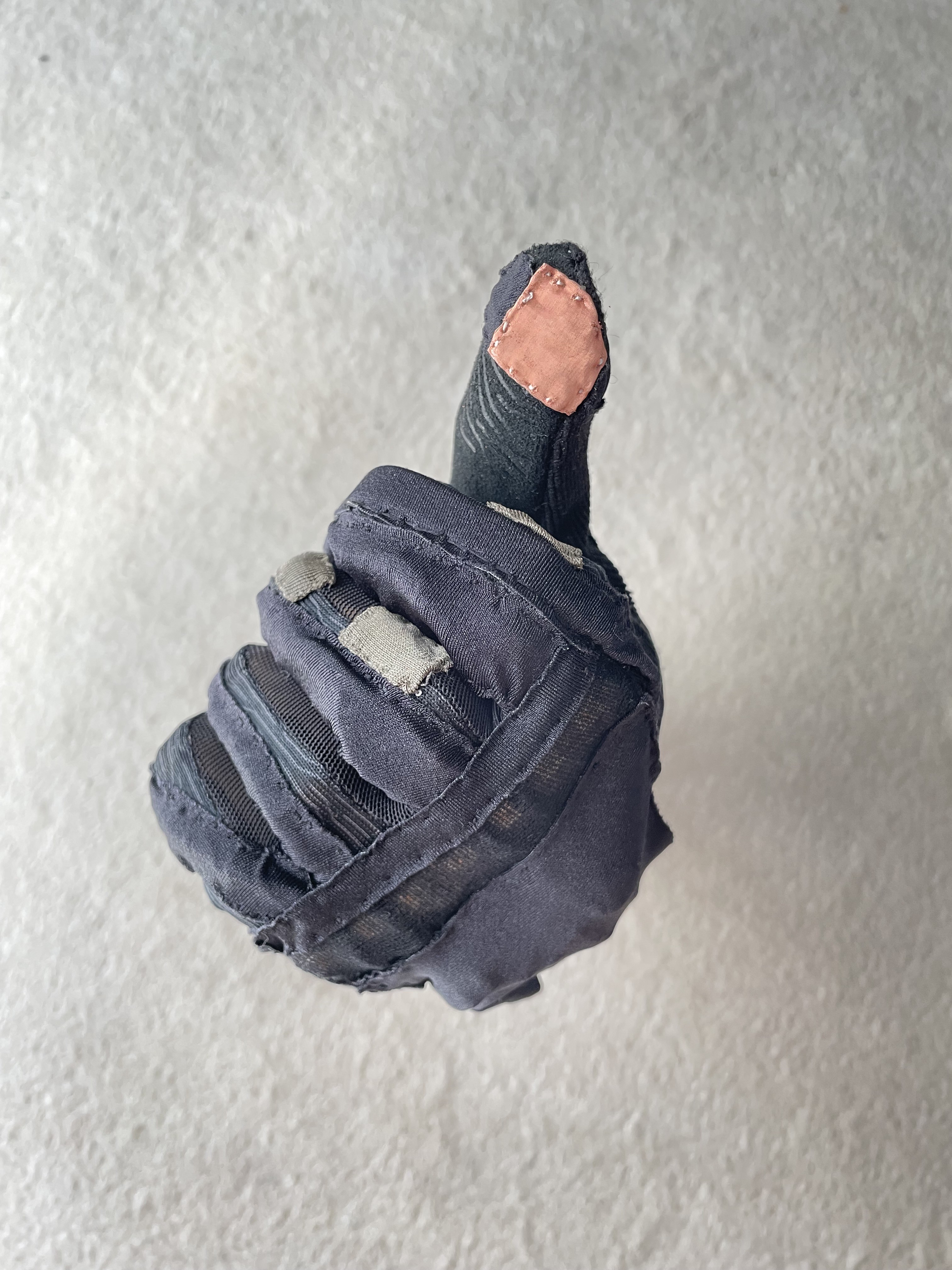

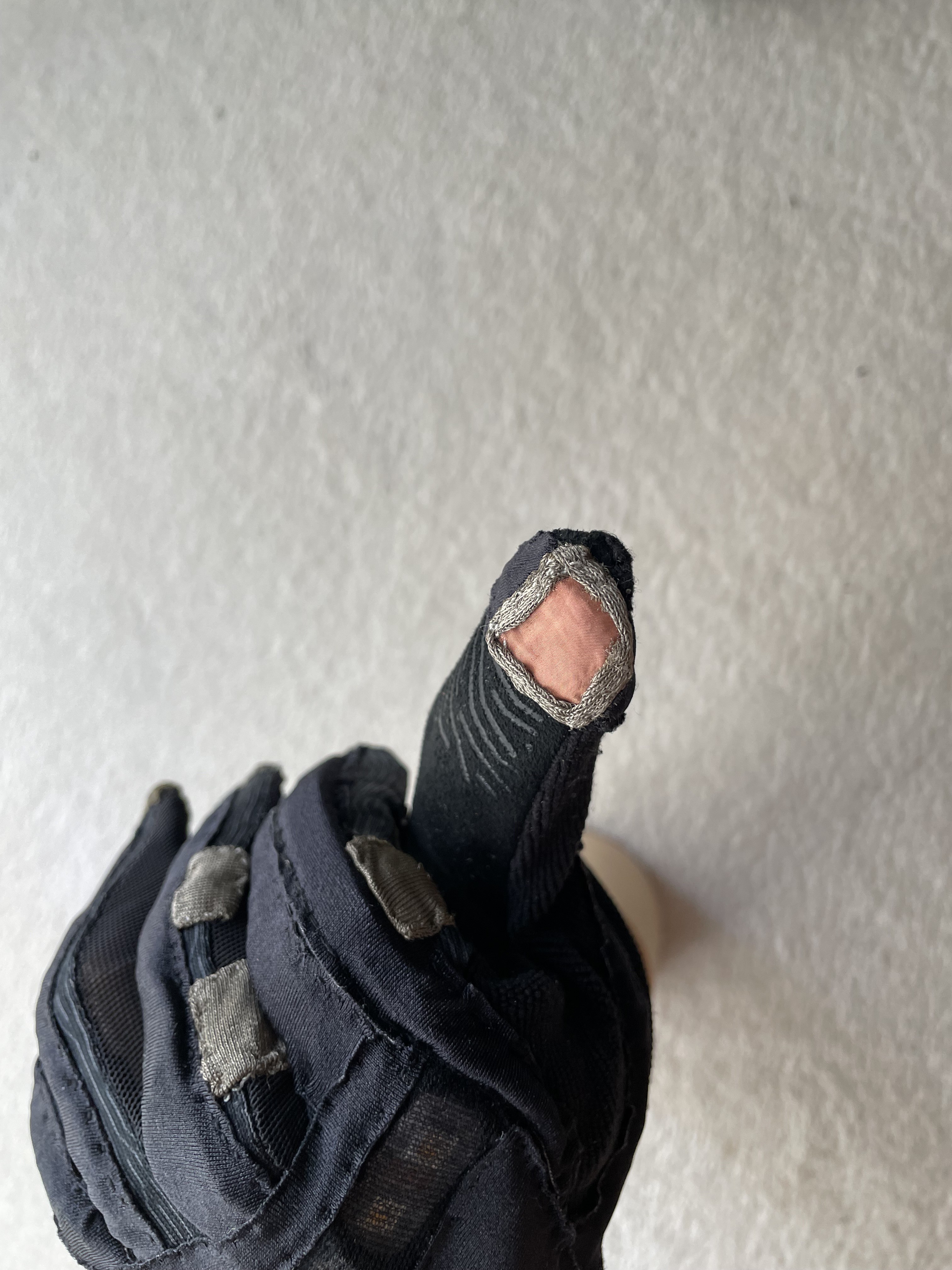

    Update - June 21 2026
    For V1 of the glove, I had tried no less than 15 different fabrics before settling on Adafruit knit silver fabric. But now I'm finding more wear specifically on the thumb (because of the FSR there) so I spent some time looking for alternatives. Pure silver knit fabric would be great but omg the price.
    Idecided to try 200 mesh copper to see how well it holds up. fwiw it takes 1h to remove a single pad, attach fresh double-sided tape and resew it.
    While sewing the 200-count copper mesh to the thumb contact it was difficult to not rip holes in it with the thread. It works well enough but I may replace it with a thicker, lower-count (120 or 80) mesh because it might be too fragile - and the edges of the copper mesh were also snagging on the knit fabric on the other fingers so I also sewed a little frame of the silver knit fabric around it.
