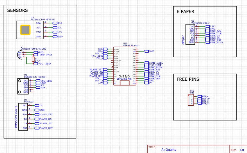

Schematics
it couldn't be simpler !

  1. Power Management: The PMS5003 consumes significant current during startup (approx. 100mA). The 5V USB power source of the ESP32 can handle this peak load. The other sensors are directly powered at 3.3V witth the EPS32's power regulator. BME and DS18B20 are powered via an I/O pin of the ESP32
  2. Bus Sharing:
    • The BME280 and SCD40 typically use the I2C bus. (they don't have the same addresses so do not conflict)
    • The E-Paper uses an SPI interface, allowing it to function simultaneously with the I2C sensors without pin communication interference.

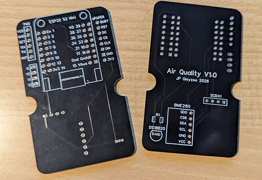

PCB
The PCB can be bought at PCBWay
As you can see corners are "rounded" in order to fit into the 3d printed enclosure. The PCB is delivered CNC milled with this exact shape. No screws are needed for the PCB to fit into the enclosure.
Soldering the PCB is easy. Sensors go on both sides:
Result is a clean and compact setup.
The PCB was kindly sponsored by PCBWay and is as usual of excellent quality.
You can order it here : PCBWay shared project. It's cheap, delivered very fast, and so professional looking!
and if you are new to PCBWay please use this affiliated link : https://pcbway.com/g/o35z4O

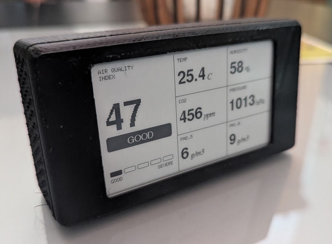

Enclosure
You can print the enclosure, the PCB will fit inside
All the sensors fit into the box, venting holes are preset to help air to circulate into the Plantower laser particules sensor and the CO2 sensor.
Here is the box once closed

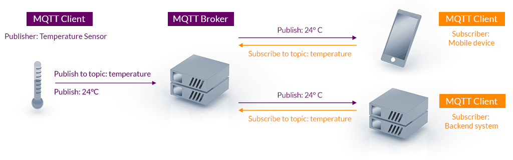

    So you have now your firmware ready to send data to a MQTT broker.
    But what is it ?
    MQTT stands for "Message Queuing for Telemetry Transport".
    "MQTT is a Client Server publish/subscribe messaging transport protocol. It is lightweight, open,
    simple, and designed so as to be easy to implement.
    These characteristics make it ideal for use in many situations, including constrained environments such as for communication in Machine to Machine (M2M) and Internet of Things (IoT) contexts."
    More precisely, MQTT embodies all the aspects of pub/sub:
    • MQTT decouples the publisher and subscriber spatially. To publish or receive messages, publishers and subscribers only need to know the hostname/IP and port of the broker
    • MQTT decouples by time. If desired, the broker can store messages for clients that are not online.
    • MQTT works asynchronously. Because most client libraries work asynchronously and are based
    on callbacks or a similar model, tasks are not blocked while waiting for a message or publishing
    a message.
    • MQTT is especially easy to use on the client-side. Most pub/sub systems have the logic on the brokerside.
    Although communication can be bidirectionnal, for our simple sensors, we will only use the client to broker publication (left side of the above picture)
    So we need now to host a MQTT broker into Home Assistant for the sensor to publish values
    And Home Assistant will have (internally) to subscribe to these messages to use these data (right side of the picture)

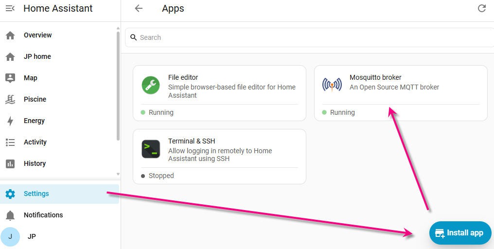

    Adding a MQTT broker in HA
    Follow this tutorial into Home Assistant
    • Add the Mosquitto broker : Settings >Apps > Install App and select Mosquitto broker and run it
    • Go to Settings > Devices & services.
    • In the bottom right corner, select the
       Add Integration button.
    • From the list, select MQTT.
    • Follow the instructions on screen to complete the setup.

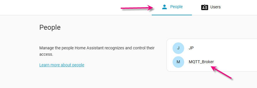

    For MQTT broker to be allowed to speak to Home Assistant it must be declared as a "user"
    So add a new user (MQTT_Broker) and enter its credentials (same as the ones you have choosen when compiling the firmware)

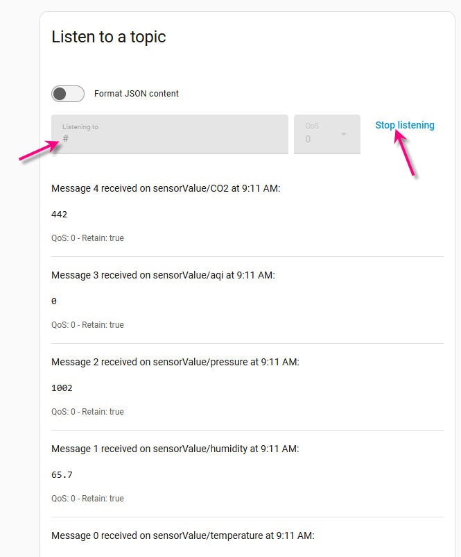

    Your broker is now ready to listen to messages. click on it and try to listen to "all messages" by typing "#" and start Listening
    if your AirQuality station is running then you should see the sensors coming every 5 minutes !

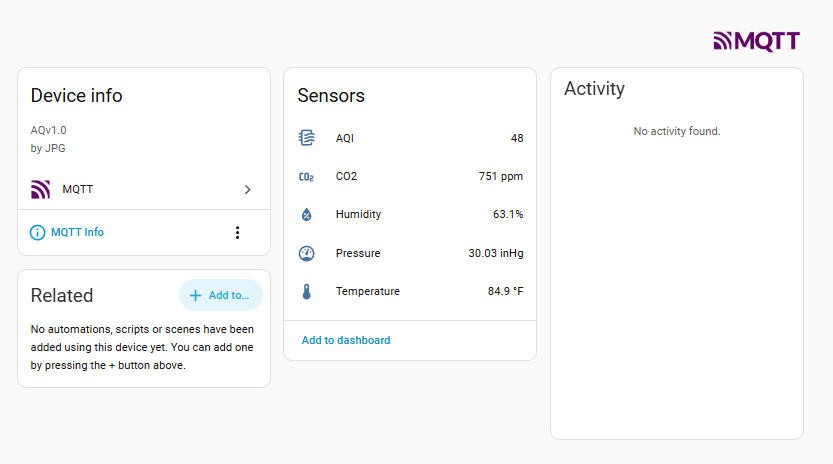

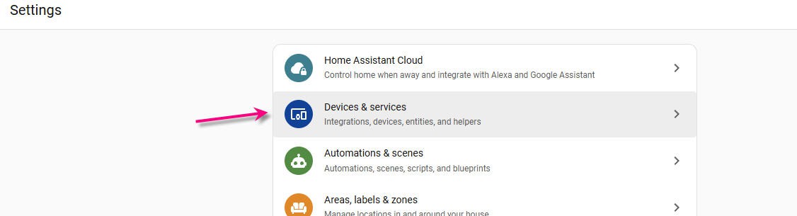

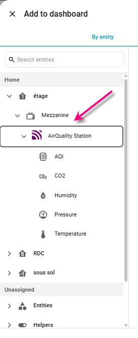

    sensors integration

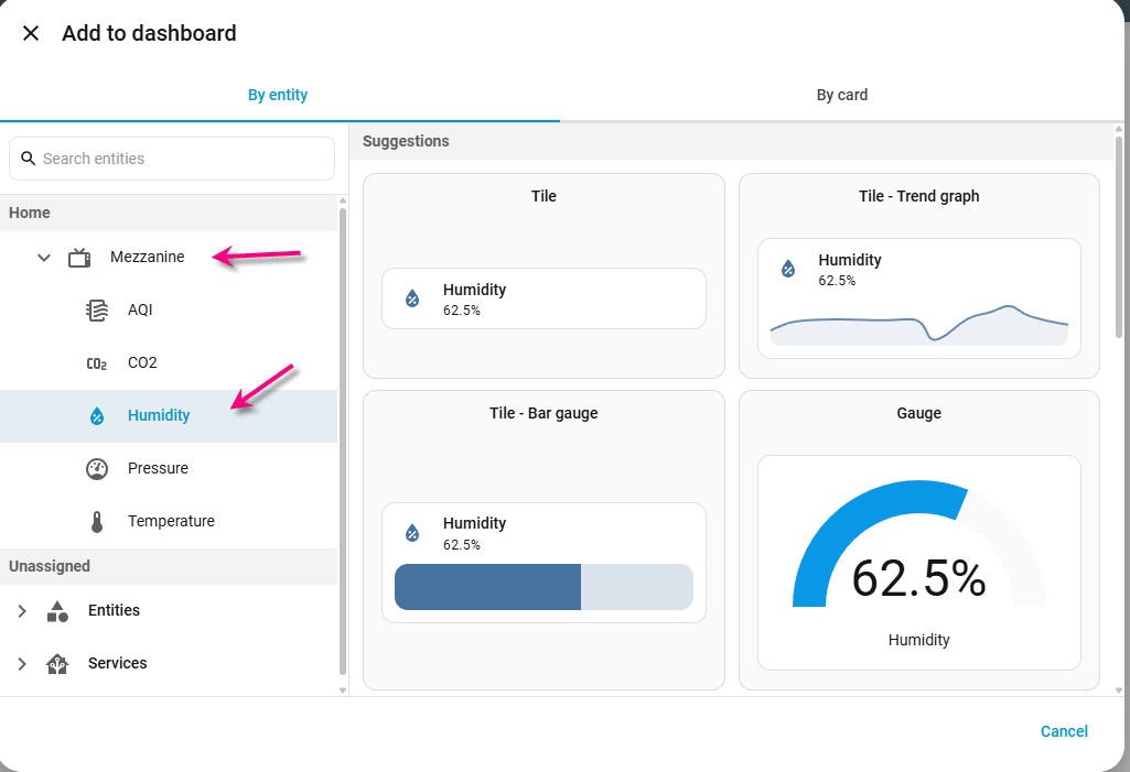

    The most easy way to select your new sensors is to go to Settings >Devices and services then select "devices",  and you should see your new AirQuality sensors.
    You can then add the to any area you want (I have choosen "Mezzanine" which is at the first floor !)
    When added to an area then click on it, into the main screen, and you will see sensors attached to this area

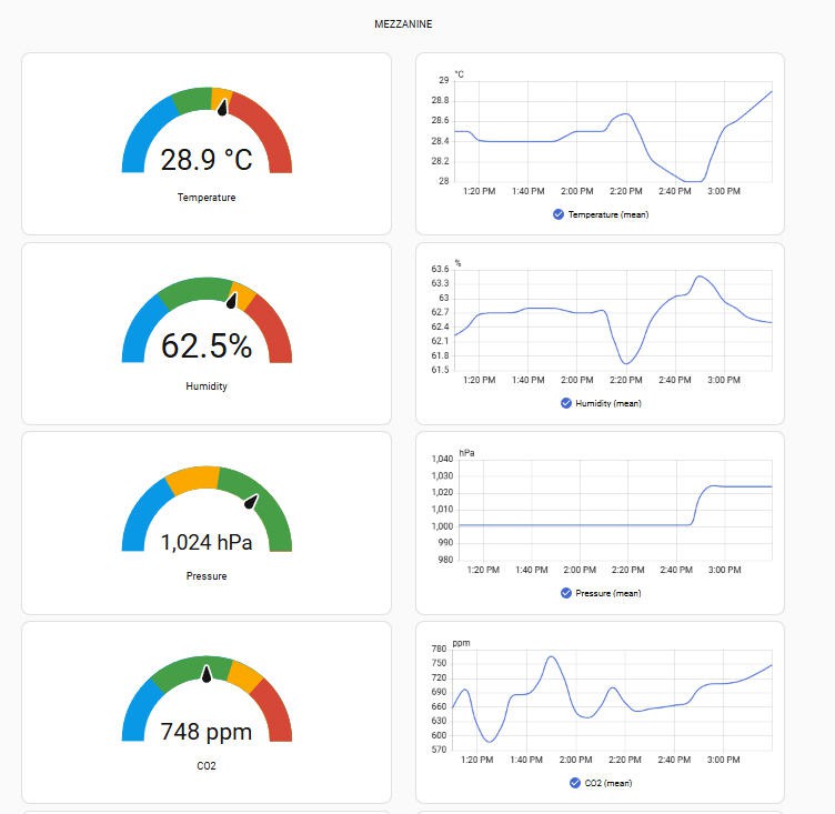

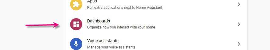

     Going further
    You have now access at the full power of Home Assistant!
    You can create a new dashboard
    then add any view you want
    And finally get the "perfect dashboard" ! (don't look too closely at the pressure chart... I changed the "sea level" value around 3pm !)
