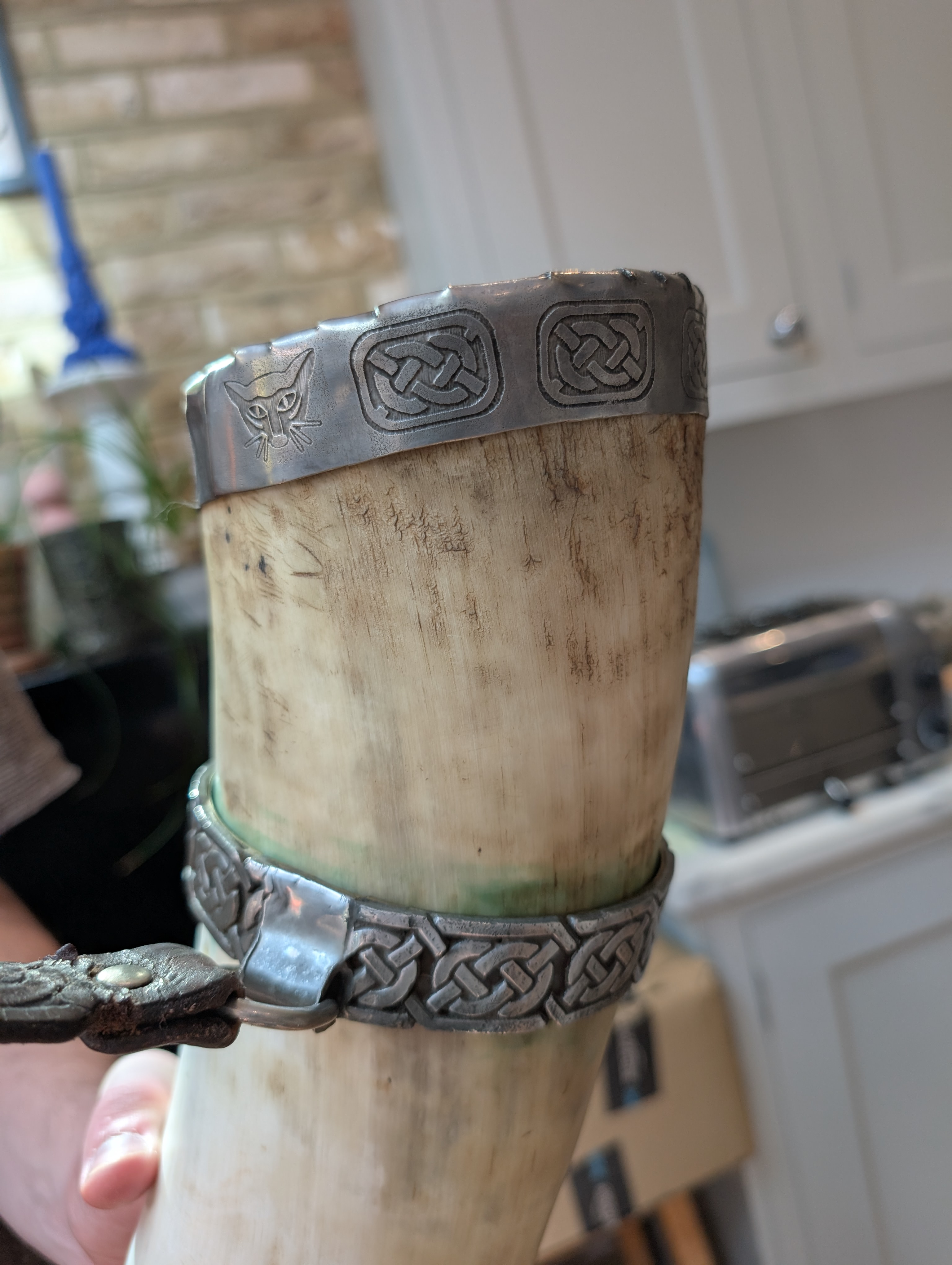

My son is at university and his club has a drinking horn that's been in use for a couple of decades. It has a leather carrying strap attached to a couple of rings that we suspect are nickel-plated copper or brass. The two bands look like cast metal — the mould was some kind of Celtic or Viking knotwork pattern. Have a look at the photos and decide for yourself.
The existing carrying ring on the horn — cast Celtic knotwork, and the inspiration for the pattern we etched into the new rim cap

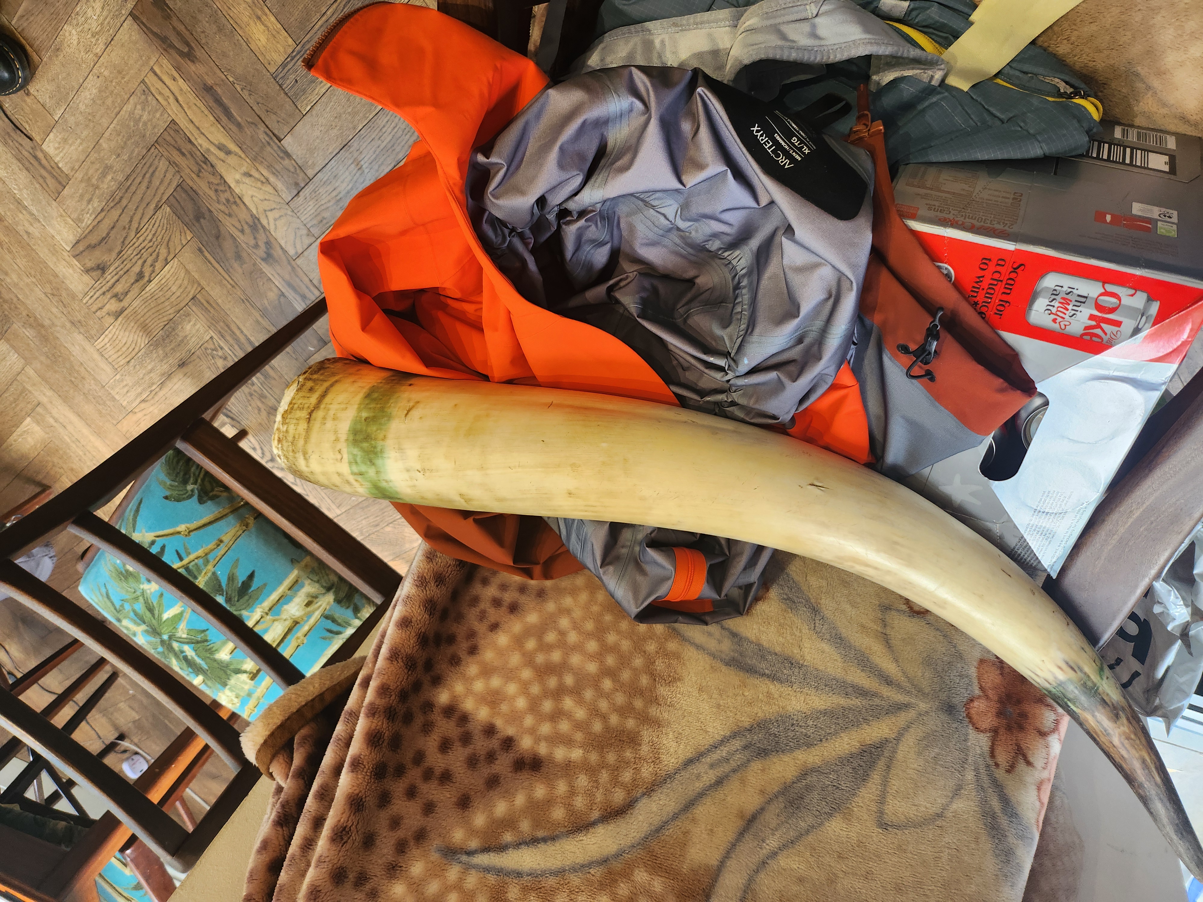

But the rim of the horn was becoming damaged and delaminating due to blows and general wear and tear. One option was to cut a few cm back to fresh material — but that road goes nowhere, and the new rim would just suffer the same fate. So we decided to take on a little metalwork and electroplating project.
The drinking horn before any work — visible green discolouration and damage at the wide rim end

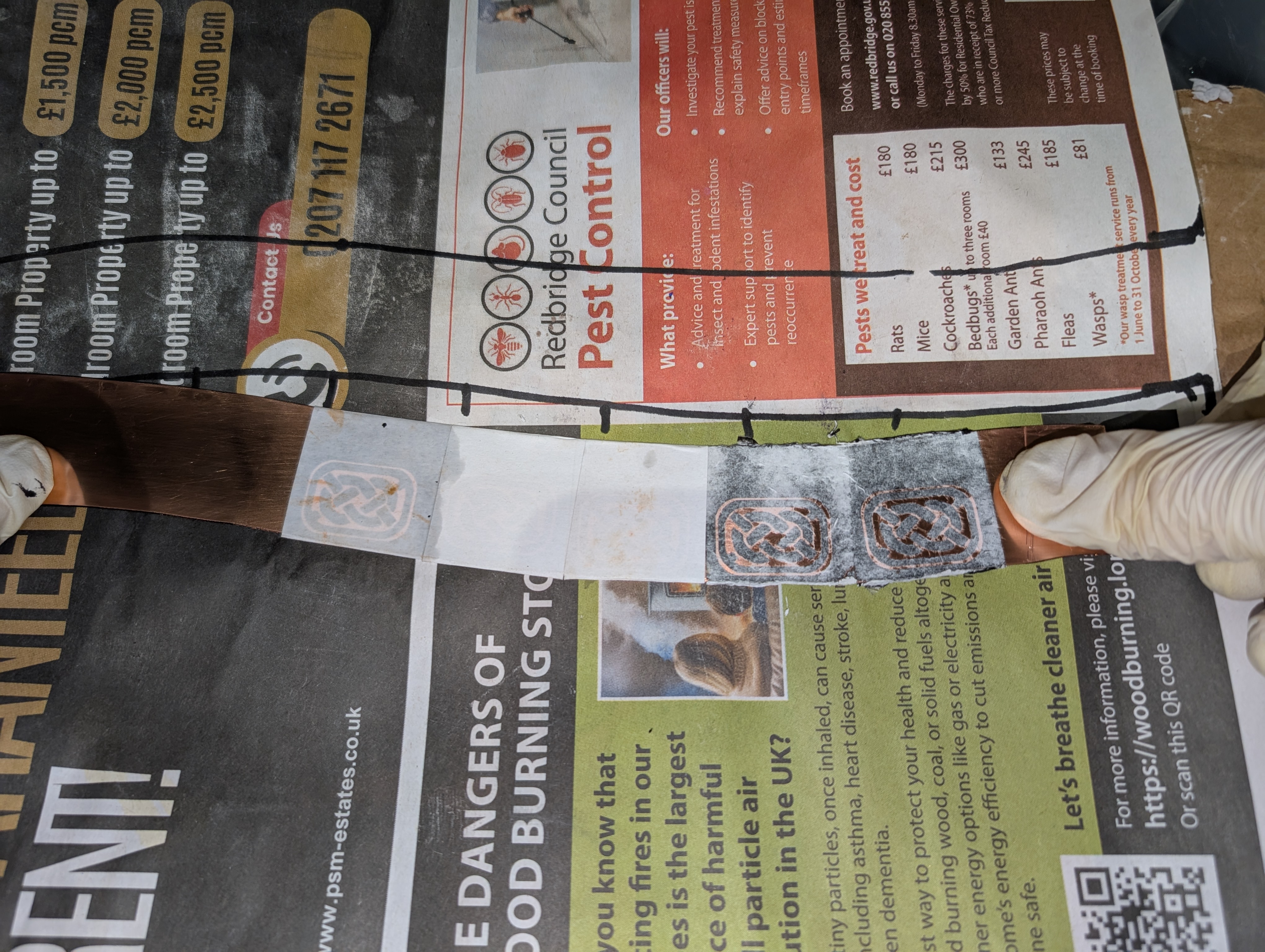

The approach we kept reading about was to print the design onto paper with a laser printer, then transfer the toner onto the copper as an etch resist. We bought a cheap Brother laser printer for about £50.
Iron-on transfer — print the design, place face-down on copper, iron the back to release the toner. Did not work at all for us, though it apparently works for others. Complete fail.
Pure acetone transfer — print the design, place face-down on cleaned copper, wet with pure acetone and rub until the toner releases. We failed time and time again with every paper type we tried — glossy, cheap A4, magazine covers. The toner just wouldn't release cleanly.
Three toner transfer attempts on copper showing partial, smeared and inconsistent results — typical of the failed methods

The Magic Trick: 50/50 Acetone and Water
Then I came across a comment in a video online. Someone mentioned that pure acetone didn't work for them either — but a cheap nail varnish remover had. What was different? It was diluted with water.
We tried mixing our acetone 50/50 with water. After days of failure, it just started working. It really was like magic.
The method: print your design onto cheap A4 paper (thin magazine pages would probably give an even cleaner result — smoother surface, better release). Place face-down on the copper, wet with the 50/50 solution and rub gently until the acetone evaporates. Then take it to the sink and rub under running...
