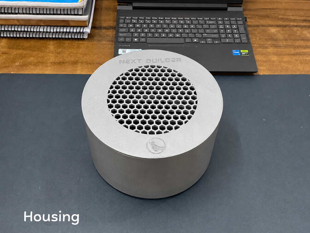

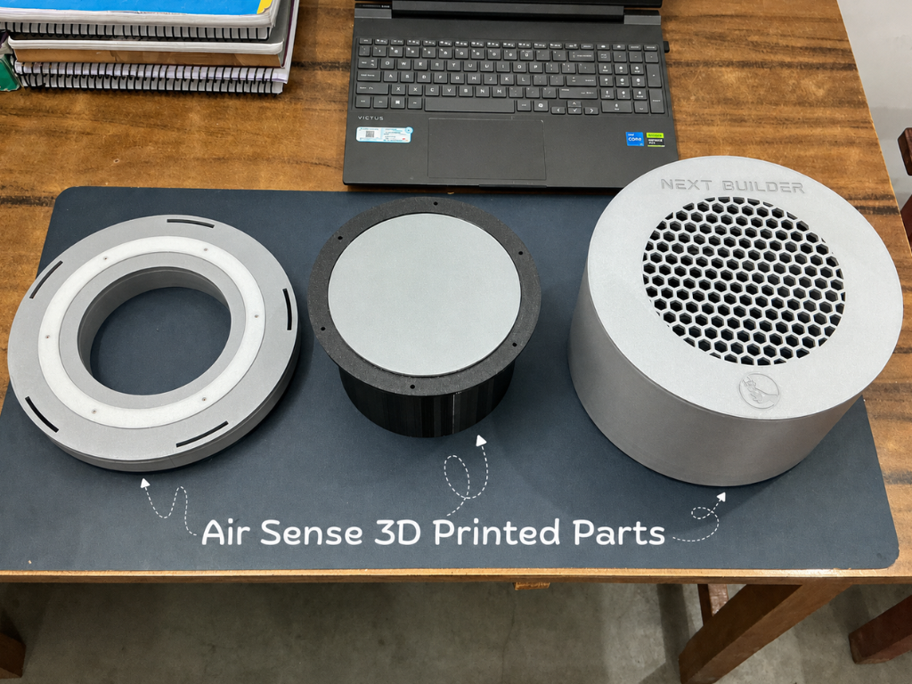

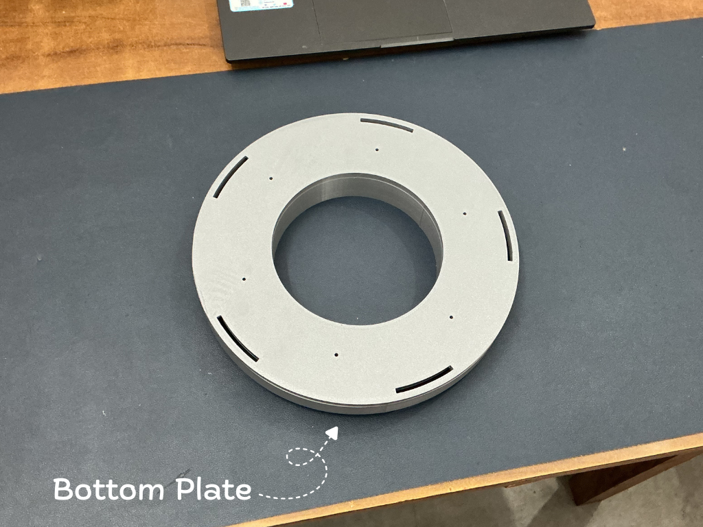

    1. Housing

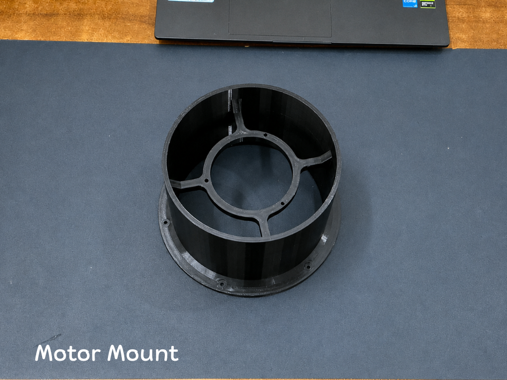

    2. Motor Mount
    3. Filter Base
    4. Bottom Plate

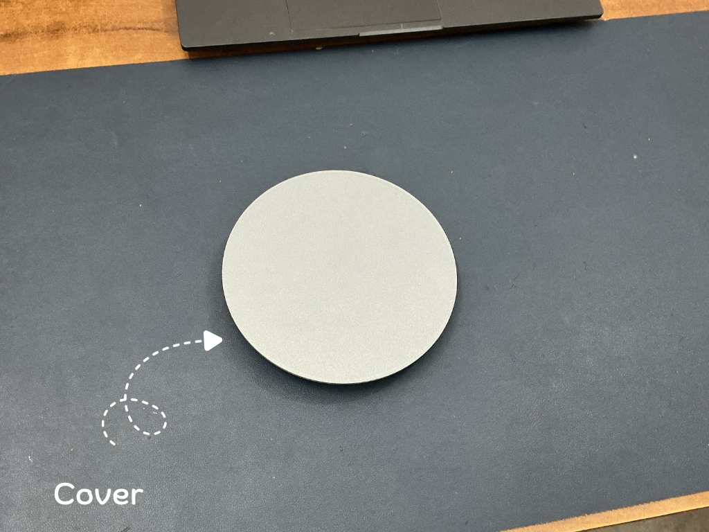

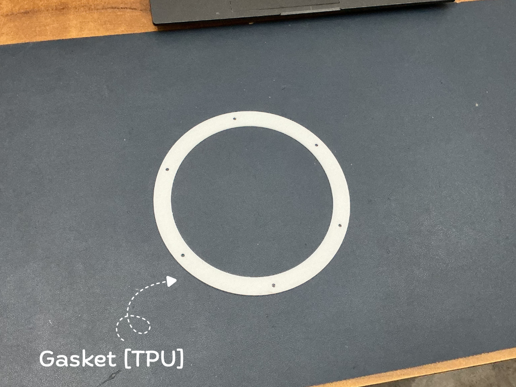

    5. TPU Gasket
    6. Display Cover

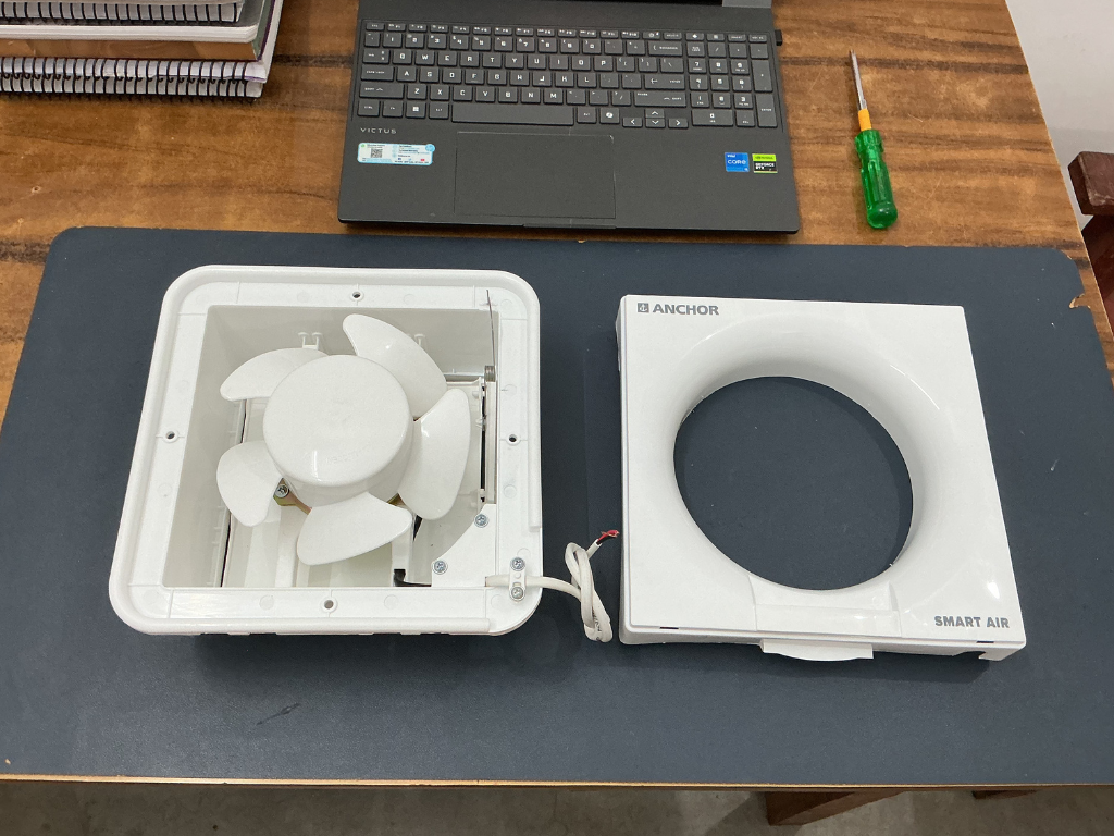

    Disassemble the Exhaust Fan

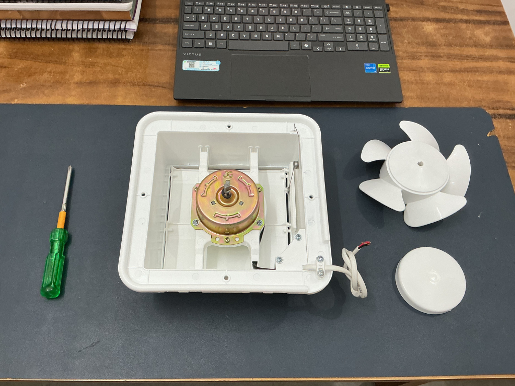

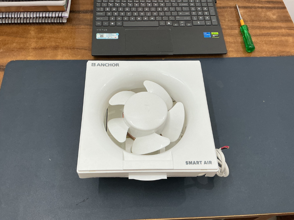

    To begin the assembly process, we first need to disassemble the 150 mm Anchor Smart Air exhaust fan and remove the parts that are not required.

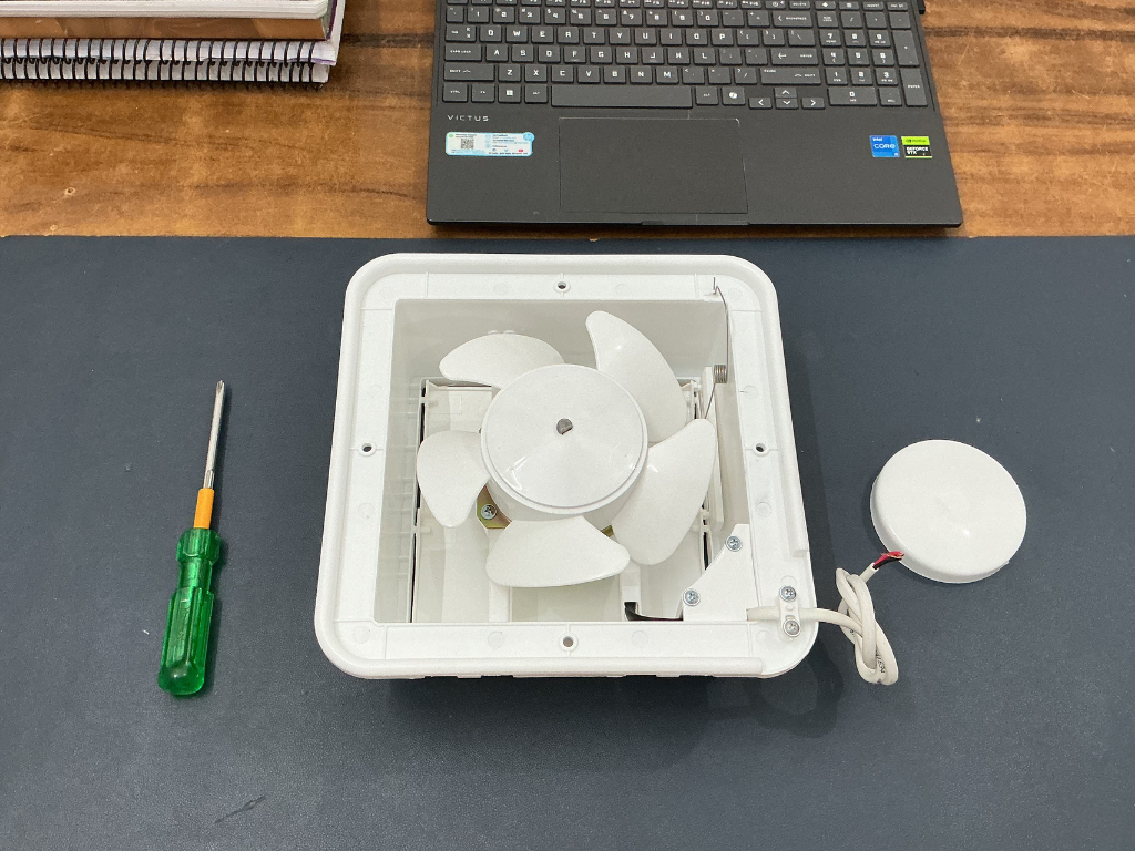

    Start by removing the front cover of the fan. Next, carefully remove the center cap and fan blade to expose the motor assembly inside.

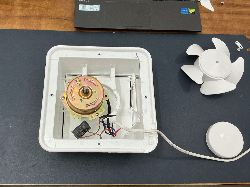

  • 3

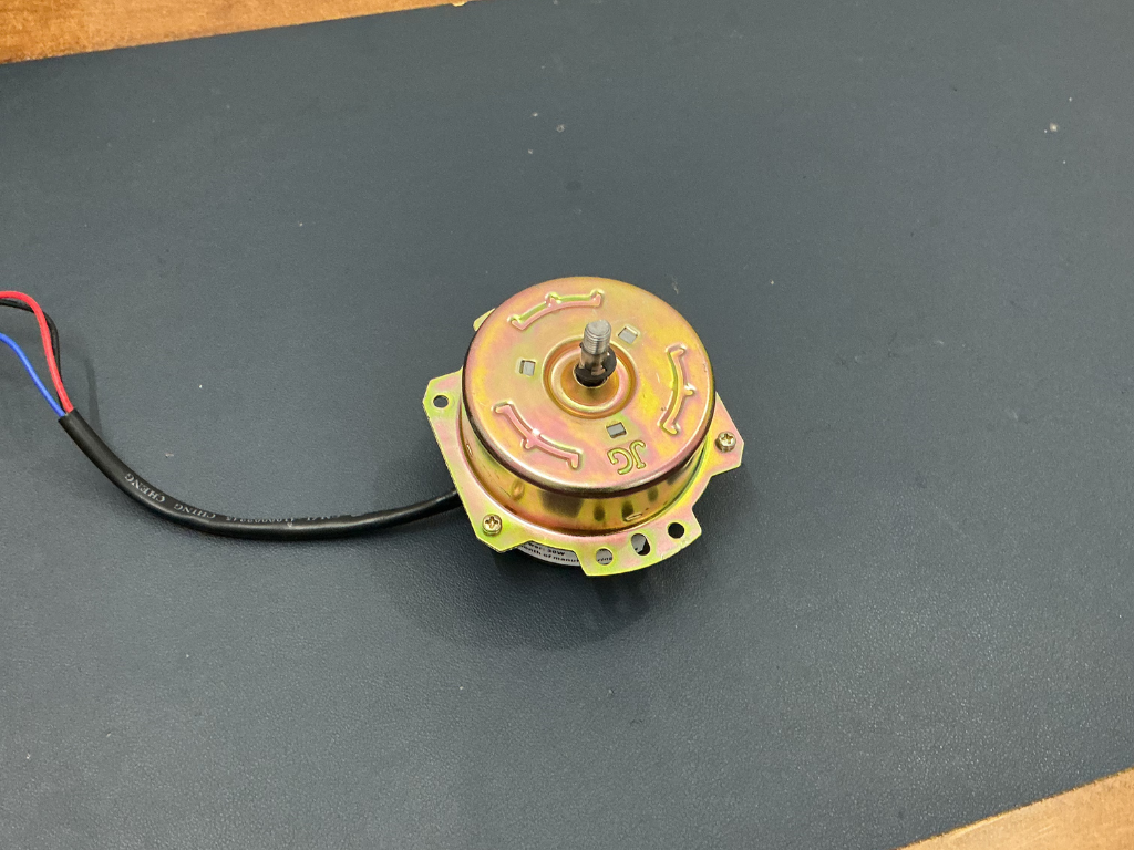

    Remove the Motor
    Start by unscrewing the motor from the fan housing. Once the mounting screws are removed, carefully disconnect the wires and lift the motor out of the frame.
    Since the original fan housing is no longer needed, it can be set aside. For this project, we only need the motor nad the fan blade, as it will be installed into the custom 3D-printed motor mount designed for AirSense.
