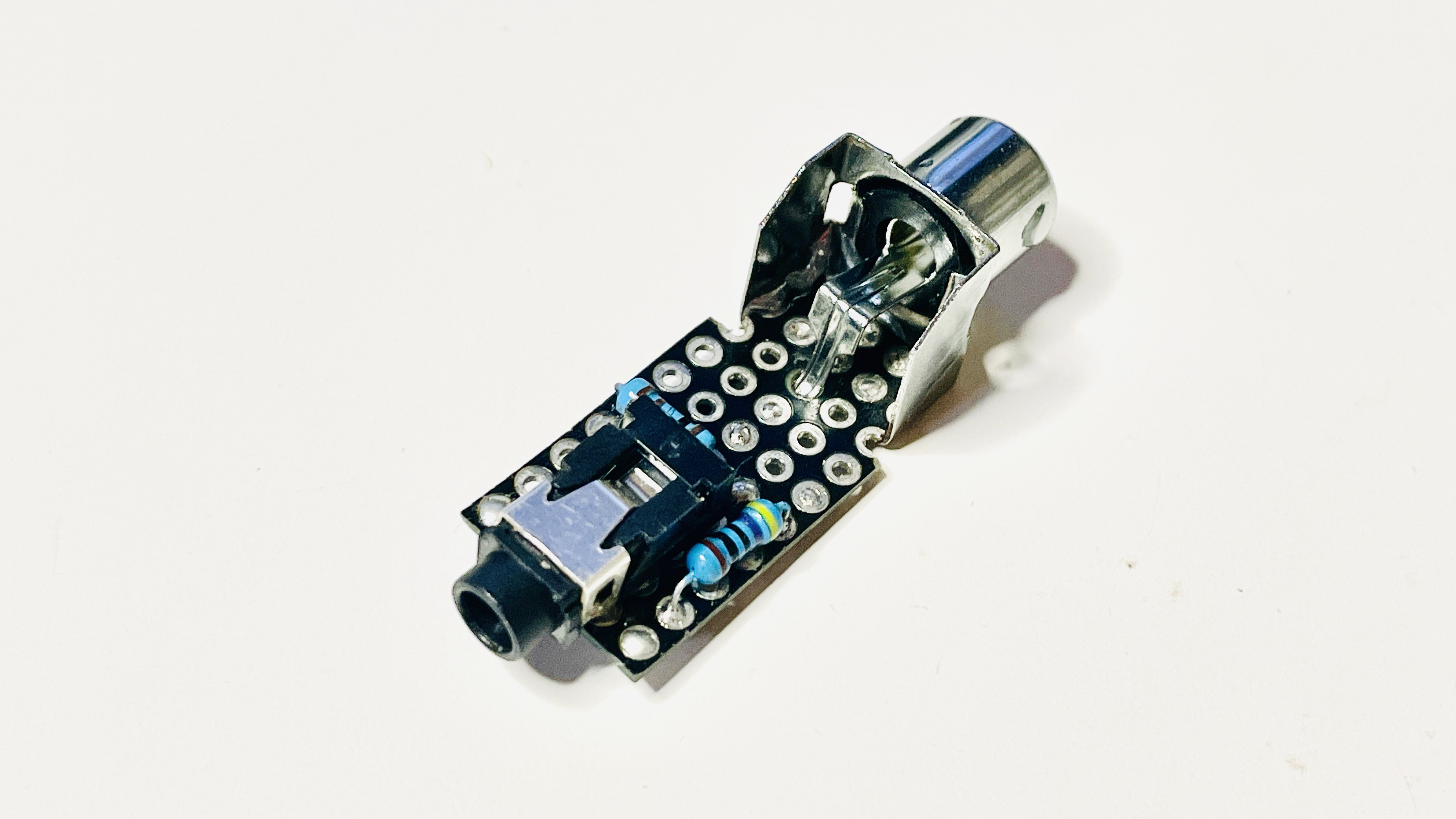

    After several iterations, the circuit was reduced to a compact passive mixer built on a small piece of perfboard.
    The final circuit consists of:
    • 3.5 mm audio jack
    • RCA composite video connector
    • 470 Ω resistor (video / luminance channel)
    • 1 kΩ resistor (sync channel)
    Connections are as follows:
    Audio Output
    Tip (L)  ---- 470Ω ----+---- RCA Center (CVBS)
    Ring (R) ---- 1kΩ -----+
    Sleeve (GND) ---------- RCA Shield (GND)
    The entire converter fits on a small perfboard and contains no active components.
    This hardware directly implements the NTSC audio-encoding method used throughout the project:
    • The left channel carries the video (luminance) signal.
    • The right channel carries the synchronization signal.
    • Both channels are resistively mixed to generate a standard NTSC composite video signal.
    Compared to the original breadboard prototype, the final version is more compact, mechanically robust, and suitable for long-term use.
    Photo: Final Audio Jack → NTSC converter board. The RCA connector, audio jack, and two-resistor mixing network are mounted directly on a small perfboard.
    This circuit serves as the final reference hardware for the project. It is compatible not only with playback from the Spresense Hi-Res Audio Player, but also with all NTSC RAW video data generated by the project, including both 192 kHz and 384 kHz formats. Any compatible playback platform can use this circuit to convert the encoded audio stream into a standard NTSC composite video signal.

    3.3 Circuit
    Just 2 resistors.
    Headphone Jack:
    L (tip) -> 470 ohm -> RCA center pin
    R (middle) -> 1k ohm -> RCA center pin
    G (sleeve) -----------> RCA GND
