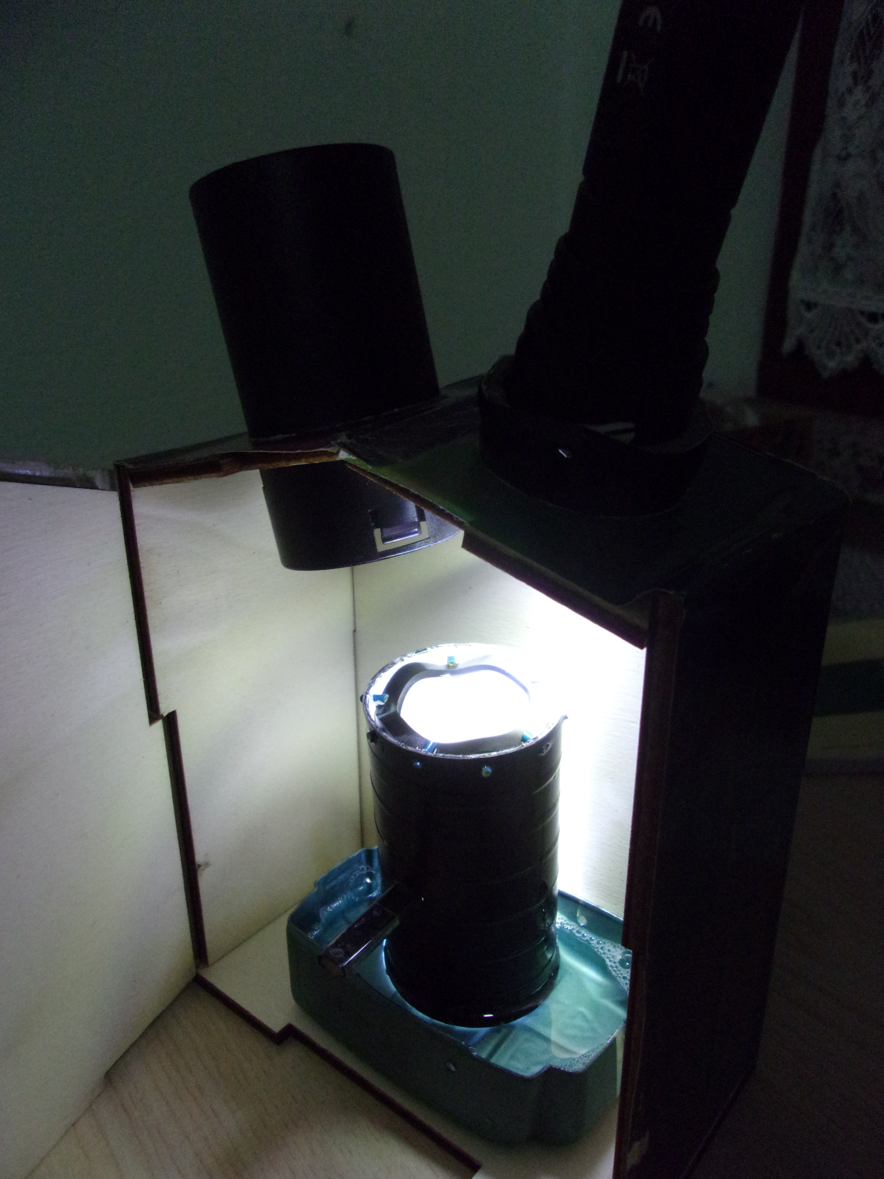

Image 6: The film generation system. Left: the soap film holder — a 50mm diameter, 100mm long plastic tube with a crossing pivot that sticks out of each side of the box. At the top (and at the bottom, not visible in the photo), a gasket is mounted in a deliberately undulating (rather than flat) configuration; this subtle waviness in the film surface adds complexity to the projected image, producing richer and more varied colour patterns. To charge the film, the tube is briefly dipped into the soapy water tank (right) then raised and placed vertically. A fresh soap film forms across the gasket, and the reflection of the flashlight on it is projected outside.
Image 7: The lamp fully assembled, with one side panel opened to reveal the internal layout. The soap film holder sits inside the soapy water tank at the bottom of the box, with the freshly formed film glowing brilliantly under the focused flashlight beam from above. The lens tube (top left aperture) is positioned above the film, ready to project the interference pattern outward. Once the final panel is closed, the box becomes a "lanterna magica" — and the show begins on the wall.

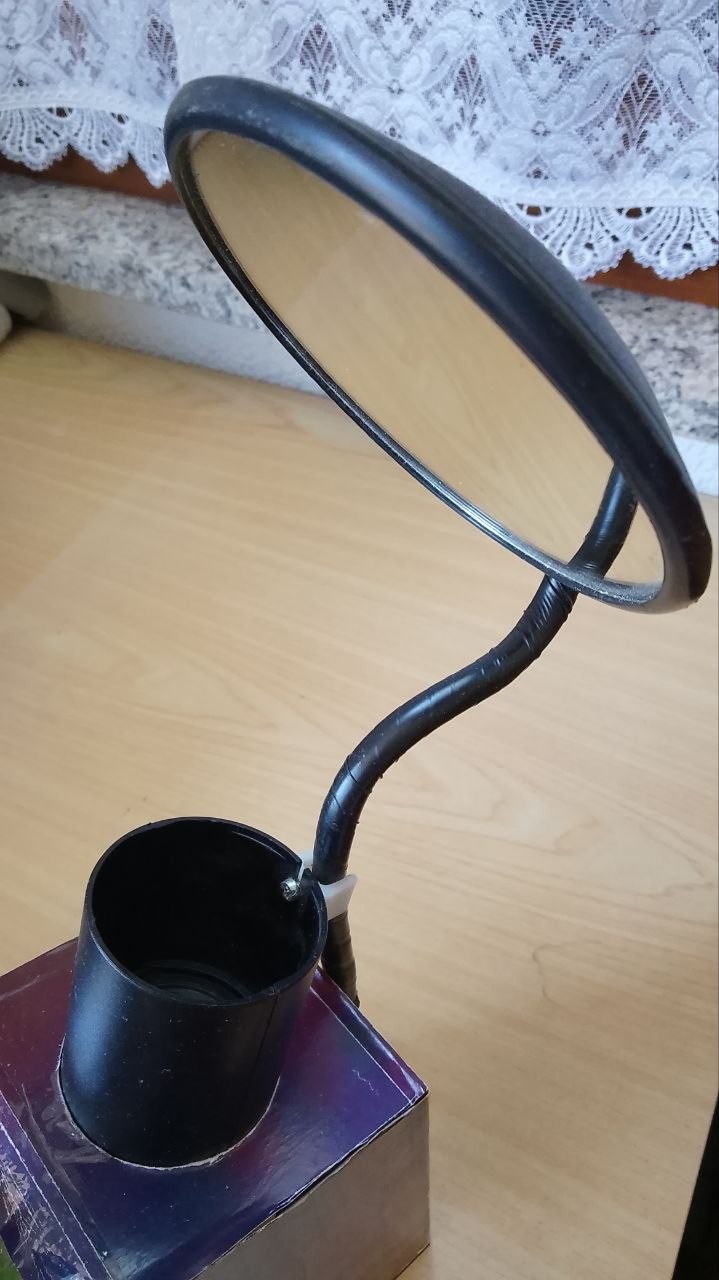

    One limitation of the original design was that the projection naturally falls on a horizontal or near-horizontal surface. To cast it onto a vertical wall — a much more practical target for ambient or therapeutic use — I added a convex mirror sourced from a standard bicycle rear-view mirror (the original mounting bracket removed).
    The mirror is held by a custom support made from a length of thick iron wire threaded through the sheath of an electrical cable. This gives the arm structural rigidity while remaining malleable enough to be repositioned freely — the mirror can be angled in virtually any direction without tools. The arm slots into a small C-shaped retaining clip fixed near the rim of the lens holder, and rests against the side of the box for stability.
    The convex geometry of the mirror serves a dual purpose: it redirects the projection onto a vertical surface, and simultaneously enlarges it slightly — a welcome bonus requiring no additional optics.
    The result is a simple, tool-free attachment that significantly expands where and how the lamp can be used.

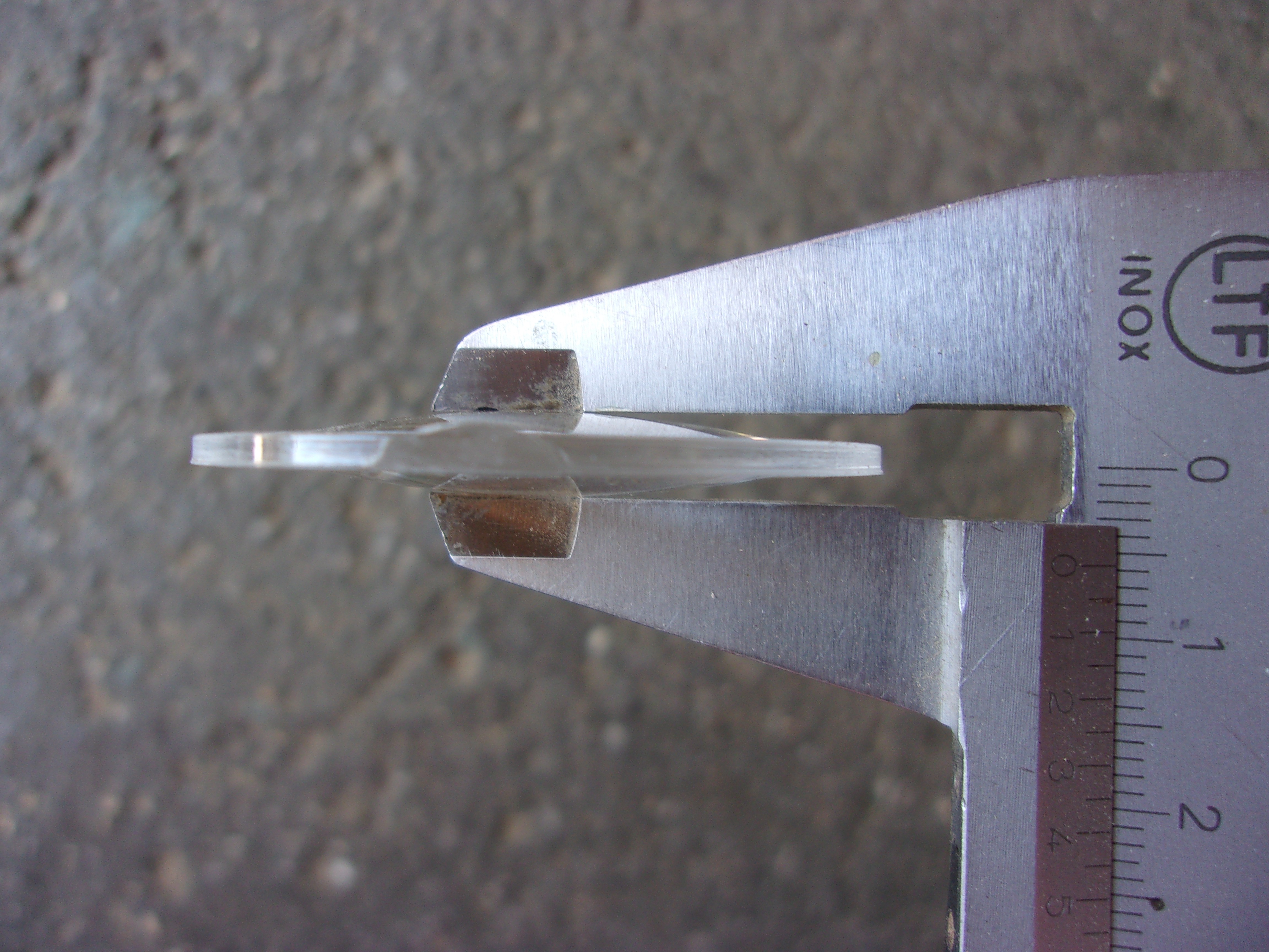

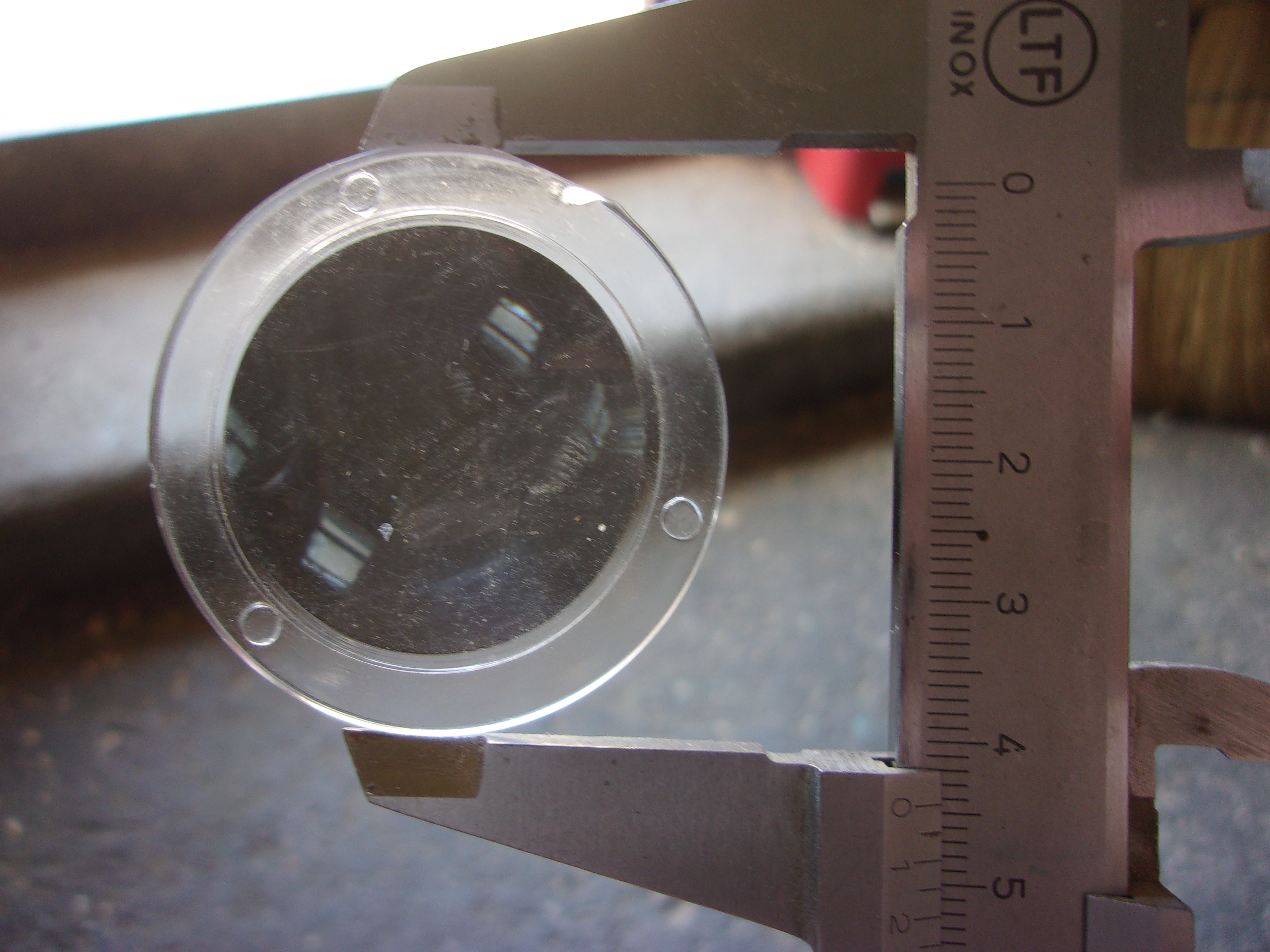

    I've only just realized I didn't provide enough information about the lens: here are the full specs, measured with a caliper and verified experimentally.
    The lens is a biconvex acrylic lens — the classic double-convex shape, thicker at the centre and tapering symmetrically toward the rim. It sits in a plastic mounting frame which fits into the lens holder tube.
    Measured specifications:
    • Type: biconvex, acrylic
    • Optical aperture (lens only): 31mm
    • Total diameter including frame: 43mm
    • Frame width: 6mm
    • Centre thickness: 5.8mm
    • Edge thickness: 2mm
    • Focal length: 70mm
    I sourced my lens from a scientific toy — the manufacturer was kind enough to send me samples, but I'm not in a position to name them here. The good news is that an equivalent lens is easy to find: search for "biconvex lens 30mm 70mm focal length" on AliExpress or similar platforms, or consu
    lt optical suppliers such as Thorlabs or Edmund Optics. The exact dimensions don't need to be identical — some experimentation with the tube length will compensate for small differences in focal length.
