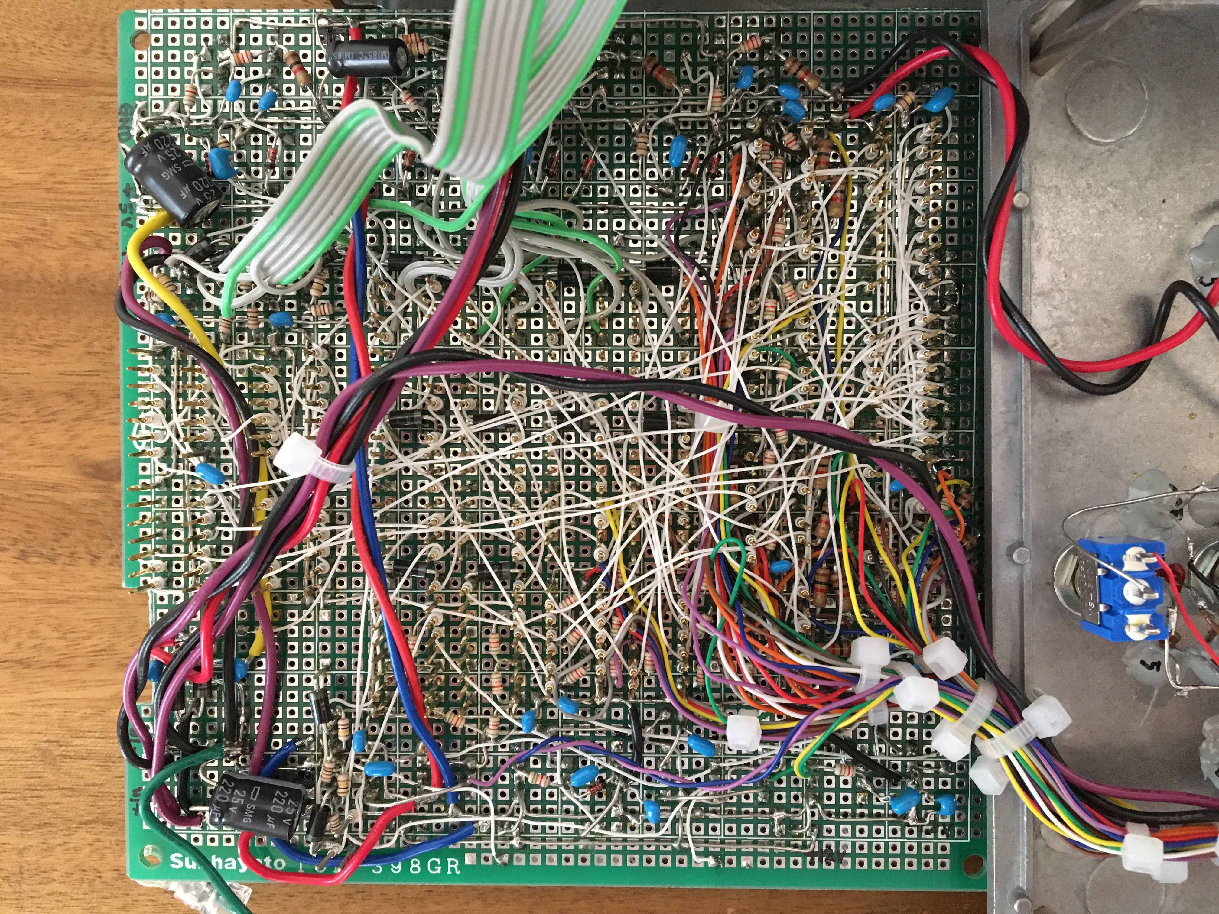

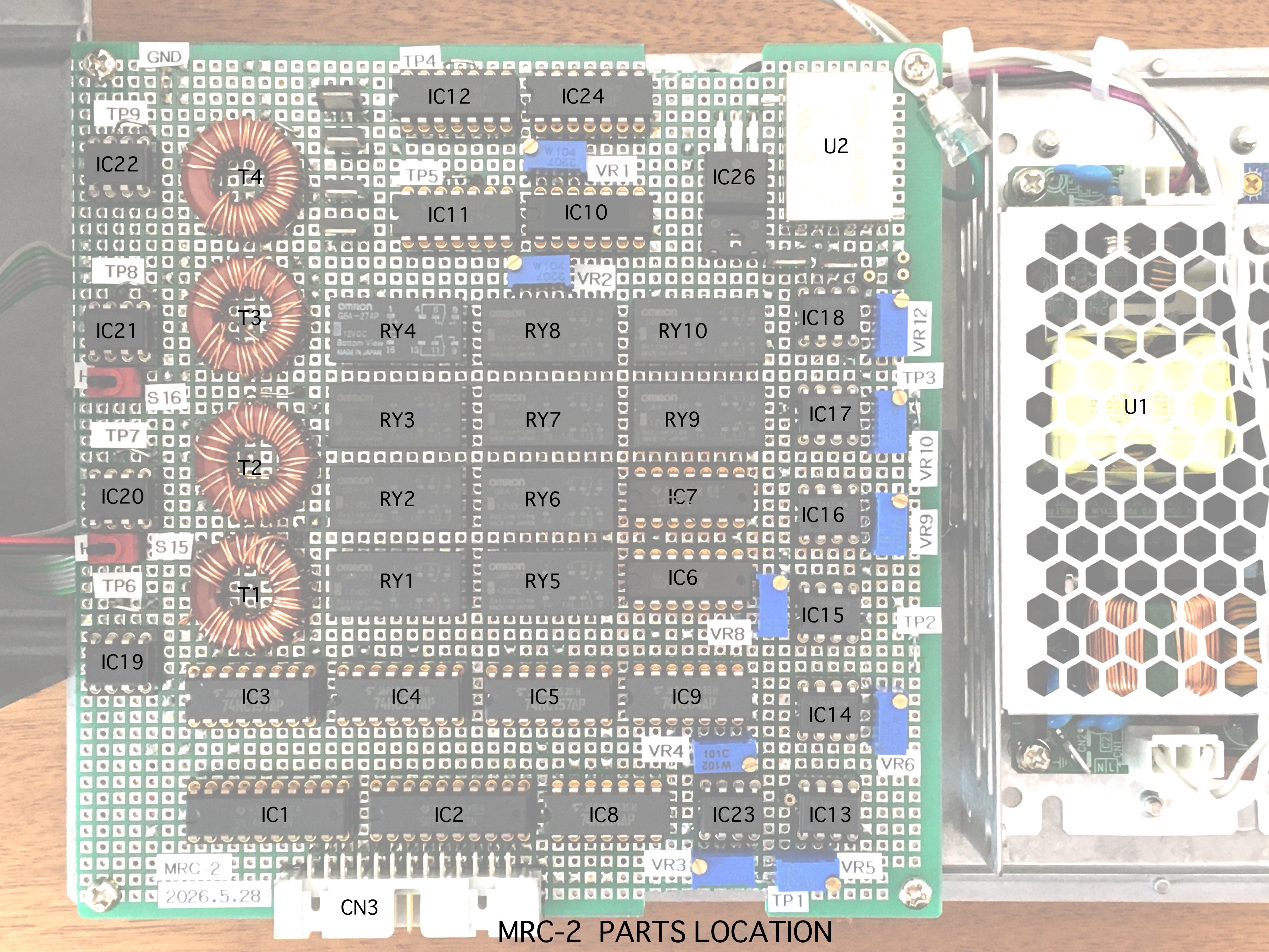

2. MRC-2 circuit board
Figure 4 shows the MRC-2 circuit board. The rightmost section of the board contains the analog PWM driver circuits for the two channels. In the center of the board are 10 relays: 2 are used for acceleration and deceleration control of the PWM drivers, 4 are used to select the driver for each section, and 4 are used to select the direction of travel for each section. The leftmost section of the board contains the block detection circuits for the four channels. The toroidal transformer is used to detect pulse currents for block detection.
    The bottom edge of the board contains a standard logic IC circuit for the 8-bit parallel interface connector, configuration registers, and data selector. The top edge of the board houses the turnout drive control circuit. The right side of the top edge of the board contains the local regulator circuit, while the right side outside the board houses the 16 V, 4 A main switching regulator. All of these circuits are housed in a HAMMOND 1550G die-cast aluminum case (222 mm x 146 mm x 55 mm). The full circuit diagram is in the attached file. The component layout figure and the wiring side of the circuit board photo are also in the attached file. In the following chapters, I will explain the...
