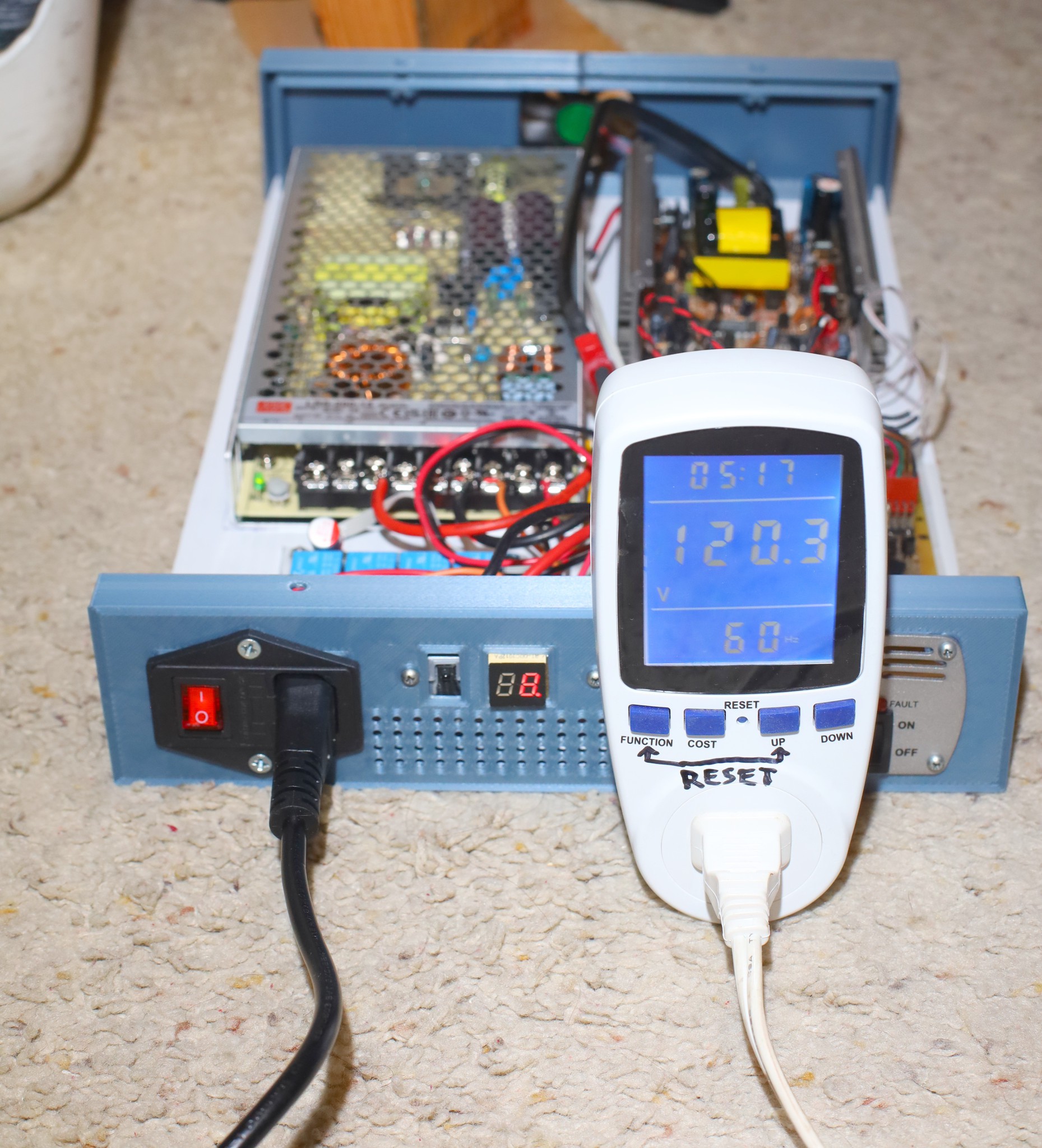

    lion mclionhead07/17/2026 at 19:54 0 comments
    A diabolical algorithm emerged whereby the transformer would always run at maximum.  The variable feedback resistor would go away.  The microcontroller would sample the peak voltage & modify the duty cycle based on the user setting.  It wouldn't be as configurable as modifying the transformer output, but it would allow the full range of variable RMS voltages.
    There was a sag when powering the blower, so it would entail either feedback based on voltage samples or dialing in the duty cycle just for the blower. Noted the latched up voltage was 140 while the maximum voltage possible with feedback resistor was 125.  It was relying on a backup overload protection to limit the voltage in its latched up state.  It might have just blown up from being run on 15V.
    Noted when the load was taken away, the latch up condition went away.   It didn't depend on writing the feedback resistor or shutting down the waveform.  The transformer controller was just sensing the load & beyond a certain point, locking on full until the load got below a certain point.  Confirmed with the stock 15k feedback resistor reinstalled, the transformer went to full power when the load got above 30W.  It was intended to rely on chopping the waveform for voltage regulation.
    Confirmed to get 90W to the blower, the inverter had to suck 117W in.  Surprised a battery powered inverter was that bad.  The meanwell was rated at 90%.  That left 13% for the inverter, fan, LEDs.  All the off grid tubers would be better off running directly on DC than their sponsored inverters.
    Basically, you'd be better off running the blower at full power than converting manes to 15V to 110V to try to save electricity.  Since it was reduced to chopping a waveform instead of converting a voltage, it was as noisy as a dimmer switch.  It was time to pack up the inverter idea & go to a remote controlled dimmer switch.

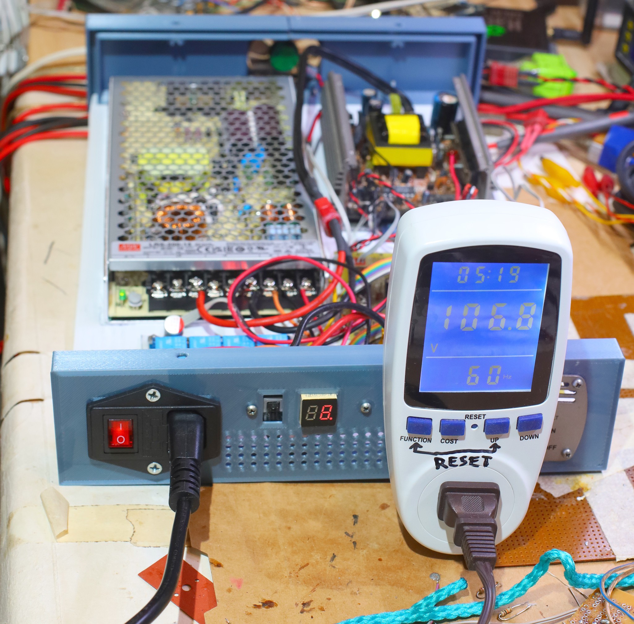

  • Inverter fail
    lion mclionhead07/17/2026 at 06:26 0 comments

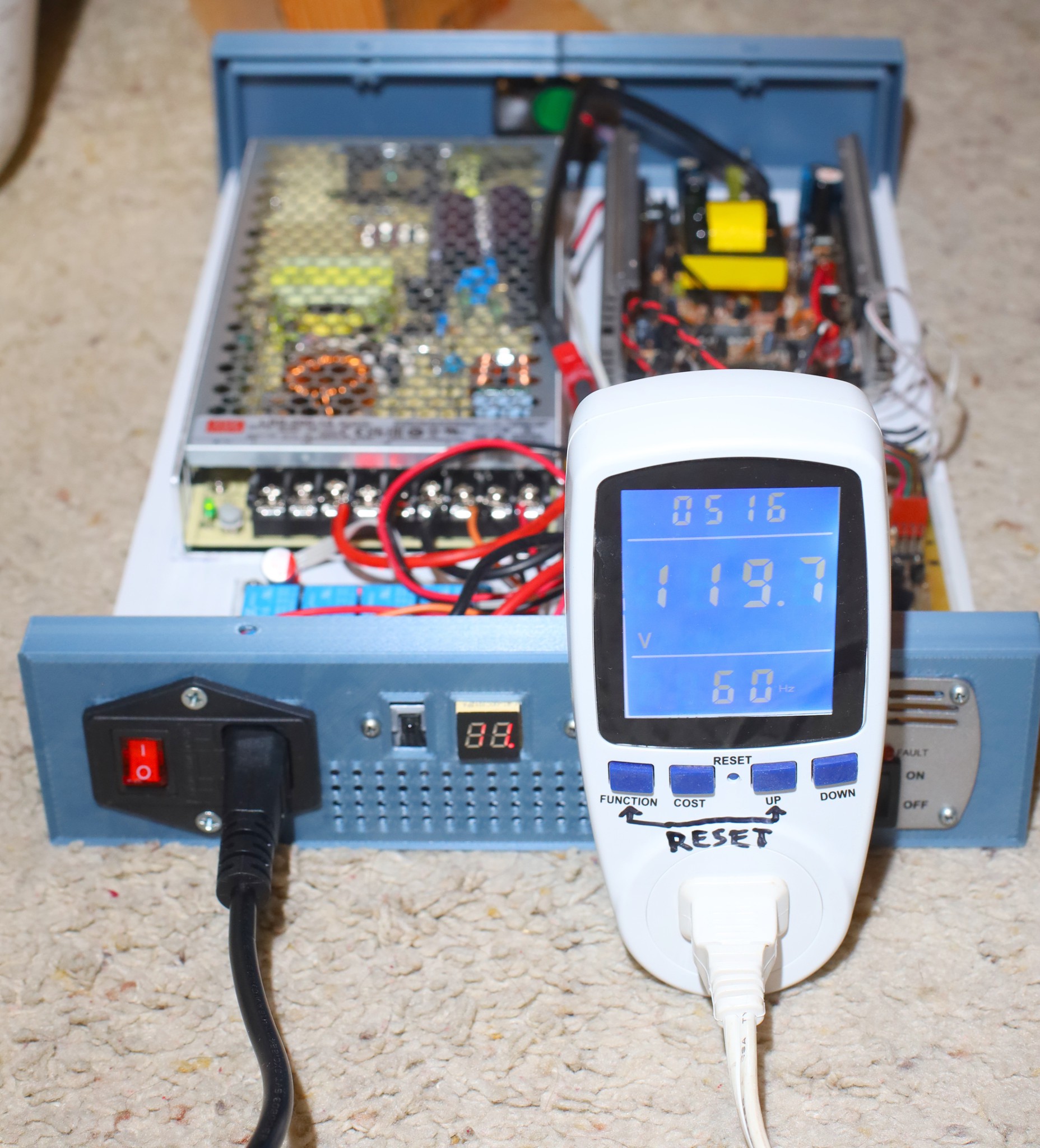

    Finally hooked up the manes bypass & full PG&E without any explosion.  Set the meanwell to 13.2V.  Made it default to off when powered on.  Fortunately, put in enough connectors to allow a reprogram without manes voltage.  Only the relays & user interface had a soldered umbilical.
    It successfully dimmed a 10W LED & a 25W fan, but
    it always ran the 100W blower at 120V for all resistor settings above 7.  Once above 120V, no settings would get the inverter below 120 until cutting the relay & letting the blower spin down.
    The manes bypass gave it 119.  The fan had a power factor at .94 & the blower was .94.
    The inverter seemed to latch up when the blower got above a certain RPM.  Setting the meanwell to 15V made the inverter latch up to its 139V backup failsafe.  The relay had to be cut & the blower had to spin down to get anything below 139.
    A measurement of the voltage drop across the digital pot showed it was still working.
    A 33W monitor with .94 power factor got the inverter to latch up.  A 60W incandescent light with 1 power factor got it to latch up.  A 55W CFL got it to latch up.  40W incandescent light worked perfectly.  The winner was a crusty 32W CFL with .45 power factor latching it up for all resistor settings.  The Mastech could be rigged as a dummy AC load by powering an RC fan.
    It seemed to depend on reactive power getting above a certain level, like a grounding issue.  Sadly, the surface mount board was never tested with configurable voltage powering the blower.  It was only tested with maximum voltage, then the voltage adjustment was tested without the blower before moving on to the enclosure.  For reactive loads, the inverter seemed to always run its DC side at full & rely on adjusting its waveform to reduce RMS voltage.  For real loads, the inverter adjusted its DC side.
    A younger lion might have limited the meanwell to limit the inverter to 120V & just lived with the balky latchup.
    Things were heading towards a completely custom transformer driver.

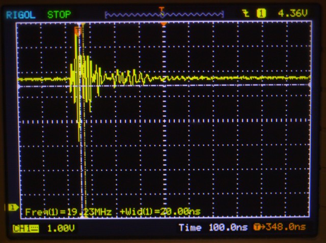

    Naturally after hooking everything up, the inverter started shutting down when the relay turned on.  They weren't previously tested together.
    1st , the relay needs star grounding & big capacitors to avoid browning out the mane board.
    2nd, a nanosecond glitch on the 5V from some kind of inductance was resetting the feedback resistor.  Not running the inverter when switching on a relay got it to stay alive.

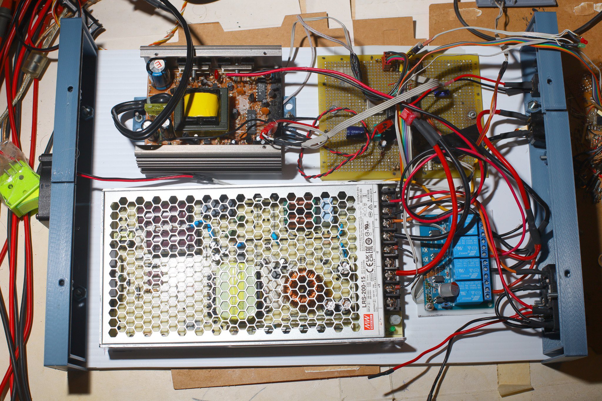

  • Enclosure
    lion mclionhead07/10/2026 at 05:40 0 comments

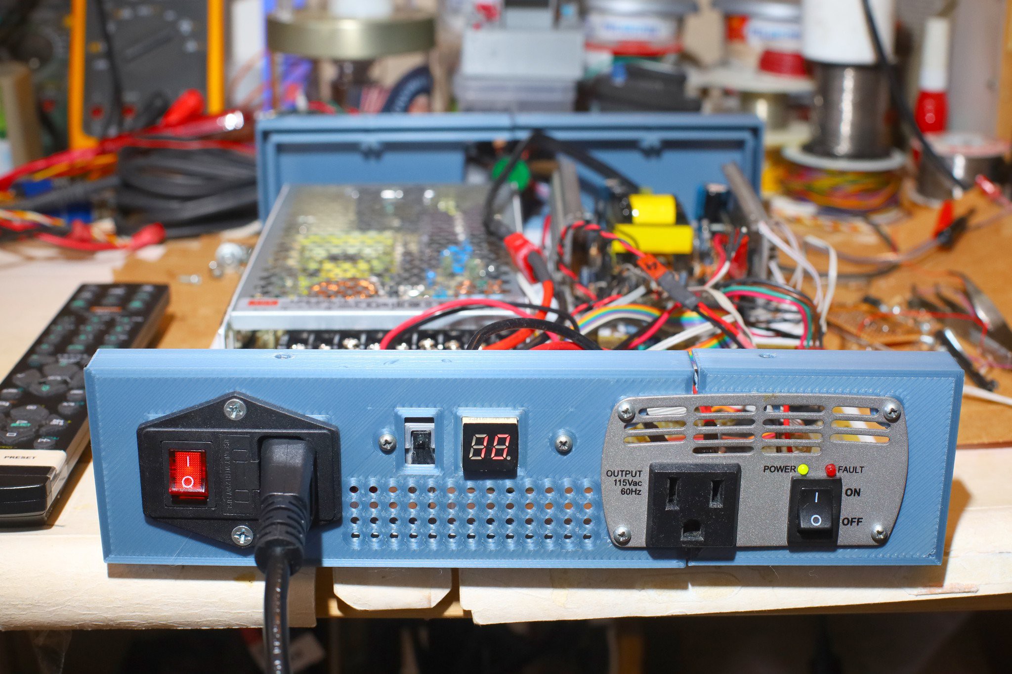

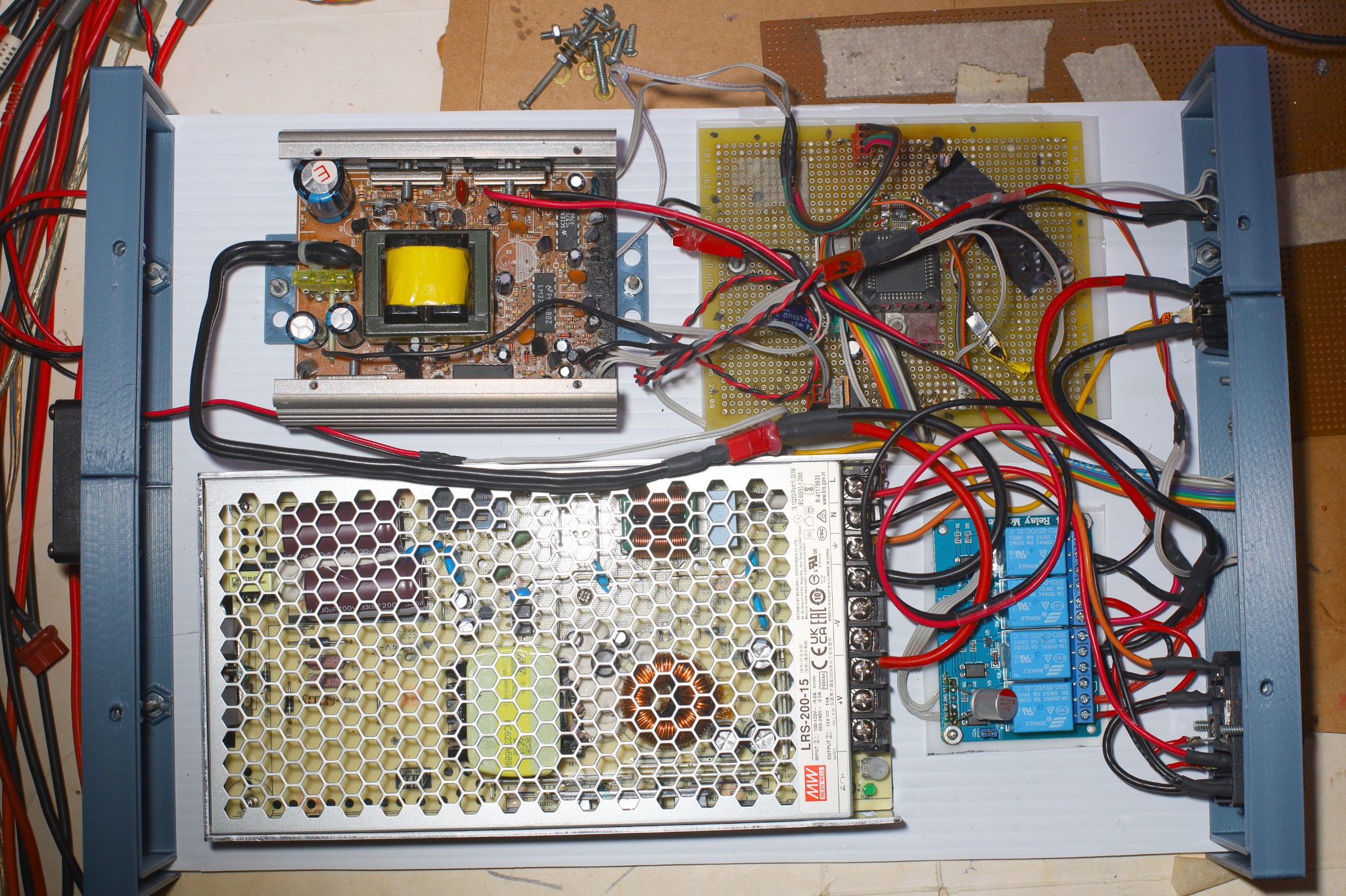

    A few pounds of PLA later, the enclosure wasn't feeling very warm & fuzzy.  Like the days when lions built H bridges from scratch, there's probably an off the shelf enclosure for a reasonable price.  It seemed to need a 2nd layer of coroplast.  It wasn't clear how reworkable it would be.  Connections would have to use screw terminals wherever provided.  A battery connector would connect the inverter + control board to the Meanwell.  Then it could be powered from the bench for testing.
    The inverter + control board + relays would have to be 1 unit because of the large number of connections.  The fan would need a connector, possibly going straight into the meanwell.  Some empty space was provided for the fan to blow into.  The fan would run continuously, since the relays get hot.
    Started pivoting back to 10 voltage steps with 10 being bypass, since battery power is never going to be used.  Nowadays, it's more common to have 12V DC fans for off grid use.
  • Relays
    lion mclionhead07/06/2026 at 08:06 0 comments

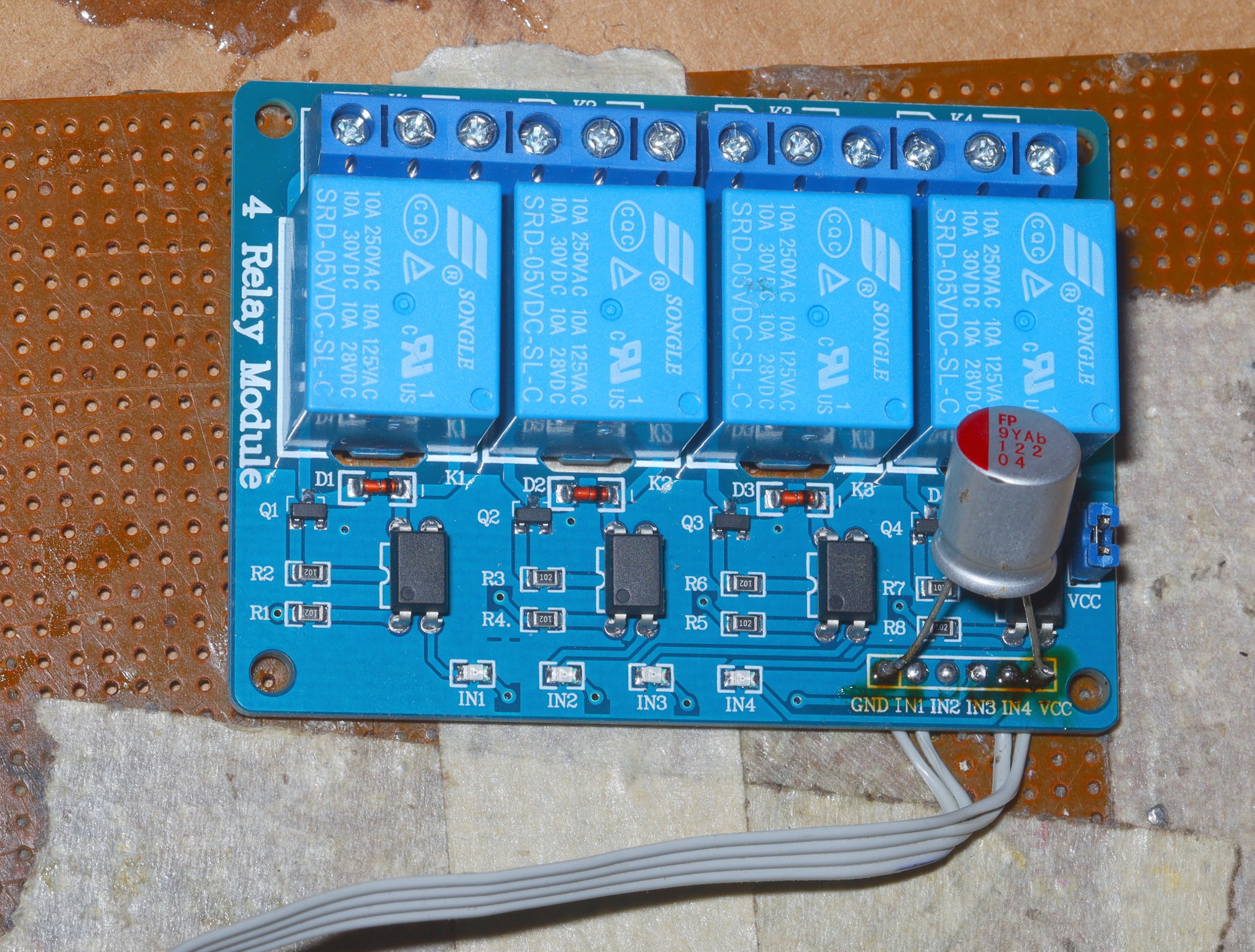

    A complicated algorithm for the relays evolved to where they're directly toggled on & off by the power button.  They connect the inverter for voltages below 11.  They connect manes for 11.  10 sets the maximum inverter voltage, which could be higher than manes, but could also be battery powered.  They wait a while in the off state when switching between relay & manes.  They always switch off with no delay.  The delay avoids back EMF & the chance of a timing glitch briefly connecting manes to the inverter output.
    Of course, the very thought of that timing glitch & the chance of a relay getting stuck has lions pondering not allowing a manes bypass at all.  The piece of mind might be worth the lost efficiency.  It needs to sense the outlet is off before powering the inverter.
    The relays suck a hideous amount of current, 75mA for each one that's on.
    Putting it all together requires mounting everything on the enclosure base plate.

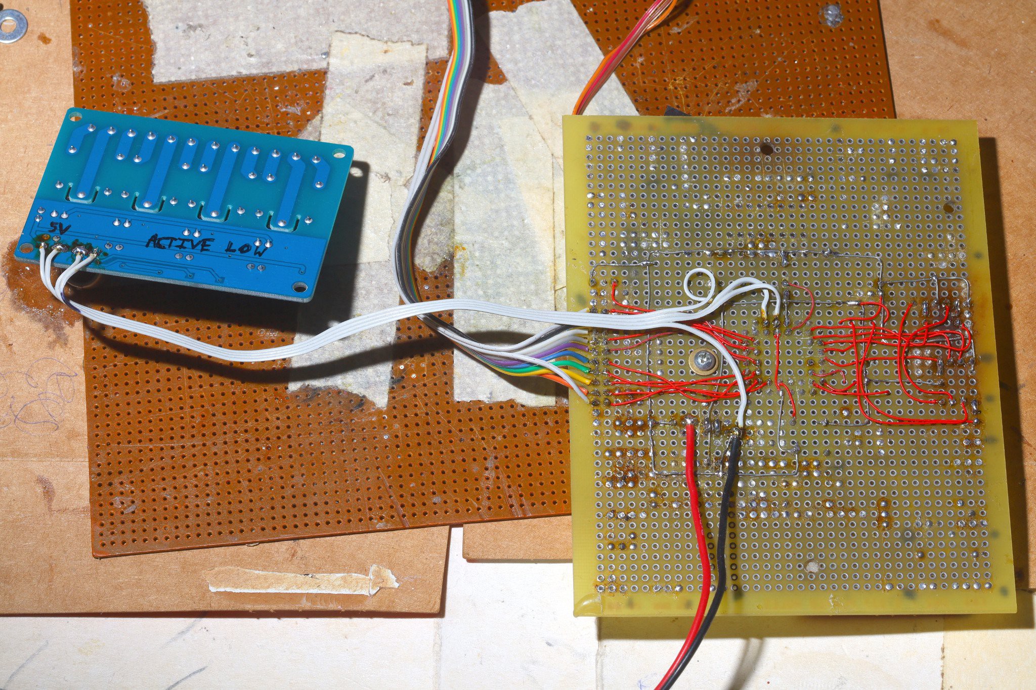

    Also, given the new need for relays, decided to rebuild the hacker board with vintage components, for vintage appeal & to get rid of some parts.  It was slow going, in the old days.
    This board dated back to Aug 2008, went through many crashes, hopefully won't be reworked again.  The LED panel dated back to 1997.
