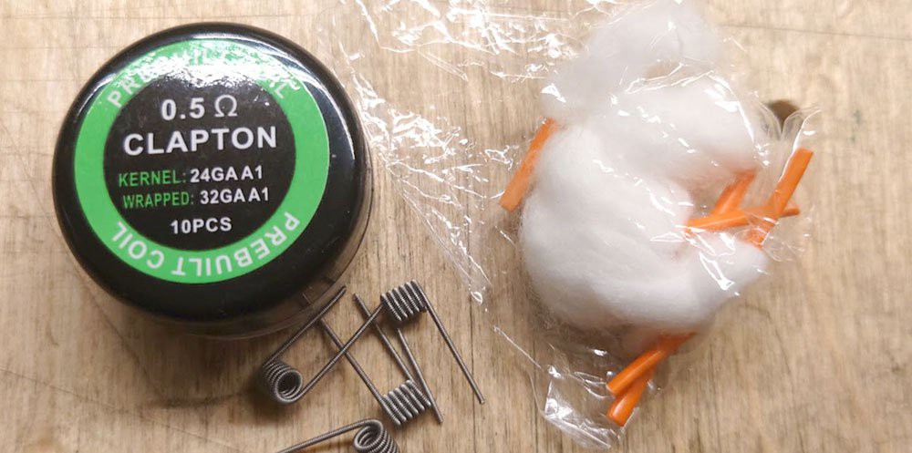

    For the fog effect, I used a Destiny 24 mm RTA from AliExpress, equipped with a 0.5 Ω Clapton coil and a standard cotton wick.
    The liquid was a classic 50/50 mix of propylene glycol and vegetable glycerin with a single drop of baked apple flavor - because... why not?

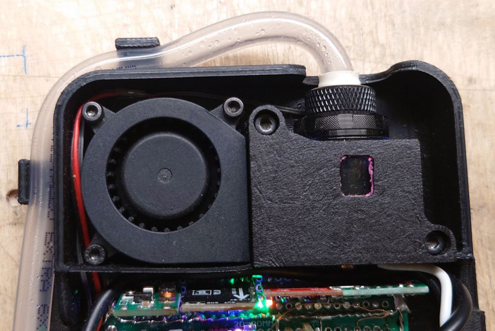

    Instead of using it as a normal vape, I built a small 3D-printed, sealed chamber around the tank. A small blower fan forces air through the bottom airflow ring, pushing the vapor out through a flexible 6×1.5 mm tube leading to the buttplug. The tube connection was secured with two or three layers of heat-shrink tubing for a tight fit. The enclosure also features a small viewing window (sealed with craft foam) and an LED on the opposite side, so you can check the liquid level at a glance.
    Heater power comes directly from the Li-ion pack through a 50 A MOSFET module, controlled by PWM from the STM32. The fan is also PWM-driven, slightly overvolted from 5 V nominal to ~7 V. It features a soft ramp-down on shutdown, which nicely clears the remaining vapor from the tube.

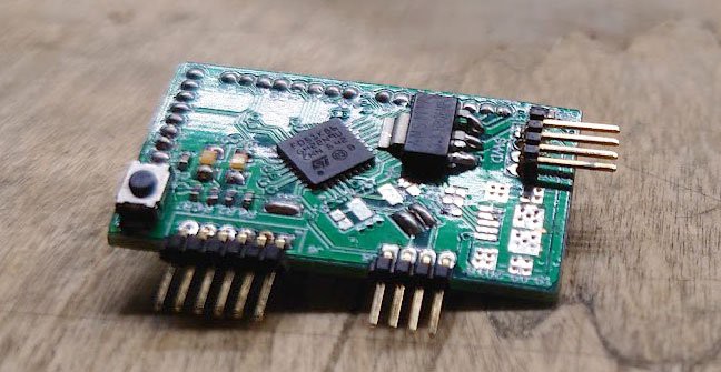

    The Brain - Custom STM32 Board
    All of this is orchestrated by my own compact (30×18 mm) STM32F051K6 board with 1.27 mm pin headers.
    I've made a whole family of these boards in different sizes - including larger ones for bigger, high-pin-count STM32 chips. They're significantly nicer and more practical than the classic Blue Pill (STM32F103) boards from AliExpress. And best of all, they're all my own design. ;)
    The STM32 takes care of:
    • Generating various laser blinking patterns
    • Driving the heater PWM with a simple temperature model (cold-start boost followed by stable power)
    • Controlling the fan with a soft ramp-down after turning off the fog
    • Handling wireless communication with the foot switch
    There is no temperature sensor on the coil and no fancy electronic liquid monitoring. I briefly considered doing a software-based liquid consumption model (kind of like coulomb counting for batteries), but quickly realized it would take more time and effort than the rest of the project combined. Sometimes the simple solution, like a visual window, is the correct engineering decision.
