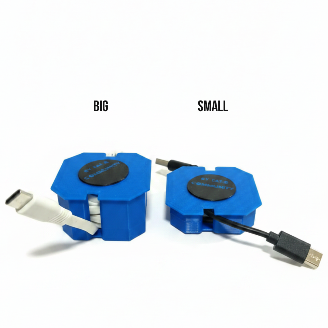

Design Goals
The project focused on several objectives:
  • reduce cable clutter in portable setups
  • create a lightweight and fast-printing accessory
  • experiment with modular attachment systems
  • encourage remixing and open hardware iteration
  • validate community-driven hardware design
Features
  • snap-on mounting system
  • lightweight geometry
  • low material consumption
  • clean cable routing
  • no supports required
  • modular attachment interface
  • remix-friendly design
    Versions
    Two versions are included:
    Small
    Optimized for thin and short cables.
    Big
    Deeper geometry designed for longer or bulkier cables.
    Both models can easily be resized depending on cable thickness and personal setup preferences.
    Print Settings
    • Layer height: 0.2 mm
    • Material: PLA recommended
    • PETG and ABS also supported
    • Infill: 15–20>#/li###
    • Supports: not required
    Recommended print orientation is flat on the base for optimal snap-fit behavior.
    How It Works
    The cable winder uses a snap-on interface designed around a mounting point integrated into ZERO.
    ZERO is a modular battery platform designed to support community-created accessories and experimental hardware extensions.
    The accessory can:
    • attach directly to ZERO
    • function independently as a standalone organizer
    • be remixed into future modular accessories
    This approach allows accessories to evolve organically through community experimentation rather than remaining fixed hardware objects.
    Open Hardware & Remixing
    This design is released open source for makers to print, modify, and remix freely.
    Possible remix directions:
    • magnetic versions
    • dual-cable variants
    • wall-mount adapters
    • travel-oriented compact versions
    • quick-release systems
    If you build an improved version or adaptation, share it with the community so the system can continue evolving.
    Final Thoughts
    This project is less about creating a single cable organizer and more about exploring how small community ideas can evolve into modular hardware systems.
    Sometimes the most interesting hardware concepts emerge from combining tiny observations into reusable building blocks.
    If you want to join the build of ZERO, you can learn more here
