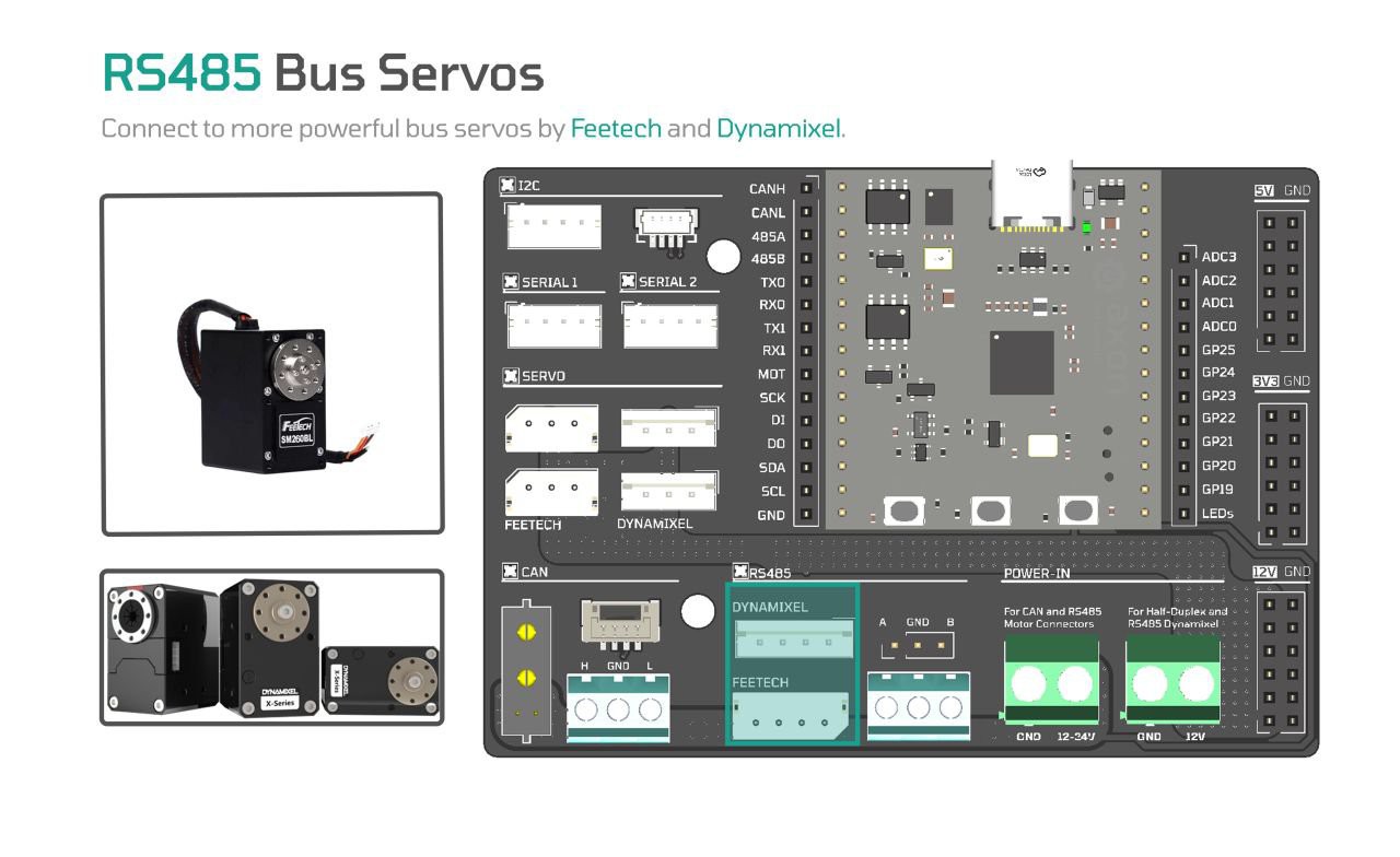

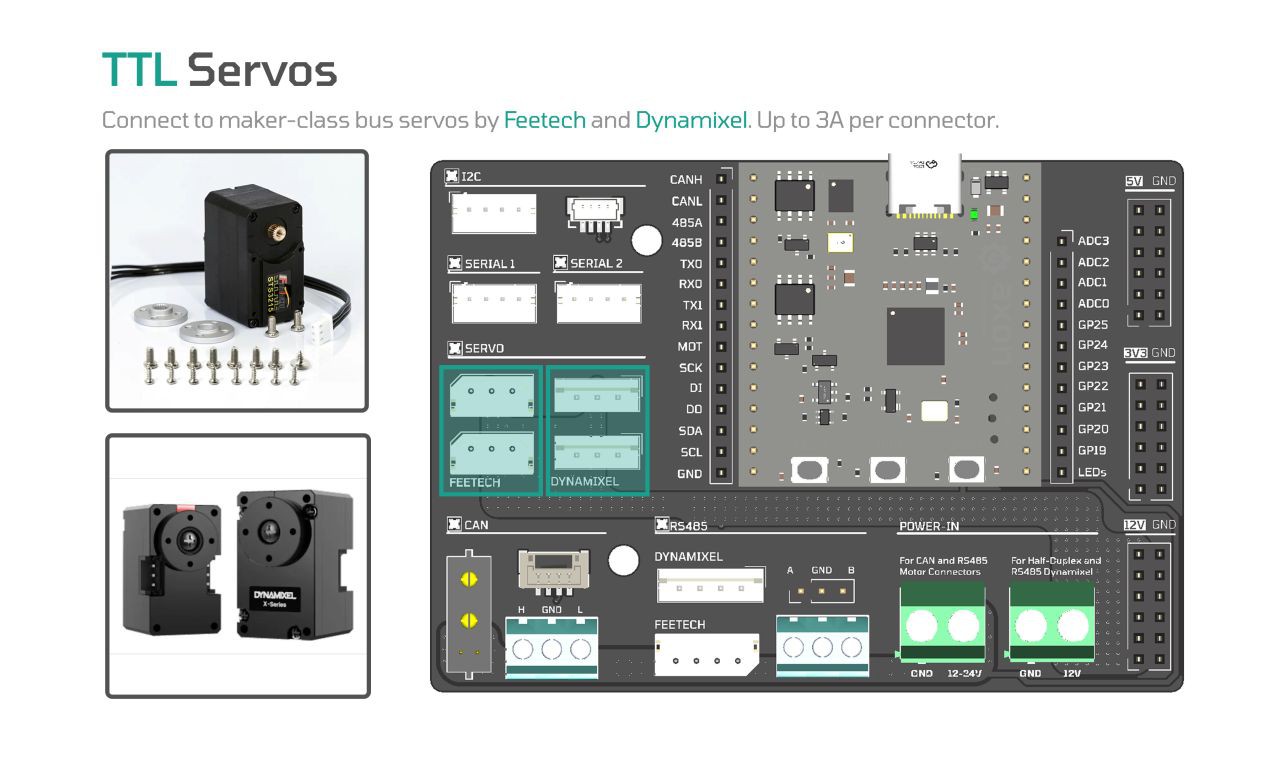

  • RS485: hardware UART with transceiver (XH2.54 connector)
    • Feetech and Dynamixel connectors
    • Screw Terminals and 2.54mm Pin Headers for everything else
  • Half-duplex UART: 1x bus compatible with Feetech SCS/STS, Dynamixel Protocol 1.0 and 2.0, FashionStar bus servos (Dynamixel and Molex connectors)
  • Full-duplex UART: 2x serial ports, one with 5V level shifter (XH2.54 connectors)
    • Waveshare DDSM, GPS modules, BMS, lidars, generic serial devices
