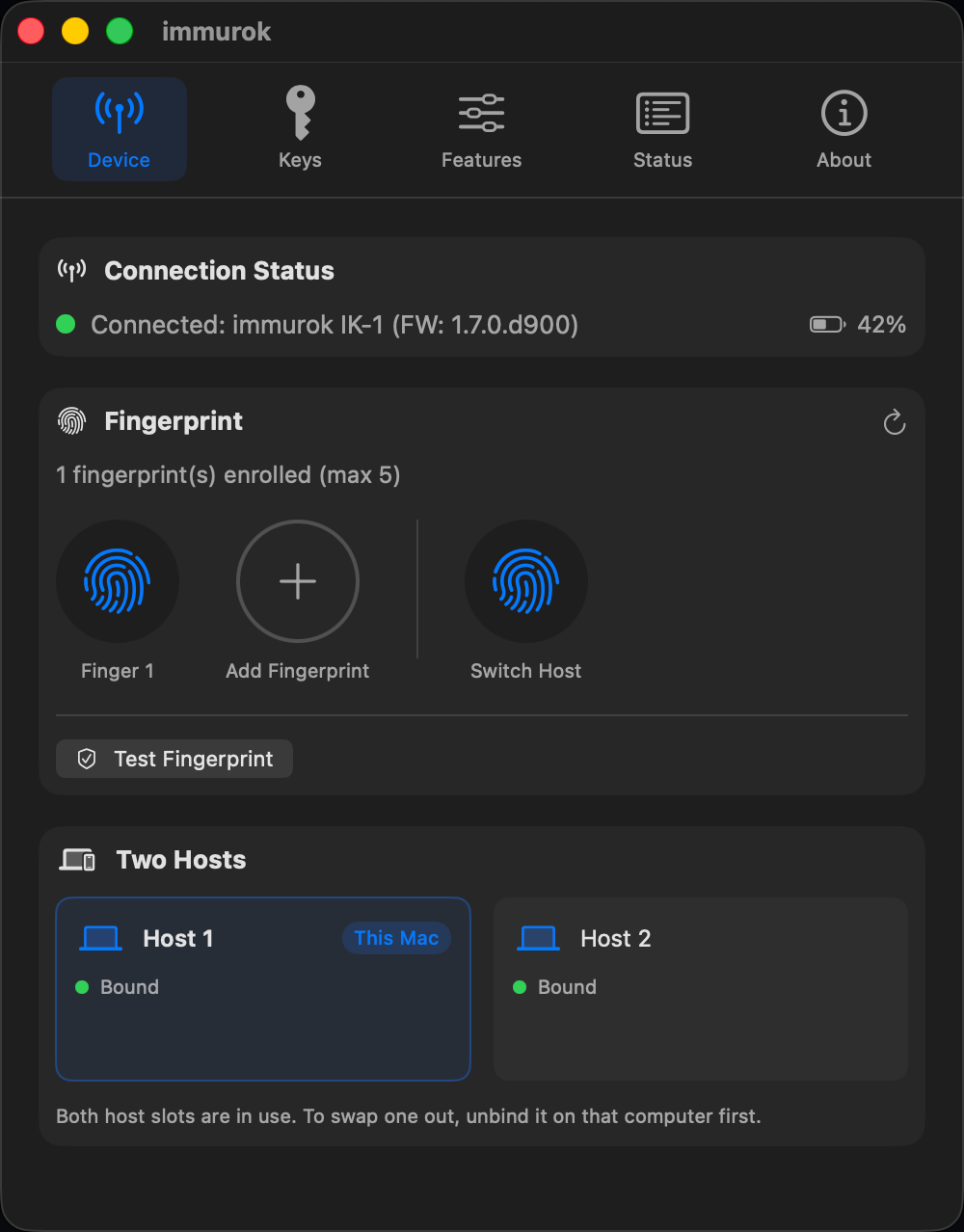

Two slots, two identities
The trick is that the key presents itself as two different devices. Inside there are two slots, each with its own Bluetooth address and its own bond. When it’s serving the first computer, it shows one identity. Switch to the second, and it shows another. Each computer just sees “my immurok key” and reconnects. Neither one knows the other is there.
The macOS app’s Two Hosts panel: both slots bound, each its own identity, with a Switch Host fingerprint sitting next to your regular ones.
Switching with a fingerprint

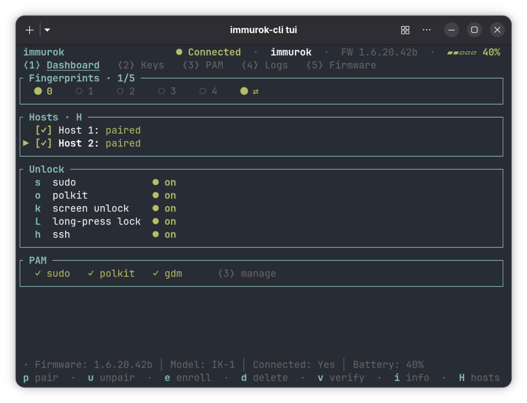

Dual-host is live in firmware 1.7.0, on both the macOS app and the Linux companion.
The Linux companion carries the same model into the terminal: a Hosts panel under
H, and the switch finger on the fingerprint row.It’s all on GitHub if you want to read the code. One key, two computers, one finger to move between them.
