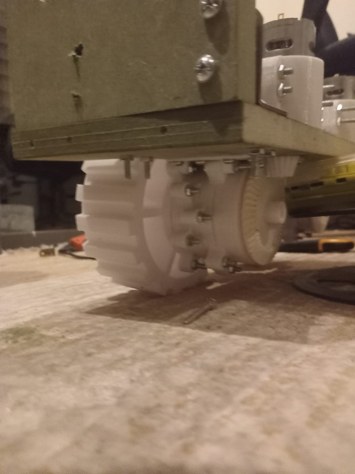

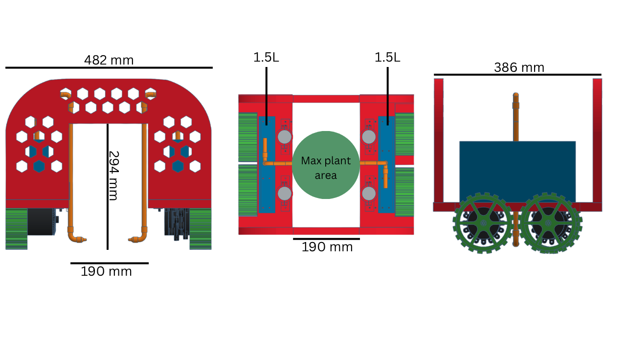

The maximum plant diameter for the robot is 190mm. Each tank carries 1.5L, so 3L total. I aimed to maximize the space in the center by making the planetary gears and wheels as thin as possible while retaining strength.
I had weak motors so I designed 3D printed gears. Planetary gears worked well because they stacked torque exponentially. I created 4 stages, where each stage connects to the next to multiply the torque by 5, resulting in a torque factor of 625.

- The gyroscope is still really inaccurate even though I used filter algorithms, which is why I can only do three plants before the movement become inaccurate and my plants get run over. I'm using an MPU6050 which might be outdated.
- I want more width in the center for plants to pass through, but I can only do that if the planetary gears are thinner. If I buy stronger motors and attempt to flip the motor upwards, I can save space. I attempted to do this but there is too much friction with the bevel gears for the robot to move:
Let me know what you think!
