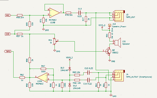

Cassette/audio interface is probably the worst part of the schematic:
It worth to be completely redesigned, especially speaker "amplifier"...
Some explanations to the schematic:
- J3 jack connector is just a general output connector to be used for cassette recorder or sound amplifier. R59 should allow speaker output signal from EAR bit to go to J3 for external amplifier and speaker.
- J4 jack connector is for smartphone which can be used as a cassette player to load programs or recorder to save programs/games with some recording app.
- Resistor R27 is needed to force smartphone detecting that something is connected to its mic input.
Note that J13 should be connected by wire to J12 to get power for this audio module.

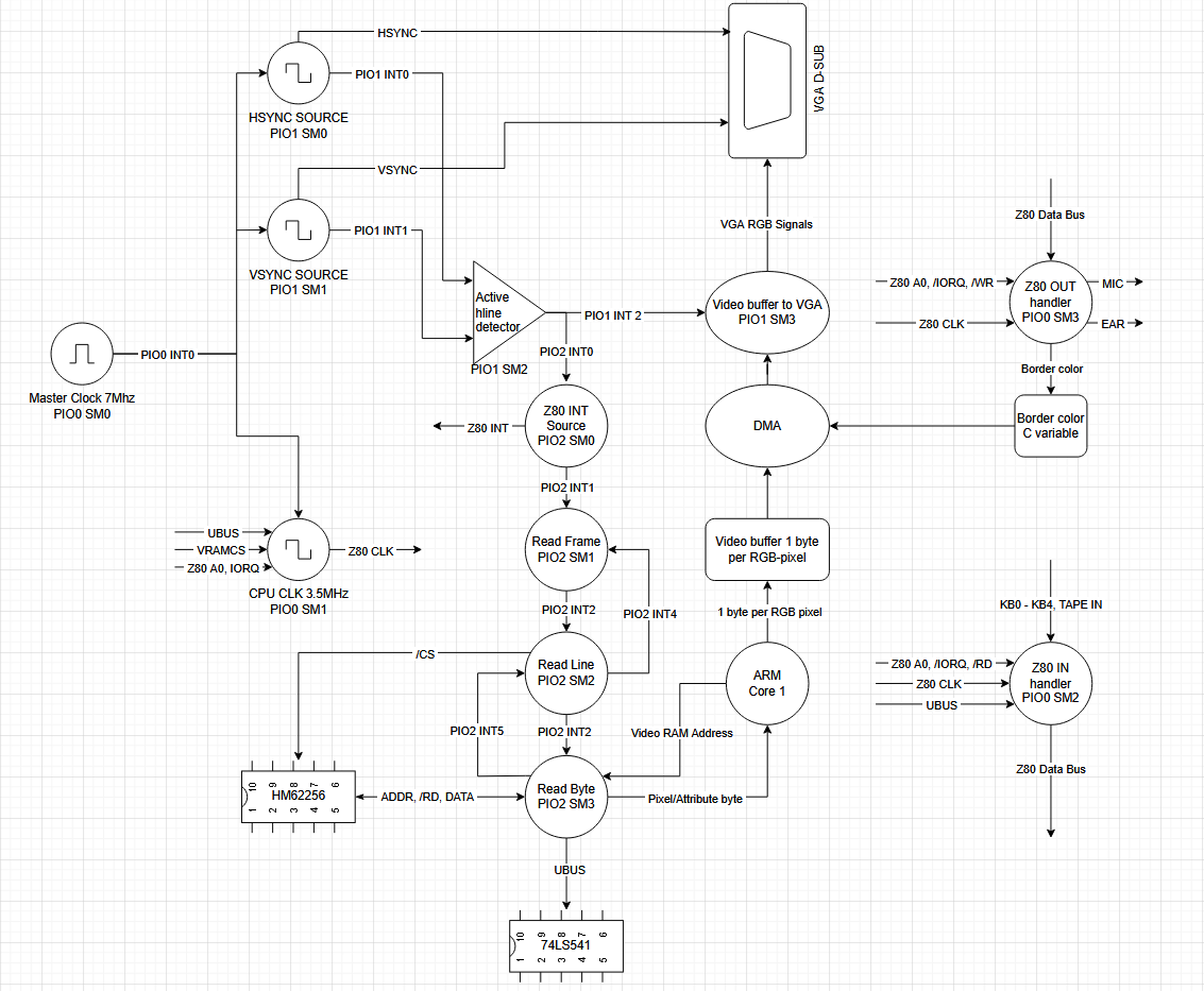

Software
Architecture of the rp2350b software/firmware:
Almost everything is orchestrated by "master clock" generator ran by PIO0 SM0 producing PIO0 INT0 signal at 7MHz. This signal is used by other SMs for synchronization.
Some details:
- UBUS is a signal to disable 74LS541 outputs so rp2350b is taking control of Video RAM address and control bus. It is also used to tell different SMs that the "ULA" reads Video RAM.
- VRAMCS is a signal produced by circuit logic for Chip Select of video ram chip. It is also used by CLK generator to identify if Z80 is trying to access video RAM.
- PIO0 SM1 generates 3.5MHz Z80 clock signal, taking into account UBUS, VRAMCS and Z80 /IORQ and /A0 signals.
- PIO0 SM2 implements respond to Z80 IN FEh command providing Z80 with port keyboard and tape data.
- PIO0 SM3 reacts to Z80 OUT FEh command taking border color and MIC/EAR data.
- PIO1 SM0 and PIO1 SM1 run the same code and generate HSYNC and VSYNC for VGA output and INTs for internal sync
- PIO1 SM2 uses those INTs to identify frame start and active (visible) part of VGA line and produce signals to Z80 INT generator and VGA RGB signals generator.
- PIO1 SM3 produces VGA RGB output taking pixels from FIFO.
- DMA feeds PIO1 SM3 FIFO from video buffer and border color memory cell.
- PIO2 SM0 is triggered by active frame detector and produces Z80 INT signal as well as triggers Video RAM reading process.
- PIO2 SM1 is triggered by SM0 and orchestrate video frame reading from RAM line by line.
- PIO2 SM2 is triggered by SM1 and control reading one line of video data from physical RAM byte by byte.
- PIO2 SM3 is triggered by SM2 to read one byte from the physical RAM. It takes the byte address from FIFO and put the data byte back to FIFO.
- ARM Core 1 C-code feeds SM3 with Video RAM addresses to read pixel and attributes data and decodes the data to fill "1 byte per RGB pixel" video buffer accordingly. It also implements character flashing function depending on flash bit in attribute byte.
- ARM Core 0 C-code is used to configure DMA and PIO SM code and then hangs up forever. It also handles DMA interrupt.
