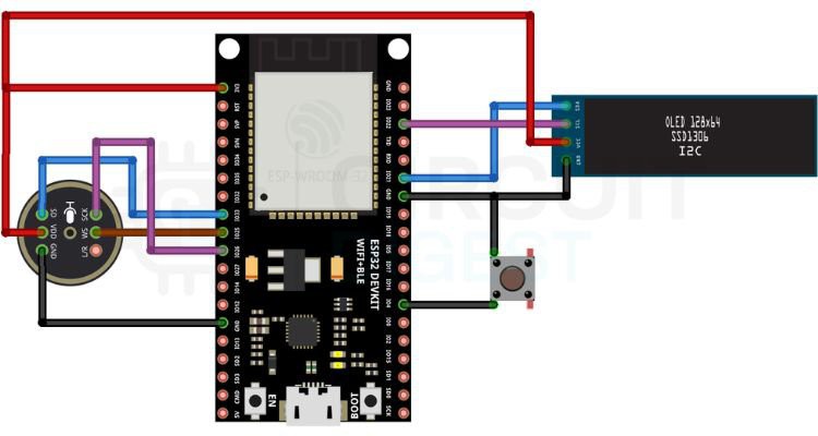

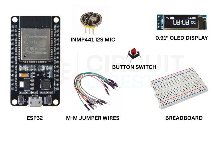

Hardware
The prototype uses only a few components:
  • ESP32 development board
  • I2S MEMS microphone
  • USB connection for programming and serial output
  • Breadboard and jumper wires
The ESP32 provides sufficient processing capability for lightweight inference while supporting high-speed I2S audio capture.

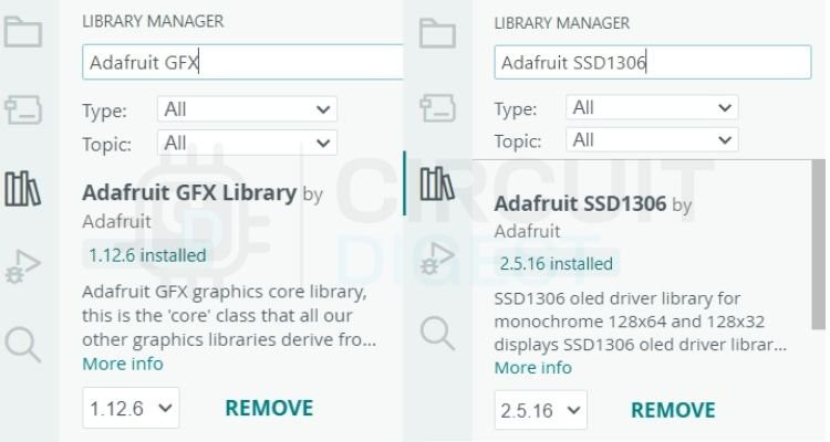

Software Stack
The firmware combines several software components to create the speech recognition pipeline:
  • ESP-IDF / Arduino framework
  • Edge AI speech recognition model
  • Audio preprocessing
  • I2S audio driver
  • Serial interface for displaying transcription results
The incoming audio stream is converted into features expected by the neural network before inference is performed on the ESP32.

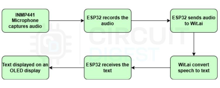

How It Works
The processing pipeline follows these steps:
  1. Capture audio through the I2S microphone.
  2. Buffer incoming samples.
  3. Apply preprocessing and feature extraction.
  4. Feed the processed data into the embedded AI model.
  5. Receive the recognized text.
  6. Display the transcription through the serial interface or use it to trigger application logic.
Because the inference runs directly on the microcontroller, no external server or internet connection is required.

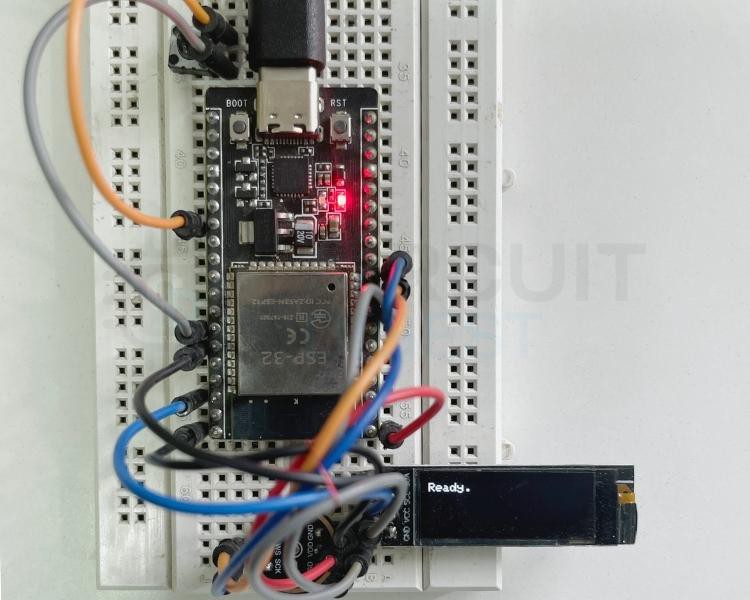

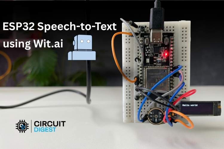

Results
This ESP32 Speech-to-Text project demonstrates that practical offline speech recognition is no longer limited to powerful processors. By combining the ESP32 with an optimized Edge AI model, it is possible to create responsive voice-enabled devices that are inexpensive, privacy-friendly, and independent of cloud services.
The project also serves as an excellent introduction to TinyML and embedded AI development, showing how modern machine learning techniques can be deployed on resource-constrained hardware for practical applications.
