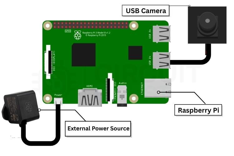

Hardware
  • Raspberry Pi 4 (or Raspberry Pi 3 with reduced frame rate)
  • USB webcam
  • MicroSD card
  • 5V Raspberry Pi power supply
  • Internet connection

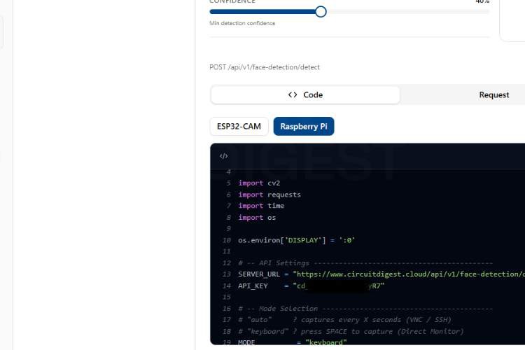

Software
  • Raspberry Pi OS
  • Python 3
  • OpenCV
  • NumPy
  • Cloud dashboard account
  • Camera drivers

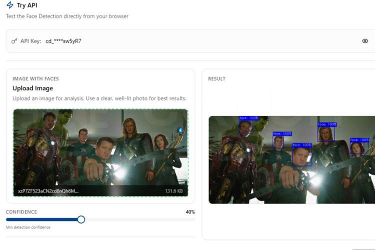

Each frame is processed locally using OpenCV's Haar Cascade face detector. Whenever one or more faces are identified, the software records the detection event and updates the cloud dashboard.
The cloud service stores the latest detection status, allowing users to monitor activity remotely without streaming continuous video.

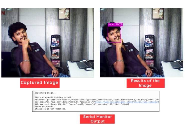

  1. Initialize the camera.
  2. Load the trained face detection model.
  3. Capture video frames.
  4. Convert each frame to grayscale.
  5. Detect faces.
  6. Draw bounding boxes around detected faces.
  7. Send detection status to the cloud.
  8. Continue processing until the application is stopped.
