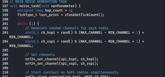

This project explores the mechanics of a Fast-Sweep Jammer (or Hopping Jammer) implemented using an ESP32 microcontroller and nRF24L01 transceivers.
2) Solution/Methodology:
To jam/ block a legitimate signal s(t) operating in 2.4 Ghz ISM band I built a low-power jammer that transmits carrier signals or ‘Noise’ in the same 2.4 Ghz band. At a given instant of time (T) the jammer can produce only ‘one’ particular type of frequency ‘F’ in the range of [ 2.4 Ghz, 2.525 Ghz ]. But this alone cannot jam the entire band, so we change the frequency ‘F’ to another frequency in the same band after time ‘T’ and continue to do this after every interval ‘T’. This is called ‘Frequency Hopping’ mechanism. In our case we keep this interval ‘T’ to be 100 microseconds so that the frequencies generated by the jammer appears to be ‘noise’ for a larger time interval say ~ 1 second, in other words our jammer changes the carrier frequency 10,000 times in a single second.

~ Uniform Probability Distribution : By using the rand() function in our source code, the jammer's presence across the 125 Mhz bandwidth follows a Discrete Uniform Distribution. This ensures that the probability ‘P’ of the jammer occupying any specific 1 Mhz channel is: P(f) = 1/N , where N=125.
~ The "Comb" Effect: In the short term (< 100 microseconds), the Power Spectral Density (PSD) shows a single, narrow peak. Over time, the high-speed hopping creates a flattened PSD that mimics Band-Limited White Noise. This "masks" the entire ISM band, raising the noise floor across all channels simultaneously.
~ Frequency Hopping Spread Spectrum (FHSS) : By setting the ESP32 timer to 100 microseconds, we transition from "Slow-Hopping" (longer than a packet) to "Fast-Hopping" (multiple hops per packet). This is a critical tool for bypassing defences ( like Adaptive Frequency Hopping (AFH) that Bluetooth uses to avoid interference with other channels ), as the jammer moves faster than the target before it can re-map the "clean" channels.

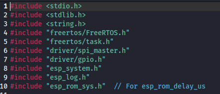

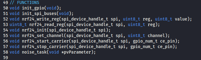

    Write source code (main.cpp)
    I would recommend writing your own code like I did. Here are some snippets from my code:
