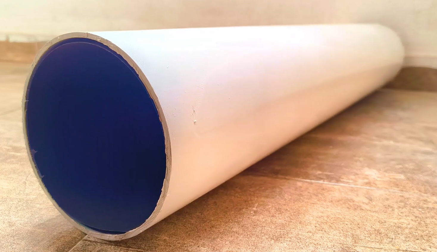

    Preparing the Parts
    Measure the actual inner diameter of your PVC pipe before printing anything.
    PVC pipes are sold using nominal dimensions, so my "5-inch" pipe actually measured about 5.25 inches internally. I modified the original PiKon models to match.

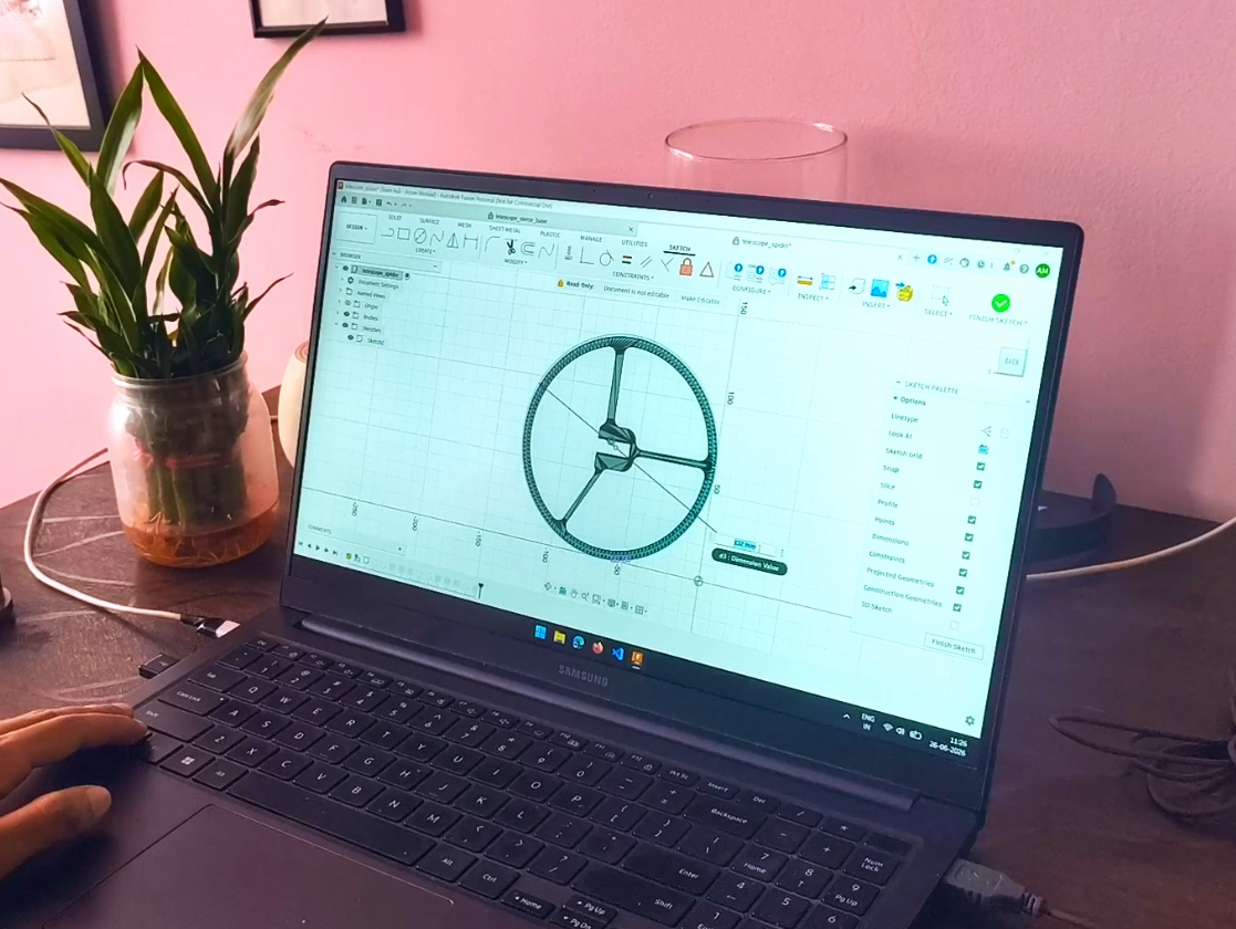

    I also redesigned several components:
    • Electronics mount
    • Universal tripod mount
    • Smartphone holder
    • Rack-and-pinion camera focuser
    Print the parts using PETG or ABS. PLA can soften in hot weather, potentially affecting optical alignment.
    For the tube itself:
    • Cut it slightly longer than your mirror's focal length.
    • Line the inside with matte black paper or paint.
    • Paint the outside if desired.
