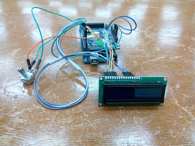

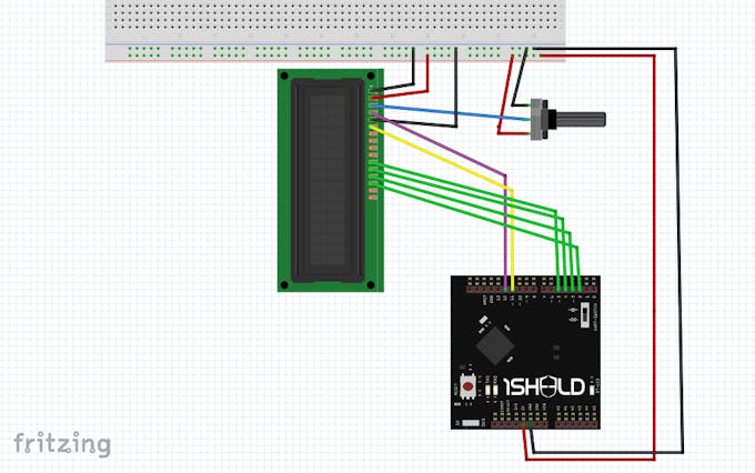

Now i know the circuit might look a little messy but it's a simple LCD circuit :
- LCD RS pin to digital pin 12
- LCD Enable pin to digital pin 11
- LCD D4 pin to digital pin 5
- LCD D5 pin to digital pin 4
- LCD D6 pin to digital pin 3
- LCD D7 pin to digital pin 2
- LCD R/W pin to ground
- LCD VSS pin to ground
- LCD VCC pin to 5V
- 10K resistor:
ends to +5V and ground , wiper to LCD VO pin (pin 3)

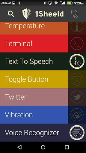

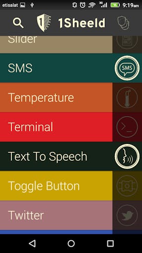

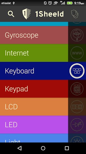

You need to choose Voice Recognition , Keyboard , TextToSpeech, and also SMS shield from the 1Shield app on your mobile phone , using the SMS shield we will be able to send messages to a far contact .
