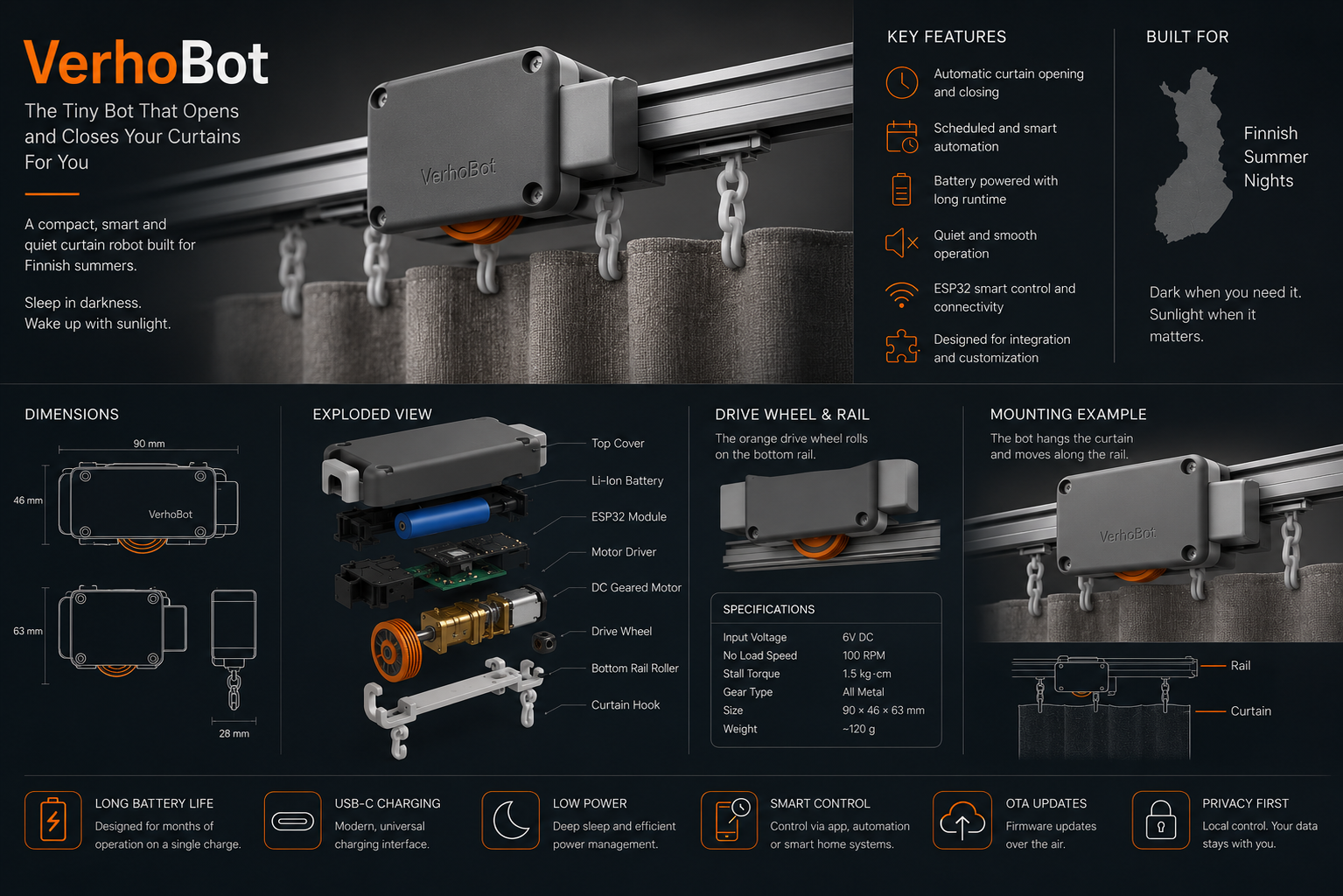

How It Works
The robot uses an ESP32-C3 microcontroller to control a small N20 geared DC motor.
The motor drives the curtain using a compact gearbox and pulley system.
Hall-effect sensors detect the motor position while end-stop sensors determine when the curtain is fully open or closed.
A rechargeable LiPo battery powers the system, and USB-C charging keeps maintenance simple.

Hardware
Current hardware includes:
  • ESP32-C3 SuperMini
  • N20 6V metal gear motor
  • USB-C LiPo charging circuit
  • LiPo battery
  • Hall-effect sensors
  • End-stop switches
  • Custom PCB
  • 3D printed enclosure
