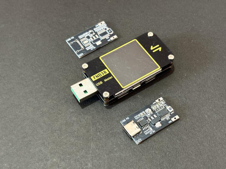

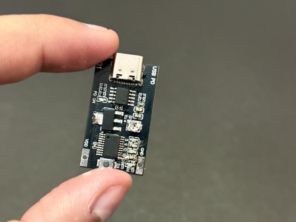

In the past, I have worked on Power Delivering (PD) ICs. They are perfect for getting instant voltage from a GaN charger. I made a simple, standalone board that lets me select different PD voltages by charging the register settings. But why not keep it more usable with a single-button setup and a 10-cent microcontroller? No OLED displays, no rotary encoders, no over-engineering, just a simple toggle button with a few LEDs. That is exactly what I built in this project using the CH224K USB PD sink controller and the CH32V003F4P6, both made on WCH hardware.

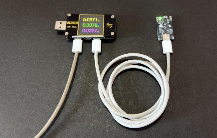

The idea is straightforward. You plug in a USB-C PD charger, press the button to cycle through 5V, 9V, 12V, 15V, and 20V, and the corresponding LED lights up to tell you which voltage is currently active. I have designed the circuit in EasyEDA and manufactured the PCB with JLCPCB to realize this idea. In this session, I will share the code and hardware files so you can easily build your own. Let’s get started.

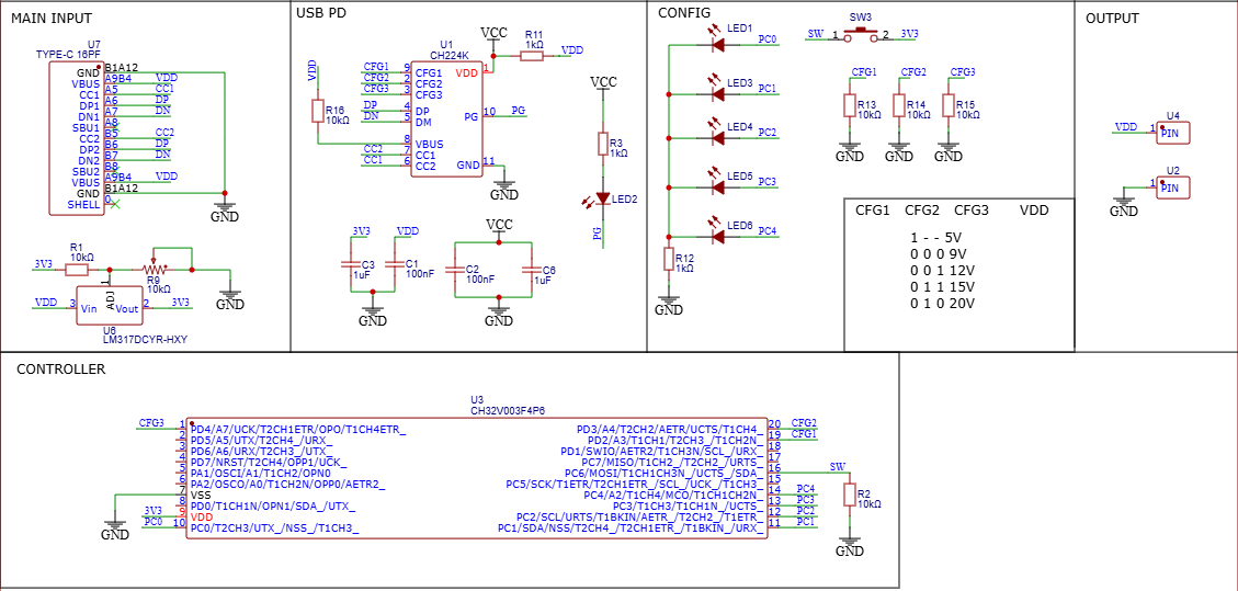

Circuit Diagram
The USB Type-C connector is a standard 16-pin one. The VBUS pins carry the PD voltage from the charger, and the CC1/CC2 lines connect directly to the CH224K for PD communication. The three configuration pins CFG1, CFG2, and CFG3 are connected to the MCU's PD2, PD3, and PD4 pins, respectively.
There is a 10K pull-down resistor on the VDD line and decoupling capacitors to provide clean power to the IC. The...
