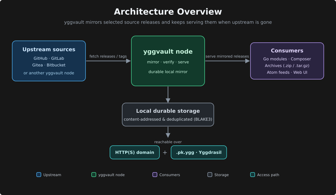

The operator lists specific projects and their upstream URLs in the configuration. yggvault pulls releases from GitHub, GitLab, Bitbucket, Gitea, and other git forges, validates the archives, stores them in local storage (SQLite + Pebble), and republishes them through a set of ready-made endpoints:
  • Go module proxy — standard GOPROXY-compatible routes, including major-version paths and optional rewriting of import paths to the mirror's address;
  • Composer v2 repository — metadata and packages for PHP projects;
  • Universal archives.zip and .tar.gz with a stable root directory;
  • JSON API and OpenAPI — for automation;
  • Atom feeds — a global and a per-project update feed;
  • Web UI — catalog, package pages, install snippets, hashes, and archive links.
The project grew out of a need for Go modules and manual archive downloads — Composer came along for the ride, and universal archives cover the standardized download schemes of Zig, Bazel, and anything else distributed as .zip/.tar.gz.
One process, one binary. No JVM, no external database, no object storage. The hot artifact cache is rebuilt from storage on demand — if the upstream is temporarily unavailable, already-stored versions keep being served. Pipeline details are in Import and refresh pipeline, storage details in Storage internals.

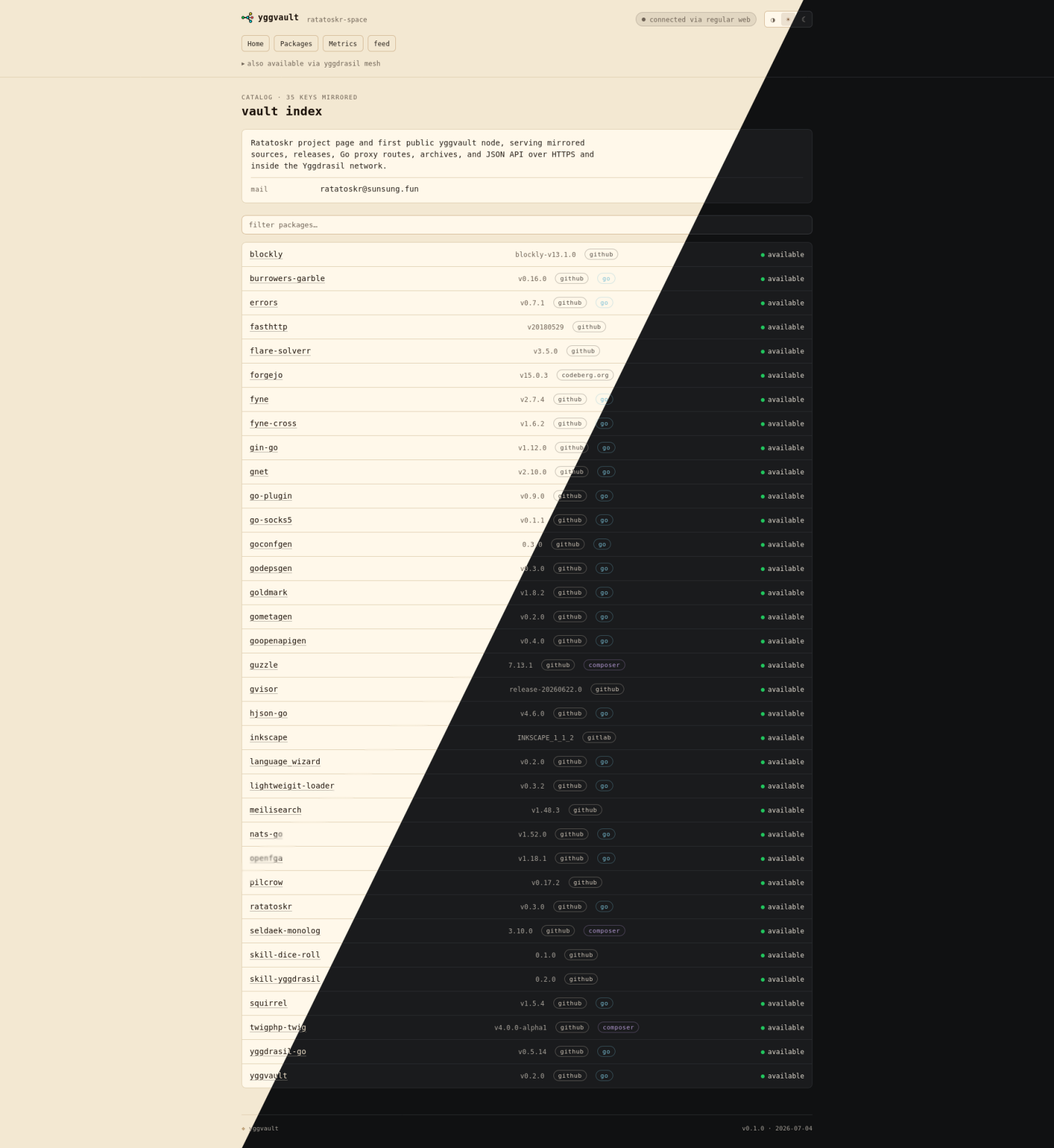

The web interface shows a catalog of mirrored projects with versions, source information, hashes, install commands, and direct archive links. The same data is available programmatically: JSON API, OpenAPI document, Go proxy routes, Composer metadata, Atom feeds. The full route map is in Web/API routes and nested mode.

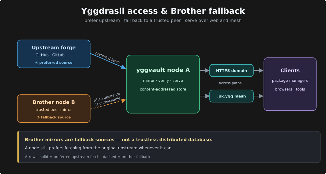

    This log is about brother mirrors in yggvault: one node can read another yggvault as an upstream source. This mode is for small independent mirrors, where several operators want to keep the same releases without shared storage, a quorum, or a consensus layer.
    A brother mirror solves a practical availability problem. If the original forge is temporarily down, blocked, has deleted a release, or is poorly reachable from a specific region, the follower node can update from a pre-selected brother. After publication, the version becomes a local part of the follower's storage and is served like an ordinary imported release.
    For this log, the left-hand part of the diagram matters: yggvault first works with the original upstream, then uses a trusted brother as a fallback source. The right-hand part with web/Yggdrasil access was already covered in Yggdrasil mode.

    This log is about Yggdrasil mode in yggvault: an additional mesh ingress for the same release mirror. The same node can serve already-imported releases through the ordinary web listener, through a Yggdrasil address, or through both access paths at once.
    The idea is practical: the mirror should stay useful where the public domain, DNS, reverse proxy, or regional access to the ordinary internet behave unreliably. The Yggdrasil layer adds an address bound to the node's key and lets mesh participants read the same package routes without public IPv4/IPv6 ingress.
    In this diagram, the right-hand part matters for this log: clients read the same vault through an HTTPS domain or through a Yggdrasil address. The brother fallback in the diagram will be needed in the next log; here it serves as an example that the mesh transport is used both for serving and for sync between trusted mirrors.

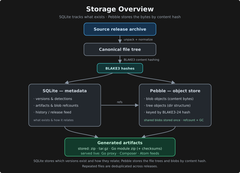

    This log is about the storage layer inside yggvault: what stays the durable source of truth, what is a regenerable cache, where the version-visibility boundary runs, and why a mirror can serve releases for a long time without an external database or object storage.
    The import/refresh pipeline is already responsible for source discovery, archive validation, and ecosystem overlays. Storage begins after that: the node has a canonical tree, a set of blobs, metadata for routes and artifacts, and a decision to publish or reject.
    Why this is a separate part of the project
    A temporary solution for a few Go modules could live as a set of files on disk. A full release mirror quickly runs into other problems:
    • different versions often contain identical files;
    • one version must be served as a universal archive, a Go module zip, Composer metadata, a JSON page, a feed entry, and a web page;
    • the upstream may delete a version or replace a tag with a different tree;
    • public serving requires ready files, range-friendly responses, stable ETags, and checksums;
    • the operator must be able to see how much the durable state takes and how much the serving cache takes.
    That's why yggvault separates durable content, durable metadata, and hot serving artifacts.
    Three layers under storage.dir
    storage.dir contains several layers that differ in meaning.
    Layer What it stores Why it matters
    SQLite index versions, lifecycle flags, source hashes, tree hashes, detection results, artifact metadata, blob_refs, history events, key/source bindings An SQLite transaction makes a version visible. This is where the relations and history live.
    Pebble object store blob objects and tree objects by BLAKE3-24 hash Identical bytes get the same object key and are not written again.
    Hot cache ready .zip, .tar.gz, Go zip, and other generated artifacts The files can be deleted and rebuilt from durable storage.
    RAM metadata cache small JSON/metadata responses Bounded by cache.metadata_max_size; this is a performance layer.
    Practical result: the durable state is responsible for truth, the hot cache is responsible for serving speed.
    Blob object
    A blob object is the bytes of a single file from the release tree. Its identity is a BLAKE3 digest truncated to 24 bytes / 192 bits. In the code this is core.HashObj: a fixed-size array, comparable, convenient as a map key and as part of a Pebble key. The 24-byte size is a deliberate step to optimize index handling while keeping sufficient collision resistance.
    Before a write, storage verifies that the bytes really produce the expected hash. Before a verified read, storage can recompute the hash again, depending on storage.pebble.verify_on_read.
    An identical file from two versions gets the same blob hash. If a README.md, license file, or generated sources repeat across several releases, Pebble stores the body once, while SQLite counts references through blob_refs.
    Tree object
    Each version in SQLite has a tree_hash. It's what links the version metadata to the canonical file tree.
    A tree object contains a canonical list of entries:
    • path;
    • mode (file or symlink);
    • size;
    • blob hash.
    The tree encoding is intentionally strict. The code sorts paths, rejects duplicates, rejects file/child conflicts, checks the canonical path form, checks supported modes, and encodes the object into a binary format with the magic YRV_TREE\x00. The tree object hash is computed from these canonical bytes.
    This gives a simple model:
    version -> tree_hash -> tree entries -> blob hashes -> blob bytes
    If the upstream publishes the same release content again, the tree hash matches. If the tag name is the same but the tree is different, storage sees the mutation as a change in tree_hash.
    Publish boundary
    PublishStaged is the boundary where staged data becomes a published version.
    Storage runs several checks before visibility:
    1. a staged blob must lie inside the temporary spool;
    2. a staged blob must be a direct child of the spool...

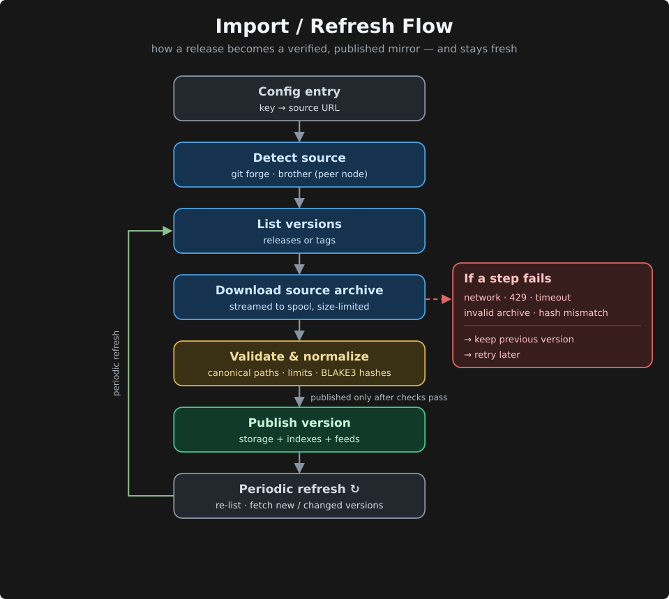

    This log is about the journey of a single version inside yggvault: from a line in the config to the routes for the browser, Go tooling, Composer, JSON API, and universal archives.
    The main idea: strict architecture is one of the project's core features. A version is better left out of the publish path than placed into storage in an unsafe or ambiguous form. This applies to archive parsing, symlinks, path rules, size limits, Go module zip constraints, and brother verification.
    A config entry as identity
    A minimal mirror starts with release_mirrors:
    release_mirrors:
      errors: "https://github.com/go-faster/errors"
    errors becomes the local key. This key is part of the public path, the Go module path, archive URLs, JSON endpoints, and feeds.
    The source URL is stored as the first binding for the key. If the operator later changes the URL for an already-published key, yggvault brings up the last-known-good data and suspends update checks for that key. This is a guard against accidental source substitution: a name must continue to mean the same upstream project.
    A single upstream URL under several keys is also treated as a suspicious config. The affected keys are suppressed until it's fixed.
    Source discovery
    Before downloading versions, the node classifies the configured URL.
    The source layer tries service endpoints like /health and /info. If the endpoint responds like a yggvault node, brother discovery kicks in: Brother.Hello, remote key detection, RPC capability, public API fallback.
    If the URL looks like an ordinary git forge, the source layer selects a provider parser. GitHub, GitLab, Bitbucket, and Gitea/Gogs-family servers are supported. A Yggdrasil address goes through the same source layer, only the outbound request leaves through the embedded mesh.
    The outbound layer already has guard rails: request deadlines, redirect limits, SSRF checks for clearnet, provider credentials only for matching hosts, bounded metadata reads, retry with backoff and jitter.
    Releases, tags, and sticky listing mode
    For a git source, the pipeline first looks at releases. If storable releases are found, the key is pinned to releases mode. If releases are empty, the pipeline tries tags and may pin the key to tags mode.
    The listing mode is sticky: the decision is saved to storage and survives restart. This is needed so that a single key doesn't change its package history just because the upstream later started publishing a different listing type.
    In tags mode, yggvault does a light releases probe. When the upstream starts serving releases for a key pinned to tags, the node raises a diagnostic conflict. The operator resolves the migration by hand.
    The listing includes versions that can be stored and published. Release prereleases are dropped. Semver prerelease tags are dropped too. Raw names are allowed only after route-safe validation.
    First import
    The initial import for a git source goes like this:
    1. get the version listing, honoring rescan.initial_depth;
    2. get the archive URL for each selected version;
    3. download the source archive into a temporary spool;
    4. compute the source hash;
    5. unpack the archive through mod/archive;
    6. check the archive boundaries;
    7. build the canonical source tree;
    8. determine Go/Composer viability and the artifact plan;
    9. build universal archives, Go artifacts, Composer metadata, and JSON-visible metadata;
    10. make a durable commit through PublishStaged.
    yggvault works with source release archives. Binary assets, installers, and other upstream attachments stay outside the pipeline.
    The download layer can resume via HTTP Range if the server provides a validator (ETag or Last-Modified). Downloading is bounded by request timeout, idle timeout, throughput floor, archive size cap, and source.download_max_parallel.
    Strict archive boundary
    Archive extraction is an abuse boundary, so the code treats the archive as untrusted input.
    Default limits from the config schema:
    • compressed archive: 100mb;
    • total unpacked bytes:...

    The yggvault model
    In a minimal config, the mirror starts with release_mirrors:
    release_mirrors:
    release_mirrors binds a local key to an upstream URL. After a rescan, the node finds versions, downloads the source tree, validates the archive, stores it in local durable storage, and builds derived artifacts.

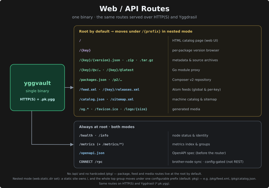

    The same release then becomes available through several interfaces:
    http://127.0.0.1:8080/errors/latest
    http://127.0.0.1:8080/errors/v0.7.1.tar.gz
    http://127.0.0.1:8080/errors/@v/list
    http://127.0.0.1:8080/errors/releases.json
    For a human, it's a web page and archive links. For Go tooling, it's a GOPROXY endpoint. For automation, it's JSON routes and feeds.
    After a successful sync, already-stored versions keep being...
