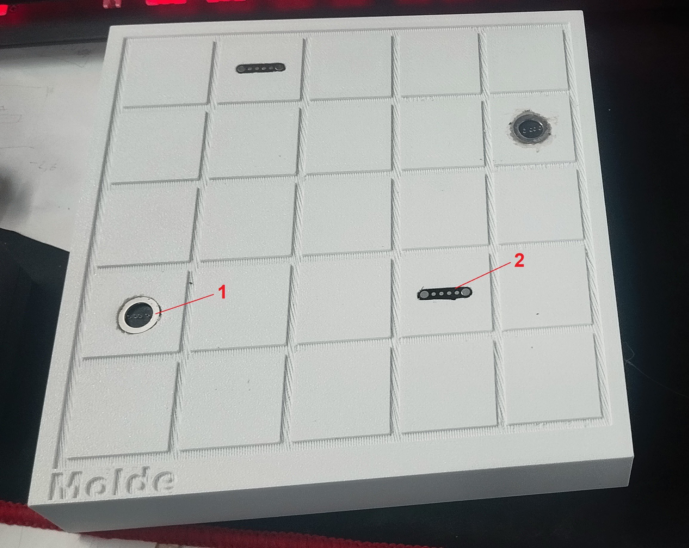

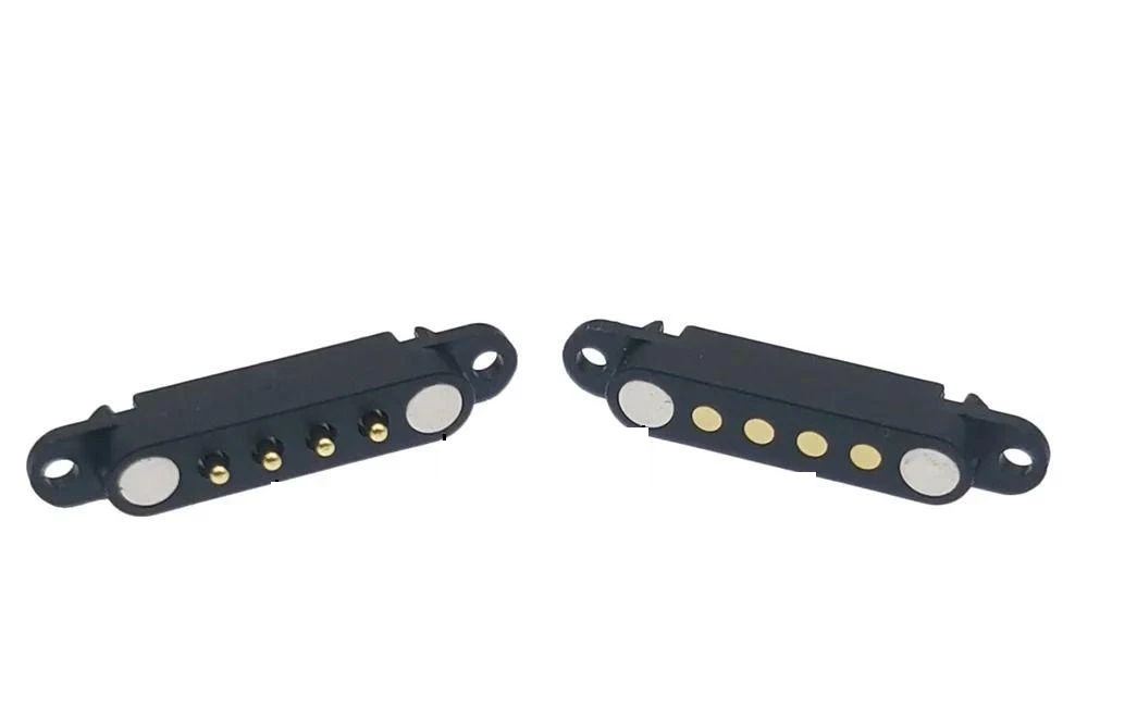

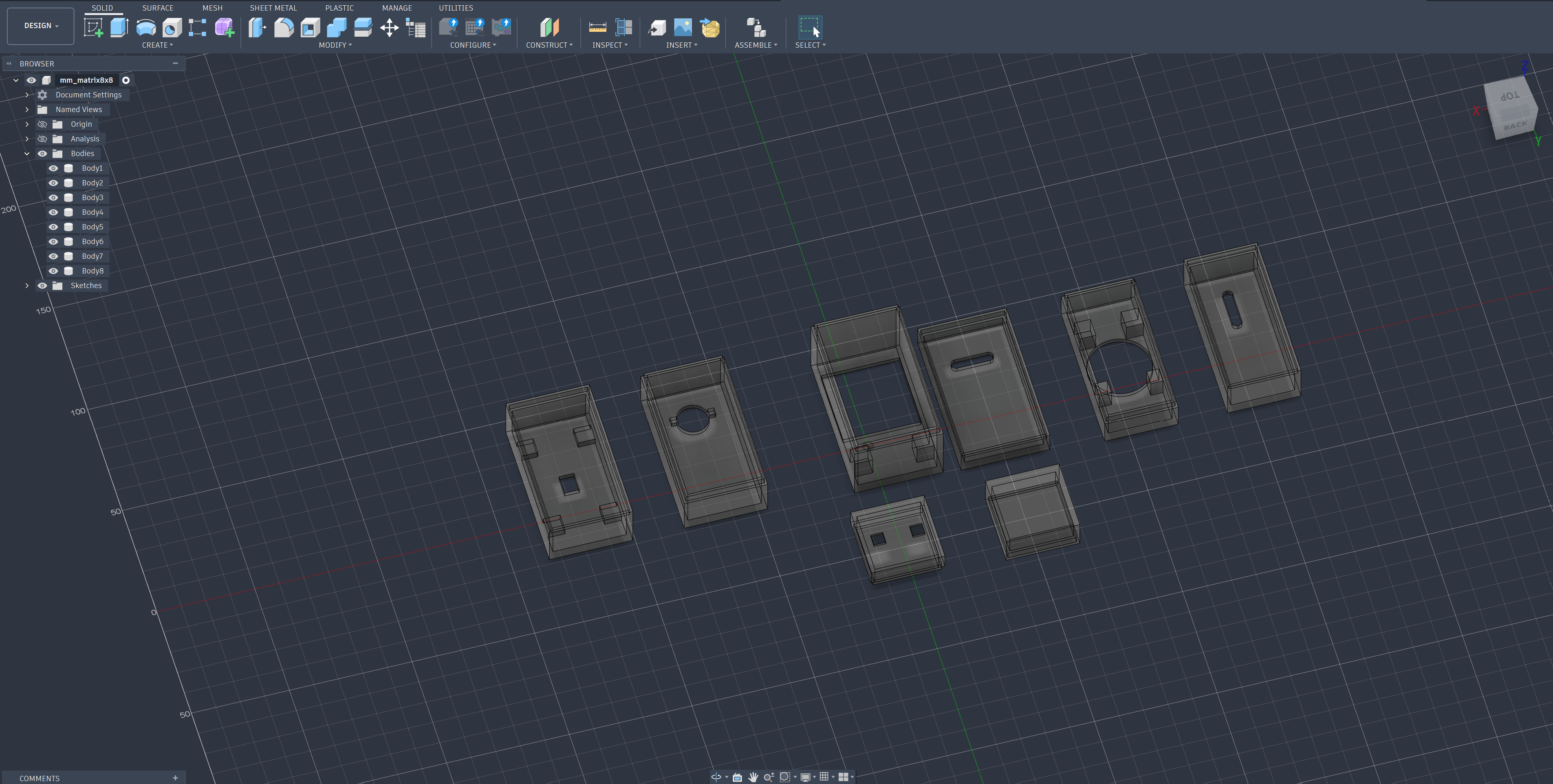

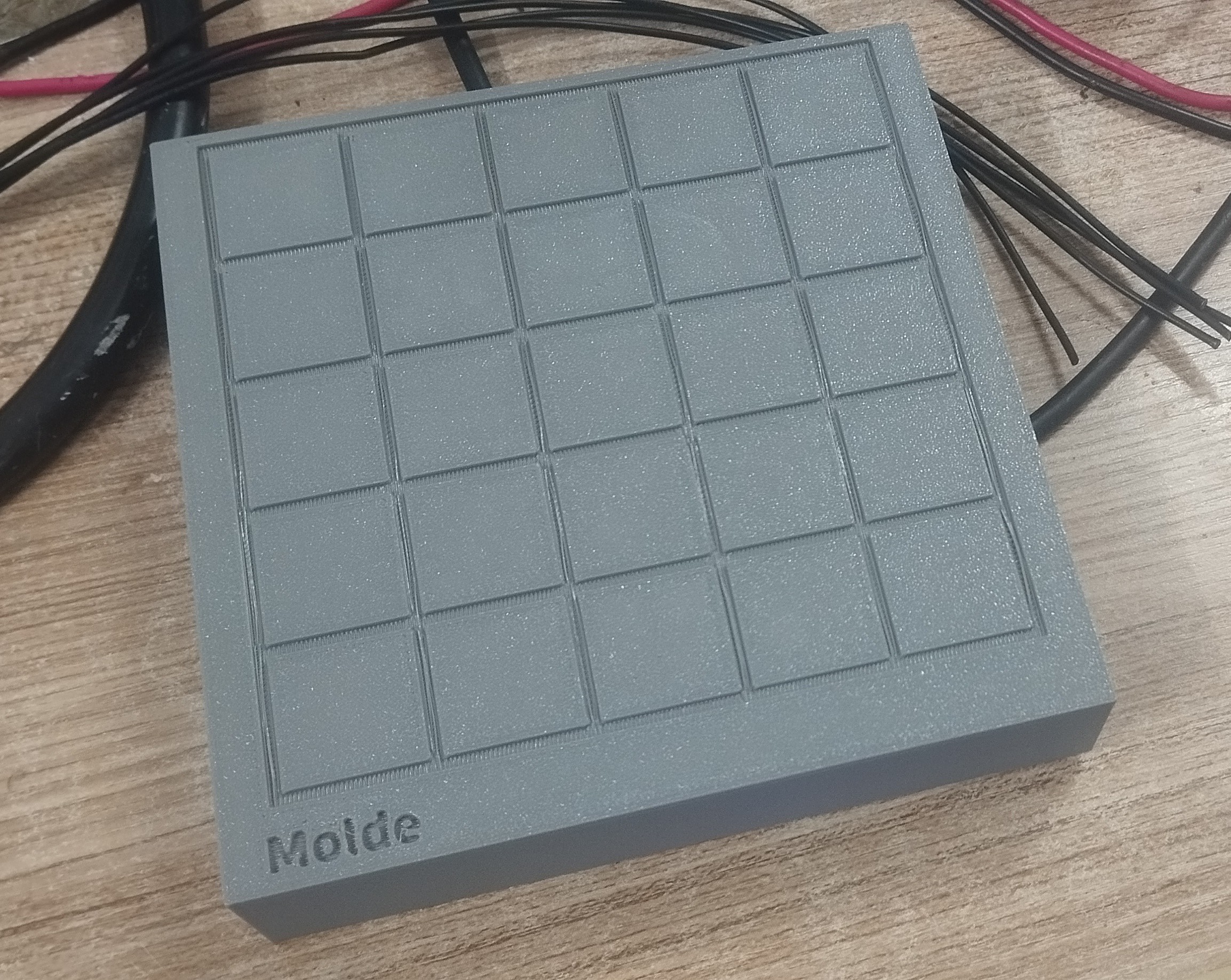

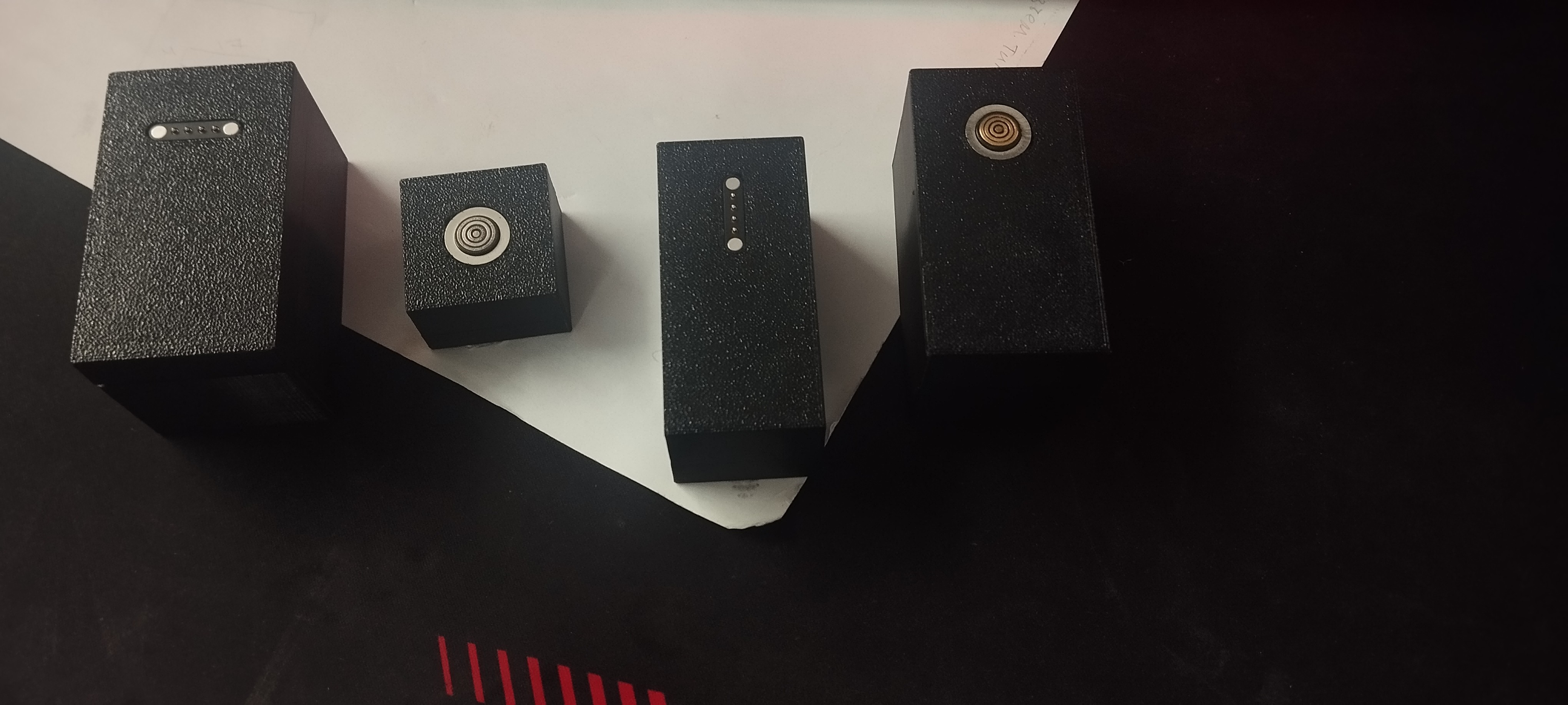

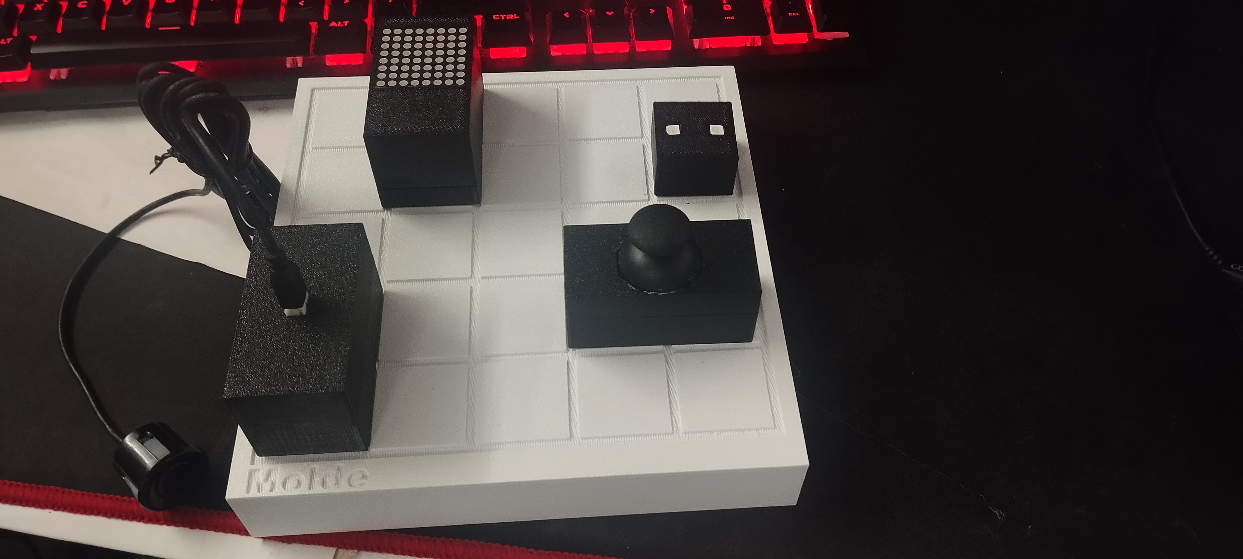

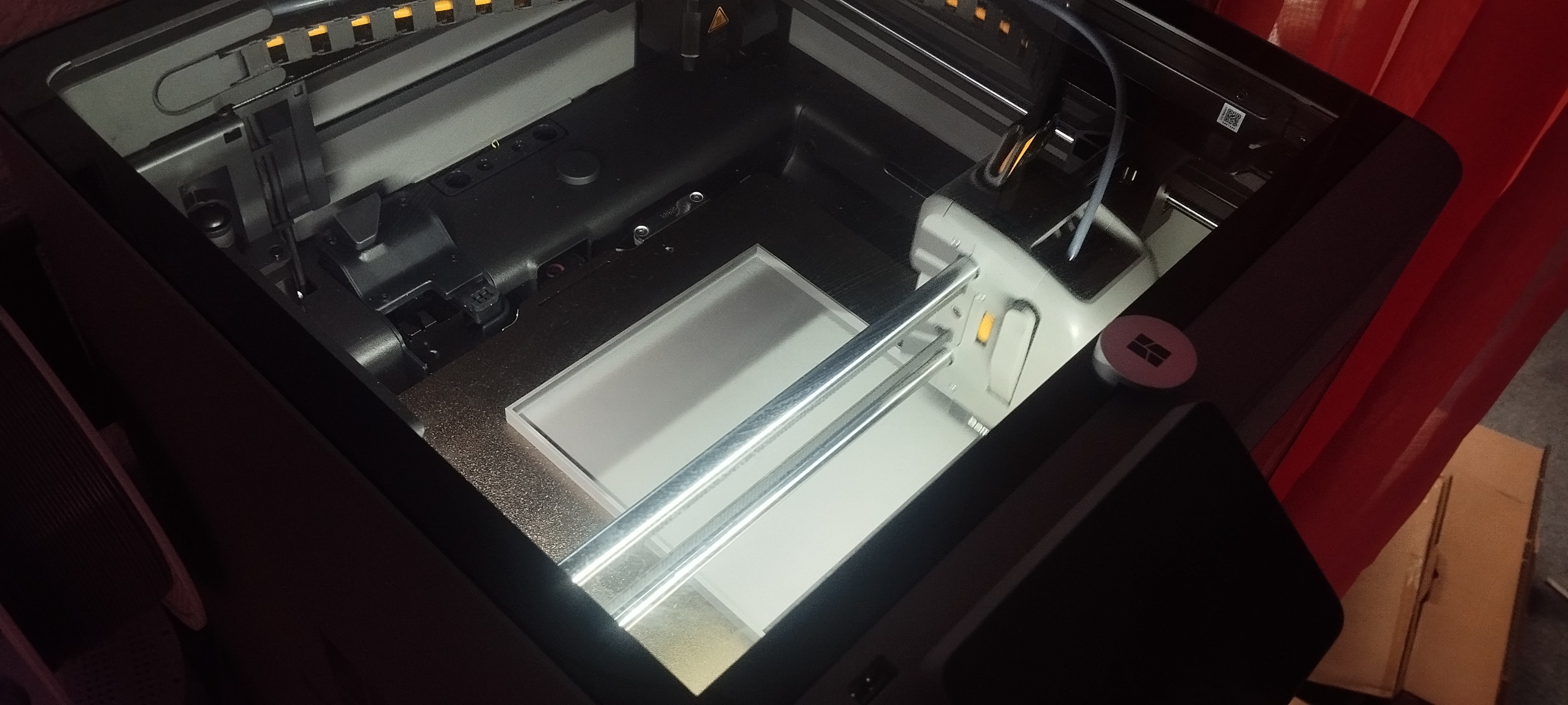

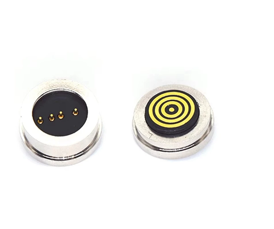

Molde
Modular platform where electronics snap together without wires.
Molde is an open-source modular hardware platform for building custom physical interfaces. Modules connect magnetically using pogo pins and communicate over a CAN bus. The long-term goal is to make hardware prototyping flexible while remaining simple, reusable and easy to configure.
Why?
Building hardware prototypes usually means connecting dozens of wires, redesigning PCBs, and rebuilding the same circuits over and over again.
Molde explores a different approach.
The idea is to build a reusable hardware ecosystem where the same modules can be combined in many different ways without rebuilding the entire project.
The Concept
The system consists of two main parts:
Main Panel – the base platform that provides power, communication and mechanical support.
Modules – interchangeable functional blocks such as displays, sensors, buttons, joysticks, communication interfaces and other electronics.
Modules attach magnetically using pogo-pin connectors, allowing them to be installed or replaced in seconds.
  • 5 × CH32V203F6P6 Modules
  • Experimental Module Prototypes
    Oleg07/24/2026 at 13:52 0 comments
    Today Molde reached another important milestone.
    ## Modules.
    The first set of experimental modules has been designed and 3D printed. These are not intended to become final products—they are simply test platforms for evaluating mechanics, connectors and future electronics.
    At the moment I have 4 magnetic connector pairs available  only, so I builded 4 different modules. Some are designed as 1×1 modules, while others occupy 1×2 cells. Supporting different module sizes has been part of the concept from the beginning.
    Current modules:
    2-axis analog joystick with push button
    8×8 LED matrix (MAX7219)
    Ultrasonic distance sensor
    Dual RGB LED module.
    I use MCU CH32V203 for driving each module ( any recommendations?).
    ## The Main Panel Evolves
    First printed panel 25×25 mm grid but after that I redesigned the base and increased the cell size to 30×30 mm. It already feels more comfortable, but I'm still not convinced this is the final size.
    Possible directions:
    reduce to 20×20 mm;
    increase to 35×35 mm;
    keep 30×30 mm but change the spacing between cells.
    ## Connector Evaluation
    One of the big open question is still the magnetic connector.
    So far I'm testing two different concepts.
    Type 1 — Circular connector
    allows free module rotation.
    Type 2 — Linear connector
    noticeably stronger magnetic attraction;
    aligns modules much more accurately.
    At this point I honestly don't know which solution is better. The circular connector offers more freedom. The linear connector offers better precision.
    ## Next Steps
    Develop the initial firmware for the CH32V203-based modules.
    Assemble the electronics for the Main Board prototype.
    One step closer. See you in the next update.
  • The First Physical Prototype
    Oleg07/18/2026 at 17:37 0 comments
    Today Molde took its first physical form.
    I 3D printed the first 5×5 prototype panel...
    The panel uses a 5×5 grid with 25×25 mm cells.
    Im not sure about size yet but anyway its a good starting point.
    The next step is turning this mechanical prototype into an interactive hardware platform.
    ## Connector Evaluation
    I also ordered two different types of magnetic connectors for evaluation.
    Each one has pros and cons. Will see
    ## Next Steps
    Design the first test modules.
    3D design and print boxes.
    Try to Integrate both connector types.
    Evaluate electrical reliability and holding force.
    One step closer. See you in the next update.
  • Project Goals
    Oleg07/17/2026 at 15:50 0 comments
    # Project Goals
    Molde has begun.
    This project is still at a very early stage. There are no working prototypes yet, and many engineering decisions are still ahead.
    The purpose of this log is to document the initial goals of the project before development begins.
    ## Main Goals
    - Create a modular hardware platform.
    - Use magnetic modules that can be placed anywhere on the panel.
    - Build a universal interactive base with reusable hardware modules.
    - Make the platform open source.
    - Keep the system simple enough for beginners, yet powerful enough for experienced developers.
    ## Long-Term Vision
    Users should be able to assemble, rearrange, and reuse hardware modules within seconds.
    ## Current Status
    At the moment, I have:
    - the initial concept;
    - several ideas that need to be validated.
    The next step is to validate the core mechanical and electrical concepts before designing the first Main Board.
View all 3 project logs
