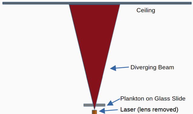

Removing the laser's collimating lens lets the laser diode's naturally diverging beam illuminate the specimen directly. Because the beam continues to expand after passing through the specimen, magnification is controlled by the distance between the specimen and the projection surface, eliminating the need for an objective lens, a focusing mechanism, or projection optics. The coherent laser light also produces diffraction halos, making organisms smaller than the microscope's optical resolution surprisingly easy to detect.

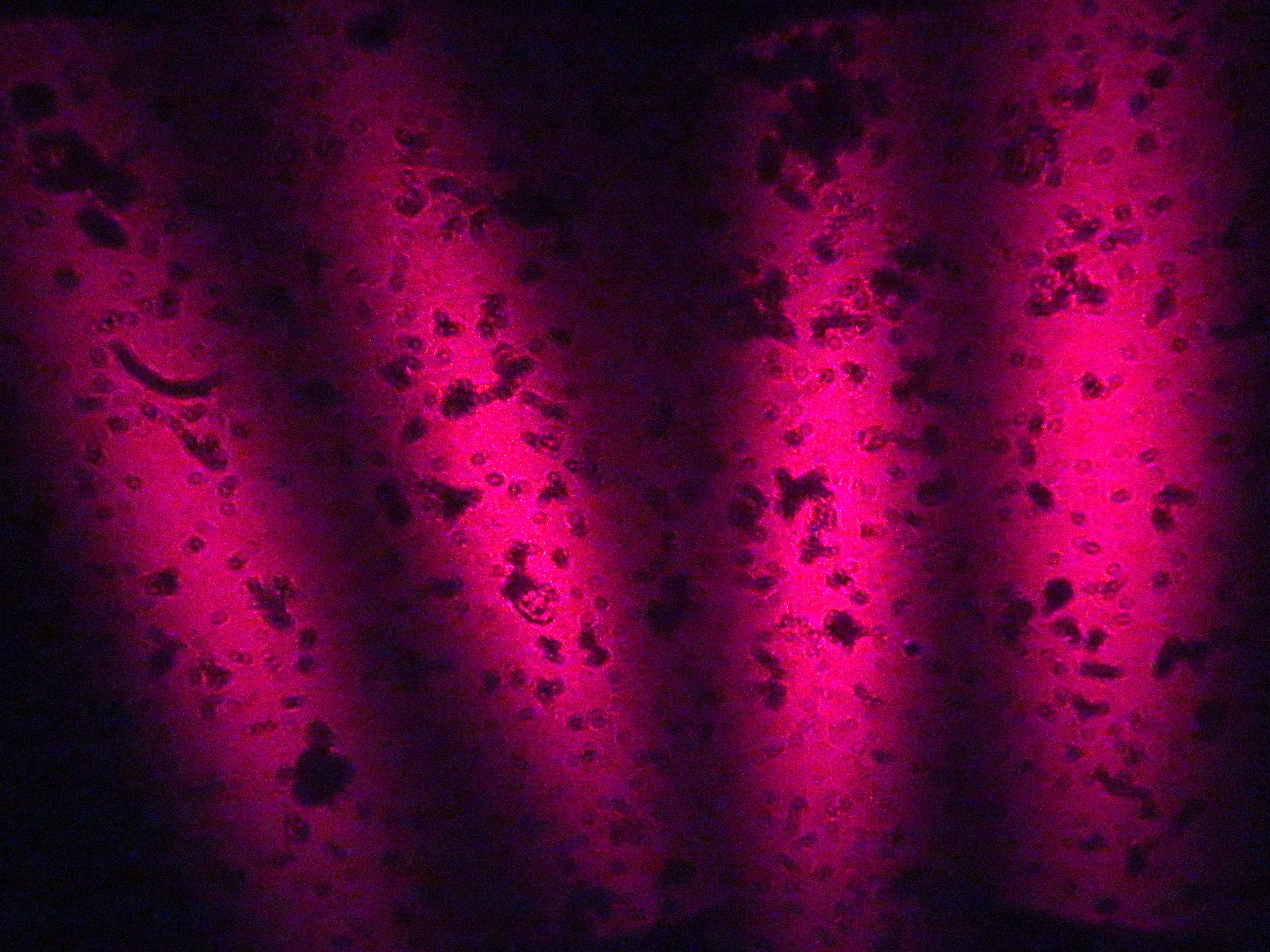

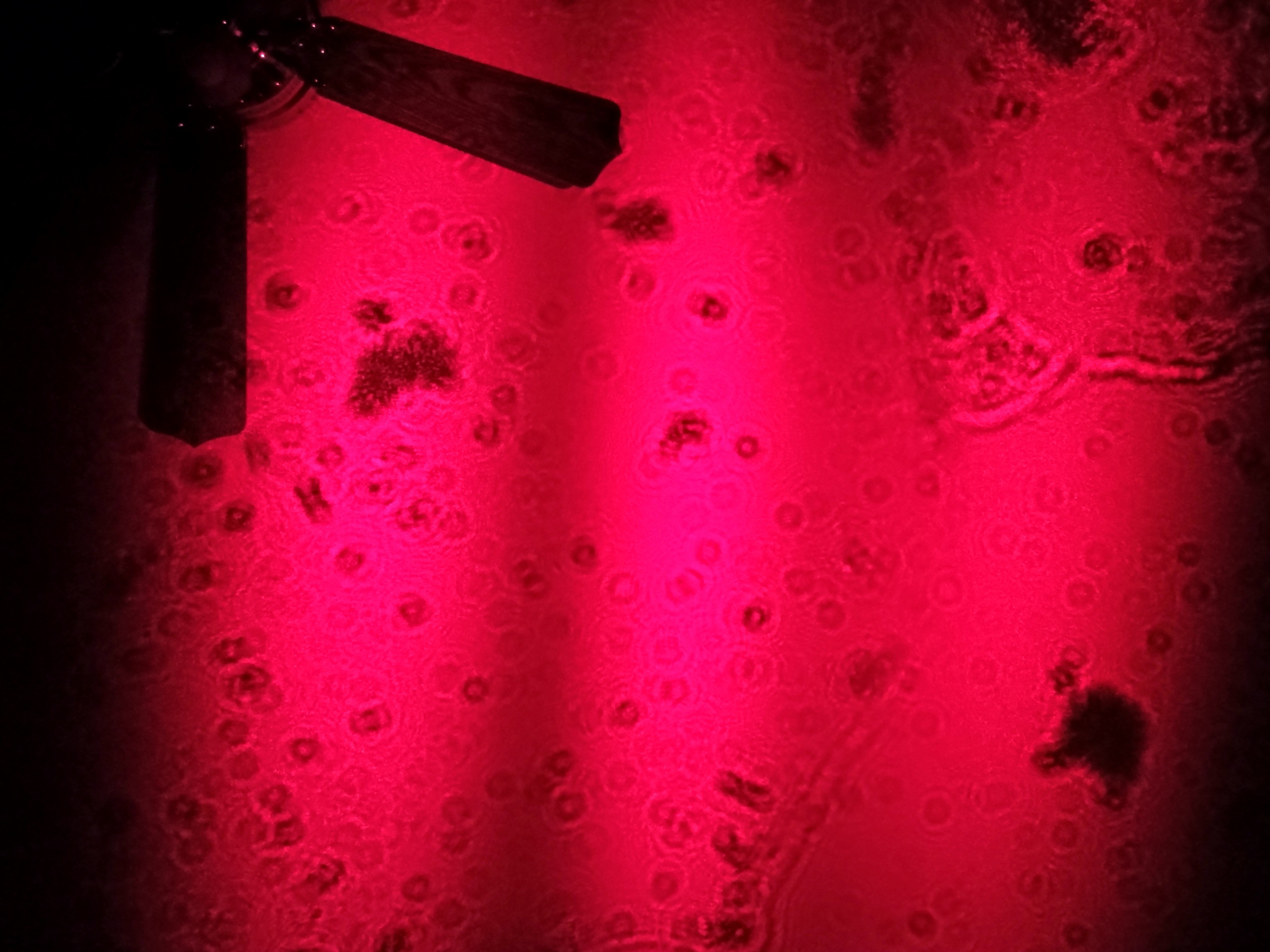

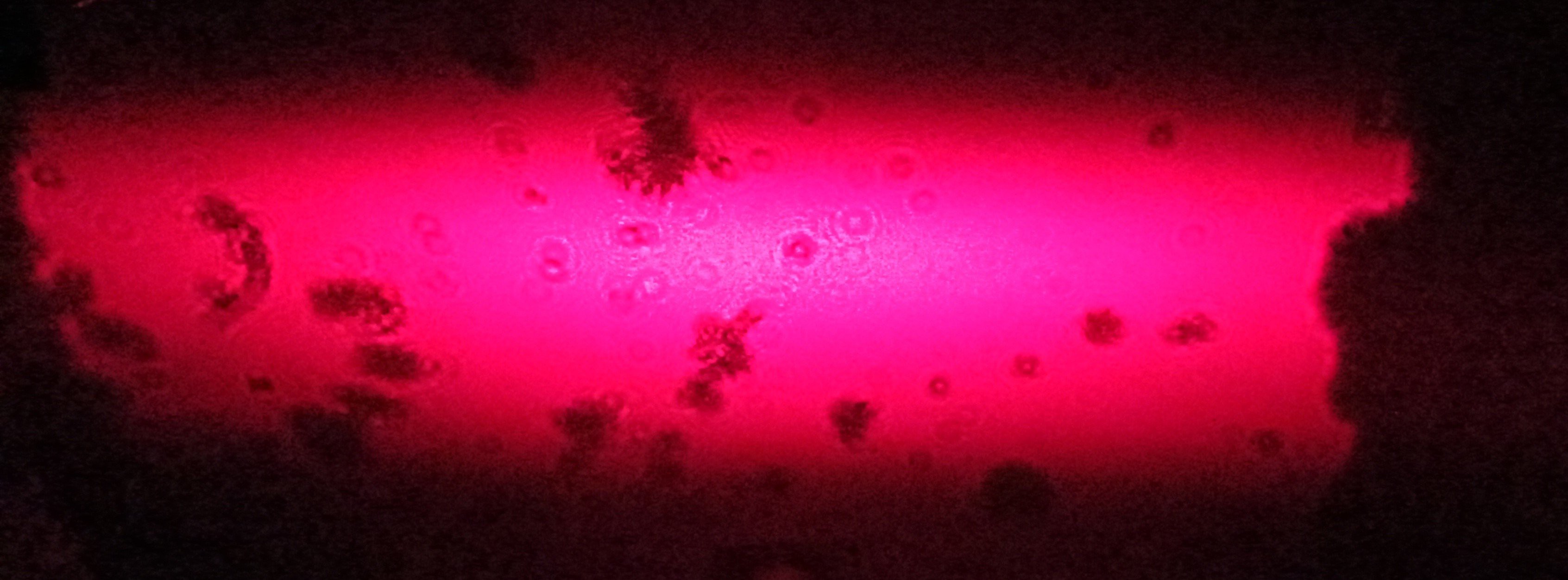

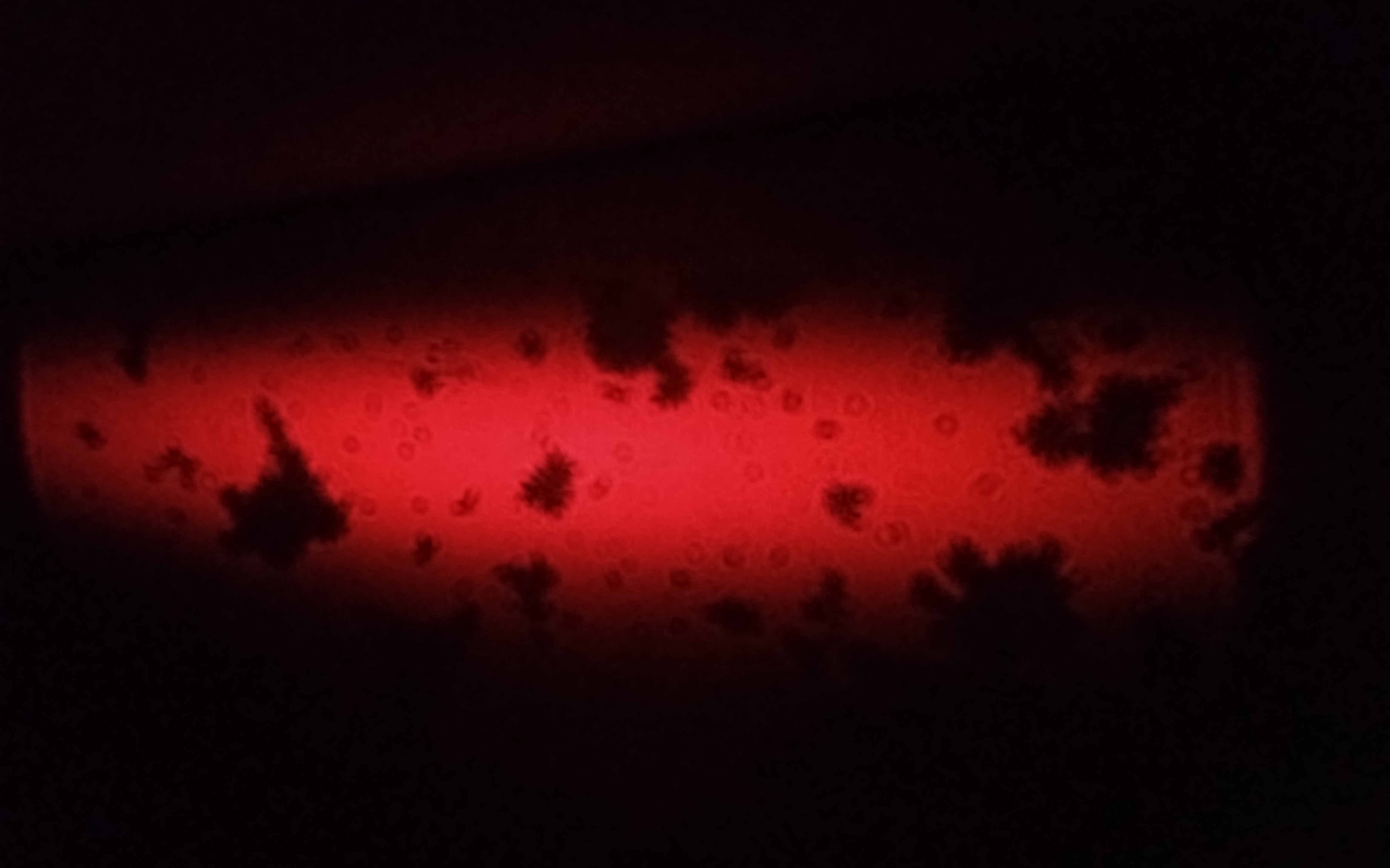

A single laser projects an elliptical field of view of the plankton sample onto the ceiling. The dark clumps are algae. The small circles are ciliates, too small to be resolved by the microscope but visible as diffraction halos produced by the coherent laser light.

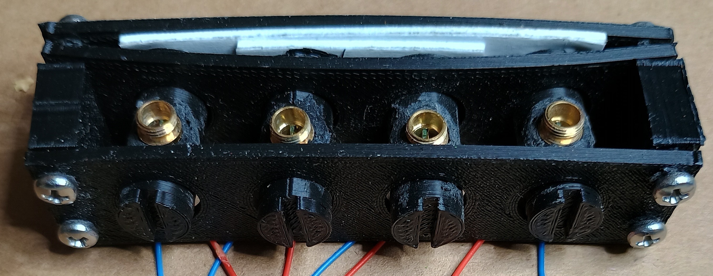

Multiple lasers mounted in rotating cylindrical Laser Pods project adjacent regions of the microscope slide. Rotating each Laser Pod aligns the projected regions to create a wider display, allowing much more of the ceiling to be covered than a single laser can illuminate.

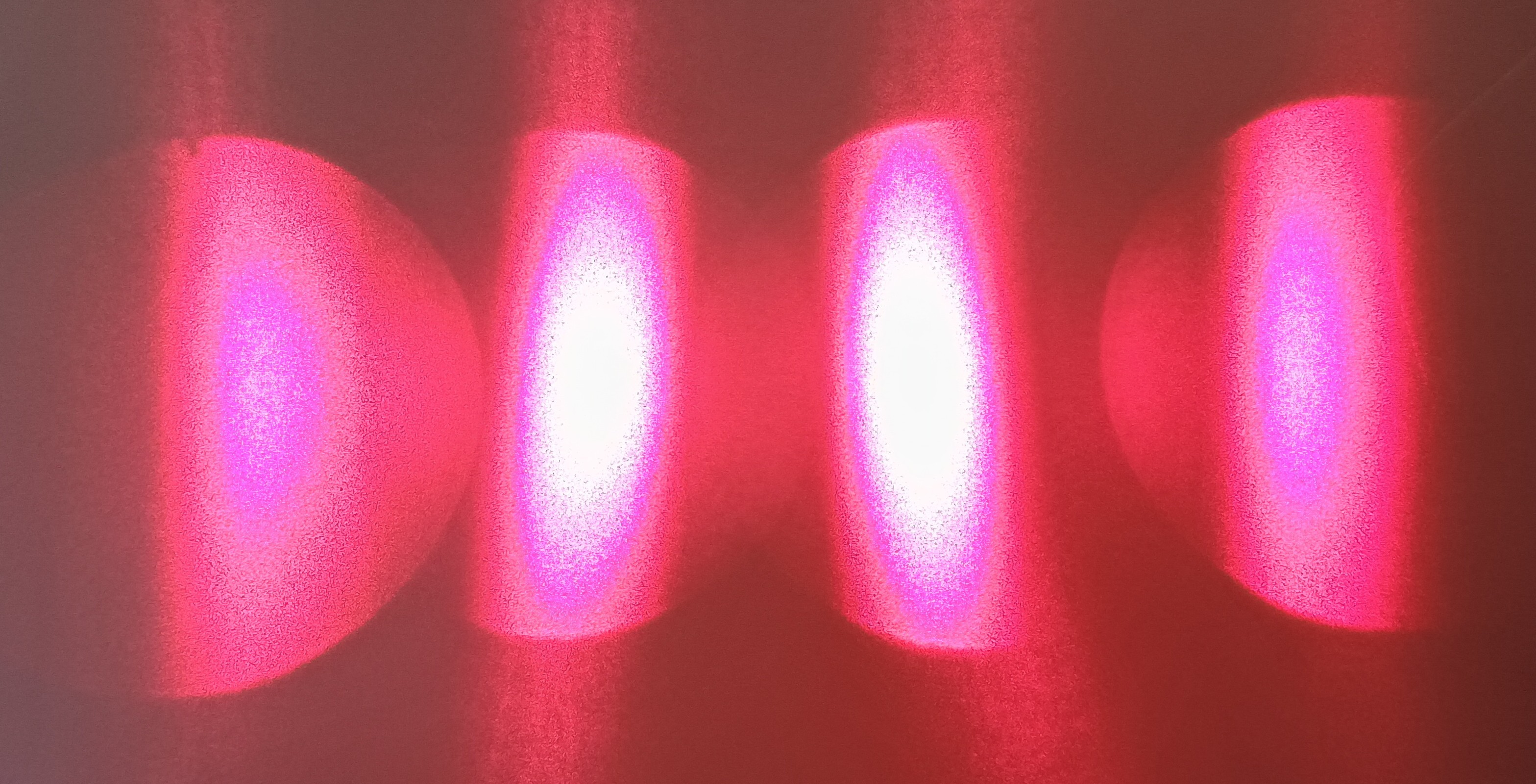

Four independently adjustable laser projection zones are positioned side by side to create a larger field of view than a single laser can produce.

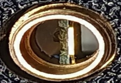

With the collimating lens removed, the laser beam is elliptical, approximately three times longer than it is wide. To maximize ceiling coverage, install each laser module so the flat sides of its brass heat sink are perpendicular to the beam's major axis. This ensures that every Laser Pod produces the same beam orientation.
Close-up of Laser Module Showing Heat Sink Orientation Major Axis of Beam Pattern Perpendicular to the Heat Sink

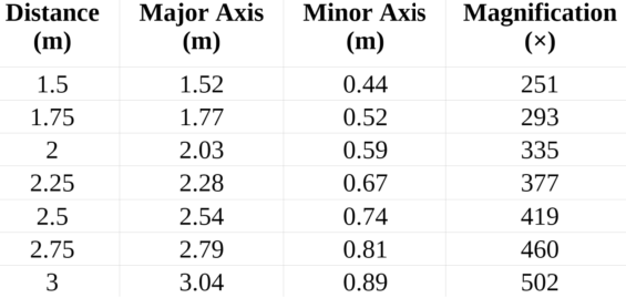

The following measurements characterize the optical performance and mechanical design of the projection microscope.
The major and minor axes of the laser beam were measured as a function of distance. The laser case blocks the beam along the ends of the major axis, creating sharp edges that are easy to measure. The minor axis gradually fades into the background and has no sharp boundary, making its width more subjective to estimate.

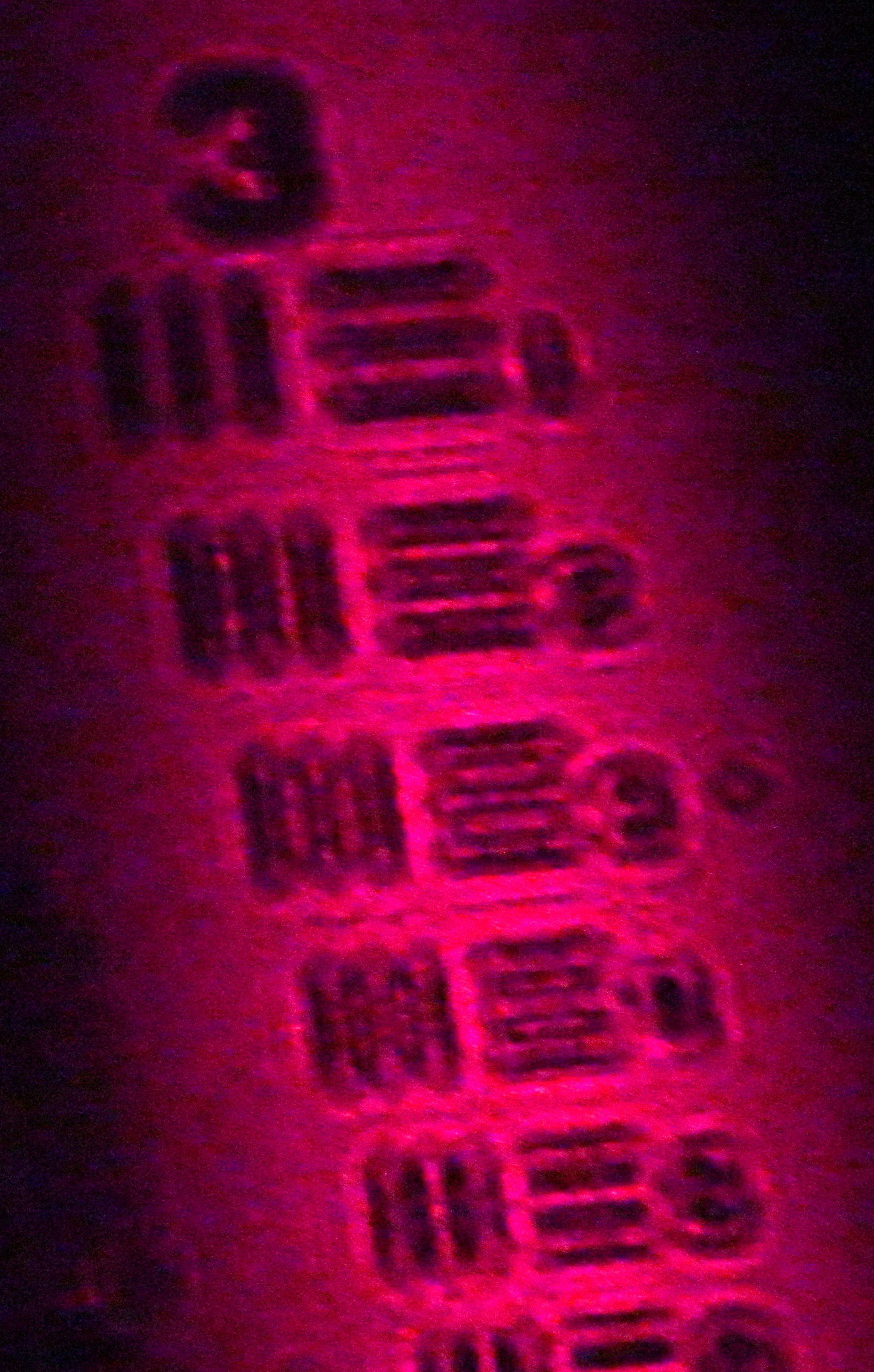

The microscope resolves features approximately 44 µm wide, as measured with a USAF 1951 resolution target (Group 3, Element 4). The known target dimensions and a 1.47 m projection distance yielded a magnification of approximately 250×.

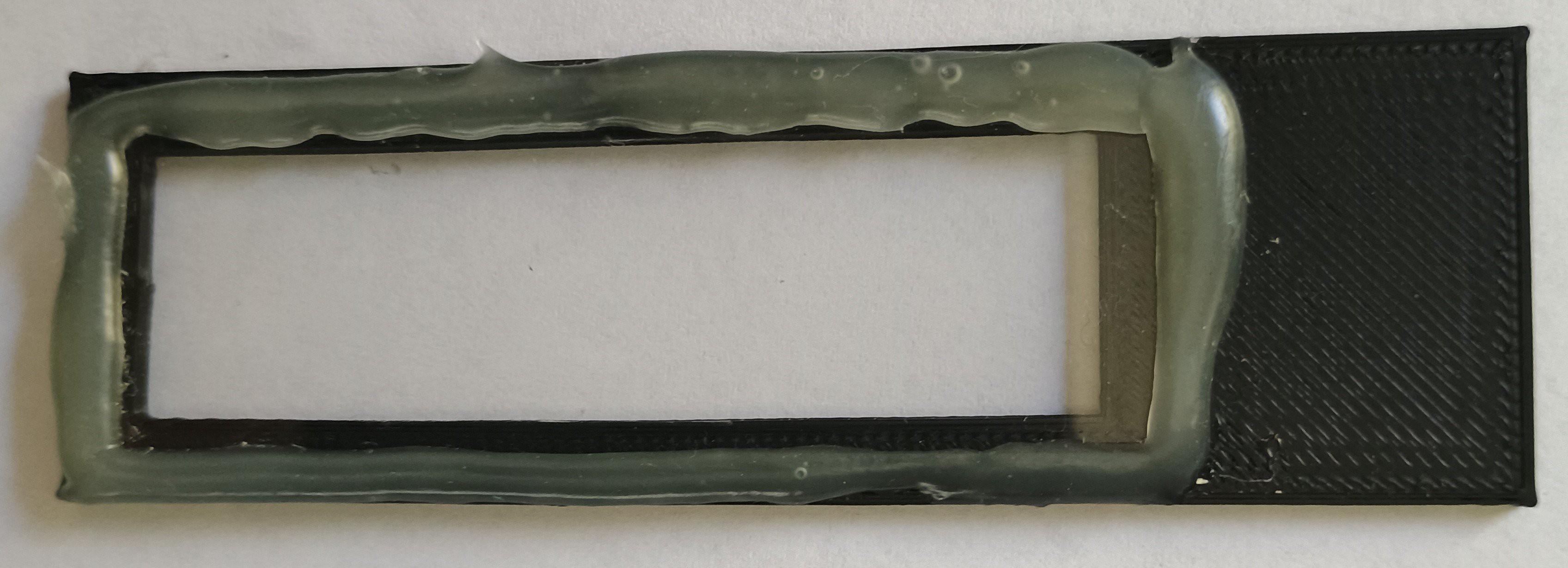

A 3D-printed frame supports the glass slide, while a hot-glue moat contains the water sample. The fabrication procedure is described in the Instructions section.

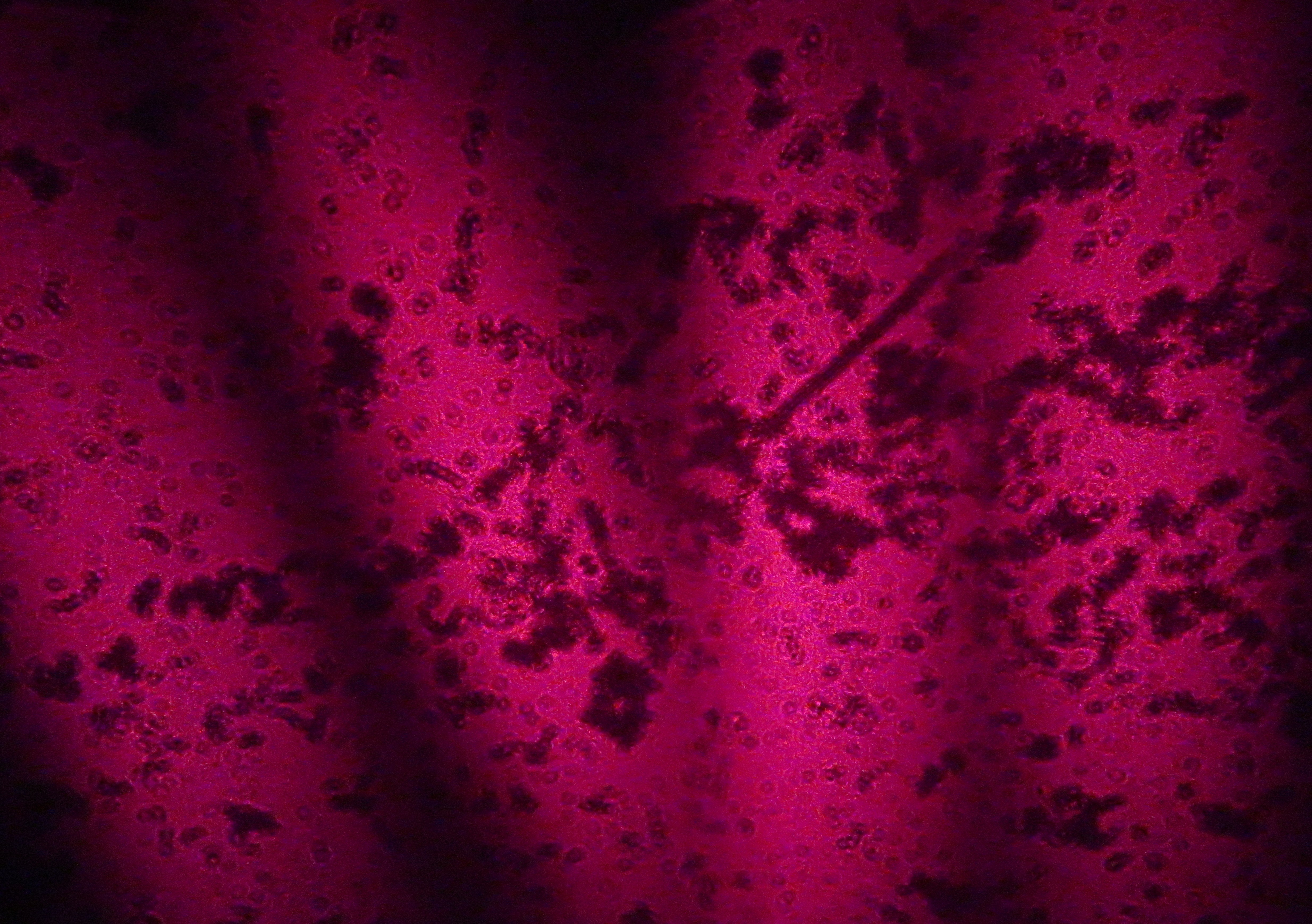

Plankton from Almaden Lake — Four-Zone Plankton Planetarium
This is the Plankton Planetarium in its natural element. A drop of pond water collected locally from Almaden Lake in San Jose, California is projected across the ceiling, where multiple laser zones create a wide viewing area. Watch as microscopic organisms swim, crawl, and interact at room scale.

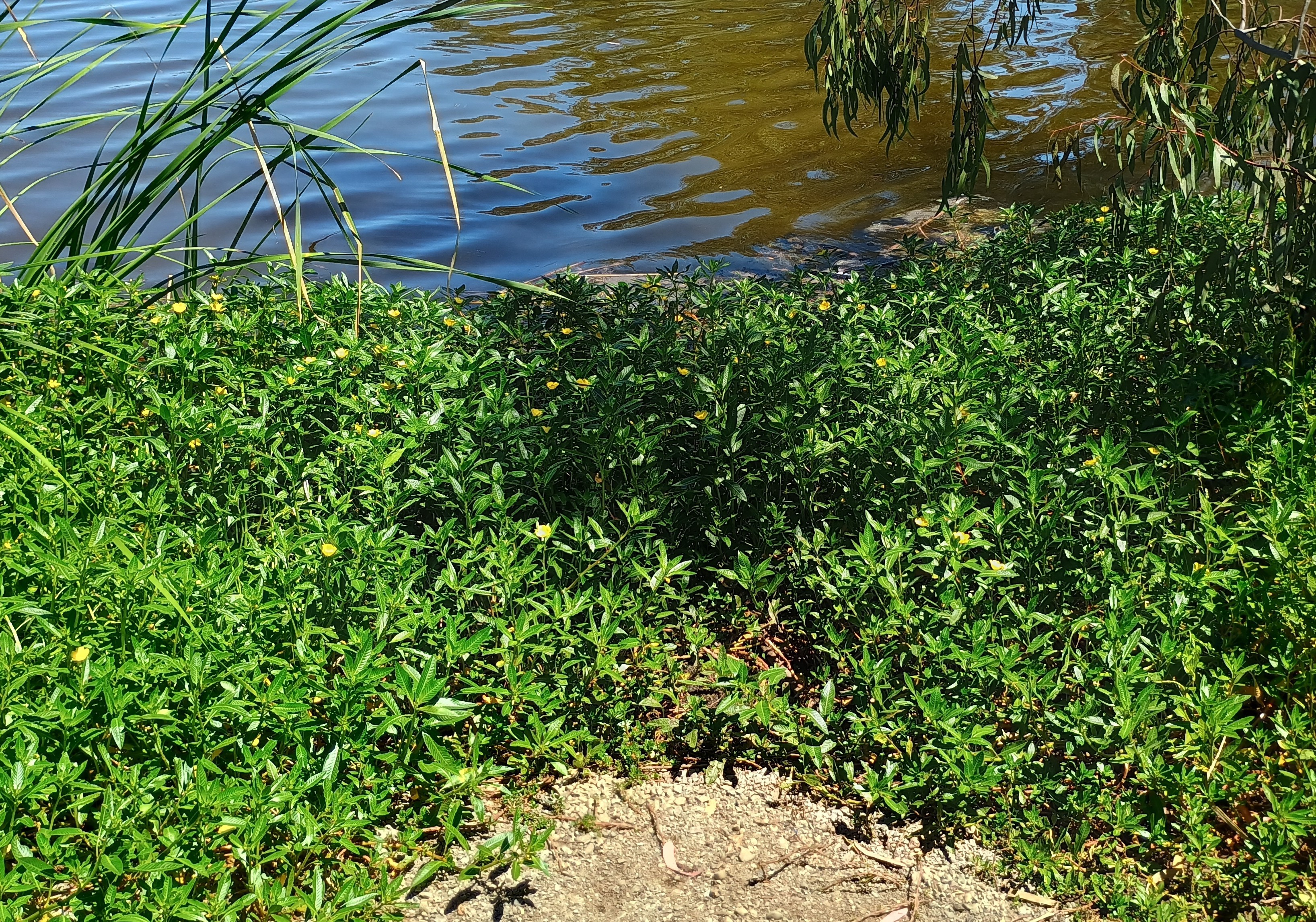

    Google Maps and Street View lead me to Almaden Lake Park. ChatGPT suggests sampling around the little aquatic plants instead of the flowing creek. The south entrance looks like the best place to start. Grab a bunch of jars and a hat. Beautiful sunny day. I never would have come here without this project. I'd probably be home scrolling the Internet. Instead I'm walking through one of the prettiest parks around. Hardly anybody's here. It's so peaceful. I need to bring my wife here for a nature walk.
    The creek samples weren't very interesting. The water was moving too quickly for plankton to accumulate. Along the quiet edge of the lake, I noticed patches of small aquatic plants growing in soft, spongy soil. The sheltered water was calm, protected from the current, and looked like the kind of place where microscopic life could flourish. I filled several sample jars and took a picture so I could find the collection site again.

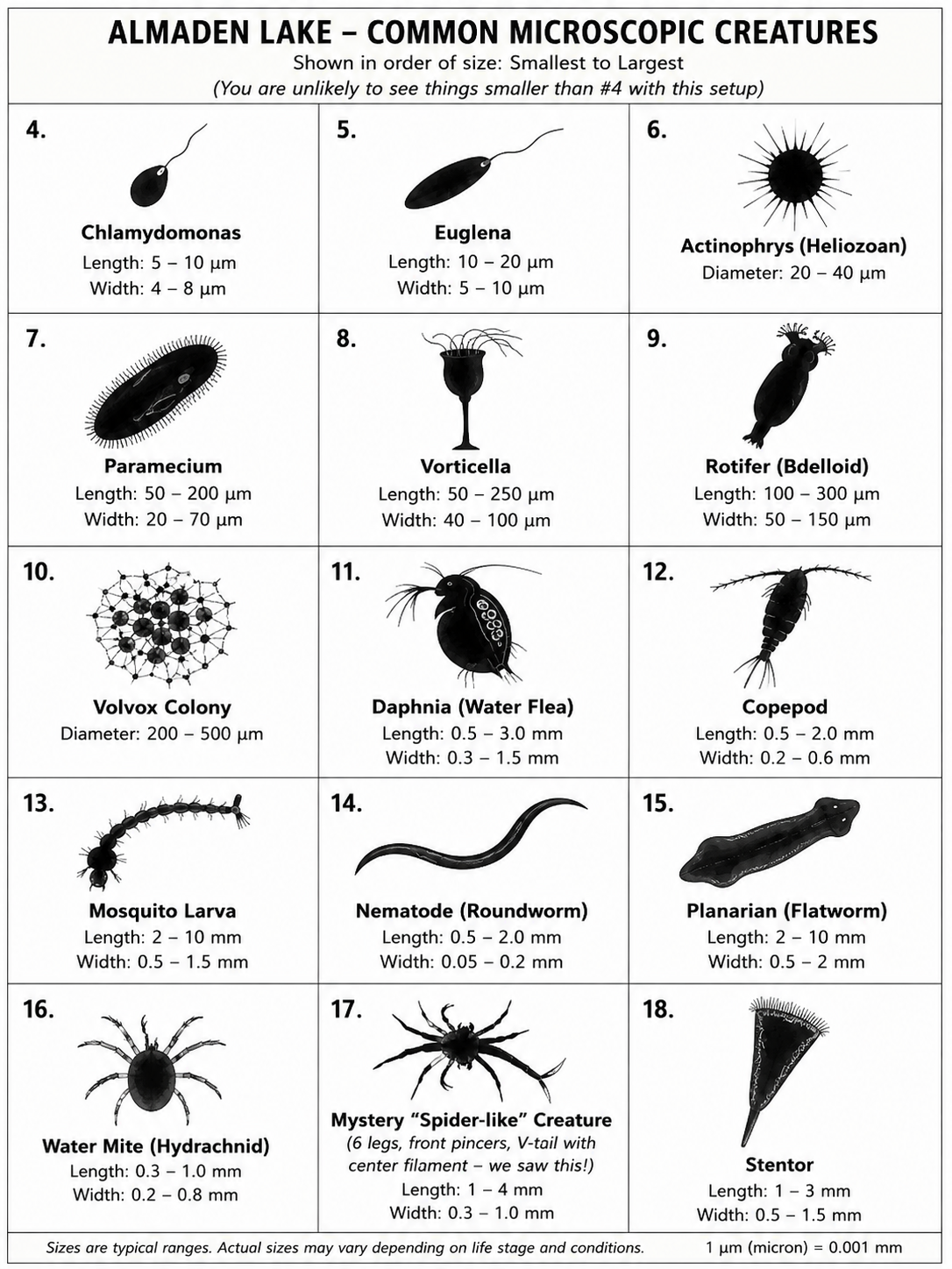

    Back home, I used ChatGPT to help identify what I was seeing and generate a silhouette guide of the creatures I was likely to find—my own version of Plankton Bingo. I measured the microscope's resolution with a USAF target and found it to be about 50 µm. Even so, diffraction halos made many organisms much smaller than that visible, although not sharply resolved. Because of that, I asked ChatGPT to include only organisms 10 µm and larger in the guide.
    Then I spotted a Stentor, one of my favorite organisms. Almost a millimeter long, yet still just a single cell. A little later I watched a mysterious spider-like predator attack another creature—just the kind of interaction I had hoped to see. I cropped the image and gave it to ChatGPT. It suggested a water mite, but the body and legs didn't match. I traced the body outline and submitted it again. Still a mystery.
    I feel like Leeuwenhoek in the 1600s exploring the invisible world in a drop of pond water. Turns out both our microscopes magnify about 300×. It's the same fascination I had when I built the lensless microscope years ago. What an amazing world hiding in a single drop of water.

    I designed separate rotating laser pods from 9 mm diameter cylinders. A small piece of foam tape presses against the end of each cylinder, providing just enough friction for the pod to hold its position while still allowing it to rotate. It's a crude solution, but it works remarkably well. Each pod is finished with a 6 mm drill bit, creating a snug press fit for the laser module.
    I added foam tape to press against the Laser Pod flanges to create enough friction to hold each pod when adjusting position. However, the added pressure bent the original 2 mm-thick pressure plate. I increased the thickness to 3 mm in the latest design, but still need to test to determine if it's stiff enough. As I add more Laser Pods, I'll need a better friction mechanism.

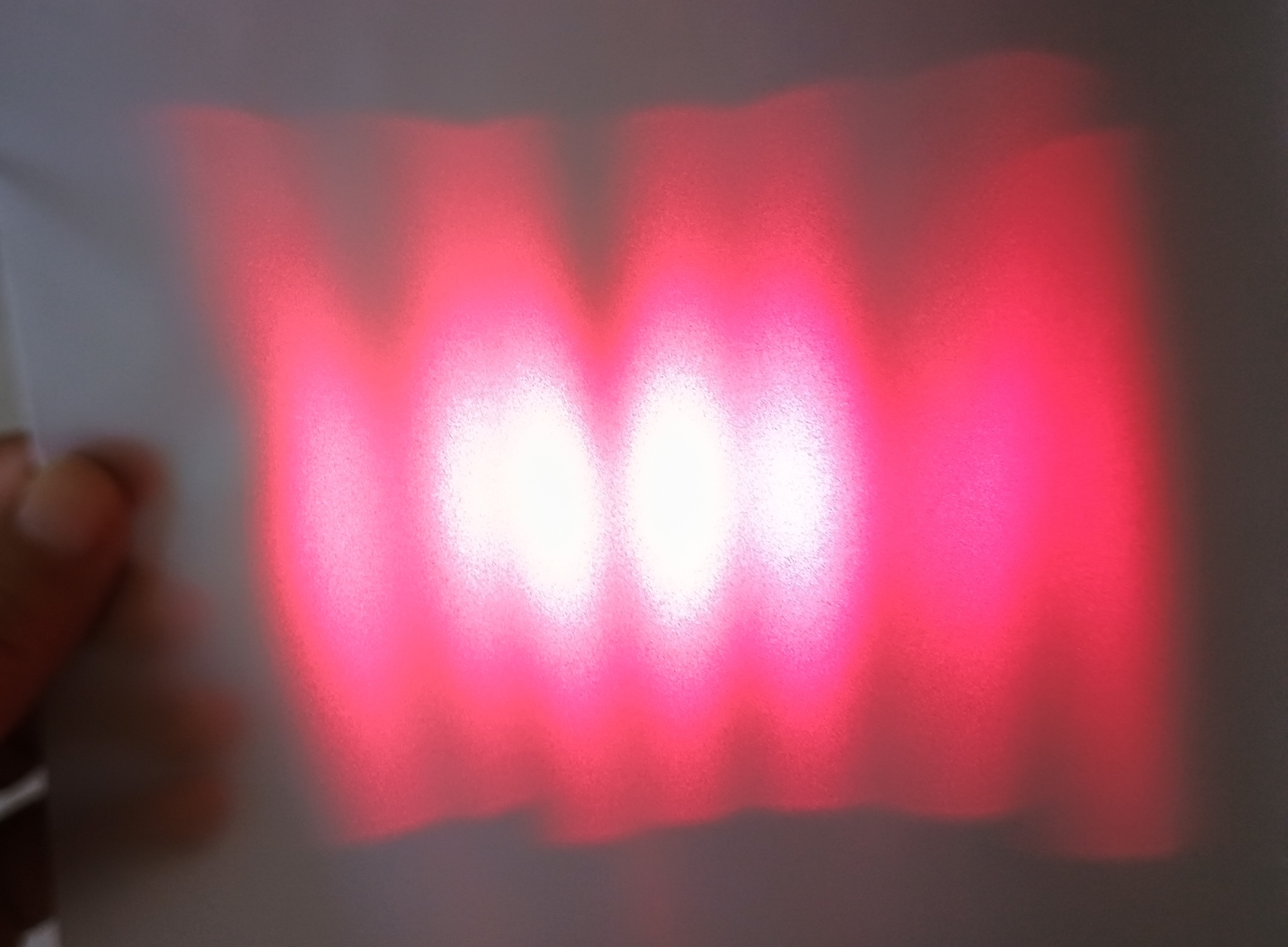

    Aligning the beams turned out to be surprisingly easy. I push each laser through its pod until the threaded end protrudes, then project the pattern onto a sheet of paper a few inches above the array. The pattern immediately shows which laser needs to be rotated and by how much. I grip the threaded end with pliers, rotate it into alignment, and secure it with a single dab of hot glue. Done. Getting all the projected zones parallel is essential for creating a convincing continuous display.

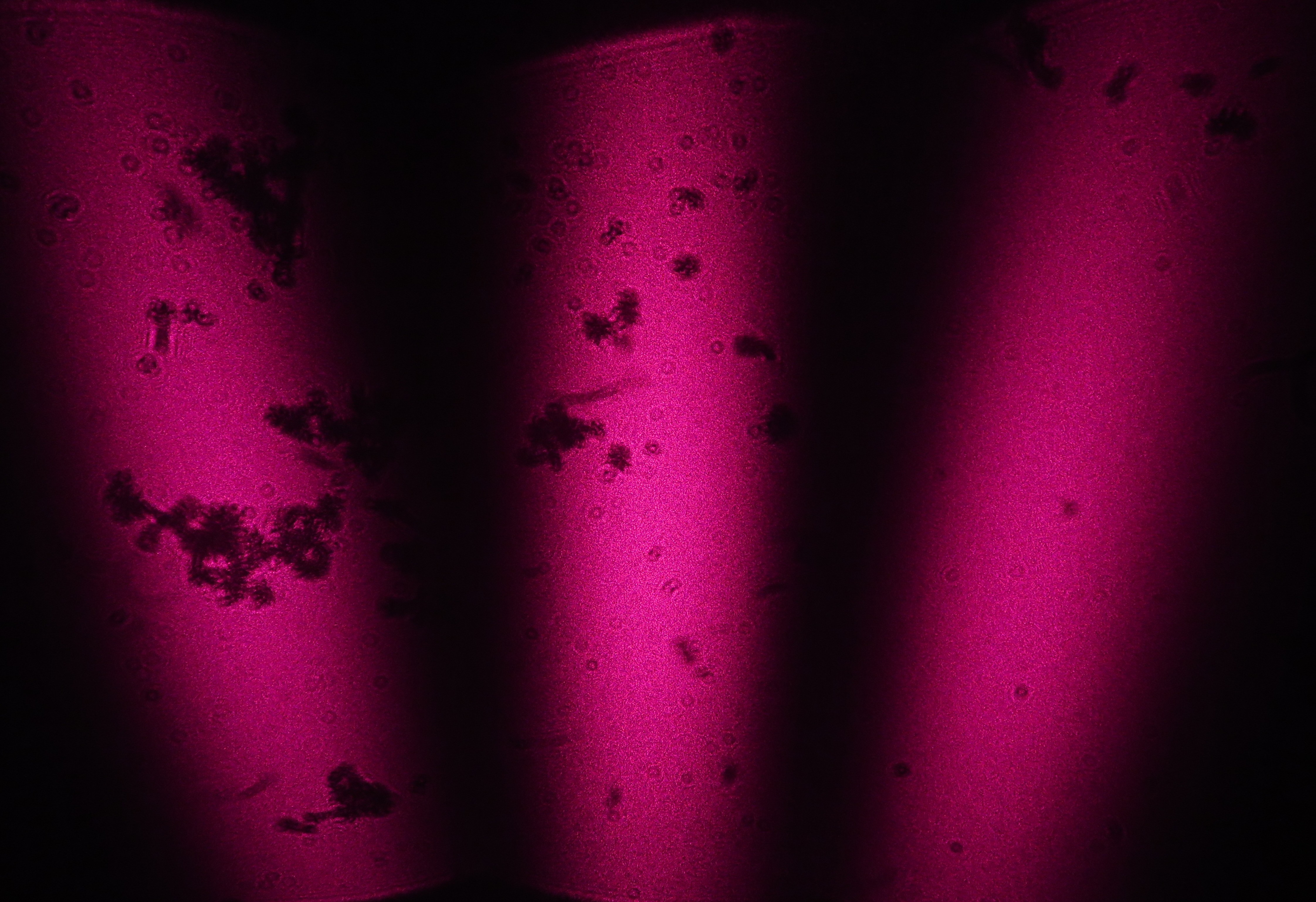

    By staggering the laser rows, I brought neighboring projected fields close enough that an organism leaving one bright zone gradually faded into the next bright zone, like the Romulan cloaking device in the original Star Trek. Instead of disappearing into darkness, it crossfaded between adjacent projections, giving the impression of a continuous display.
    Surprisingly, I preferred the original fade-to-black effect. Organisms remained visible longer as they drifted out of an illuminated zone before disappearing. It became clear that there isn't a single "best" display mode. There are at least two: fade-to-black and crossfade.
    The real limitation isn't on the ceiling; it's on the microscope slide. The illuminated regions are separated by several millimeters, so when an organism leaves one laser beam it usually swims through an unseen region before reaching the next beam, if it reaches it at all. The holy grail is continuous bright-to-bright motion, where organisms appear to swim seamlessly from one projected field into the next. The next step is to make the spacing between the laser modules adjustable so users can tune the overlap for their own optics, ceiling height, and viewing preference.
    Fade to Black (Gaps Between Zones)
    Crossfade (Overlapping Zones)

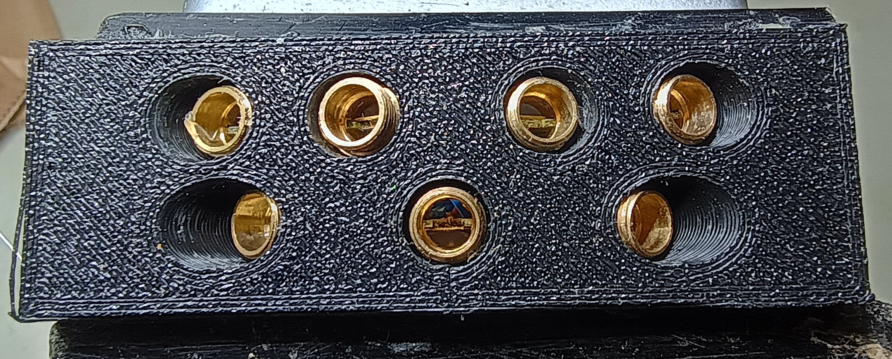

    I arranged the seven lasers in two staggered rows, with four in one row and three in the other. The projected fields were slightly misaligned, but I hardly noticed. My attention stayed on the living creatures roaming across the ceiling, not on the small registration error.
    The real breakthrough wasn't the slight increase in coverage—it was realizing that the laser array no longer had to be a single row. Until now, I had only thought about adding more lasers side by side to make the display wider. Stacking them in rows opened up a second dimension. Future versions could grow both horizontally and vertically, eventually creating much larger, denser displays. This experiment also pointed toward the next challenge: if the individual lasers could be adjusted independently, I might be able to overlap neighboring projected fields and create one continuous living world.
    Staggering the lasers opens a second dimension for expanding the display
    Seven laser modules arranged in two staggered rows. This layout packs projection zones more densely and can be extended both horizontally and vertically.

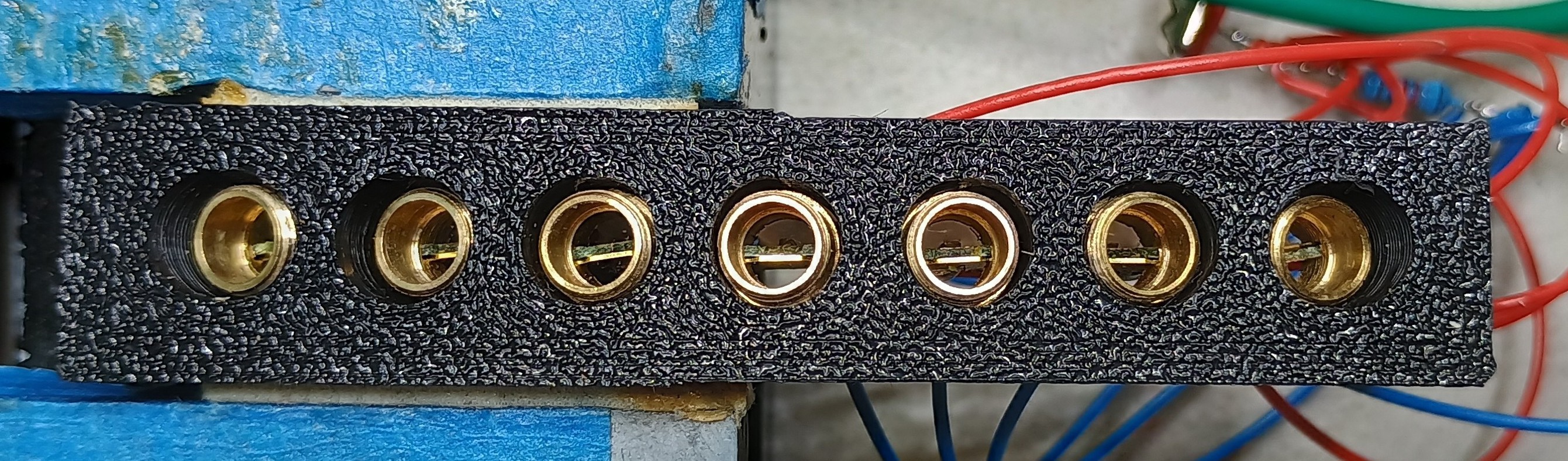

    I used Tinkercad to design a strip that holds seven lasers. By reducing the tilt-angle increment from 15° to 8° (-24°, -16°, -8°, 0°, +8°, +16°, and +24°), I brought the projected fields closer together, reducing the dark gaps between them. Incredible! The ceiling was alive with plankton. From seven feet below, the projections covered the entire fourteen-foot-wide ceiling, even spilling onto the walls. For the first time, the display felt immersive. I stopped thinking about the optics and simply watched the living world above me.
    I was so excited I had to show my wife. We lay in bed watching plankton crawl across the ceiling. It was like a planetarium, except the constellations were alive. Rotifers darted like shooting stars, while an occasional nematode slowly wiggled through the scene. Most of the creatures gathered around tiny clumps of algae, creating little islands of activity.
    I could easily imagine families ending the evening this way, watching a living ecosystem together. It would make a wonderful night light, except that the sample eventually dries out. A deeper sample chamber might extend the viewing time, or a low-flow peristaltic pump could periodically add fresh pond water. I also noticed that when I gently shook the slide, every organism froze for a few moments before gradually coming back to life. A tiny vibration motor could automate that, periodically stirring the sample and bringing new organisms into view.
    Seven lasers transformed the experience, but the display still wasn't continuous. I could watch an organism swim across one projected field until it disappeared into a dark gap. It never emerged in the next field because the laser beams were separated by a few millimeters on the slide. The illusion of a single living world was broken. The next challenge is to bring the projected fields close enough together that organisms appear to swim seamlessly from one zone into the next.

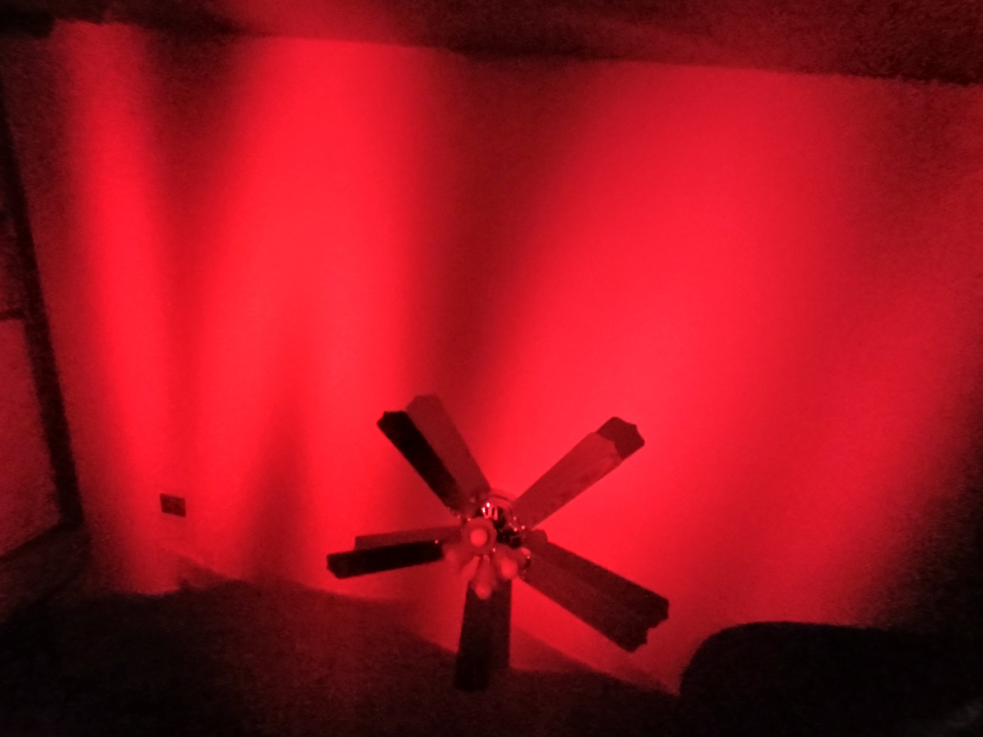

    Seven laser beams fill a 14-foot-wide ceiling
    Seven expanded laser beams illuminate a 14-foot-wide ceiling. This image shows only the laser illumination pattern—no microscope slide or plankton is present.

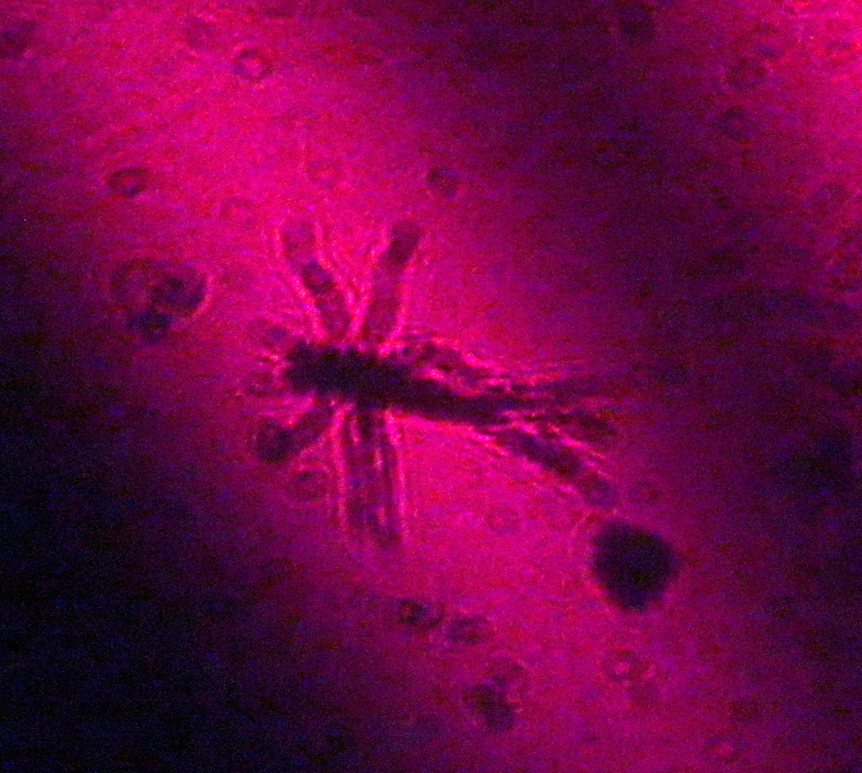

    Tiny ciliates are too small to resolve directly, but coherent laser illumination reveals them as diffraction halos.
    Close-up of three regions showing tiny ciliates—single-celled organisms covered with hundreds of hair-like structures called cilia that beat to propel them through the water. Although the ciliates are below the microscope's resolution limit, they remain visible as bright halos produced by diffraction of the coherent laser light.

    Then came the hardest part: alignment. I projected the beams onto a sheet of paper a few inches above the lasers. Instead of neat, parallel ellipses, they looked like a row of crooked teeth waiting for braces.

    Took the lens off a cheap red laser module. The beam is really asymmetric. Traced it out on a piece of paper. About 3:1, a long ellipse. The major axis is at a right angle to the gold seam on the package. Put it in a vise with a microscope slide on top. Got some standing water from my basil plants outside. Projected it on my bedroom ceiling. At about 6 feet the beam is roughly six feet by two feet. Wow! Rotifers swimming around. A wiggling nematode. Then the stars of the show—mosquito larvae. They look like creepy caterpillars. It's a whole world of plankton on my ceiling.

    Using pliers, rotate each laser so the gold seam on the laser module is parallel to the Laser Pod. The laser's elliptical beam projects perpendicular to this seam. Check beam orientation by rotating each Laser Pod to the 12 o'clock position so the beams point straight up. Place a sheet of white paper above the lasers and turn on the power. Slowly raise the paper until the elliptical beam patterns are just touching. All ellipses should have the same vertical orientation and be parallel to one another. Mark any misaligned lasers, turn off the power, and rotate each laser barrel until all beam patterns are parallel. Repeat the check until all lasers are aligned. Lock the alignment by applying a small dab of hot glue to each laser module to prevent it from rotating.
