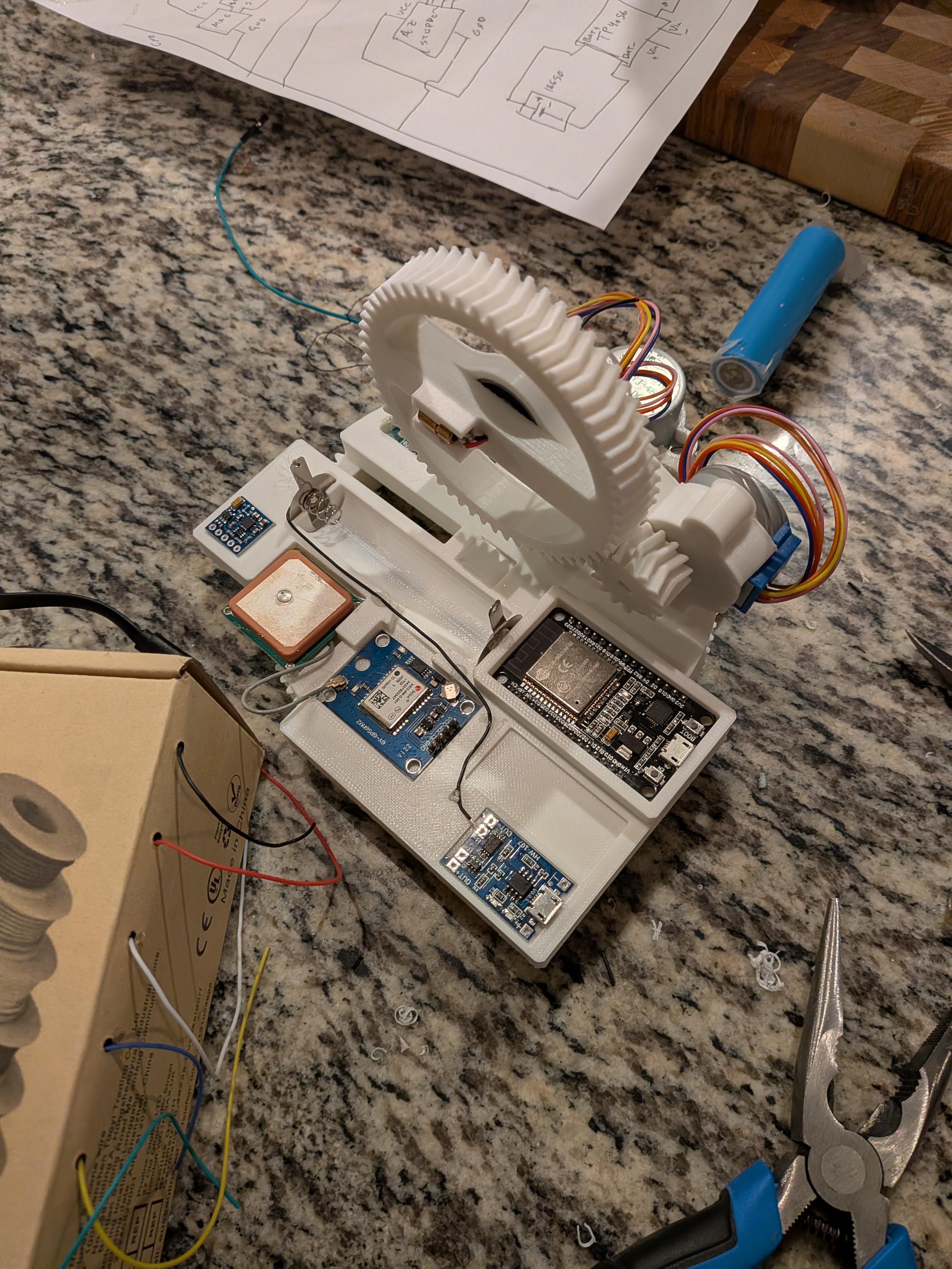

Laser diode controlled by 2 stepper motors in azimuth and elevation to point to and track different points of interest based on position. GPS Module and magnetometer to locate position and bearing. Run by an ESP32 to connect online and get realtime position of objects of interest (e.g. ISS, various satellites, potential stars/planets- maybe even airline flights: for indoor tracking of flights only).

Upleveled github ESP32 code by having Gemini write a much nicer README. Wrote most of the current esp32 code myself so that I could have a better idea of system structure (some learning as I go, which is part of the reason for doing projects in the first place :D)
azimuth and pitch motors are working properly and receive commands via micropython repl-
azimuth stage tends to stick. a product of 3d printing tolerances I believe
wrote a little script to sample and average a bunch of magnetometer readings- average of 100 samples shows distinct change in magnetometer readings (yay!) very cool to see especially while testing remotely
magnetometer and stepper motor values are arbitrary in scale and meaning right now but the consistent correlation is exciting (it's not random!...er...okay, it's not completely random!)
calibrations pending...
video of pitch and azimuthal axes running concurrently pending (reason for asyncio)...
I'm very much the kind of person who needs to understand the ins and outs of how a project functions- this is doubly true if I am making the project and putting my name on it. Claude made a truly impressive interface to get the first steps going on the azimuth and pitch axes but everything else was a miss. Somewhat delighted that I have to roll my sleeves up I am going to have to scrap Claude's first run because it's too much and too complex for me to understand outright what was written and it's not worth spending cycles trying to learn it- better to build the aprts up myself so I know whow everything goes together. That way I'll be able to troubleshoot when something goes wrong. Claude's not fired per se but I'm defintiely going to need to build the firmware myself.

Azimuth is continuous— the pinion walks around a stationary ring gear and every wire rides the rotating stage, so there's no cable wrap and the firmware always slews the short way around. 20:3 gearing on top of the 28BYJ-48's internal 63.68:1 works out to ~75 half-steps per degree: 0.013° resolution.
Elevation gets ±120° of software travel.The only thing on the elevation stage is the laser diode, on wires with a couple turns of slack. Why below the horizon? Because indoors, an ISS pass doesn't end at the horizon — the dot just keeps crawling down my wall. That's the whole point of the project: making the invisible geometry visible.

Current gremlin: the GY-271 magnetometer isn't answering on the I2C bus — scan comes up empty, so it's wiring/pullups/dead-board territory rather than software. The firmware shrugs it off (the compass was only ever an advisory coarse-north...
Managed to 3d print the design and start assembling it. Here is a video of the azimuth and pitch stage working. Having some trouble with the magnetometer and laser diode which is tied directly to esp32 gpio pin (for low power but my bench test showed that 3.3v works to light the diodee with only a 14mA power draw so I should be okay to power the diode from the esp32).
