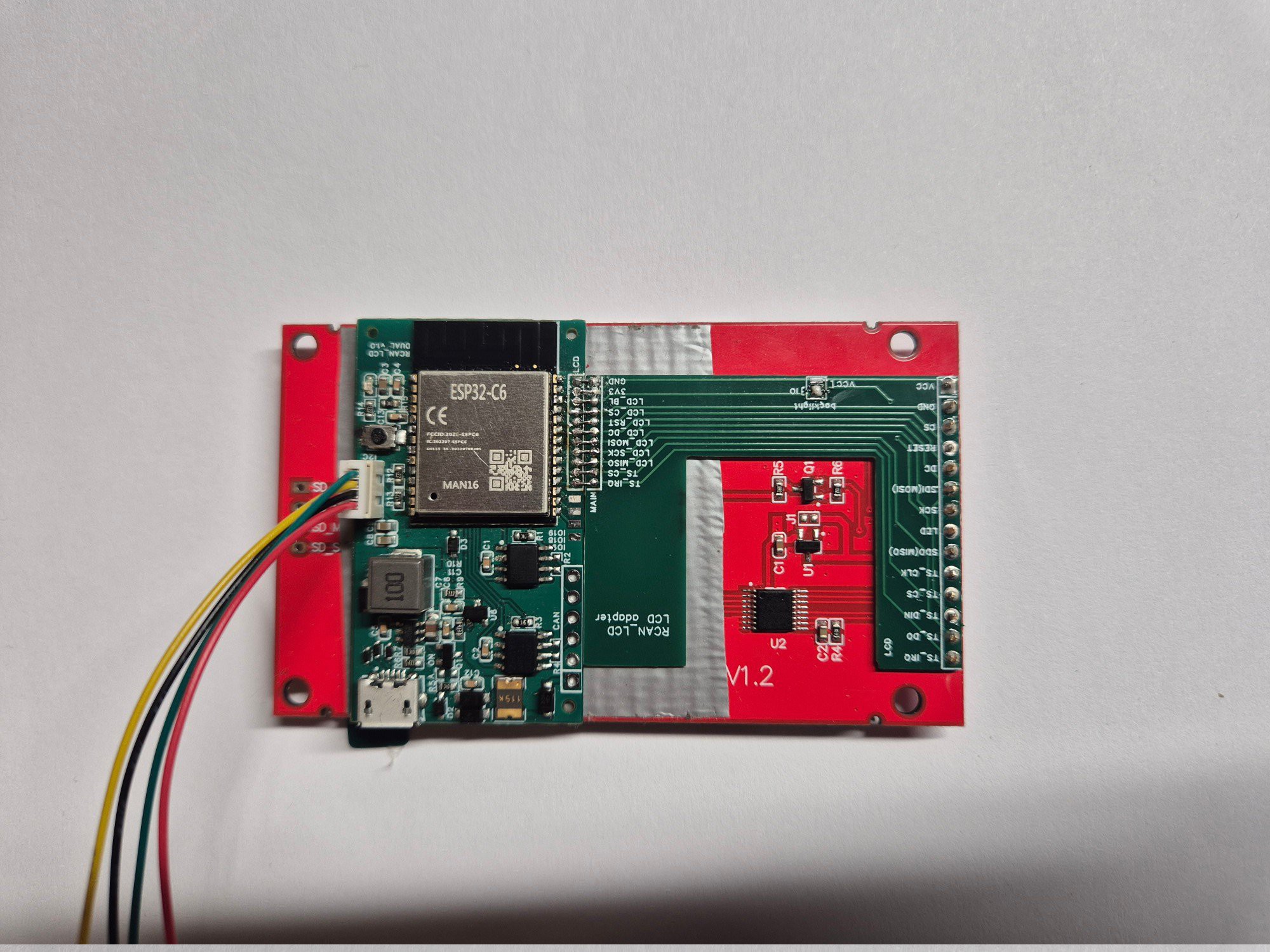

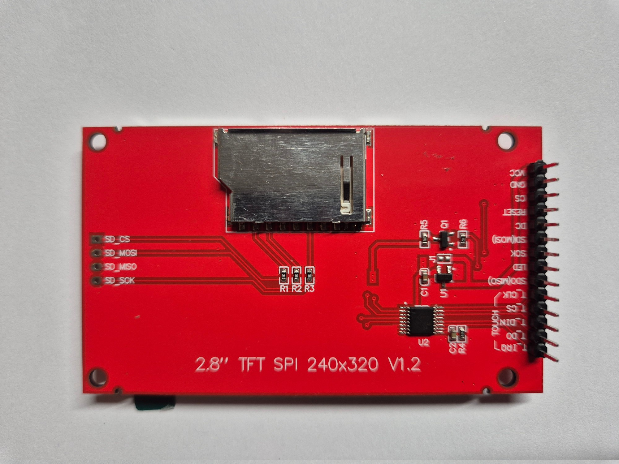

As LCD I took a red 2.8 inch SPI board from which I removed the SD card reader to place the module there together with an adapter PCB for LCD connection.

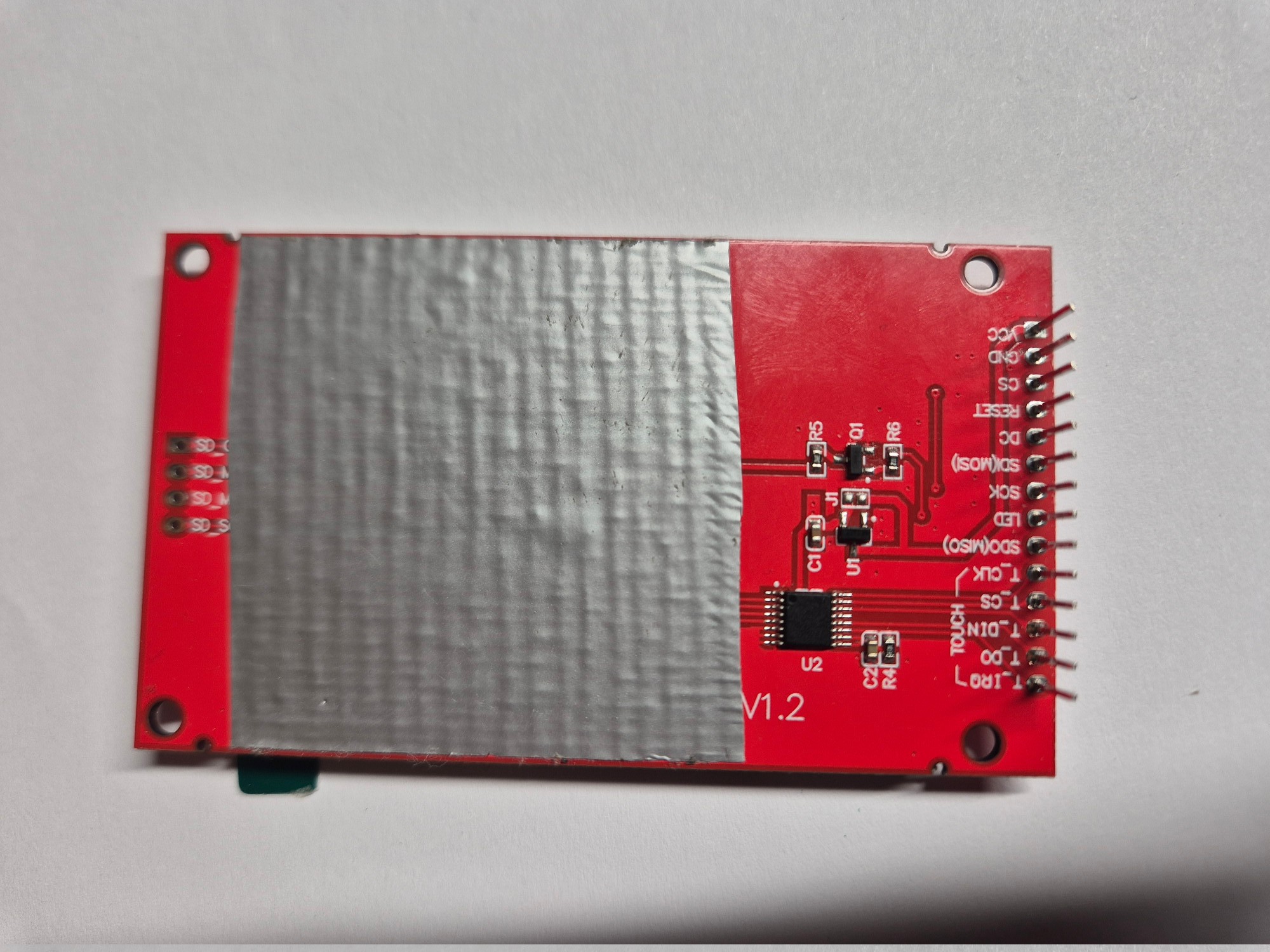

SD card socket and resistors were removed, plastic from the LCD pins as well. A piece of duck tape was used as "isolation layer" between LCD board and RCAN-LCD module.
LCD adapter board goes over the "naked" LCD pins, There is currently no nice way to fix the RCAN-LCD module on the board - I used some glue on the outer side to fix it.
The adapter board has backlight selection pads. One option is to control it by MCU pin, another to connect it to VCC so it's always on with power available. I choose MCU pin control to be able to dim the light if necessary. Wire bridges between RCAN-LCD module and adapter board are "hacky" and I also thought about castellated holes, but it unnecessarily increases the PCB costs - so "hacky" is good enough for me. I'm already happy that with the adapter board I could get rid of wild cable wiring...

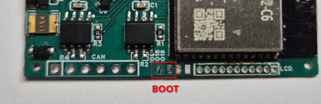

To save space I intentionally left out the BOOT button. Because it's actually needed only for first time programming. All binaries uploaded after usually contain some code allowing esp-upload tool to switch the device in bootloader mode automatically. So for the first programming the pins need to be shorten before uploading the code.

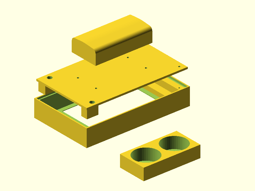

The case was designed with OpenSCAD - source files together with STL exports for printing can be found in the repository.
I used ABS for printing the enclosure, because first prototype made of PLA got a deformation by the high temperatures when the car parked under direct sun. I didn't want to destroy the dashboard to mount the display so the best idea came into my mind was using neodymium magnets. First attempt was using 8 of 18x3mm neodymium magnets, but the dashboard wand seems to be too thick for that combination. Display was slightly moving around and didn't stay at chosen position. Next try was to use more powerful magnets - 20x5mm and some grinding of the mounting...
